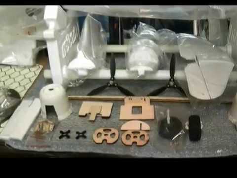

HK 1600mm DC-3 Build
So far this kit is working out fine for me.I was pleasantly surprised with the detail. I loved the fact that it came with all the hardware. I put my Dynam C-47 into the trees on its maiden and just finished up a complete rebuild with some mods. Looking forward to getting her back up.While I am not a fan of HobbyKing, I do love the C-47. I have the old Royal kit, but it got a little banged up. I had thought of buying the Dynam kit, and replacing the fixed gear with the retracts from the Freewing Mosquito. It would be pretty close to correct, and I can do some minor modification to make them even closer to scale. I was going to get the white DC-3 version, and do my own paint job on it. I think I like the looks of this one better, so now I am on the fence again....decisions decisions...LOLComment

Here is the build so far in a slide show.This a Photo show (Part One) of my winter build of Hobby King's DC-3/C47 Kit.Comment
