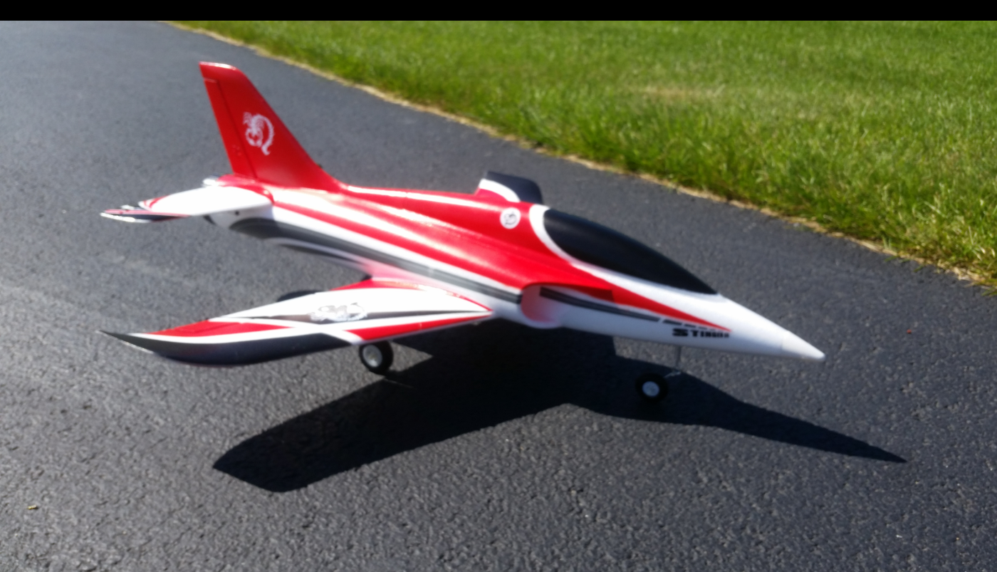

          Really like mine too ! Rips fast as heck once its up and rolling . I can get mine airborne off short grass on wheels but it sure does like a good head wind . 2200 admiral pro 4s stuffed in the battery box . It started out as a 3s but changed out the fan and esc
