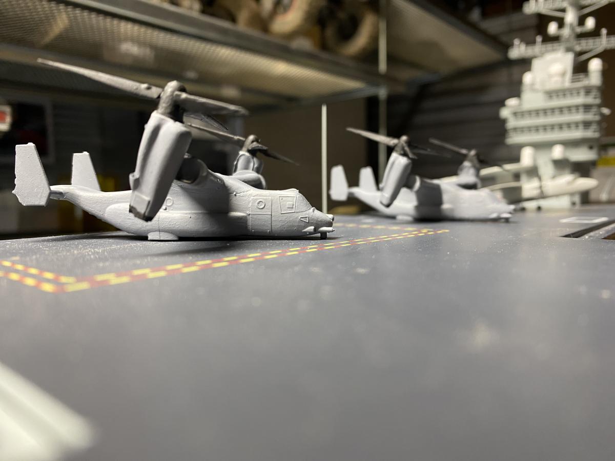

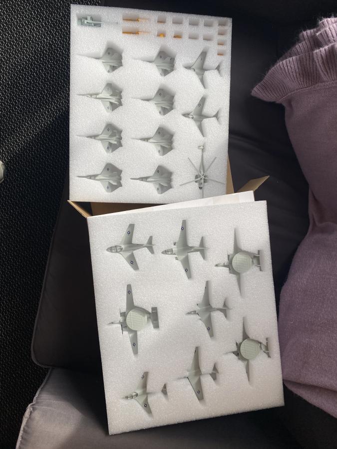

                  Finally got my Nimitz and I am preparing to mod with rotating radars and additional 3d printed aircraft, etc. REALLY nice looking ship. I did wish it had brass props instead of plastic. I will likely have to upgrade those. You can see here the 3d printed ones I am making compared to the provided aircraft. The included ones are quite nice. The ship was VERY well packed and FedEx Ground beat the crap out of the package. I would spring for the extra cost of shipping by another carrier next time. My Titanic arrived in similar shape.

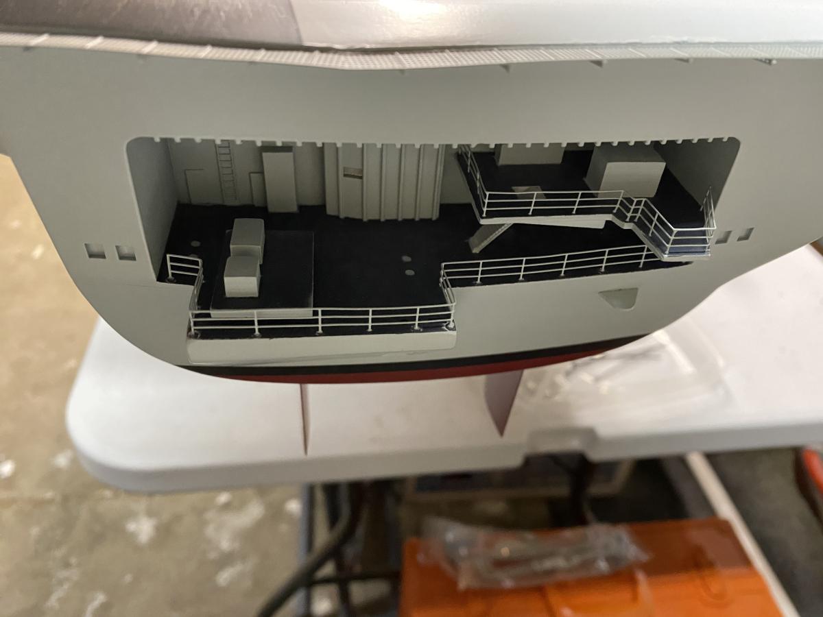

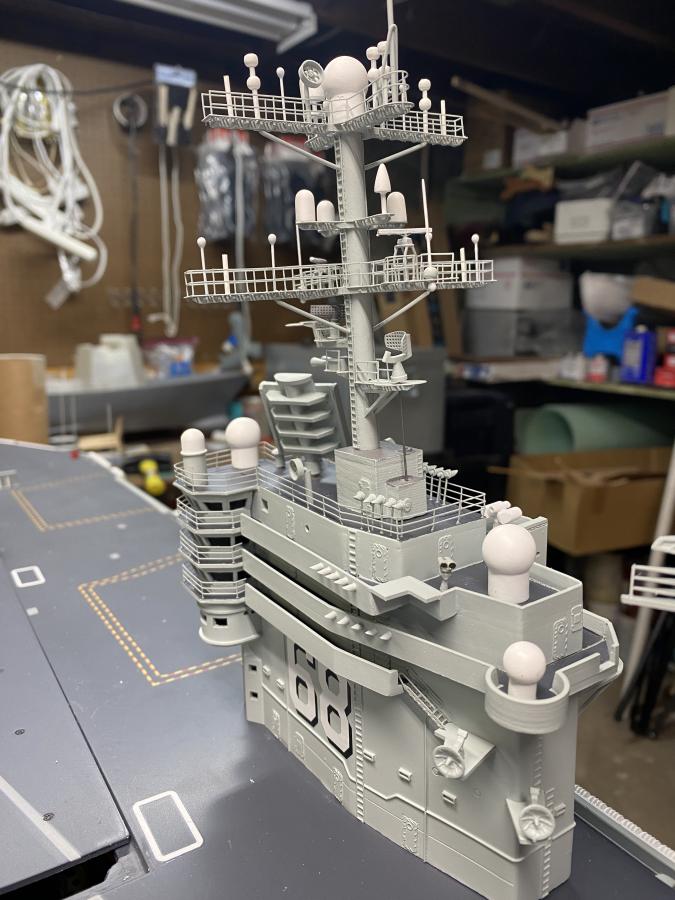

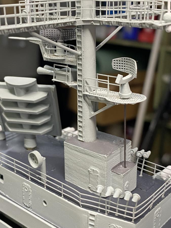

                          I wanted to raise the mast mount of my Motion RC Bancroft Nimitz aircraft carrier to allow for the rotation of the radar. I chose to do this by making a small shack level on which to mount the mast, rather than a mast extension.
                          It is not historically accurate, but serves the purpose. I have a hole for the original mounting screw into the mast from inside the new base shack. I used a few washers under the screw to spread the load out, then glued the new base shack to the existing roof deck of the carrier island. There is also a hold for a small rod running through the shack to allow for the rotation of a radar on the mast itself.
                          Both rotating radars are connected to separate N20 small geared motors. These are available in a variety of voltages and speeds from Amazon and Ebay for a few dollars each. I am using a 30 RPM and a 50 RPM motor.
                          I made this in Tinkercad and printed it on an Anycubic Mono X resin printer with standard resin. It is hollow and open on the bottom. I printed with auto supports with the piece at a slight tilt.​
                          I moved around some of the radars that came with the model and added some others I was able to find and print. By drilling a small hole in the base of the radar, I glued it to thin steel wire which runs to the small geared motor, which is connected to the motor with a piece of fuel tubing.
                          I had the paint scanned at HomeDepot and have included a photo of the label, so that others can get the paint matched. It is close, but not exact. And that is fine for a Navy ship. There are likely subtle variations in the paint on the real ship as well due to age, repairs, etc.

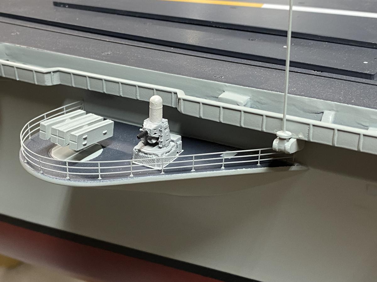

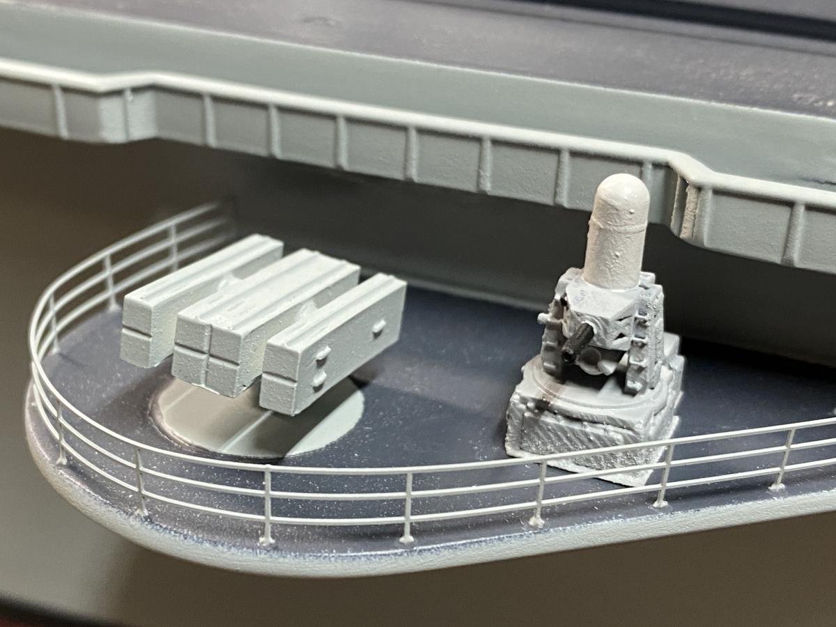

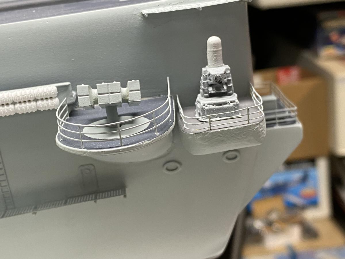

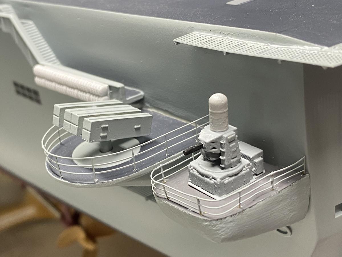

                                Upgraded with 3d printed CIWS mounts. Platform is balsa. Railings are PE Brass. CIWS file found on Thingiverse. I do not have the link so please search. Printed on an Anycubic Mono X.

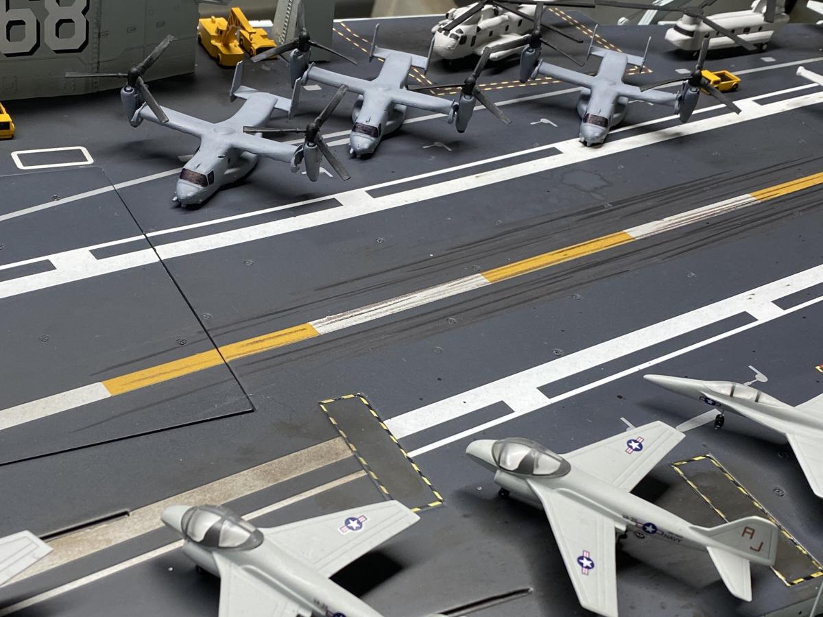

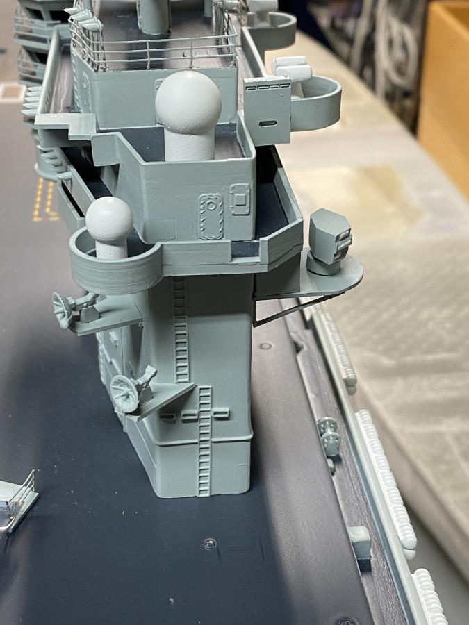

                                        Making progress on weathering and details.
