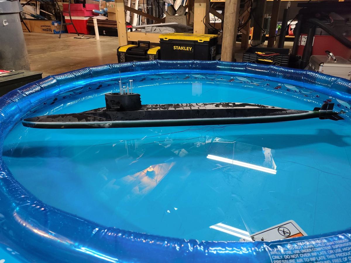

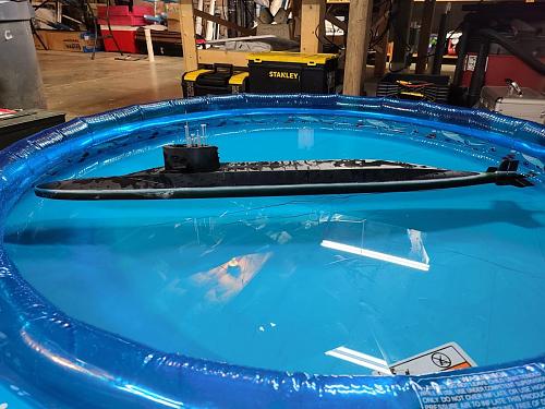

              Picked up a cheap inflatable kiddie pool and have been working on trimming it. You have to establish both a waterline trim and static dive trim so it is quite the process of trial and error. It is a matter of where to place weight in the keel and how much and then where to place foam above and below the waterline. When done it should sit in the water at the waterline and then when the ballast tank is flooded, it should submerge straight down and the deck should wash over evenly. It is easier said than done.

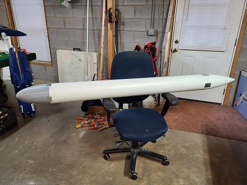

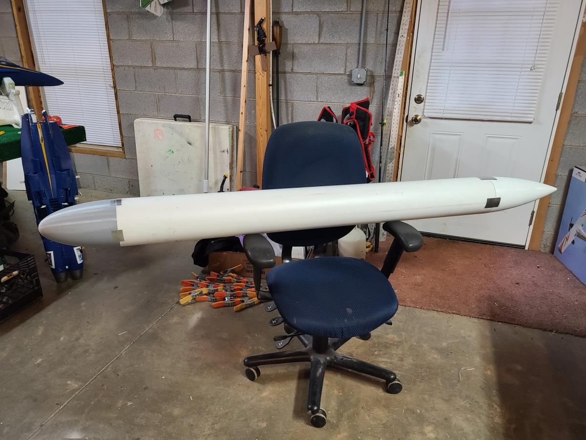

                            Thank you sir. They are fascinating. Now in addition to this one and my 1/35th Nautilus, I also have a fiberglass Typhoon hull and I am building an Ohio'ish class sub based on a piece of 6" PVC pipe. It will be almost 7-1/2 feet long. I am designing and 3D printing the nose, tail and deck and will likely mold the sail and stern control surfaces for it. The main thing with it is the modularity permitted by using the PVC pipe for the hull. The nose and tail will be removable to access a slide in tray that contains all the running gear.
