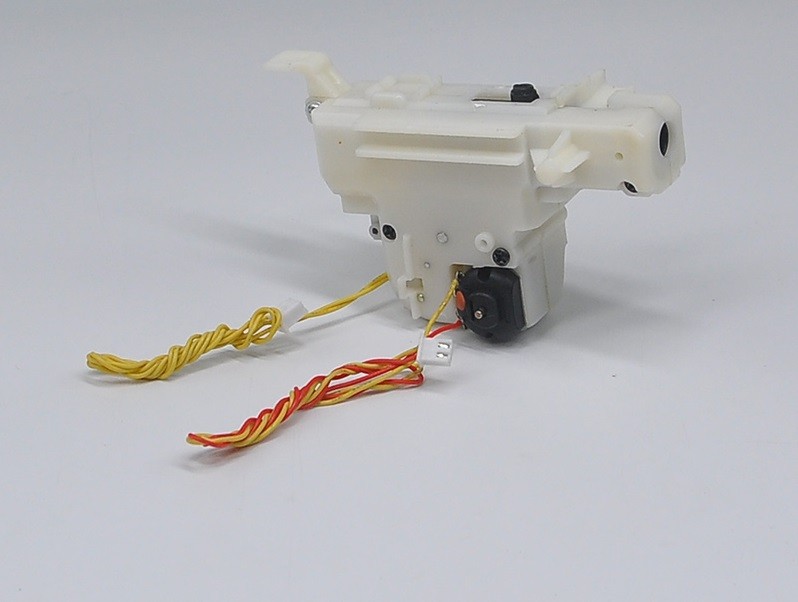

    2) Airsoft firing mechanism for 6mm plastic BB. -When pressing the firing buttons from the radio, the brushed motor (yellow-red wire) compresses a piston/spring rearward until a trip switch is triggered (yellow-yellow wire), at which point the piston slams forward to propel a 6mm BB out of the barrel at the same time the MFCB triggers the "cannon firing" sound and the track recoil effect.
Name:	O1CN01PvqjTS1Zensh0kFa9_!!3408063220 - Copy.jpg

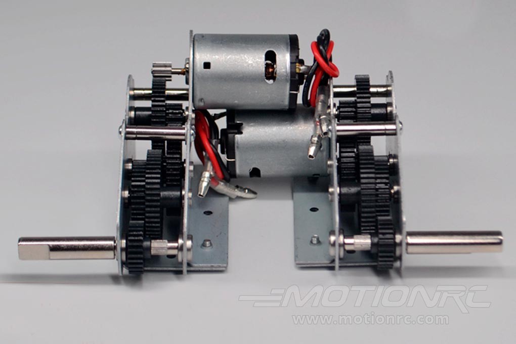

    1) Motors. Or... your tank is really a pillbox. All RTR tanks have two motors. Most RTRs use two identical motors, each responsible for one of the tracks. To move forward, both of the motors spin their respective tracks forward. To turn, one of them spins forward while the other spins rearward. Certain configurations use a "drive" motor to drive the tank forward, and a "steering" motor to turn.
    2) Gearboxes. Each of the motors transfer rotation to the drive shaft via a gearbox. RTR tanks' gearboxes are often exposed. The gearbox ratio is usually fixed, but aftermarket upgrades with other gearbox ratios can be paired with other motors for faster speed, higher torque, etc.
    Click image for larger version  Name:	bbkth4.jpg Views:	1 Size:	77.1 KB ID:	222672

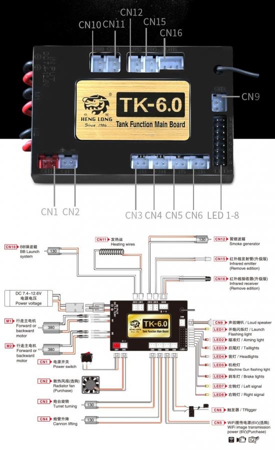

    3) "The Brains" - MFCB, MCB, MCU, or by any other name, this is the multi-function board that controls the motors, speaker, power input, turret functions, track functions, LED functions, etc. All RTR tanks' MFCBs also integrate a receiver, but aftermarket MFCBs require the user to add their receiver of choice. Below is an example of Heng Long's latest TK6 series MFCB. All functions are designed to plug in, without any soldering required, for easy replacement and servicing.
    Click image for larger version  Name:	O1CN01XUzGEy1ZensiHTfP8_!!3408063220.jpg Views:	1 Size:	92.4 KB ID:	222674Click image for larger version  Name:	O1CN01pPB8Ou1ZensiBLkzL_!!3408063220 (1).jpg Views:	1 Size:	68.7 KB ID:	222673

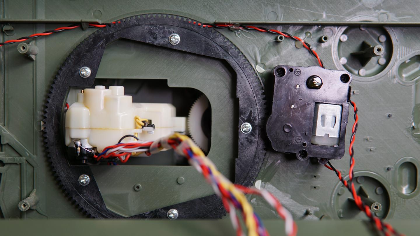

    Upper Hull:
    1) Turret Ring (for 320 degree rotation, unless modified for 360 degrees) - The black ABS plastic ring seen below
    2) Turret Traverse mechanism (usually a geared brushed motor) - The black rectangle mounted against the turret ring below
    3) LED Wiring - Headlight LED wiring and tail light LED wiring, depending on the tank's layout
    Click image for larger version  Name:	DSC00025.JPG Views:	1 Size:	127.2 KB ID:	222564Click image for larger version  Name:	DSC00017.JPG Views:	1 Size:	133.8 KB ID:	222567
