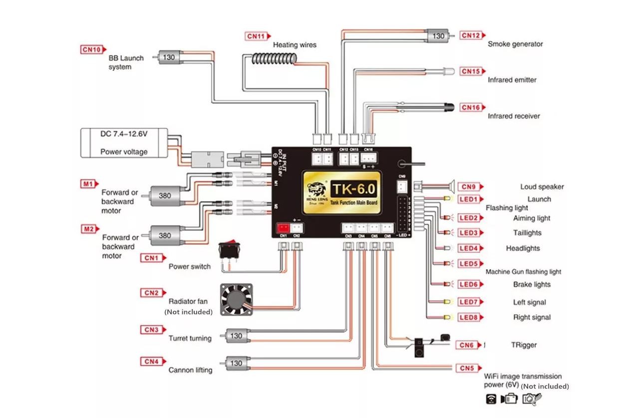

    Thanks for the tips and I just purchased a heng long Sherman Pro tank. the info is much appreciated. I do have one question though... Can you switch the left and right controller sticks? It sounds like the controller is in mode1, can it be switched where the left stick controls forward. reverse and turn? or did I read it wrong.
    Thanks in advance,
    STC
    Hi STC, welcome to Hobby Squawk! The TK6.0 does not currently have a provision to swap the "Mode". However, my prototype TK6.1S I'm currently testing is swapped as you described. I'll ask the factory when they wake up. Standby.
    Here is a diagram (from the printed manual) that identifies all the ports and switches on the TK6.0. Note that there is no "mode switch" button. I don't have the manual in front of me right now to view the pages that show the deeper programming in the radio itself, but as I recall, programmable functions handle recoil, turning sensitivity, acceleration, speed mode, and other functions of that nature... not mode switching.
