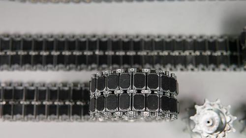

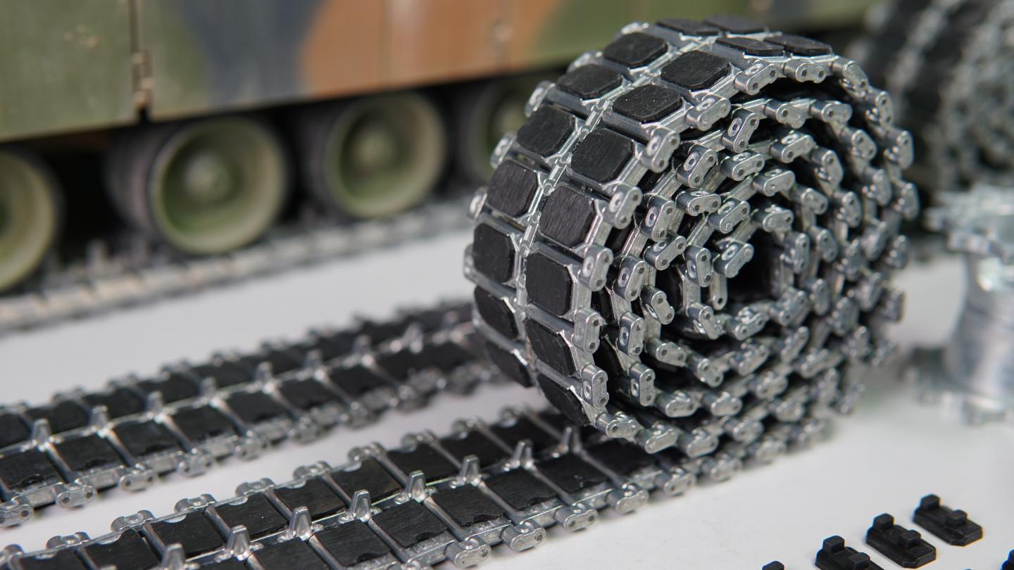

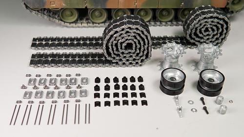

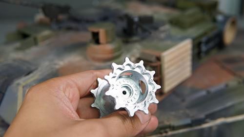

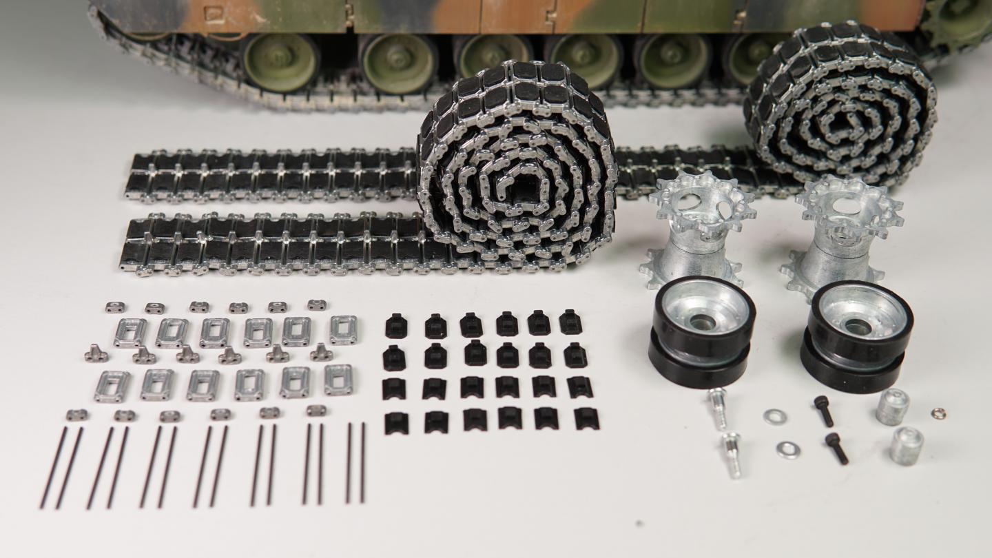

    I have been running Mato's aftermarket track/sprocket set on my Heng Long 1/16 Abrams "Pro Plus" tank for the past several weeks.
    Note that my "Pro Plus" version is significantly upgraded from the usual retail "Upgrade" and Professional" versions of the Abrams. My tank uses CNC gearboxes, 390 motors, an all metal lower hull, steel torsion bar suspension with adjustable idlers and full bearing sets, a prototype TK6.1S 160A MFCB, dual smokers, and onboard charging for the 2s 7000mAh battery. Your experience with Mato's tracks may differ depending on your tank's motors, suspension, MFCB, etc.
    In the context of my tank, here are my impressions so far of Mato's tracks :
    PROs:

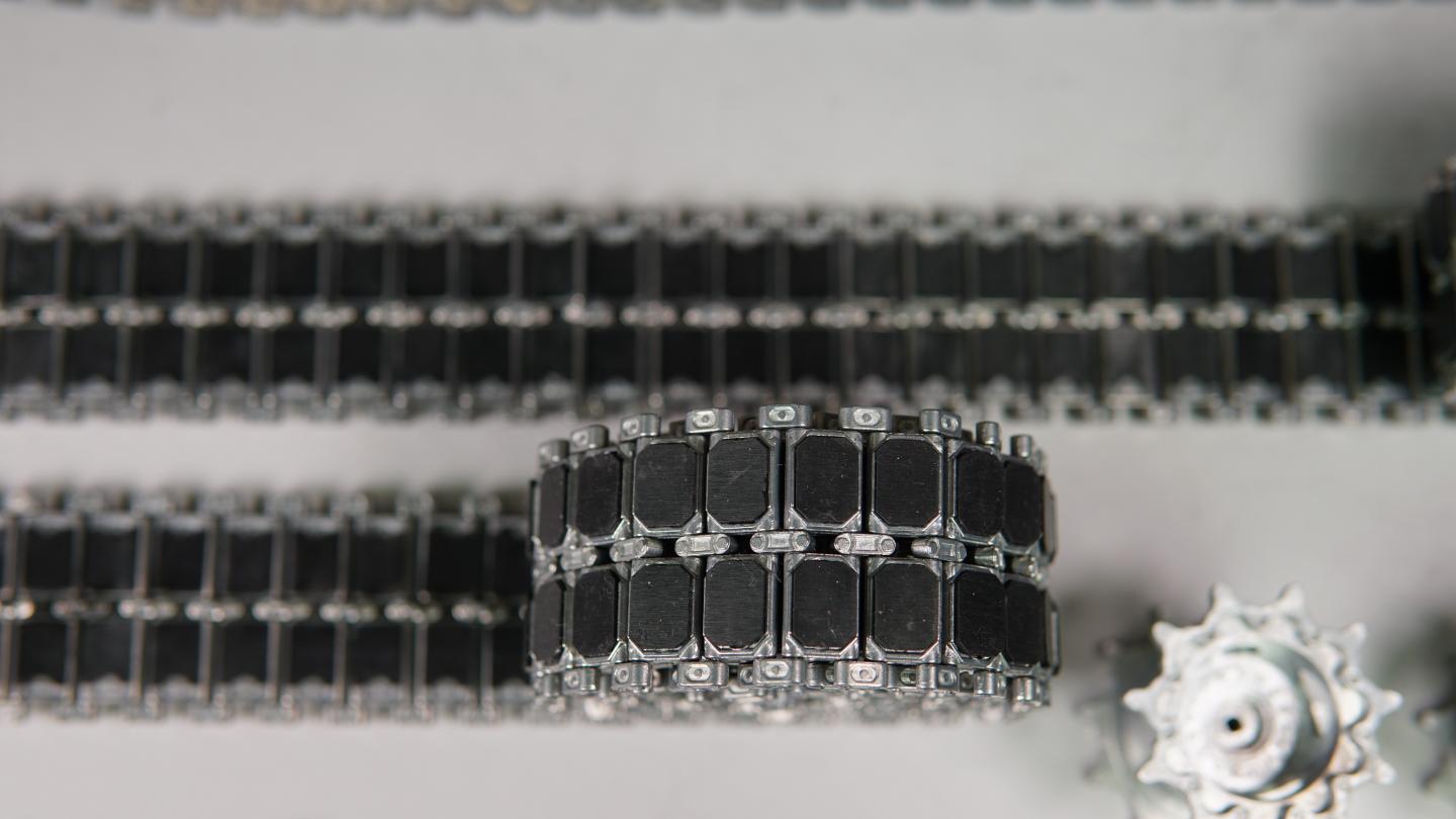

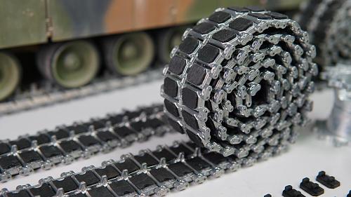

    1) Pads. Double-sided rubber pads are designed to overlap each other, which increases the holding power of the adhesive and resisting shedding pads. I've run these tracks on gravel, sand, dirt, asphalt, smooth pavement, and grass. So far, I've only lost one outer pad, and replaced it with one of 12 spare outer pads that came with the original set, using E6000 adhesive.
    2) Weight. The tracks themselves are heavy and lend a pleasing weight to the tank. I'm about 14 pounds as it sits.
    3) Traction. The rubber pads impart excellent traction on all surfaces, even wet paved surfaces and tile floors, where plastic tracks are prone to slipping. I can really "creep" the tank slowly. At full speed, the vibrations are low and the ground rumble is lower than Heng Long's original all-metal pads.

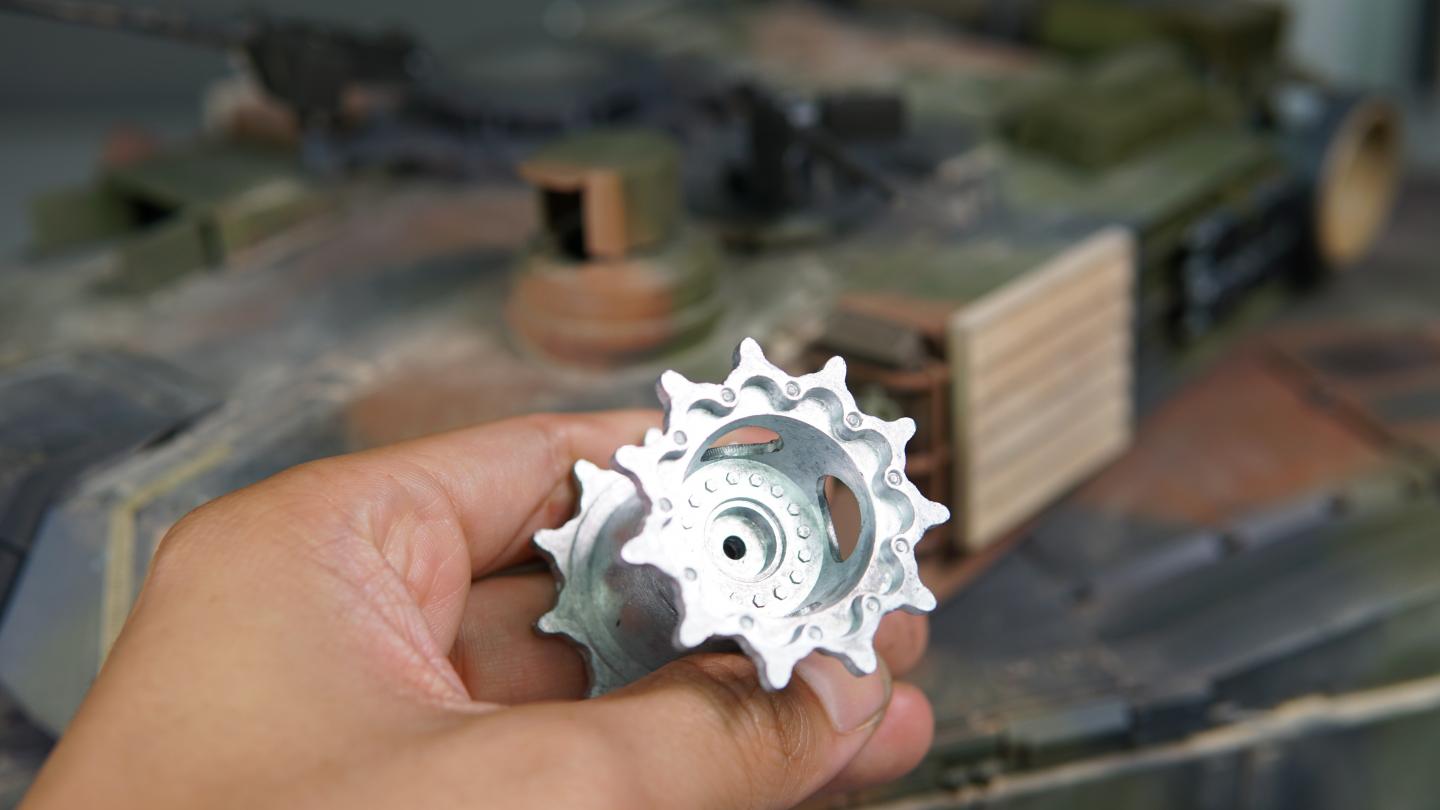

    4) Accuracy. I won't get in the weeds over various track cleat/pad shapes, but I will say that I like the sprocket, which is more accurately shaped than the original part, both on the outer ring's inner radius and the inner wall's four holes. It is the same metal, however, so I don't see any strength advantage over Heng Long's cast metal sprocket. I also like the pad shape for this specific variant of Abrams track style.
    5) Durability. I don't expect to crack a track anytime soon. I run tanks, I don't bash tanks. So cast metal tracks from Heng Long and Mato are basically a "set it and forget it" type of upgrade for someone who drives tanks like I do.
    CONs (factors worth CONsidering):
    1) Price. The set costs about twice as much as "plain" metal tracks, and about four times as much as the plastic tracks. I prefer plastic tracks on many of my tanks, so 4x-5x is quite a price hike by comparison.

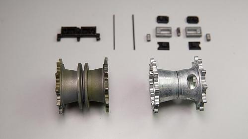

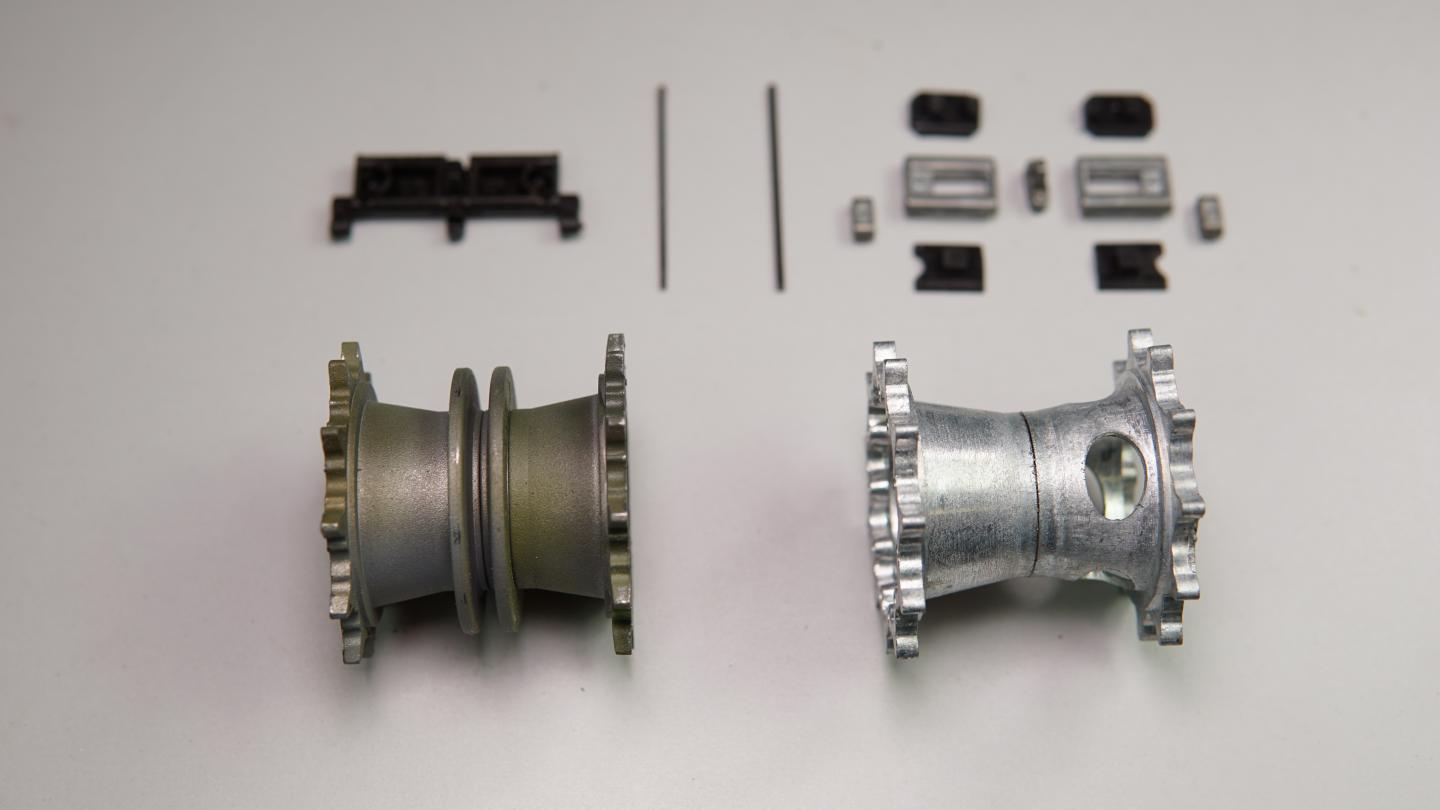

    2) Fit. Mato's spocket and idler are drop in fits with Heng Long's shaft and mount, respectively, which is a good thing, initially. Mato's idler appears to be identical to Heng Long's idler other than a slightly brighter surface finish on the Mato version. The problem with fit is Mato's sprocket, which didn't fit well with Heng Long's metal tracks, and Heng Long's sprocket didn't feed too well with Mato's track's either. So, for now I need to advise anyone wanting to install Mato tracks should also purchase Mato's idler AND Mato's sprocket. The additional cost is worth the reduced headache.
    Heng Long's simplified track link and sprocket are to the left, and Mato replacements are to the right. Notice the nine pieces from Mato that comprise the single piece from Heng Long.

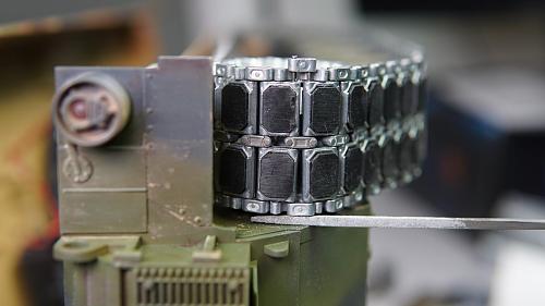

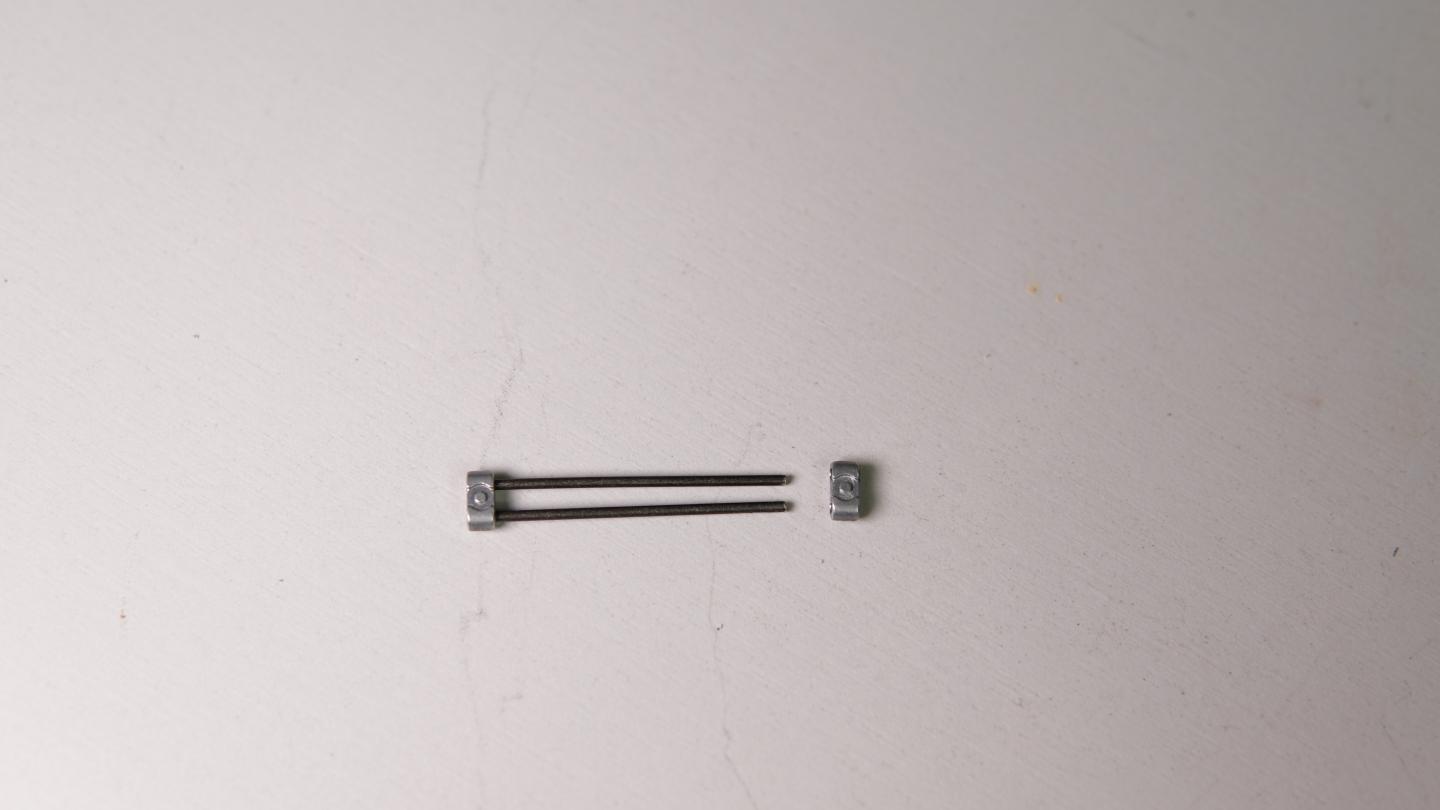

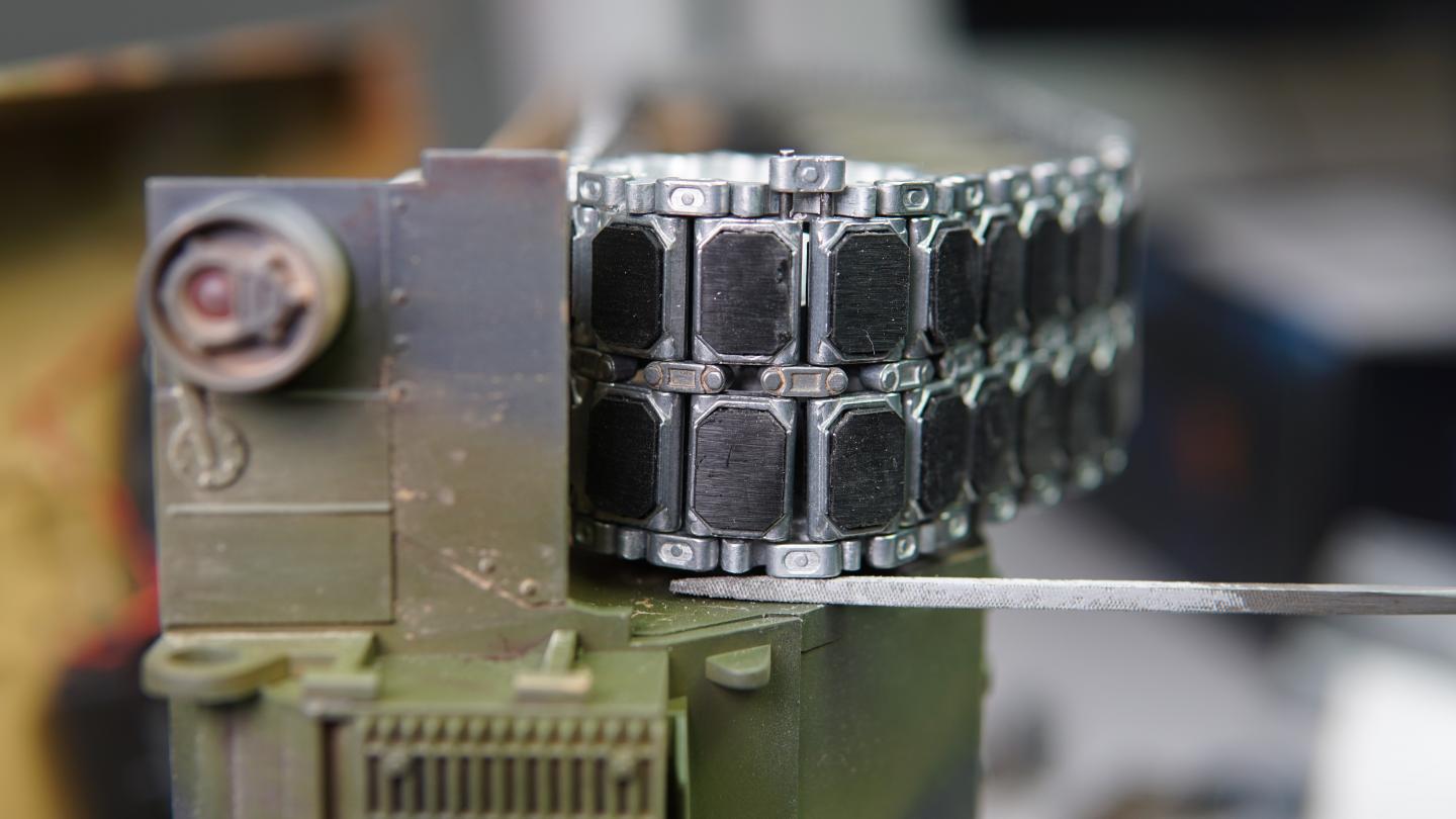

    4) Design. The pin design is also different from Heng Long. With Heng Long tracks, one side of the track pin is smooth. This is the side that you push into the hole first. The other side of the track pin is abraded, and its raised edges provide "grip" to secure the pin in the hole. With Mato's tracks, however, the entire pin is smooth and both ends are smooth, so there is no raised surface on one side to hold the pin in. Rather, then entire pin is intended to hold itself in with friction, meaning you'll need to pound the pin in with more force than Heng Long tracks require. Thankfully, you only need to do this once per track, during the installation phase. It isn't impossible, it just takes some planning and preparation beforehand.
    I recommend prepping the two cleats by first using a tiny file or pin vise to slightly open up the inner link. Leave the two holes on the outer face of the tracks exactly as they are, however, since you'll be relying on their friction to hold the pin in, while the inner holes have less friction. I also prep two track pins by linking them together.
    Click image for larger version  Name:	DSC00005.JPG Views:	0 Size:	52.0 KB ID:	221340
    I also recommend positioning the two track sides against the sprocket, to serve as a guide as you grip the track and bring the two ends together. Position them overlapping as you would any tank track link, then tap in the pin. I wedged a metal file into place between the track and hull, to counteract that tapping force.The file helps hold the two track sides in place, so I can focus only on aligning the pin as it's being tapped in through each section.

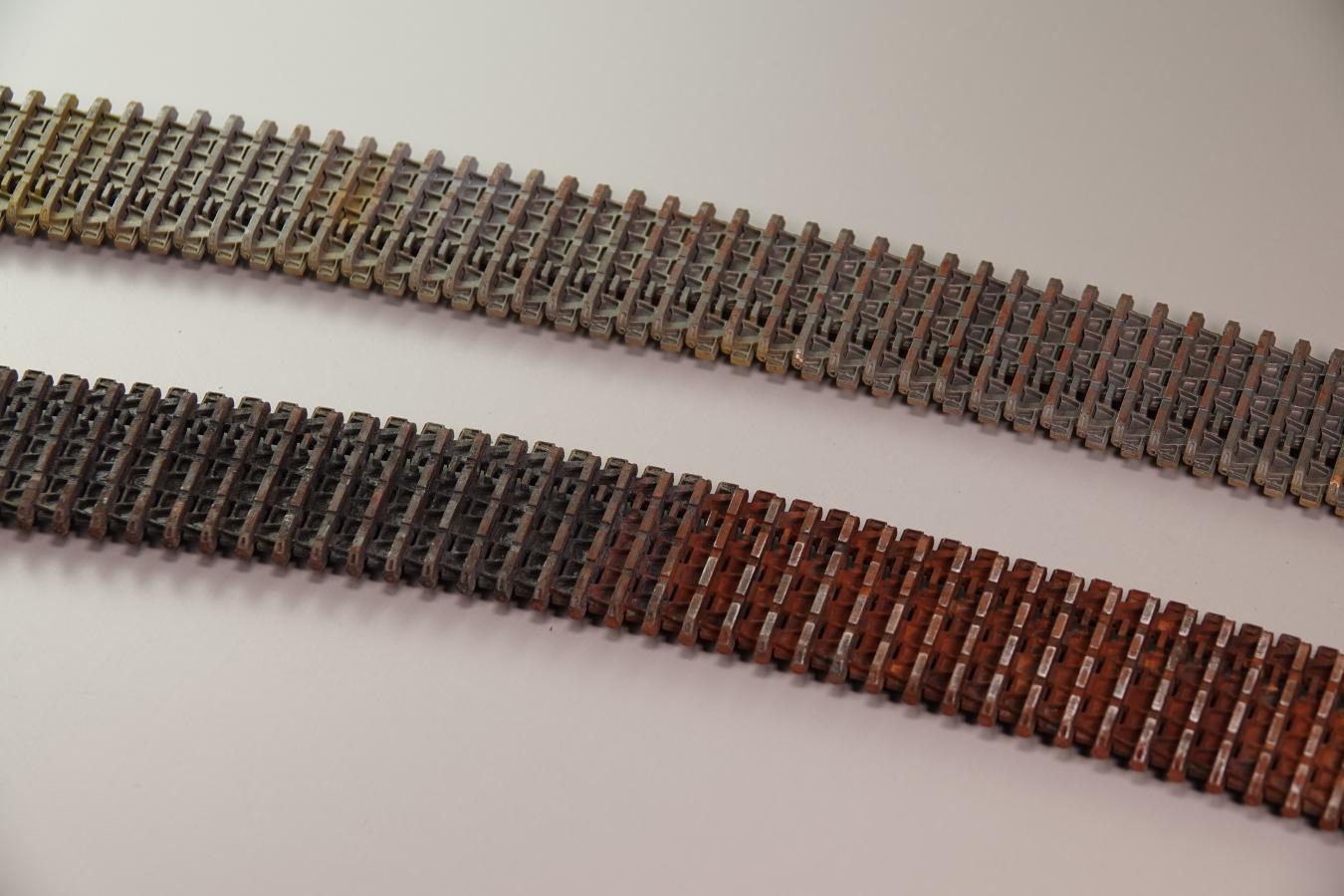

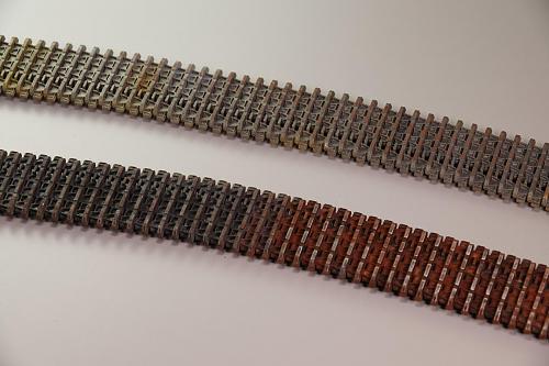

    The next step is to age the tracks with AK Interactive's "burnishing liquid", which will allow the tracks to weather more realistically outside in the elements. I'll also add some pigmentation of my own to help things along, same as I did on my Tiger I Early.
