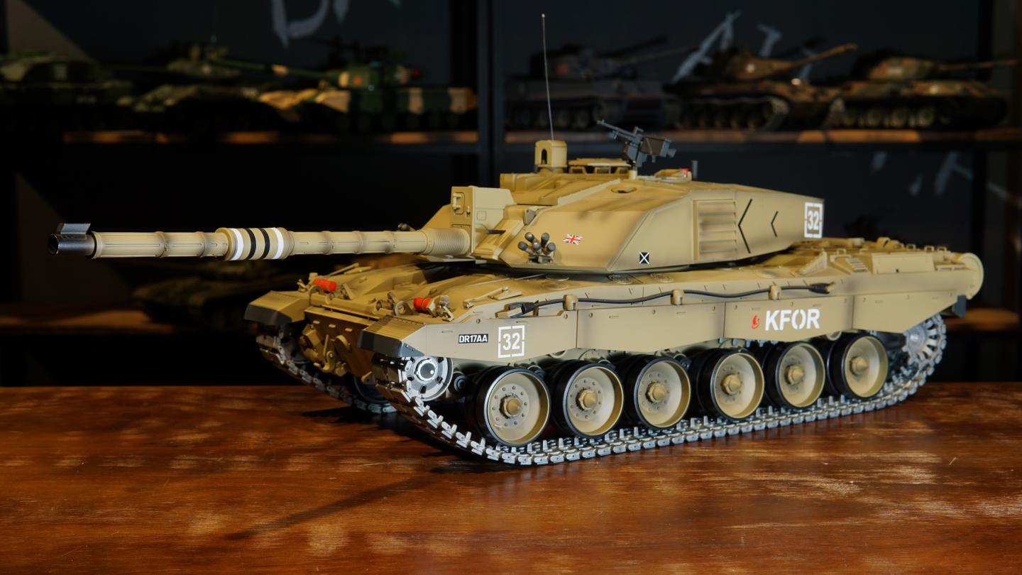

    Scale Fidelity:
    The Challenger II is one of the more recent tanks to be produced by Heng Long in 1/16 Scale RC, and it shows. The overall lines of the tank are accurate and the proportions don't leave any glaring issues. Being a very large tank in real life, the Heng Long 1/16 scale Challenger II is the longest tank offered by Heng Long. Two sets of decals are included to depict accurate markings from real units that were in

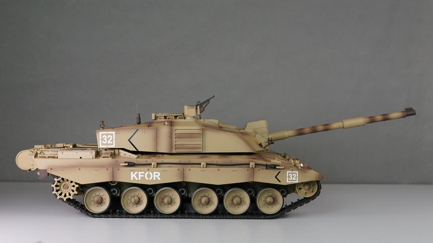

    Exterior Quality:
    The tank is primarily composed of ABS plastic, which is nicely molded. There are a couple small sunken areas, but these are barely visible. The fit and finish of the tank is superb, considering its price, and I consider it a very good value. This version of Challenger II arrives fully painted in a base desert color and a factory-applied shading. The shading varies in weight at different areas of the tank, resulting in a nice, inconsistent shaded appearance. Some people may prefer an unshaded version, but in my case I plan on eventually using the factory shading as pre-shaded base for a custom airbrushed paintjob.

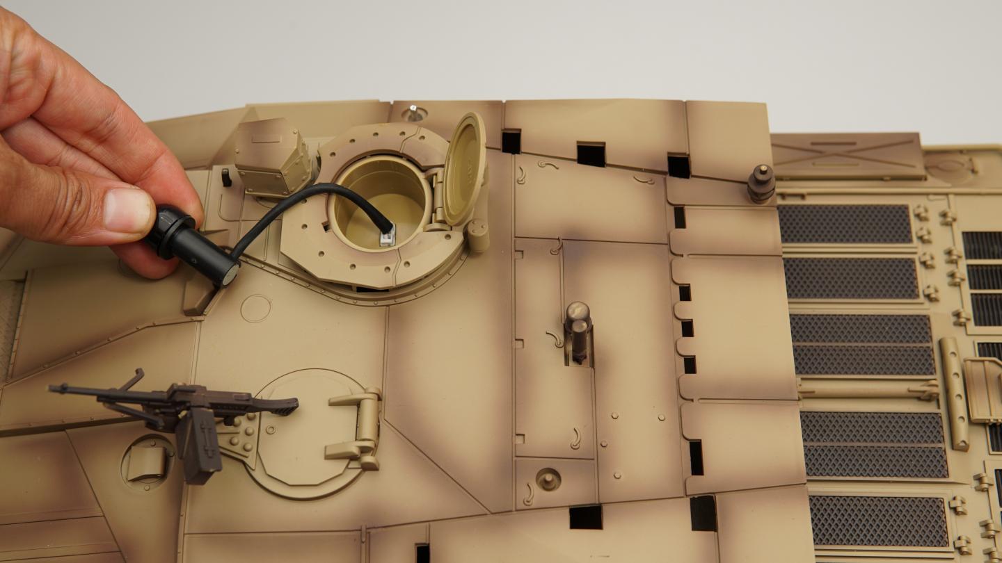

    If you plan on battling your friends with the included IR (infrared) system, plug in the IR apple and locate its magnetic anchor spot in front of the hatch. Heng Long's magnets are concealed inside the turret and thus there isn't any unsightly mount visible from the outside of the turret. The IR apple is low profile, and reasonably sensitive in overcast conditions out to ~10-15 meters. Due to the mostly flat and uncluttered upper surface of the Challenger II's turret, however, its IR apple stands out more than some of the other tanks from Heng Long.
    Click image for larger version  Name:	DSC00123.JPG Views:	0 Size:	99.9 KB ID:	220973

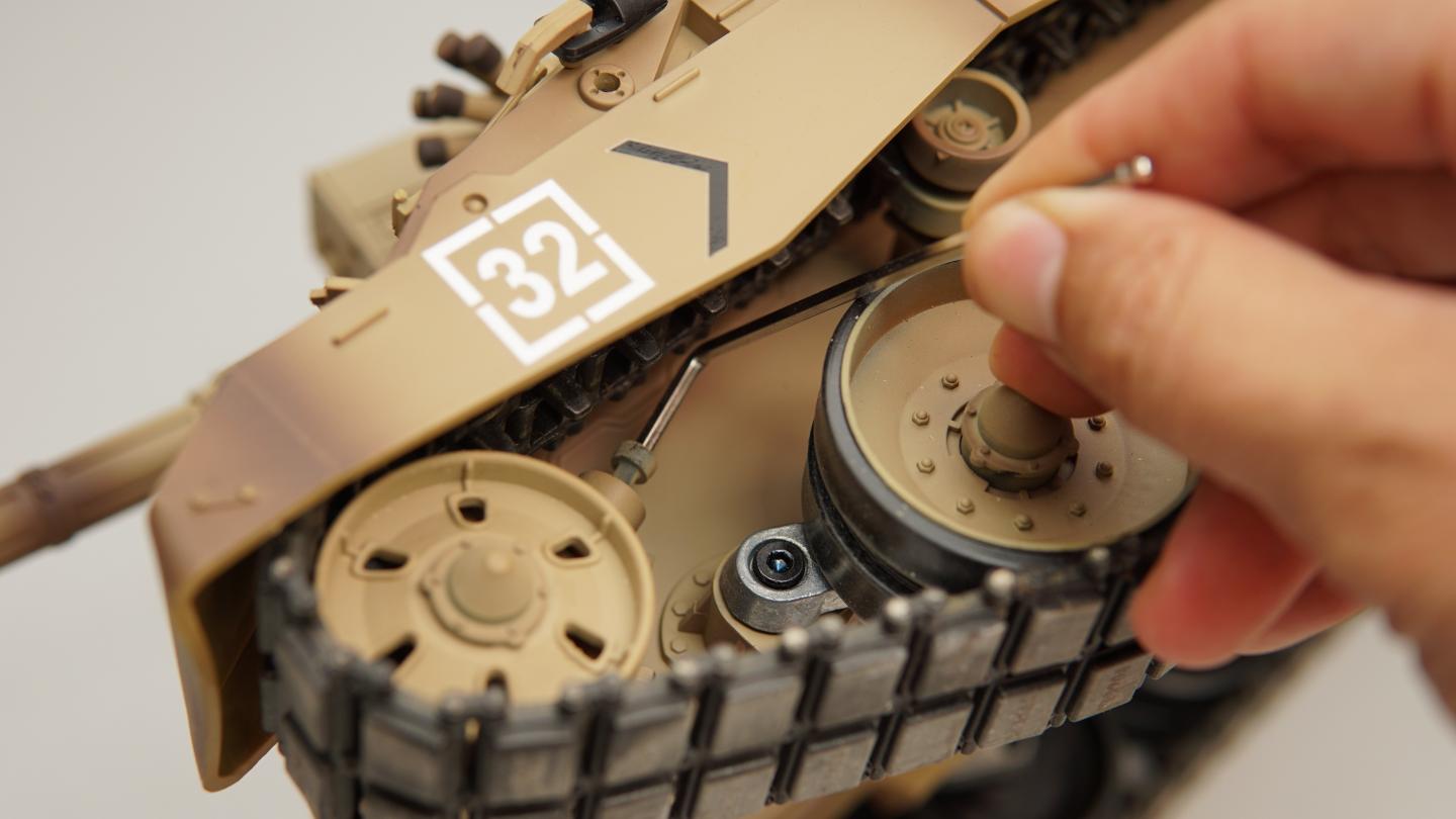

    Note the metal suspension arms and metal idler wheel mount, that incorporates an adjustable idler. This allows very easy adjustments to loosen or tighten the tracks to best suit your driving style and terrain conditions. The Challenger II and T-72 are recent tanks from Heng Long that feature this mechanism. While it is not a daily use element, it is still nice to have if/when the need arises, and is simpler than adding or removing track links to adjust the overall track tension, as is required with models like the M1A2 Abrams, Panther G, T-90, and King Tiger.
    Click image for larger version  Name:	DSC00129.JPG Views:	0 Size:	79.6 KB ID:	220976

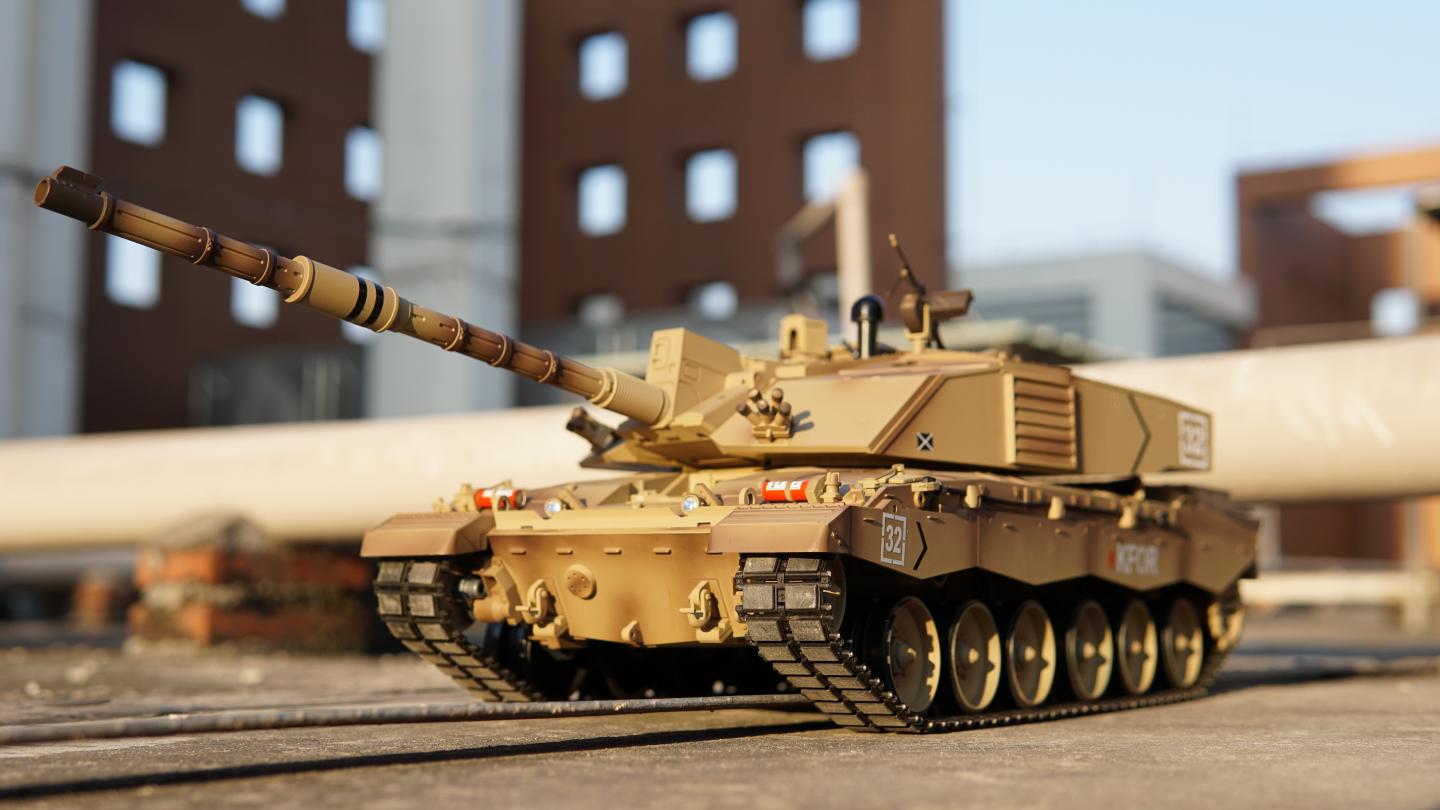

    Indoors, the sound is very loud, the LED headlight is bright, and the smoke is easily visible. Outdoors, the sound is still readily audible and the LED is also visible in daylight, but the smoke becomes difficult to see. This is just as well, since the real tanks weren't constantly venting smoke as if they were on fire, so I don't mind the reduced visible volume in daylight. The Challenger II has two exhaust ports, just like the real tank, and these are easily accessible under plastic grates. This makes refilling them with smoke oil very easy to accomplish.

      Perhaps the most user-friendly element of the Challenger II is its adjustable idler mechanism. Easy to access, convenient to adjust, if ever needed.

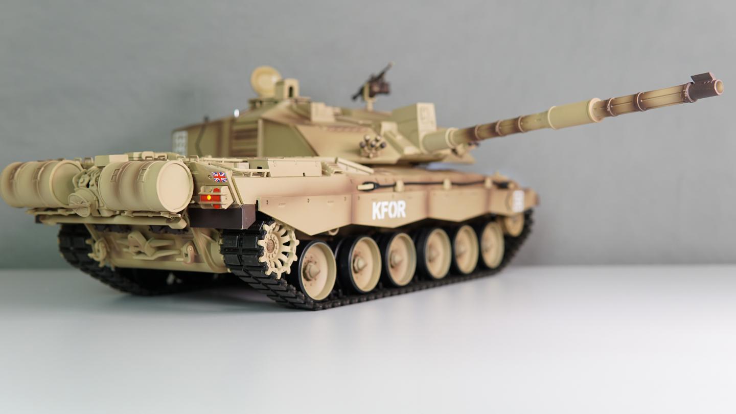

      Several sprues of plastic parts are provided for the modeler to install on the tank to enhance its overall scale appearance. These all plug into pre-drilled holes, and are nearly "snap fit". A few of the parts were loose, so I bonded them with ABS glue. But otherwise, I prefer to keep the parts unglued so they're easy to remove or replace if needed in the future. Installing the plastic "accessory parts", including the fuel tanks, fire extinguishers, smoke grenade launchers on the forward turret area, rear view mirrors, and many grab handles, took about 45-50 minutes from start to finish. Plan for an hour if you want to take your time cutting the parts out of the plastic sprues. I recommend a sharp clipper designed for this purpose, as it makes cleanup much easier. The accessory parts are pre-painted and really enhance the tank's overall surface detail.
      Some areas of detail are necessarily softened at this price point and acceptable for a mass production RC tank, but overall this 1/16 scale Challenger II looks good from almost any angle. It feels like an imposing machine that means to do bad things to bad people.

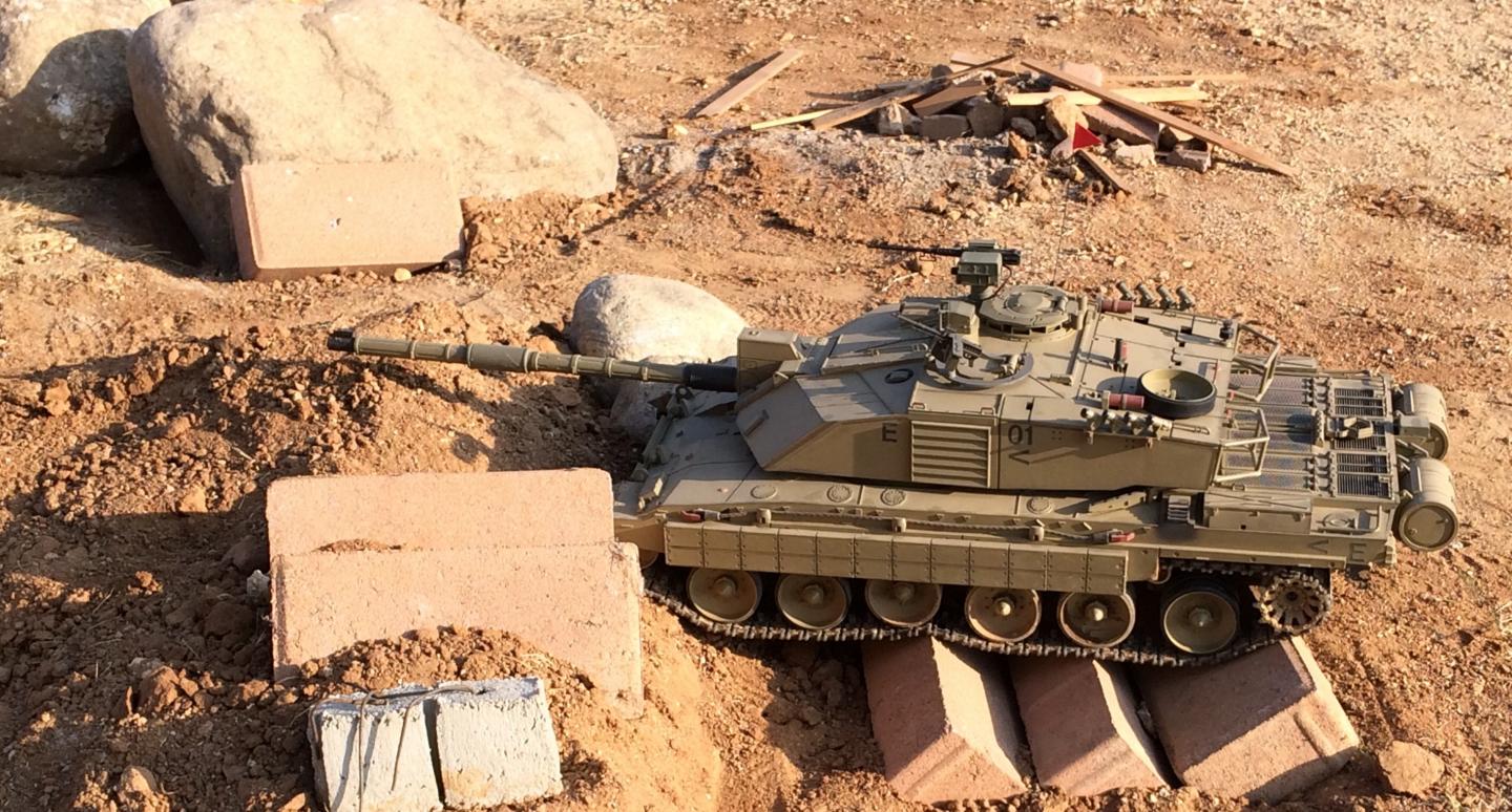

                The Challenger 2 is one of my favorite R/C tanks. It's huge for a 1/16 scale tank, looks mean as heck and has superb suspension articulation that make for one smooth cross country running tank. With the new 6.0 version now coming with an adjustable track tensioner it should be even better then before.
                Here are a few photos of my Challenger 2 tackling an off road tank obstacle course.
