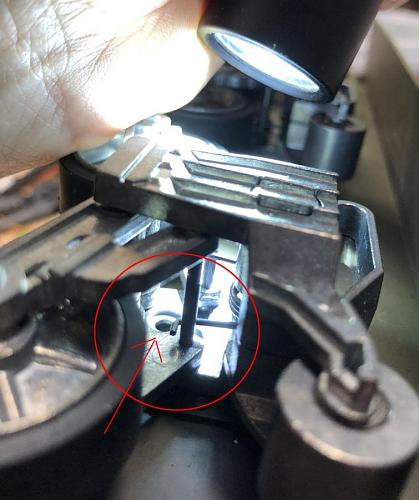

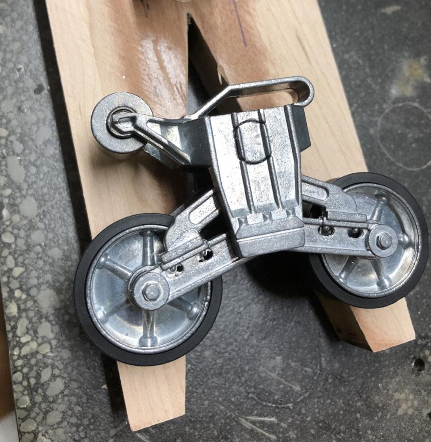

Looking for advice on how to dismantle the HL bogie.... One of them broke off and now I'm trying to dismantle it for the repair I have in mind. For the life of me can't get the plug on the outside to budge.. Can I drift the plug out from the inside without damaging the inside of the assembly? What do they look like when apart?

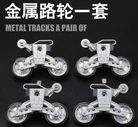

Finally found a somewhat useful picture on the web for un-installed HL bogie's. Looks like I have to get the plug out somehow.......darn it. Alpha, can you put an order in for replacement metal plugs? May have to drill it out and use a plastic one for the time being..
The proper way for them to be installed and removed from the hull requires them to be disassembled to get to the lower hull screw..
HL doesn't produce metal bogies for their Sherman. The metal bogies you're looking at here are made from third party shops. I was surprised when HL told me that, but they told me that to my face while standing in the HL foundry, so, I believe them. They also did not have any metal Sherman bogies on their spare parts price list, and their Pro version doesn't have metal bogies, so, again, I believe them. The good news is that they did comment that most metal Sherman bogies on the aftermarket do fit. It seems sellers will market them as "Heng Long", which we English speakers interpret as "Made by Heng Long", when in reality a more accurate descriptor would be "Made to fit Heng Long". So it shouldn't too much of a chore, if not a breeze, to install them onto a Heng Long hull, in the same way that Mato wheels were drop in fits to my Abrams.

I think I found them. Must be a third party as Torro and Taigen both look a little different.
Here's a link that must be them.

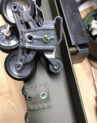

One of them broke off.

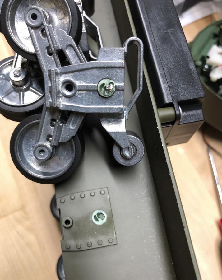

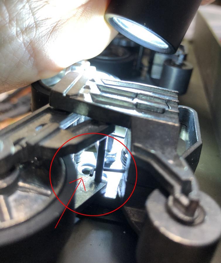

Notice the second lower screw isn't installed. I checked and they aren't installed on any of them.
You would have to split the bogie to install the lower screw and then assemble it in place on the hull.
I have a call into the company I purchased it from. They haven't responded yet..

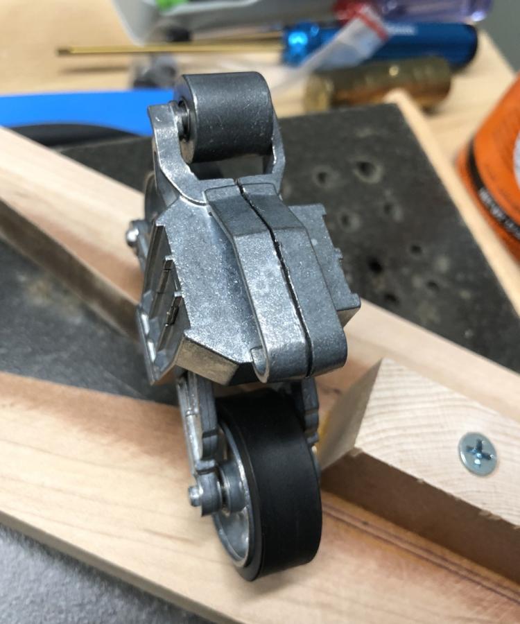

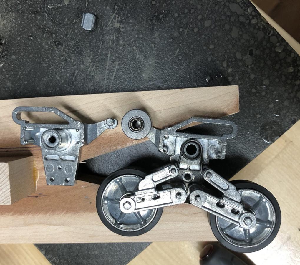

There was a small dab of glue holding the metal plug in place. After heating the plug with a soldering iron it came right out. Bogie is easily separated for install or painting. I contacted ForgeBear about these since they were the only folks I've found that sells them separately and they said individual parts aren't available. Only complete units. He didn't say who the manufacturer was but said they're made in China.
