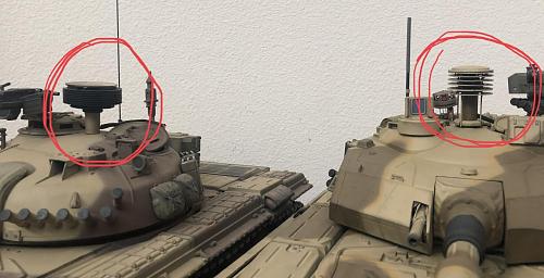

    Simple homemade “sunshades” for Heng Long 6.0 IR receiver.

      I understand the one on the right but what comprises the one on the left?

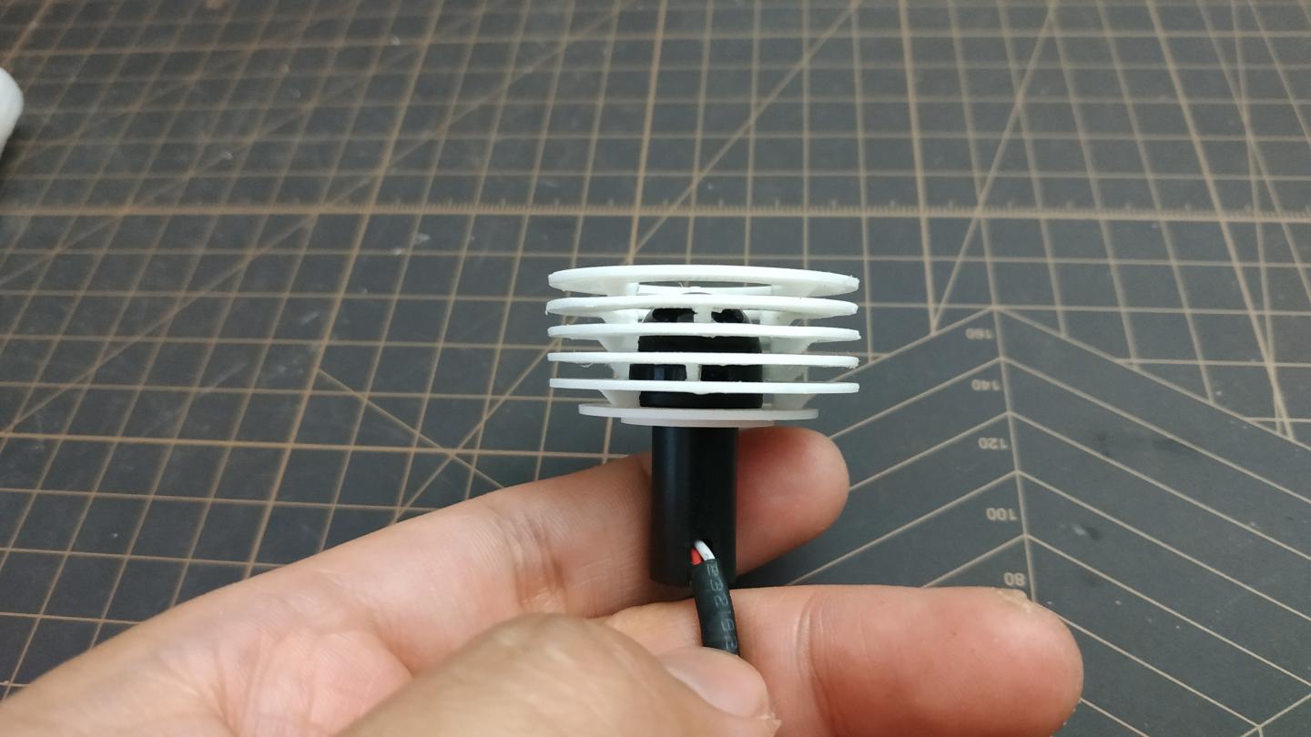

            The left one is comprised of thinner yet larger diameter “fins”. It was taken from a Tamiya IR receiver that was not being used. The left one is slightly more effective then the right one, the cost to make another copy is quite high and outweighs the difference in effectiveness.

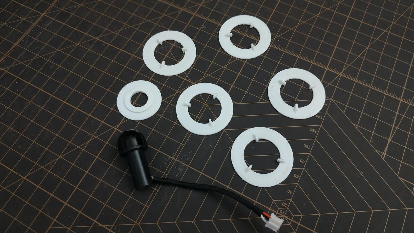

              I'll draw up a 3DPUP file for a sun shield that fits around Heng Long's TK6 receiver apple, then post it in the 3D File Exchange thread tonight. Users can 3D print it themselves. In the future I can look into mass producing it if/as the demand grows.

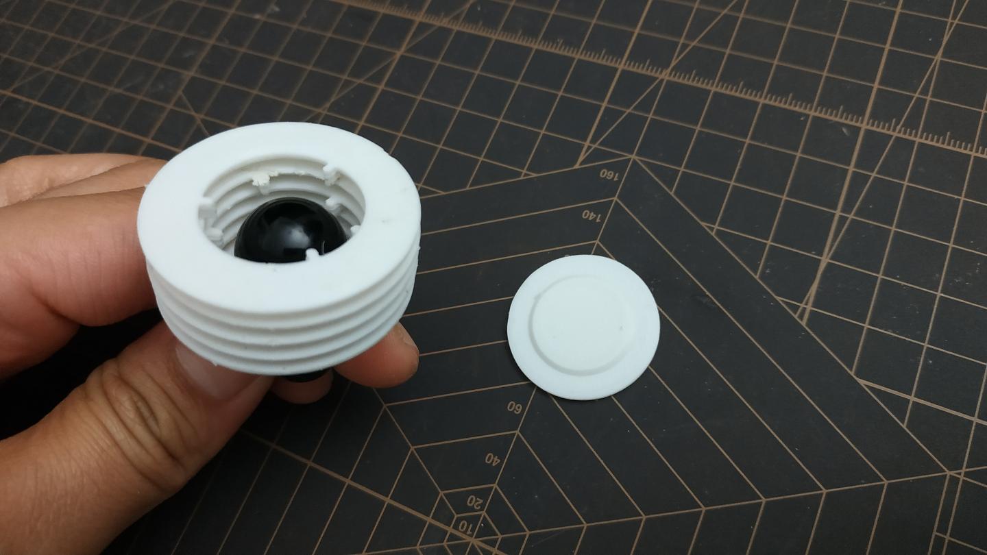

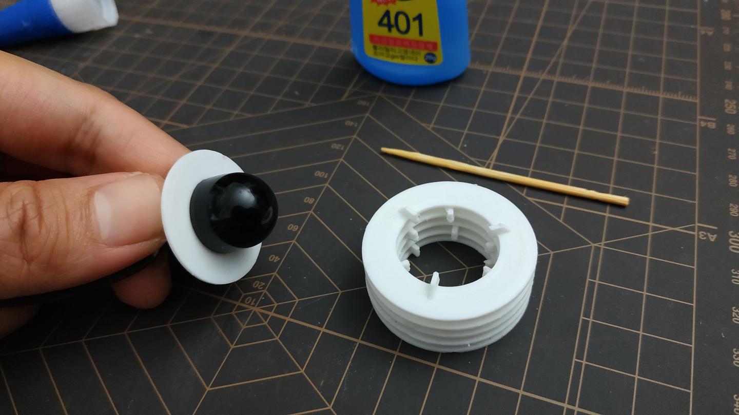

                  I threw this together tonight. Testing over the weekend. It's intended to house a reflector inside the cover, and uses angled slits to reduce overhead glare with minimal reception loss. I'll have to paint it black first, though!

                      Like RichJohnson I don't have a 3D printer so trying one out first hand is out of the question for the time being. Though based on the design and my experience making sunshades, I suspect it will work to greatly improve the IR receivers performance in direct sunlight.
                        I have come to wonder how I ever made it without my 3D printer before I got it. :woozy_face: Excellent work as usual Alpha!

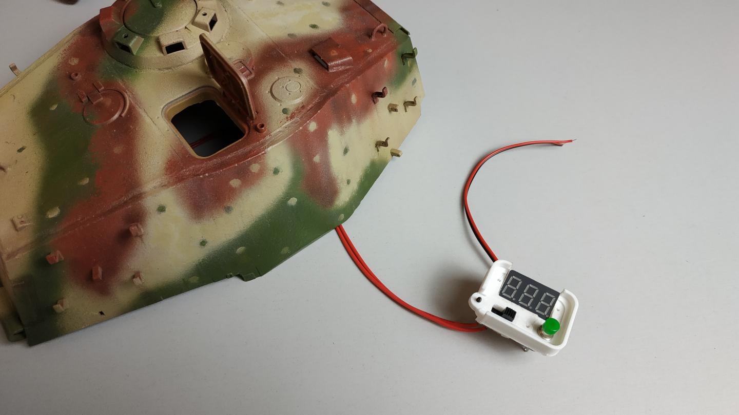

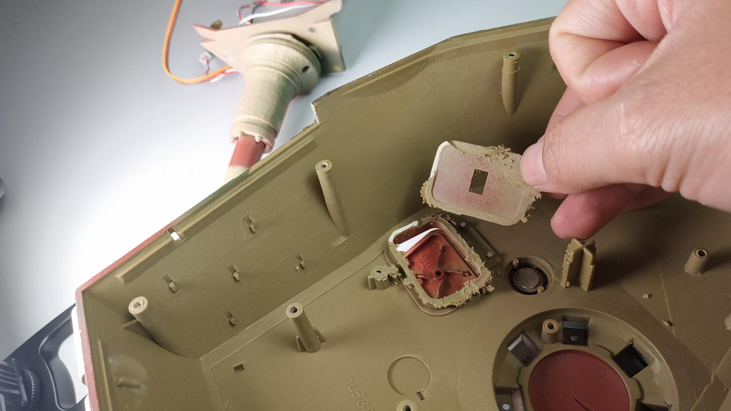

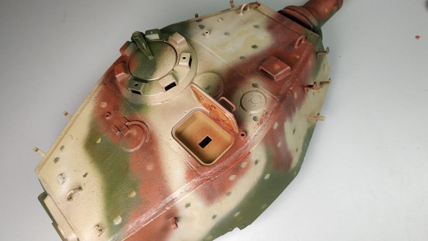

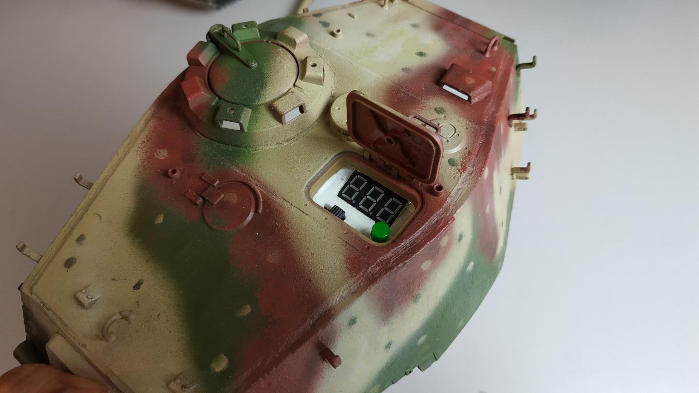

                            I drew up a combo plate for one of the hatches that incorporates an LED voltage indicator, a momentary actuator button, and a latching power switch. I'm printing a redesigned plate that incorporates an on-board charge port onto this area as well. It's much more convenient to open the hatch, tap the momentary button to illuminate the voltage indicator, then tap the latching button to power on the tank. This layout eliminates the need to invert this 11 pound tank every time I want to swap the battery or flip the power switch.
                            Click image for larger version  Name:	IMG_20200108_005005.jpg Views:	0 Size:	110.2 KB ID:	227526Click image for larger version  Name:	IMG_20200108_005402.jpg Views:	0 Size:	92.5 KB ID:	227525
                            Click image for larger version  Name:	IMG_20200109_011740.jpg Views:	0 Size:	83.5 KB ID:	227524Click image for larger version  Name:	IMG_20200109_011714.jpg Views:	0 Size:	97.4 KB ID:	227523
                            I will have to relocate the TK6's IR port into the commander's cuppola, which again, with 3DP, requires less than 5 minutes of design and ~20 minutes of printing.
                            I'll post these files in the Tank 3DP thread when I'm finished.
                            • RichJohnson
                              • 1276
                              Nice mod. Just dont charge Lipos in the tank. Too man times people have burned down their shop or the room the tank was in when the battery ran off and caught fire.
                              I have modded nearly every tank I have to get the switch somewhere accessible from the top and open the tank up for battery access rather than turning it over that risks breaking all the stowage and detail off.
