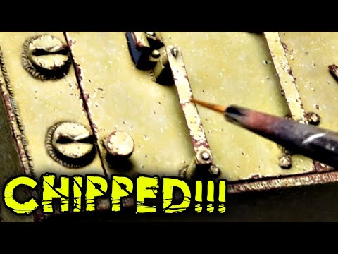

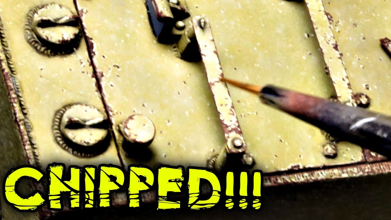

            • #26
              So how about some more info ?? How and when would you use it ?? I am totally unfamiliar with the procedure, but want to learn about it......
              • #27
                You put down the red oxide primer on a German tank let that fully cure, spray hairspray over it, it only takes a couple seconds to dry, then immediately spray on your base coat (acrylic), and let that cure for a few minutes get a toothgrush, wet it a bit and brush over the surface where you want to chip the paint, you can scratch with a toothpick as well to get say a gouge mark or more control to scrape paint off a specific detail. , how long you let the base coat of paint cure dictates how big the chips are and how hard youll have to work to get your chips, longer dry time up to about 15-20 minutes will net smaller chips that take more work to achieve doing it within a few minutes results in large flakes of paint coming off. , How it does this is the hairspray is also water soluble, but much more so than the acrylic paint, so once you scratch through the layer of paint the water wicks under the paint, spreading along the hairspray lifting it slightly and allowing it to be scratched or brushed away. after about the 20-25 minute mark, the acrylic is pretty much cured to the point were its almost impossible to scratch through and chip. It is important to use dissimilar paint/ and primer here because if you use both an acrylic primer and paint you risk reactivating the primer wet scrubbing like you do with this technique lacquer/enamels stick better to the henglong tanks for your prime coat anyway. Night Shift, the guy that did those 2 YT videos posted earlier is the freaking rust MAN, Ive spent evenings just watching his tutorials. The ones doing flame torch scoring on plates and epoxy putty welds, and texturing with Mr Surfacer are avbsolutely just brilliant

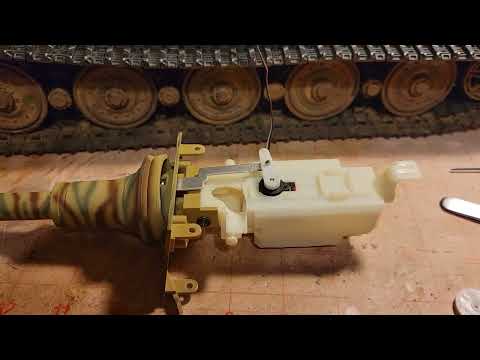

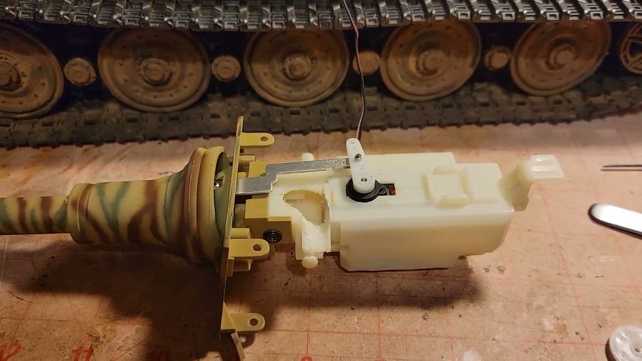

                        I also installed a servo driven recoil and elevation unit. More on this later… Subscribe to this thread for future updates!

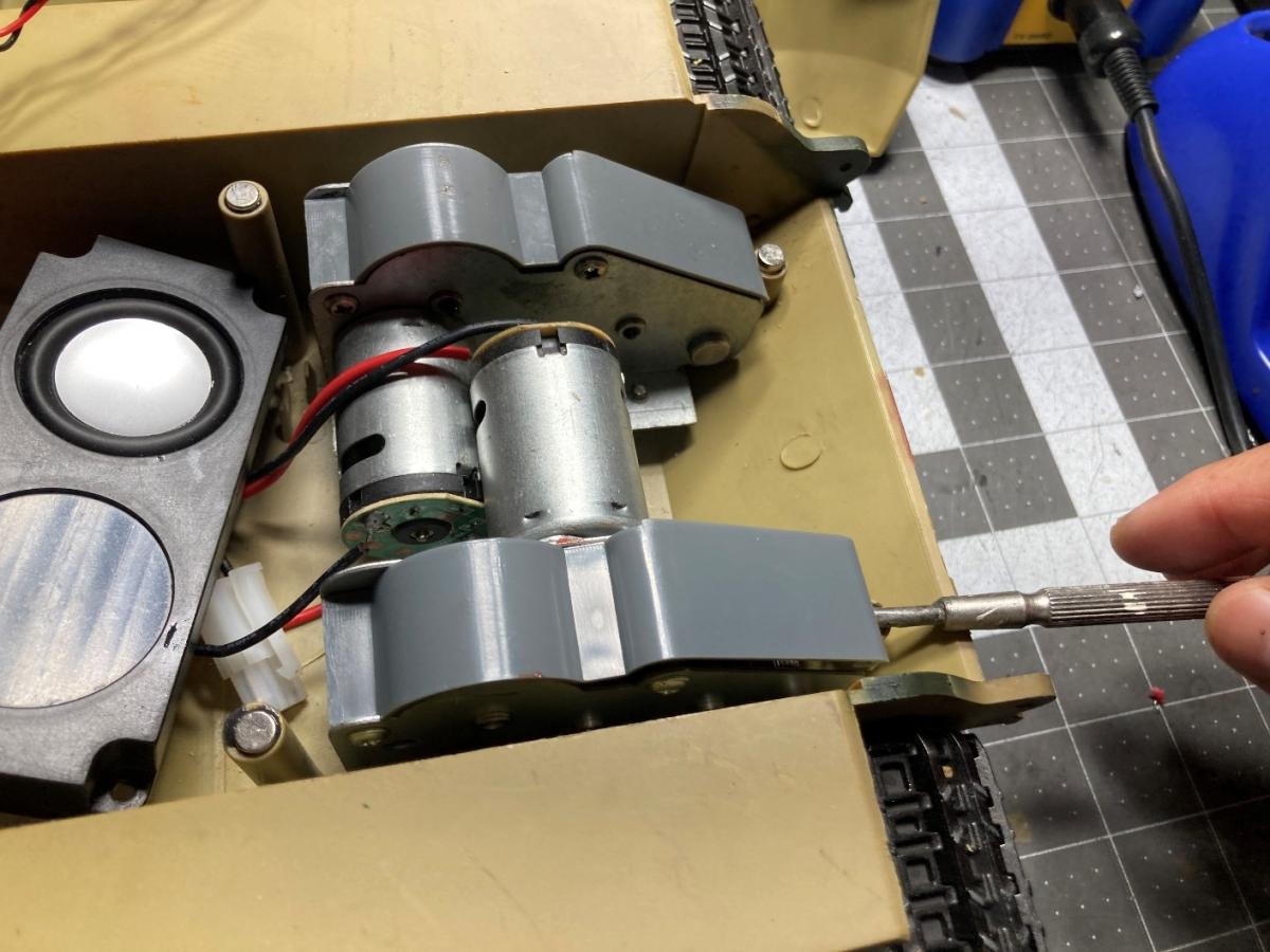

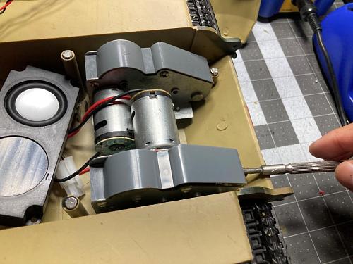

                            • #35
                              Just to confirm.....I use a screw driver to open them from the front
