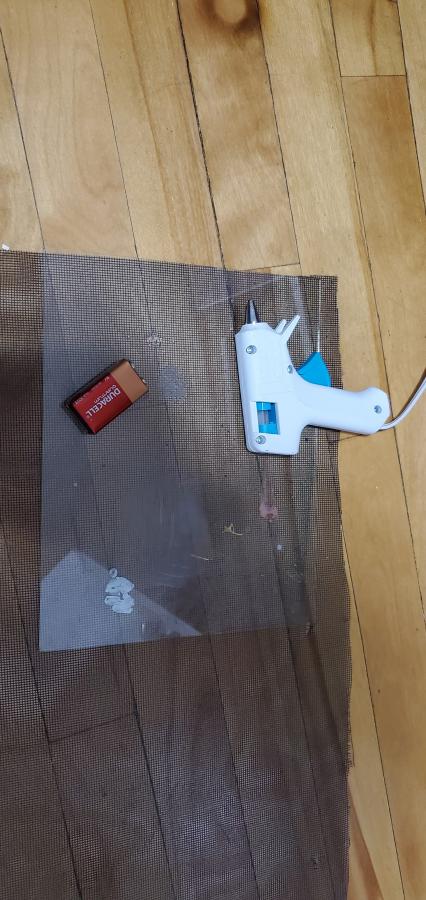

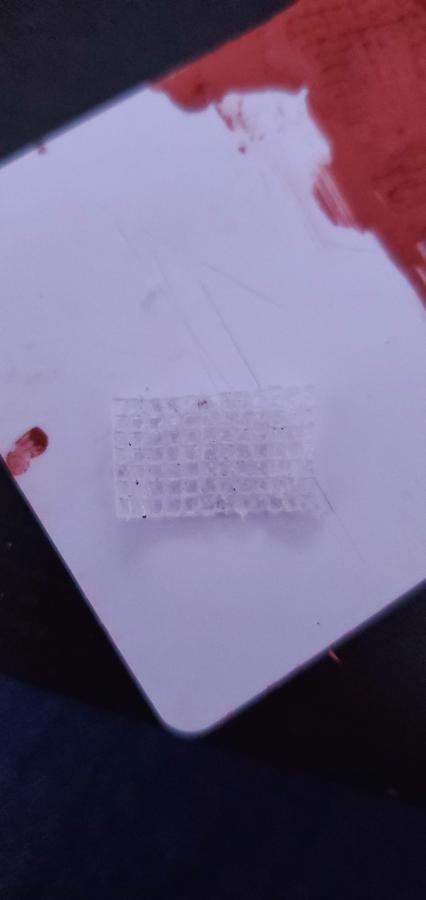

          Ok so tried and didn't turn out to bad.
          So to start you need a hot glue gun, a large flat surface, window screening, a large flat object to sandwich the glue and, lotion or something to stop the glue from sticking to your flat surface.

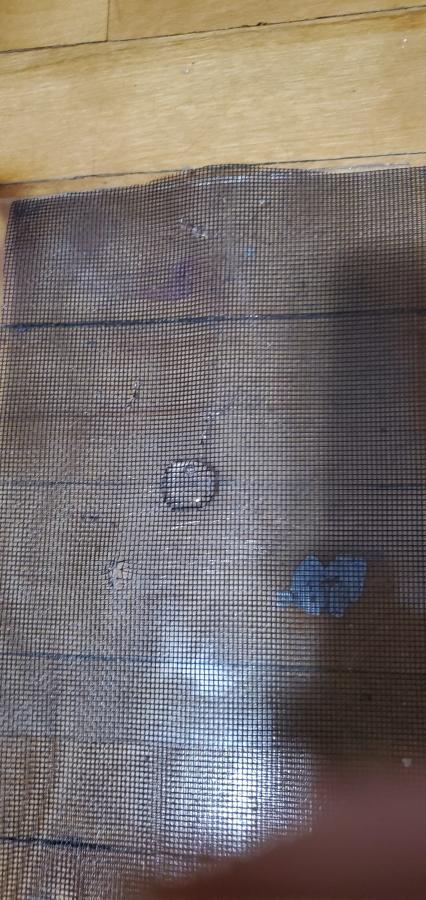

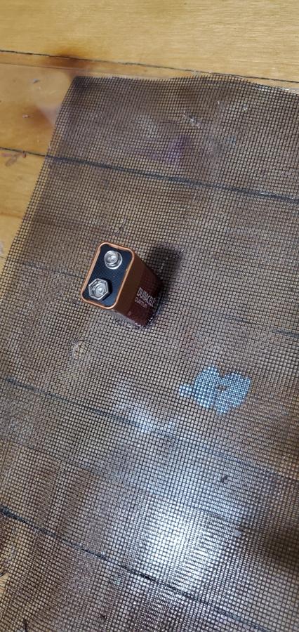

          next lube up the surface, lay the screen on it, and pour out some glue.
          Sandwich with the 9v
          Once the glue is hard peel off the battery and clean up overflow

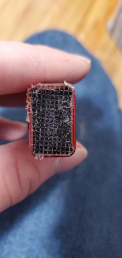

          now peel off the battery and trim the sides clean.

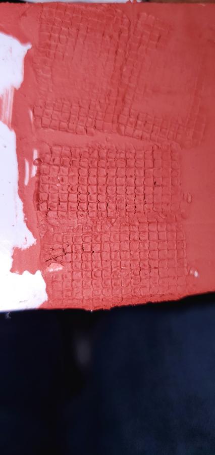

          Now put this on a stamp of sorts and go to town.
          Takes a few tries to get the the stamp to look good but it works.

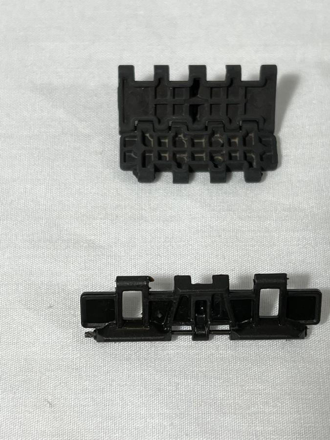

                I am thinking of buying the Tiger Tank and I was just wondering how much of a difference the color of the tracks of the professional and the upgrade are.
                If someone could maybe send a comparison picture of the tracks that would be great.
                Also I am aware that there is a comparison picture above, but it isn't so clear.

                  Welcome.
                  Ooooh I love me the Tiger I. The Upgrade version is black plastic. The Professional version is a off silver grey metal.
                  The bottom track link in the above picture is the black plastic version.

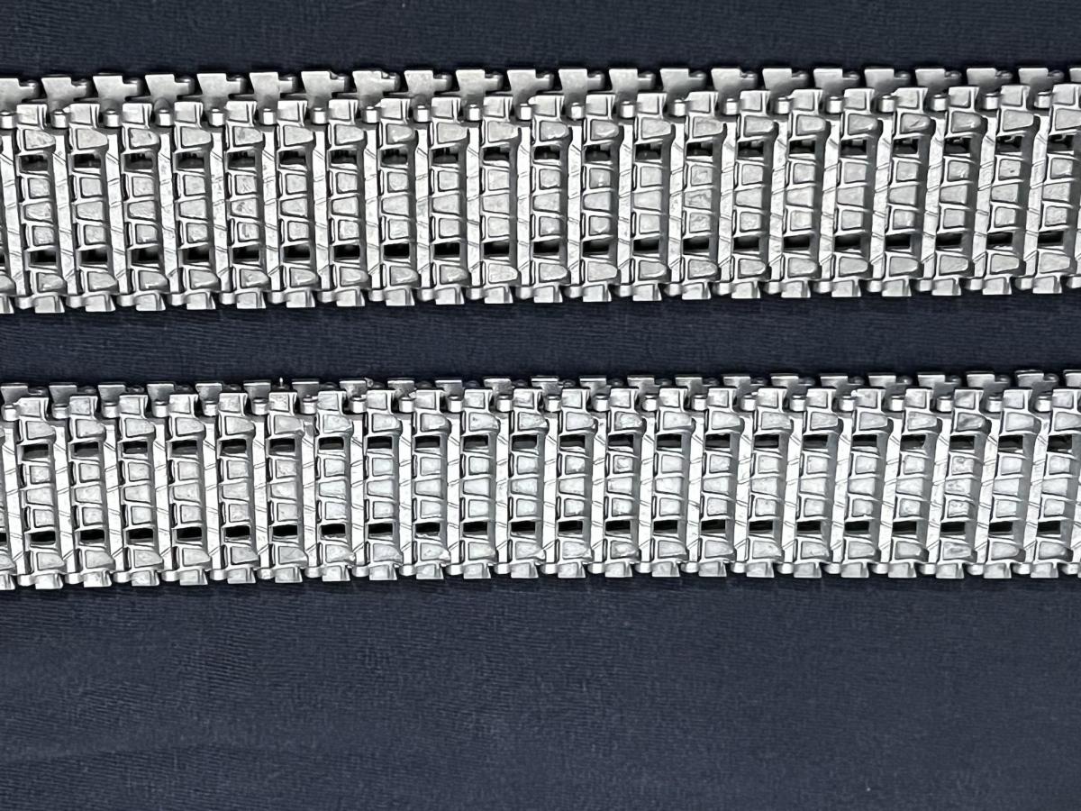

                  This above picture is the metal Professional version.

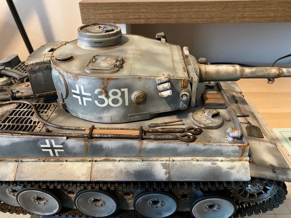

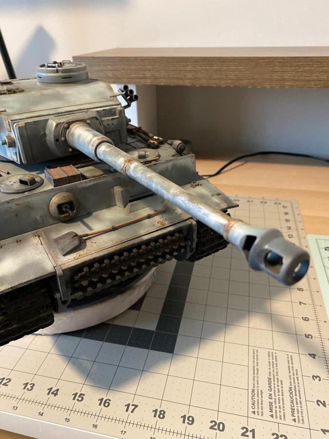

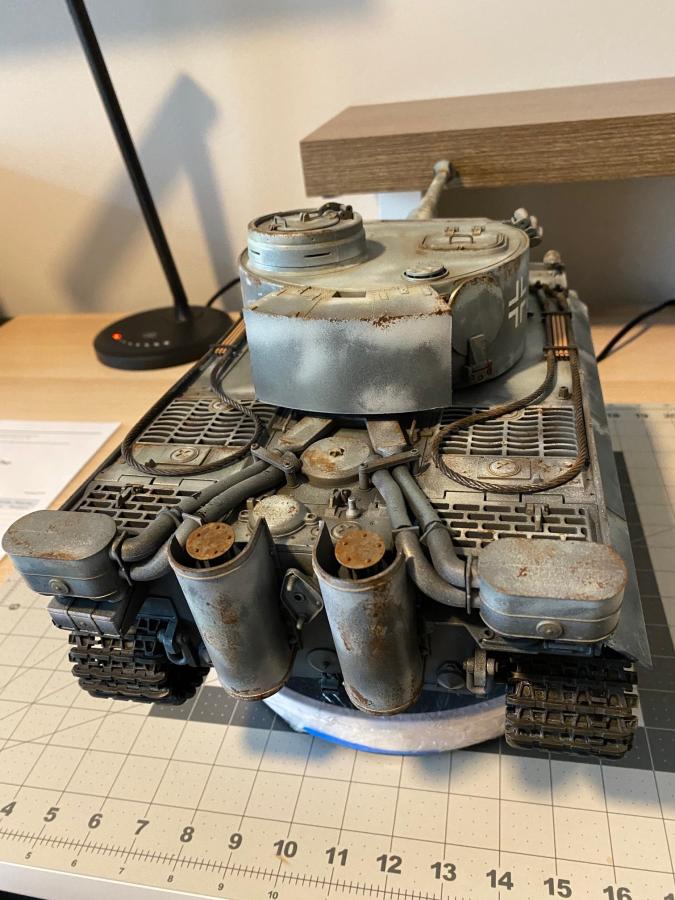

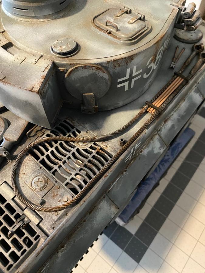

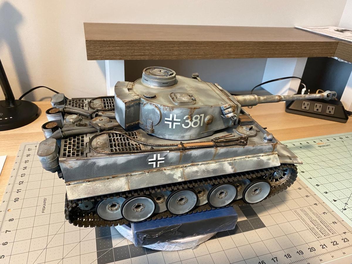

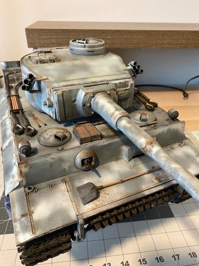

                      Finished weathered HL Tiger 1 Pro Version ready for combat.
                      • #31
                        RCAZDES20​, you've done some nice paint work and finishing there.
                            very nice work, i like the new paint job

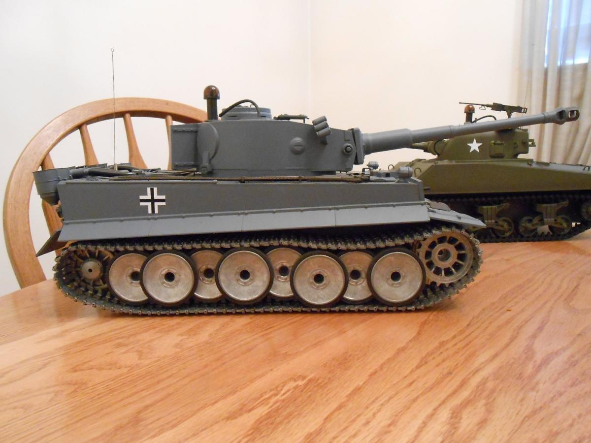

                              Hello fellow Tankers. I have a Tiger 1 Pro edition and want to paint the metal wheels. The Tamiya German gray seems too dark, what color paint do y'all think would be the best match? Click image for larger version

                                Think of this as an opportunity to upgrade your baby. Remove the HL decal, search online for some authentic decals, repaint the whole tank one color, apply the decals, then do some weathering. A very simple weathering step is to use some dry hobby pigment and brush it on.

                                  Welcome to the forum and the addiction,,,, hobby.
                                  The Heng Long Tiger I stock paint is quite blue. Tamiya doesn't offer a paint out of the bottle or can that will color match the Heng Long interpretation. It could be custom mixed. But at that point you'd probably just want to repaint the whole tank.
                                  Of course a lot depends on lighting so I tried to pick a picture with bright lighting for an example. This is Tamiya TS4 German Grey spray paint. It is Not a true Dunklegrau but it is a good starting point-
                                  I think you can see Heng Longs color is quite blue in comparison.
                                  • #37
                                    Vallejo Hobby Colour Panzergrau spray bomb. Cheaper than Tamiya and I'm a Tamiya fan, more accurate and if you feel it is too dark for your liking it can easily be moderated with a wash or pastels at the end. Bit if you are just doing the wheels then weather the hell out of them. Cheap and cheerful and looks great
