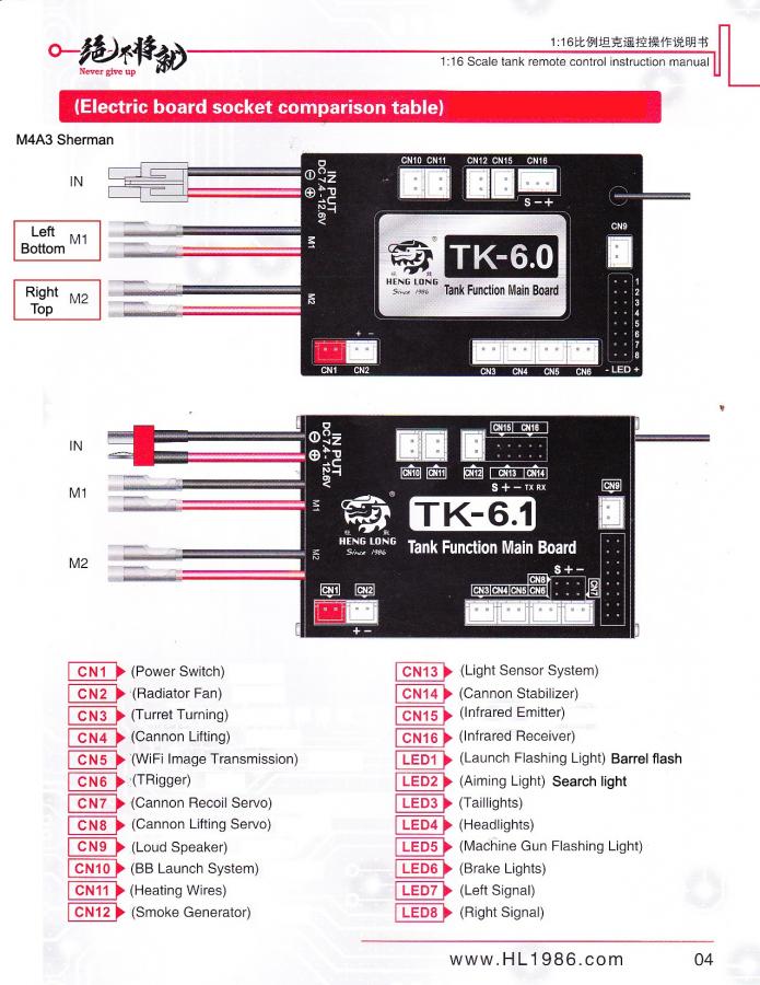

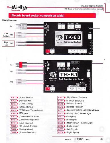

                                I had to replace my main board in my Sherman and I thought I installed everything as it should be but now just the forward and backward are reversed. I scoured all the manuals looking to see if you can reverse the right stick function and it seems someone pointed this out at one time but I'm at a loss. Did I just connect the MFU motor wires to the wrong motor M1 vs M2? I have the right (top) motor as M1. It steers correctly left and right just forward and backward on reversed.

                                  I had to replace my main board in my Sherman and I thought I installed everything as it should be but now just the forward and backward are reversed. I scoured all the manuals looking to see if you can reverse the left stick function and it seems someone pointed this out at one time but I'm at a loss. Did I just connect the MFU motor wires to the wrong motor M1 vs M2? I have the right (top) motor as M1. It steers correctly left and right just forward and backward on reversed.
                                  Stock or upgrades motors? Try swapping around the red and black wires to each motor.

                                    Stock motors. I'll try swapping positive and negative and hopefully won't mess up left and right turning..

                                      Swapped the positive and negative wires and forward and reverse was correct but turning was backwards. So, returned wires to correct positive and negative but switched leads between motors and discovered for stock Sherman setup M1 is the left (bottom) motor and M2 is the right (top) motor. Will make notes in my Heng Long cheat sheet..
                                      Click image for larger version  Name:	HL_TK6_61_MotorWires.jpg Views:	0 Size:	100.5 KB ID:	252671
