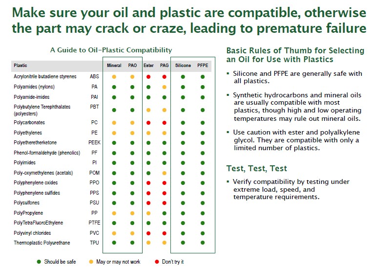

          For plastics (ABS), any PTFE or Silicone lubricant is safe. Lots to choose from and cheap.
          From what I've read, "ester and polyglycols " based lubricants are NOT safe for ABS. So also be careful of what you use on your steel gears in an ABS hull.
