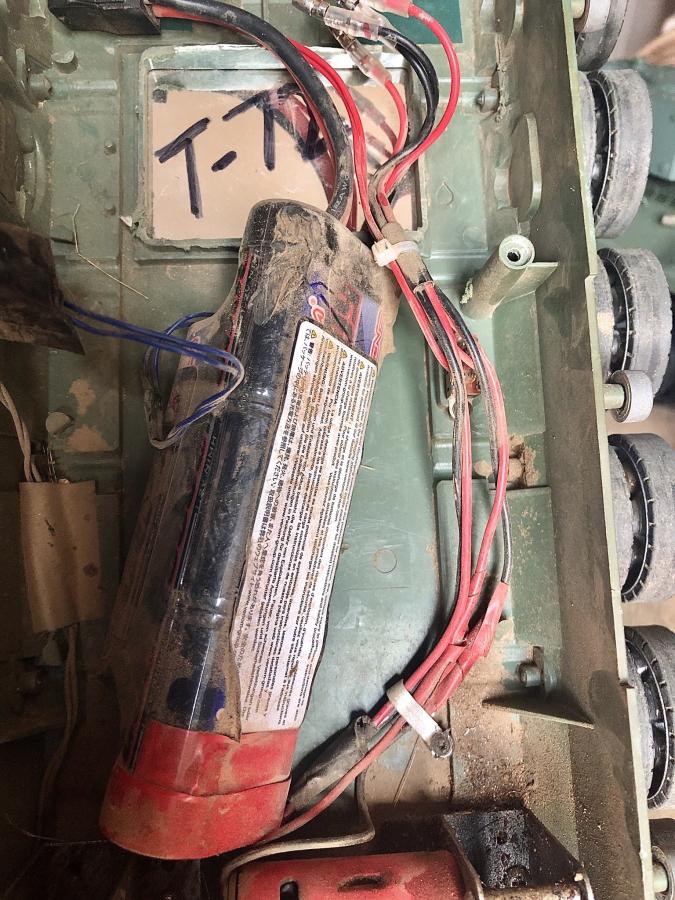

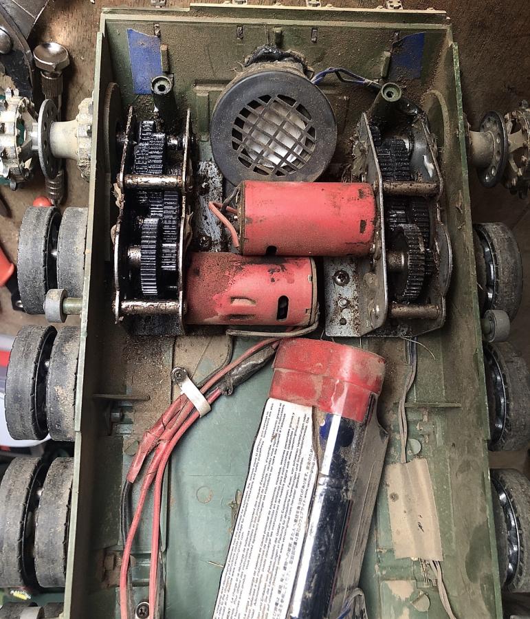

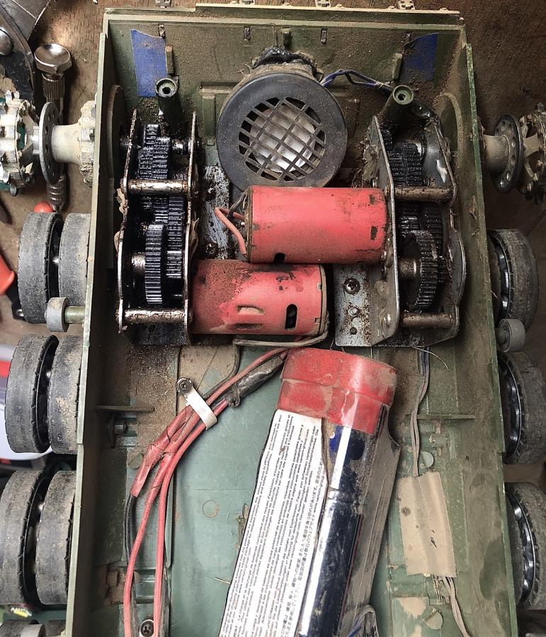

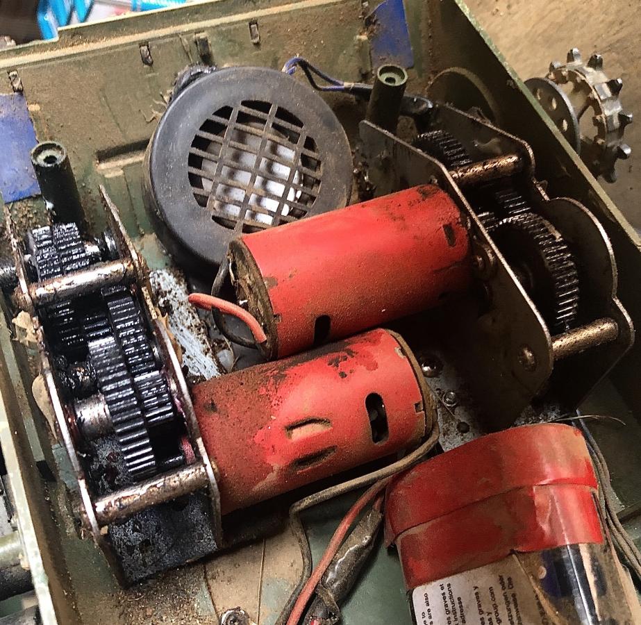

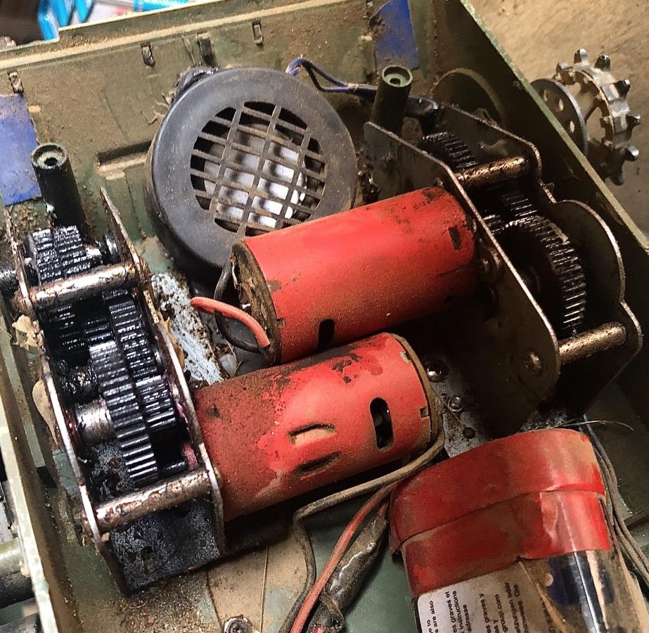

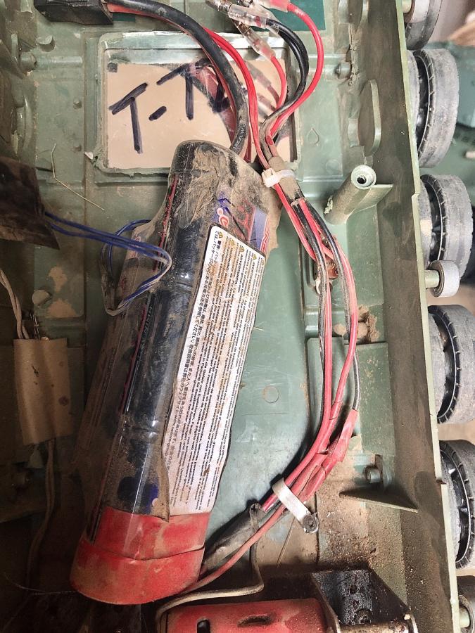

    Now about six months into its life in my fleet and easily 50+ hours of running, it was time to pop the T72 open and inspect everything. For the most part all was good with the small exception of a crack on the lower hull glance at the idler wheel mount(not good but repairable) and a hull full of dirt and pieces of dried vegetation. Don’t ask I have no idea how they got sucked inside...lol.

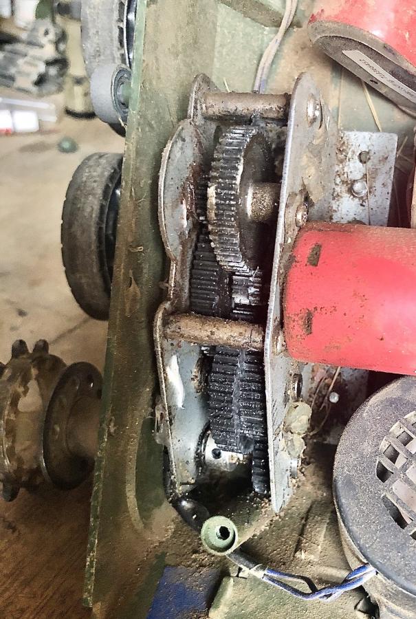

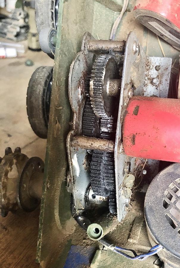

    For cleaning I simply grabbed a vacuum and sucked most of the dirt and vegetation out. After that I re-greased the gears and repaired the hull crack. The photos below show the inner hull and gearbox after the vacuuming and re-greasing. You can see there is still a fair amount of dirt and some minor vegetation still left inside. The presents of which possesses no issues and the tank will run perfectly. Point is these new 6.0 tanks are rather durable and though they will get dust, dirt, sand and the odd vegetation bits inside, it has little effect on them.
    Below are photos of the T72 inner hull and gearboxes. Please understand this tank has had a number of modifications in order to fit the rather larger battery which is fixed in place. These modifications were covered in another thread. Also everything shown was brand new six months ago.

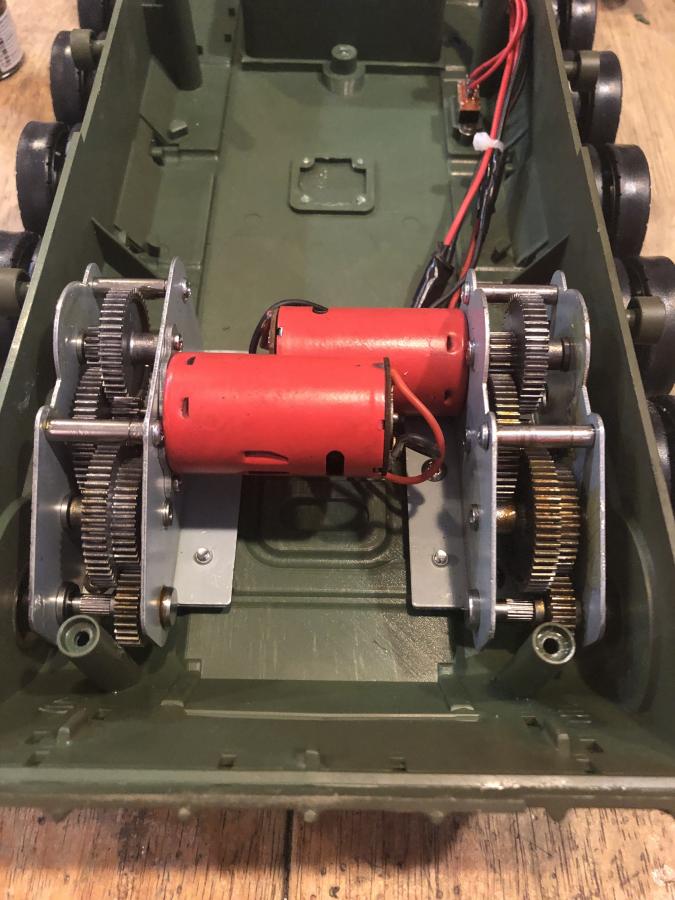

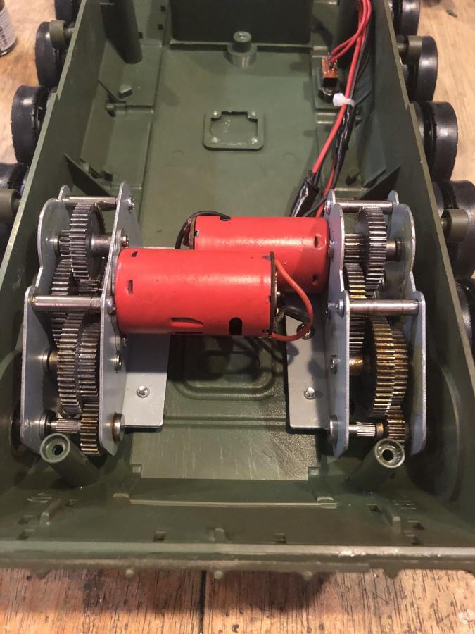

    VVVVV....Below when new for comparison......VVVVV

        Originally posted by Beeg
        That is nasty. Are those the stock HL gearboxes?
        Could you expound on track tensioning and maybe other regular wear/use adjustments? Bearings, bushings, bogies, shock springs, etc?
        Yes those are the new stock steel 6.0 gearboxes. All the tanks being sold by Motion RC comes with them standard. They are rather tough and quite forgiving to dust and dirt. I run them fairly “wet”. Some will disagree with me on the level of “wet” but until we get gears with a fancy aerospace coating like NiB and such. Wet is it for me and what I recommend when asked. Haven’t ever had a failure caused by or related to “wet” gears. They can be a bit messy at times but it tends to add to the overall grimy effect I like on my tanks.
