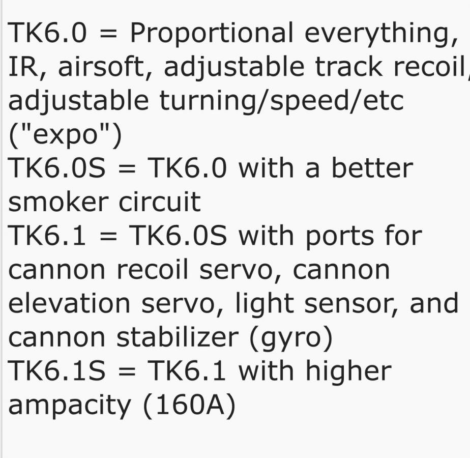

      The 6.0 “S” is for the higher power smoke unit that is in some of the factory upgraded versions. Alpha posted the below on another forum.
      Click image for larger version  Name:	5D23FA1E-BCEB-488B-9C77-F6EB9297AE97.jpeg Views:	0 Size:	98.3 KB ID:	250579
