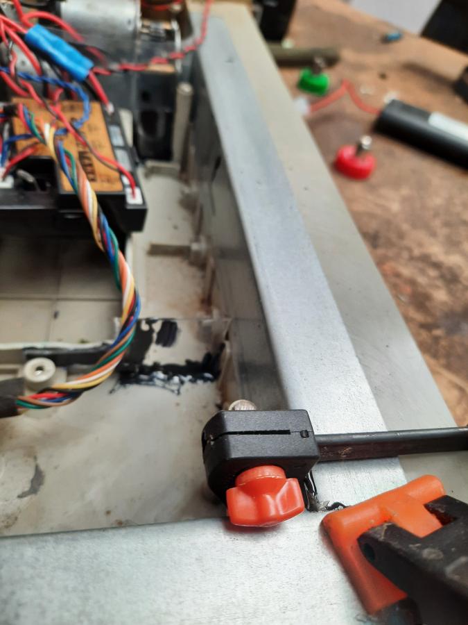

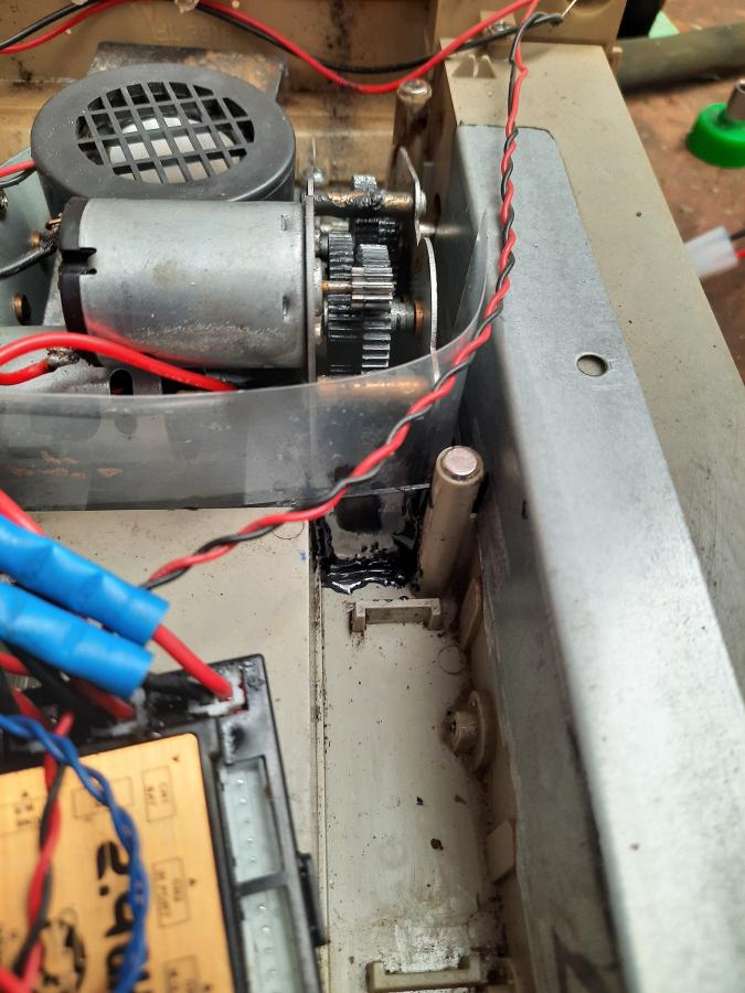

Had a idea bout keeping water from the mfu, what do ships have to stop water going from one end of the hull to the other? Just what you have here, water proof bulkheads. I don't go quite as crazy as to submerg the glacis so I thought all I needed was something to stop water getting to the mfu and here it is. I know it is water proof cause once installed I filled it with water and it didn't leakComment
