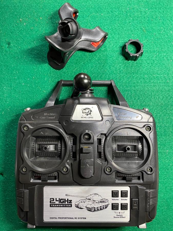

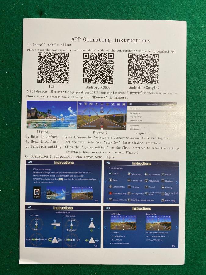

                          Hey guys, my tank arrived three days early. How often does that happen? Anyway, I'll share my first impressions. In the box, the controller has an extension arm screwed onto the top. A phone holder bracket is included, to attach to the arm and grab your phone. Looks like it is original equipment, since the box had its original seals intact. As I'd noted before, there is a socket on the main board intended for WiFi. A single sided sheet contains the instructions; basically use a QR Code to download an app, in my case an iPhone 11. It loaded and runs fine. Once loaded,turn on the tank and pair it in wifi settings. Standard stuff. So, good news and bad news, the good first. Picture is superb, and this is from a miniscule 8mm square camera mounted on the front of the right hatch. The app has many functions which I haven't explored yet, included possibly controlling the tank from the screen. Not that I'd want to, I guess. Recording, all sorts of stuff. The picture was upside down to start, but I quickly found a button to right it. The bad news? Yep, a lot of lag. To be fair, I haven't really worked it much, because the tank battery was low. I will keep you apprised of what I learn. I do know that some cheaper drones use a wifi fpv system, so maybe it'll work out.

                          Oh by the way, the upgrade included a 360 degree turret, not a necessity but nice to have. And the sound! What an improvement over the first generation HL's.

                              I played with the WiFi a little bit. A lot of the features of the app aren’t used with the tank, it’s a generic app used by other products. It does work, doesn’t have so much lag it can’t be used, but range can be a problem. It has about a 30 foot range, enough for inside the house or the backyard, but not a big battlefield. IMHO, it’s virtue is for tankers who don’t have video equipment or don’t want to wire up components. Cool though!

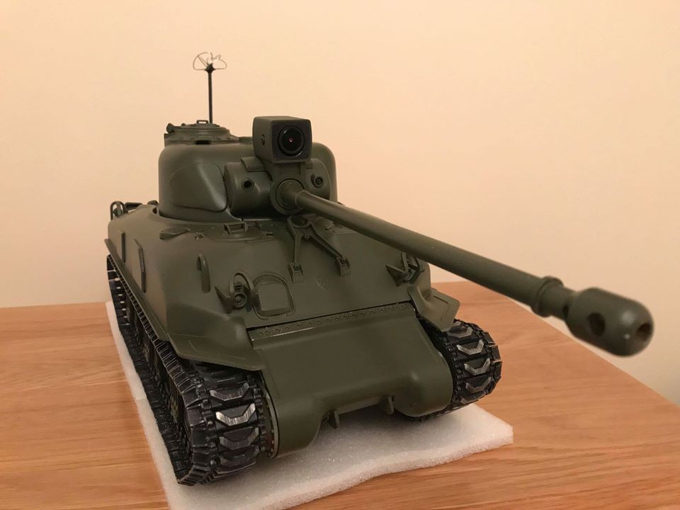

                                  Here’s my FPV Firefly 90% finished, I haven’t posted any videos as I forgot to order the microphone so no sound affects. As the camera and VTX are all in the turret it only needs a power lead running up from the main battery or if you have room and access in the turret a tiny lipo will run the FPV gear if needed. You can get small all in one units as well which can be just mounted on the turret with Velcro which give better video than a WiFi system. With the march of the new HD systems the old analogue goggles, VTX’s and cameras should be dropping price and as many convert over 2nd hand bargins may be found on fleebay etc.
                                  Just by way of an update, the microphones turned up but I’ve found it impossible to get the sound quality right. The microphones pick up every little bit of electrical noise from all the brushed motors and static from the FPV feed so I am now going to look into using something like the RunCam2 which I k ow works well from my FPV trucks but the big drawback is the size.

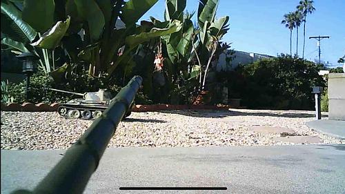

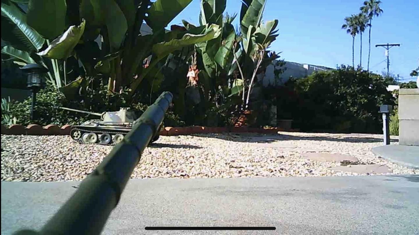

                                        It’s a shame, because the picture is impressive. This is a still. The video is of this quality, but maybe 20 FPS.
