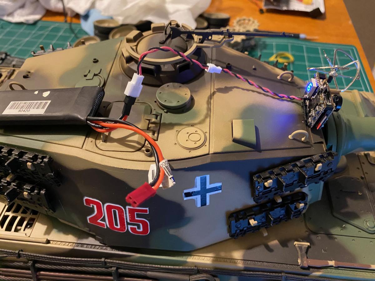

        Was disappointed with the range. Not with the FPV but rather the tanks. They are low power RC systems so 60 to 80 feet is all you get before the tank stops.
        Here was my system set up on my King Tiger.

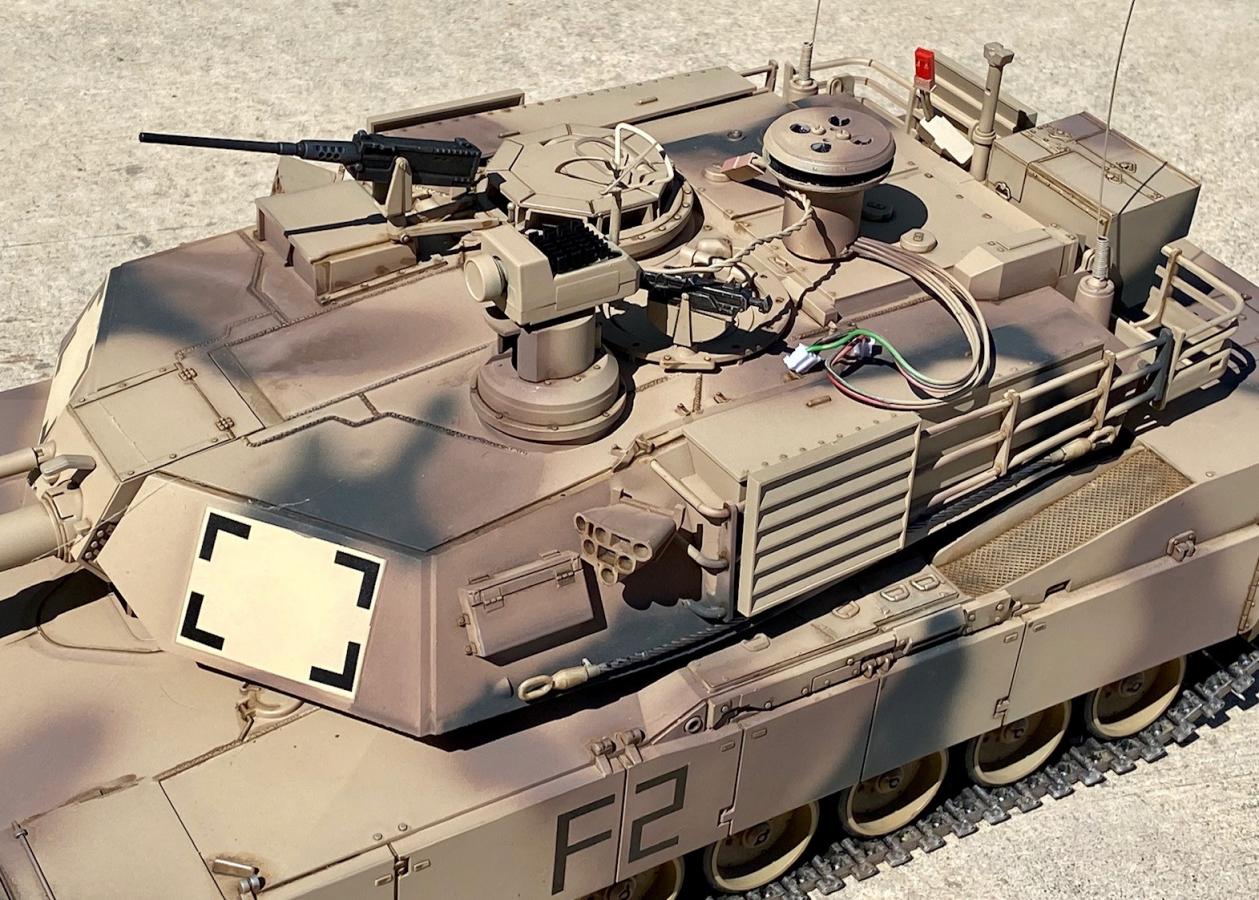

          Nice King Tiger. Maybe I need one!

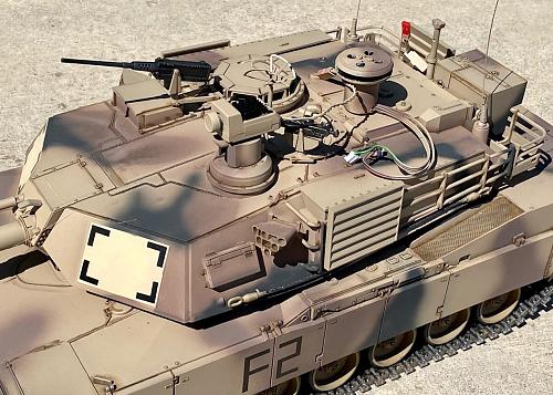

          I put this FPV setup on my Abrams. i use a one cell battery, which keeps the unit from getting too warm, but limits its range to.....wait for it....60 to 80 feet, same as the radios!

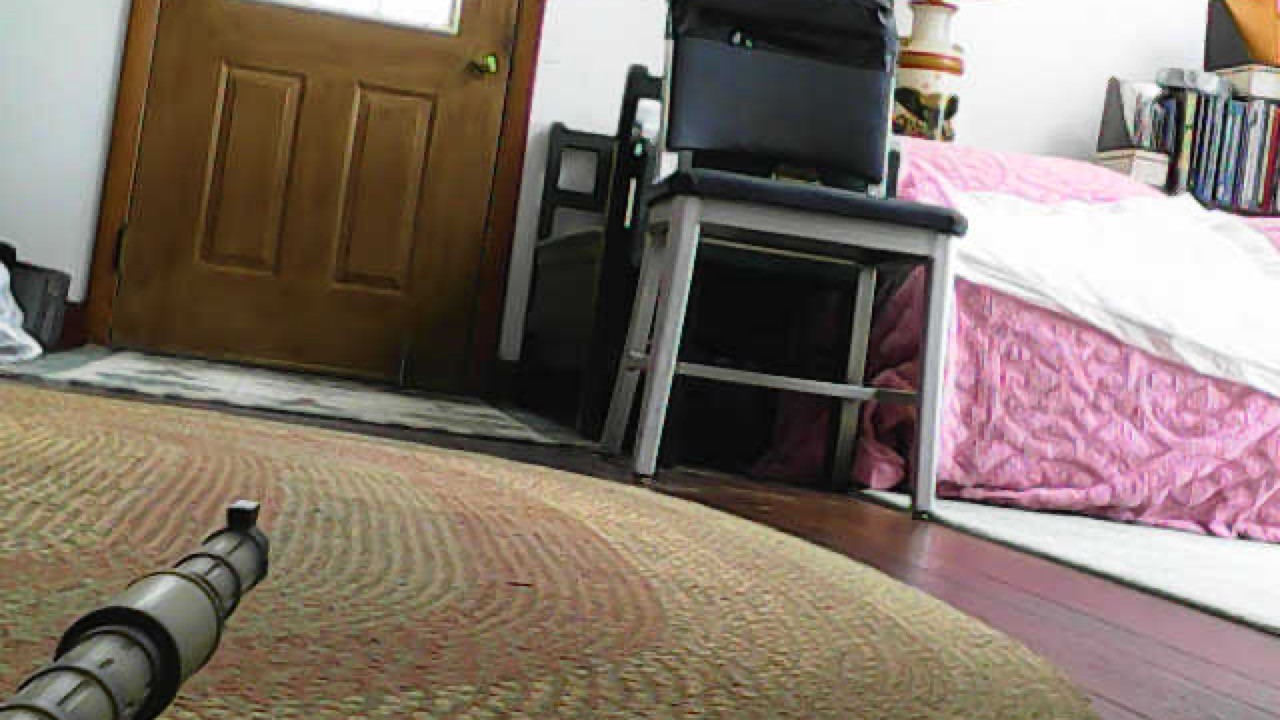

                  A bit more experimentation with the fpv camera. Facing double, sliding, all glass patio doors with dim sun on fresh snow outside made other objects in the room rather dim until I turned the tank away from the bright light. Color seen through the camera is on the warm side, white surfaces being yellow toned.

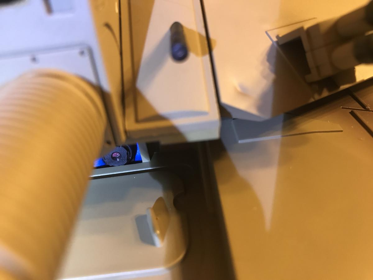

                                    Here are a couple pictures showing how unobtrusive the cameras I am using are. One in the drivers view port and the other in the commanders primary sight. The actual lens is only about 3 mm across, so it could probably hide behind an opening that small if needed. Click image for larger version
