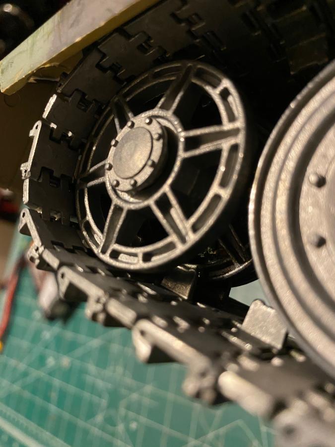

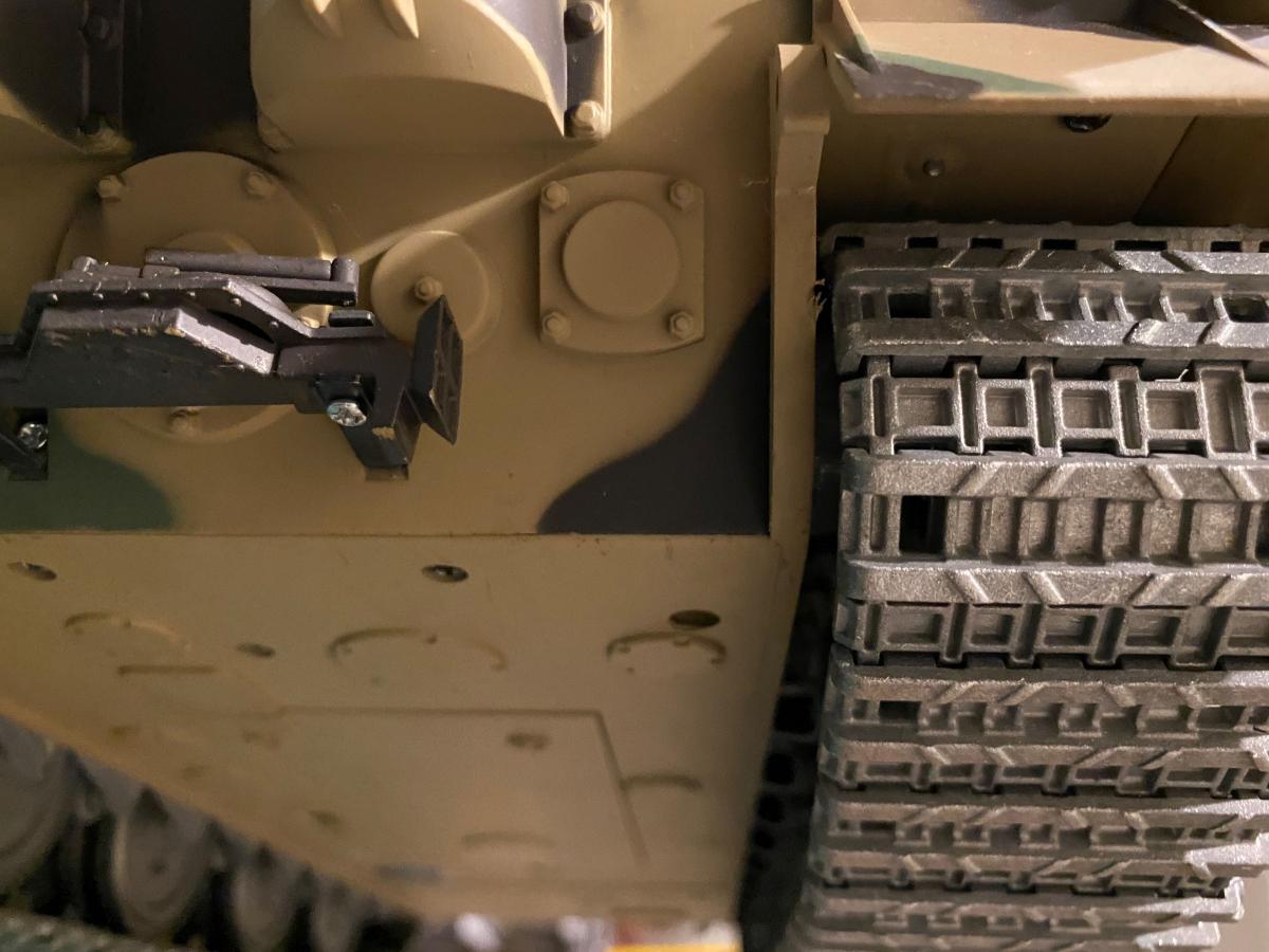

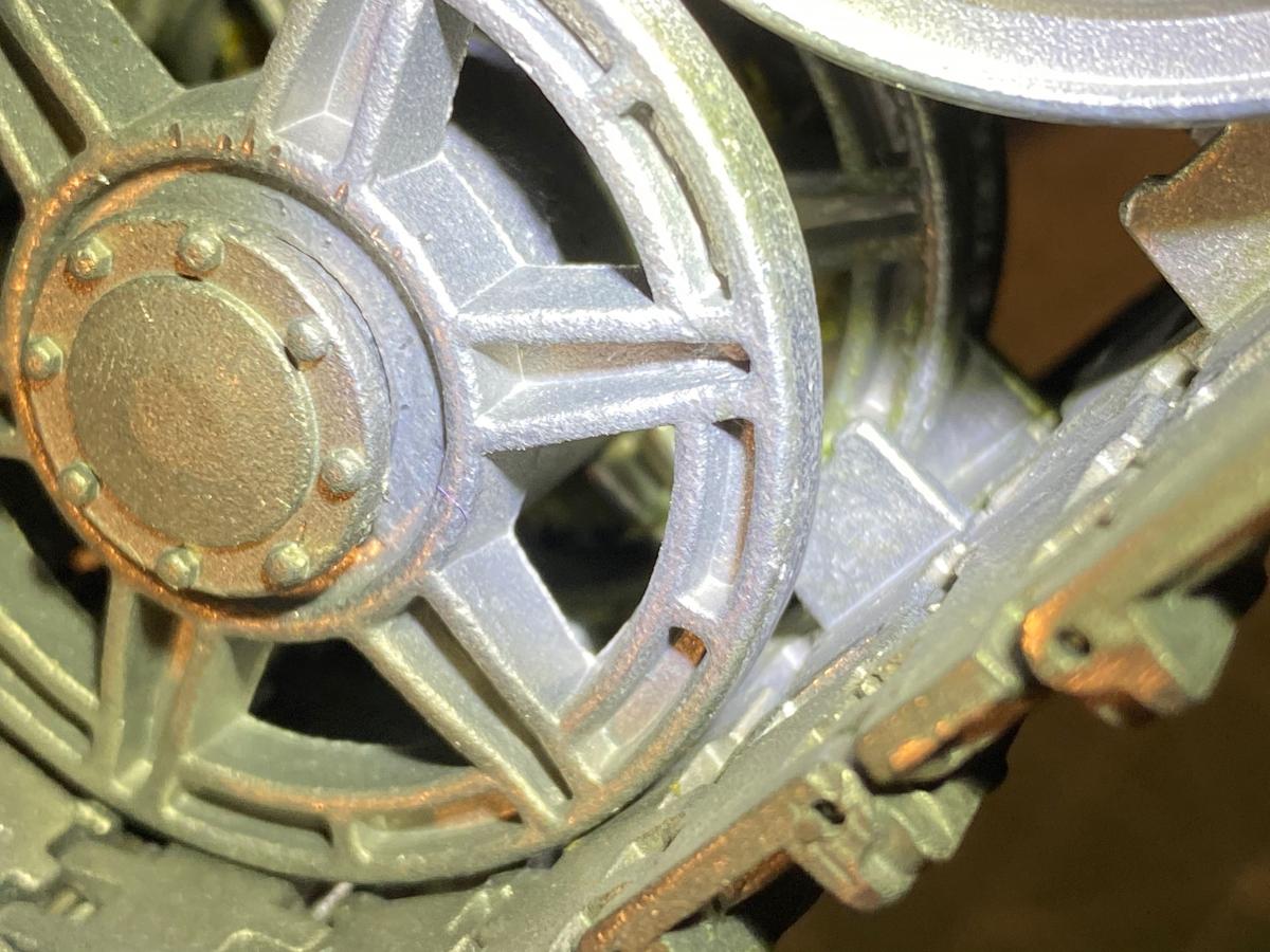

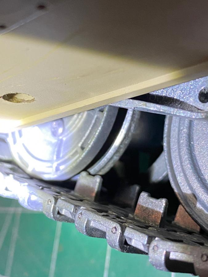

          So it was on mine. But only on one side. It would seem that it was installed wrong at the factory. Here is how it should look. See the images.
          • #25
            Apparently it was a factory error. I fixed it after I saw your posting. I also noticed the idler overlaps the nearest road wheel on the right side, but not on the left side. I don't know if I can do anything about that. Great close up shots, by the way !!

                Do you know if it's OK for the idler to overlap the edge of the nearest road wheel ?
                • #28
                  The idler should not overlap the road wheel. However, the main drive sprocket does. Can you post an image? Make sure all the road wheel suspension arms are tightened down all the way.
                  • #29
                    It is just a very small overlap,. maybe 1/16 of an inch. probably not a big deal at all. Might be able to adjust it out by using the track tension adjuster, if you think I should, or perhaps just leave it alone because it runs just fine as is.
