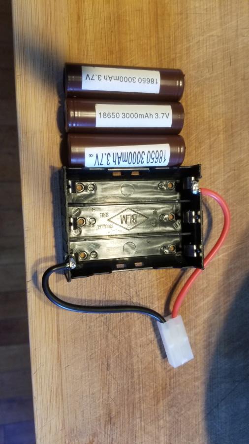

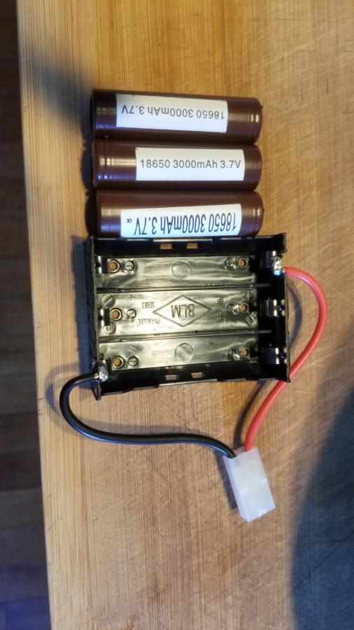

                I've just purchased the parts to convert my tank from using battery packs to a 3S 18650 battery box that I will be able to just pop the cells in and out without having to deal with the connector or packing the connector wire into the cramped T90 battery compartment

                        Got my 3S 18650 holder in today and wired it up, MFCB did not let the bad smoke out and the treads were turning what seemed like twice as fast, unfortunately I didn't quite get my measurements right and I'll need to expand the battery bay by about a quarter inch Click image for larger version

                            Just a friendly warning. At the voltage you are running (3.7 x 3 = 11.1 = ~12 peak volts) you will have rapid heating issues of the MFU and motors greatly reduce their life. If you compound this with higher performance 390 motors you will fry the 6.0 MFU.
                            Now if you swap over to the 6.1S MFU you should be fine as it has much higher power ratings and can handle the higher volts a bit easier.

                              If the main issue is just overheating the components on the MFCB has anyone tried to remediate that by taking it out of its assembly and adding some high efficiently thermal compound and extra passive heat sinks to individual components that are running hot?

                                It’s rated a maximum of 12.6v but at that voltage it gets screaming hot very fast. Anything over 10v is really a waist as the performance difference is so minor regardless of stock 380 or red 390 motors. Cooling fans on the MFU and motors are all but useless unless the internal hot air being generated by running at over 10 volts can be vented out and cooler outside air let in easily. On most tanks this can be quite a challenge if you wish to hide the intake and exhaust openings.
                                The 6.0 MFU IMO is just not worth tinkering with beyond cooling fans. It will ultimately end up costing about the same or more to install and test(?) a cooling system then just buying the upgraded 6.1S system and swapping it in.
