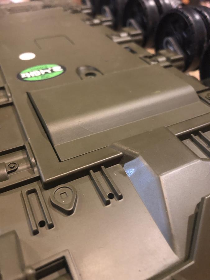

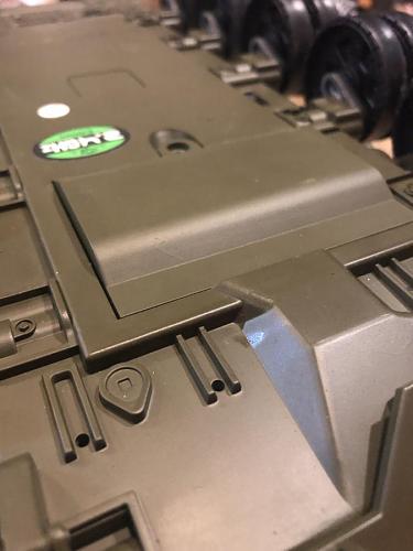

        The new 6.0 T90 has a different lower hull then the older 5.2/3 T90. If your battery box door is more then 4” long and runs longitudinal with the hull, it is an older hull without the new idler adjuster.
        Below is what the new 6.0 T90 battery door should look like.

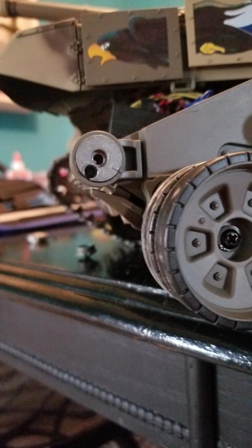

            After removing the track and the idler wheel this is what I see
            I just wanted to make certain that this block is meant to rotate and adjust the position of the idler because it does not move easily and I am worried about breaking the hull of I try to force it
              Yes that is the idler adjuster.

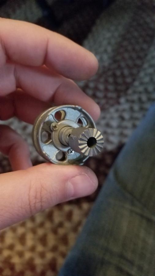

              • #8
                Ok, here was the missing piece, the idler must be pulled straight out slightly before it can be rotated
                      Yes you can pull it all the way out but you don’t need to. Just lift it slightly until it turns and you feel the ratchet groves moving over each other. Once in the desired position push down lightly and you should feel the groves lock/engage together. Once this happens tighten with screw.
