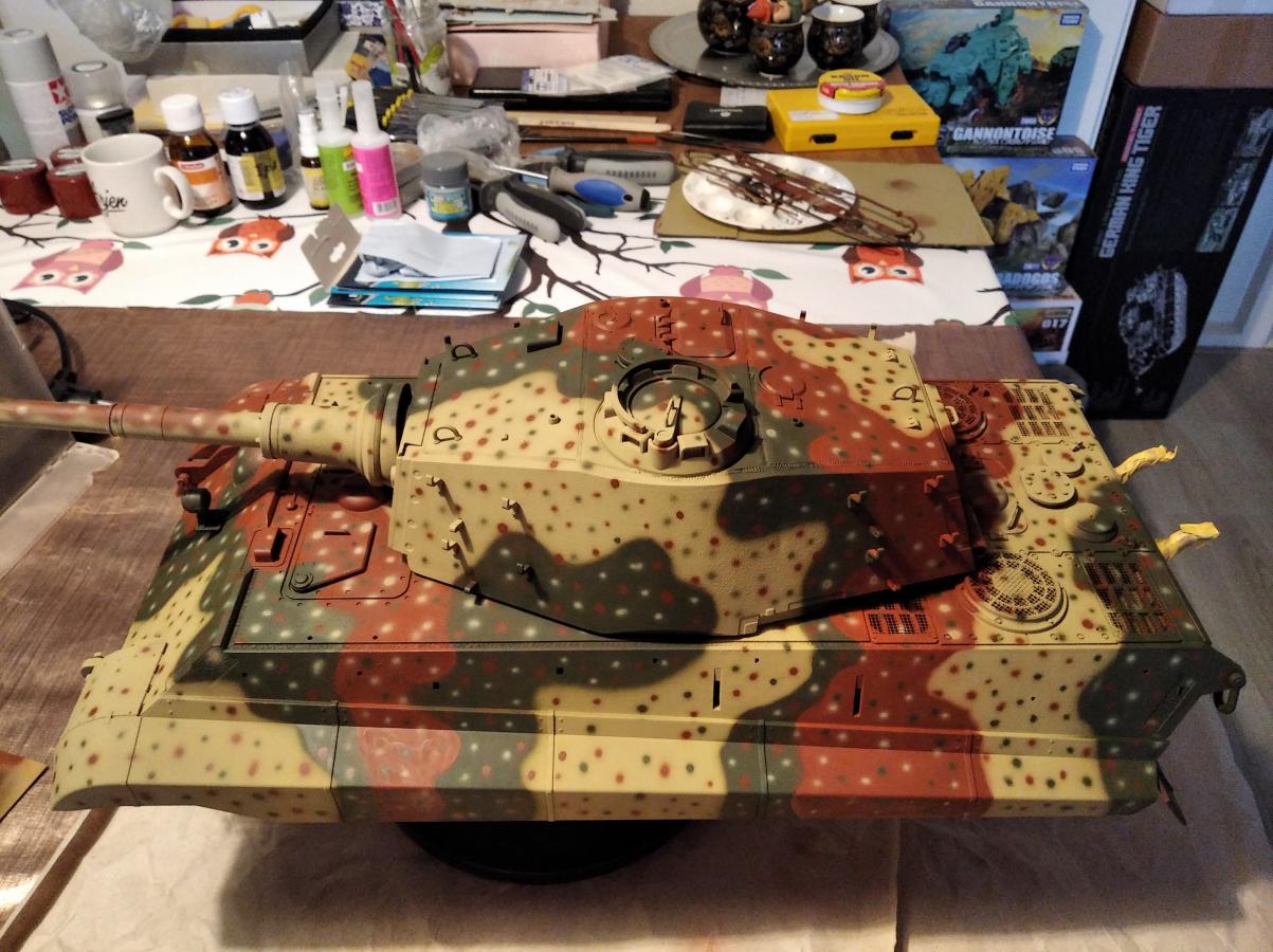

                                    Today I airbrushed the flecktarn camouflage. Took the better part of the day.
                                    Now I also know why the Germans really lost the war: They were too busy painting their tanks.
                                    • #19

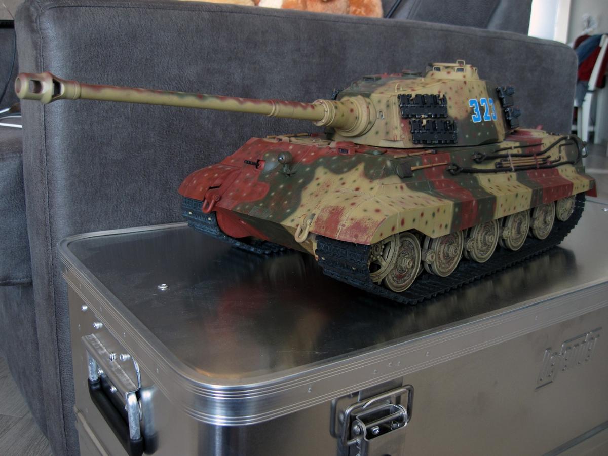

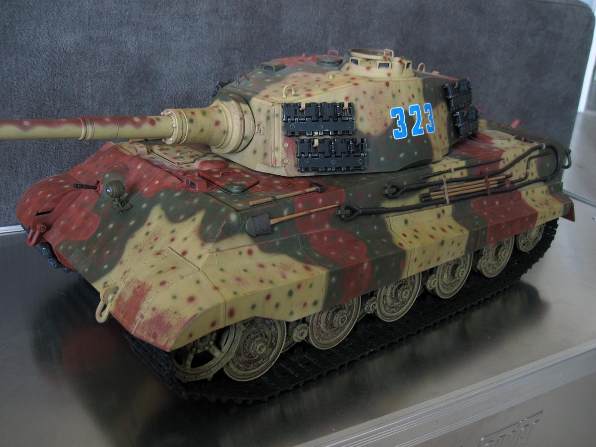

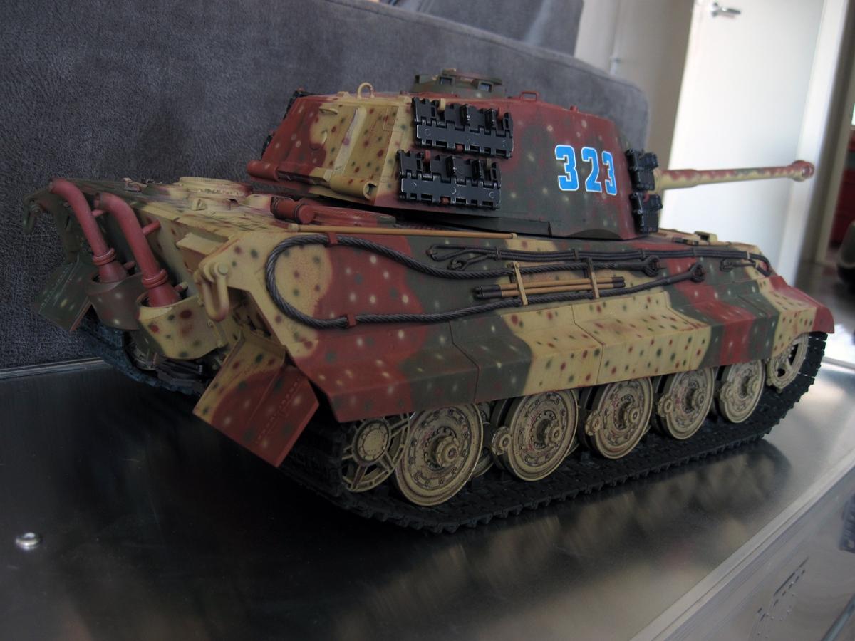

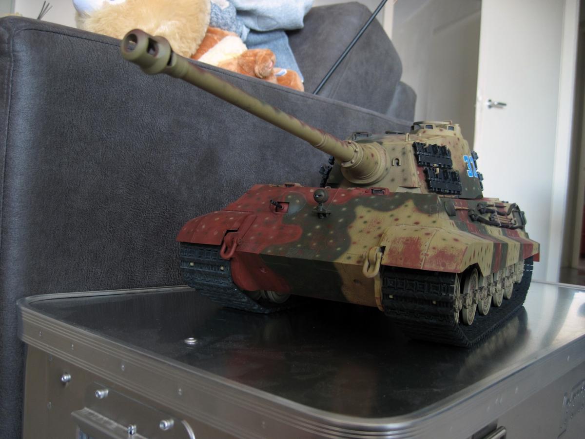

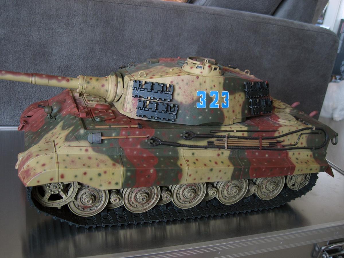

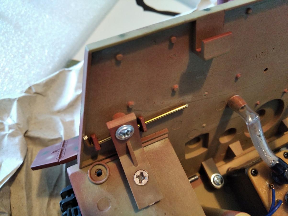

                                      The King Tiger is finished! I'm quite happy with how it turned out. Though seeing these photo's I might add a small pin wash here any there. Also the wheels are a different shade of dark yellow even though I used the same base colour. I think it's because of different weathering techniques. I might give it a quick hit with the airbrush again to bring back the yellow.

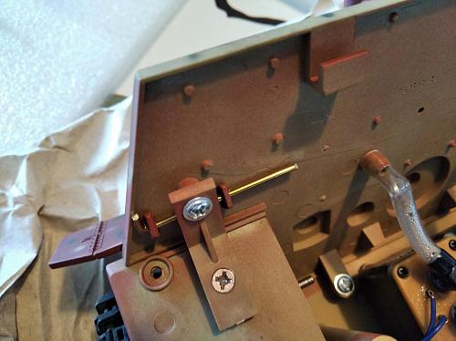

                                      I also made a simple modification to prevent the read mudflaps from falling out.See the last photo.
                                      One thing that is weird: The track recoil doesn't trigger anymore when the BB gun is fired.I don't think I missed reconnecting a wire, and all the other functions are working correctly. I don't want to open her up again, as it's not a big deal.
                                      Now to continue the quest for a suitable 1/16 scale crew...

                                        UltraVargen Very nicely done! Personalizing a tank is very rewarding, in my opinion.
                                        Regarding your track recoil, have you tried pressing the two buttons on the radio that select the amount of Track Recoil? It cycles through Off, Light, Medium, and Heavy recoil. Perhaps your track recoil is in the Off setting?
