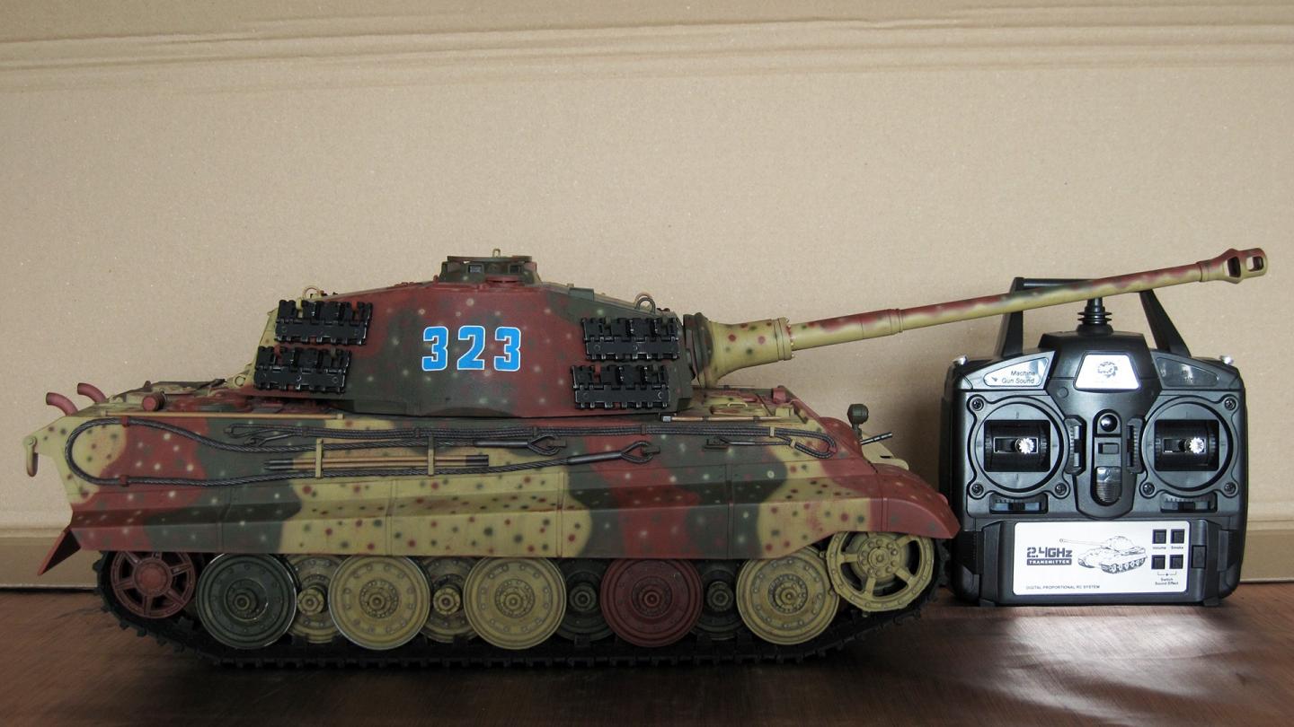

      Redid the wheels and pulled the camo colours into them, a huge improvement. Now I can really call it done.
      I ordered an assortment of resin figures from Aliexpress to put a crew together. It'll probably be while until they are here. Nice figures seem to be difficult to find in 1/16. either that or they are hugely expensive. So I will open a new topic once they arrived to discuss them.
      Side note: I also found out what was wrong with the track recoil: It was a wire after all. I had the "double yellow" wire plugged into a wrong position on the board.

        • 4861
        #23
        UltraVargen, Absolutely beautiful work! Truly well done. Best, LB

          Thanks for the kind words Elbee!

            Wow! That's really impressive. Beautifully done.

              Thanks Prowler, happy you like how it turned out!

                Great paint scheme! I tried it once on a smaller scale tank, it unfortunately ended up looking like a clown car. Yours came out great. I did notice the "worn left fender, beginning to show the underlying factory red brown primer" touch.

                  Thanks Bob! Yeah, I can imagine this type of scheme to be a lot more difficult to pull off in a smaller scale.
