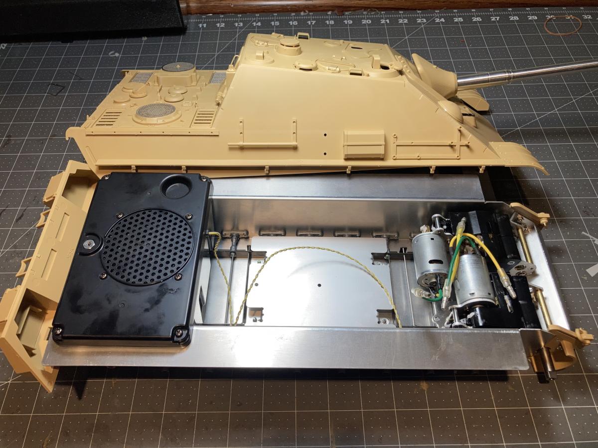

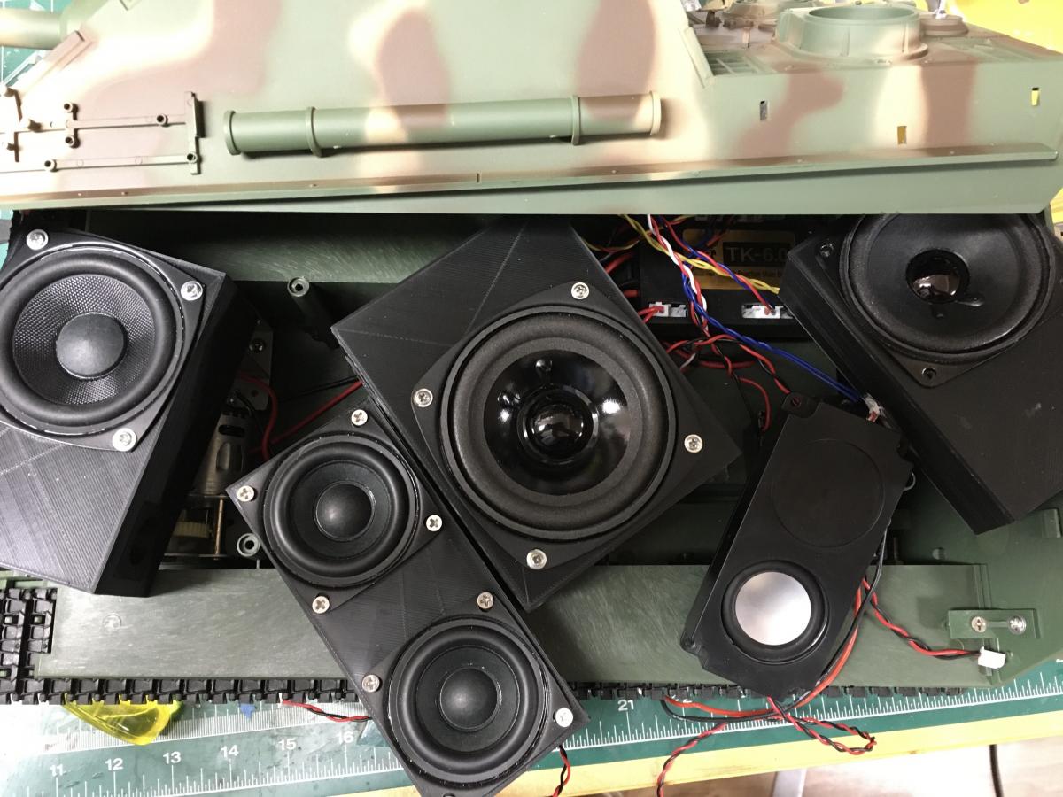

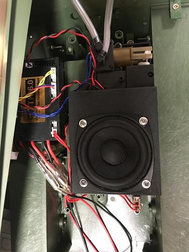

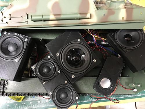

    Let's start with the speaker. I have countless speakers for many different tank builds sitting around. Some are 4ohm others are 8ohm. I tried them all on the 6.0 board and they all worked fine. Knowing previous HL boards ran at 8ohms, I decided to stick with that, and not have to replace the board after burning out the tiny amp.
    Click image for larger version  Name:	IMG_2708.jpg Views:	0 Size:	141.5 KB ID:	262158

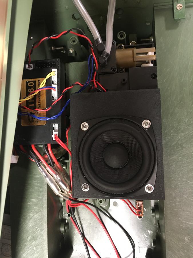

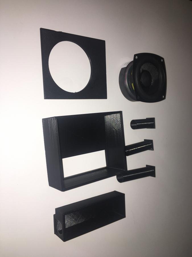

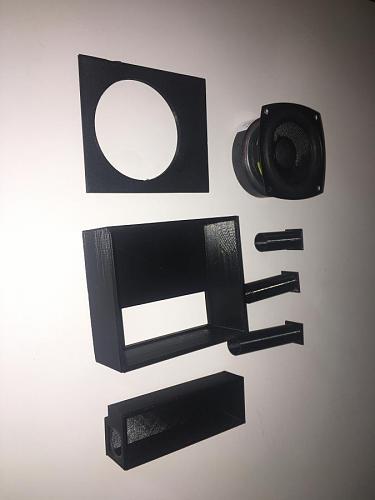

    I designed a box in Tinkercad to use the small space on the left of the lower hull, over the battery tray. I designed it with a modular port/vent system, so I could try different tunings once it was placed in the hull.
    Click image for larger version  Name:	IMG_2717.JPG Views:	0 Size:	36.8 KB ID:	262159
    It's a little louder than the stock speaker, but the low end is substantially better.
    Click image for larger version  Name:	IMG_2720.JPG Views:	0 Size:	80.1 KB ID:	262160
    Looking forward to seeing how this comes together. I'd be interested to know what speaker you are using. And, your box design. I'd like to get more low end sound out of my tanks also.
    • #3

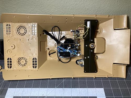

      The speaker is a Dayton Audio 2 1/2 8ohm https://www.parts-express.com/dayton...river--295-152 . It is a great speaker with a higher power amp. A better choice for the HL power supply would be a Visaton https://www.parts-express.com/visato...8-ohm--292-530. I usually carefully calculate for internal volume and port length, but experience has shown that the only real difference is poly-fill and port length. So I build it as large as I can, then change ports until is sounds right,

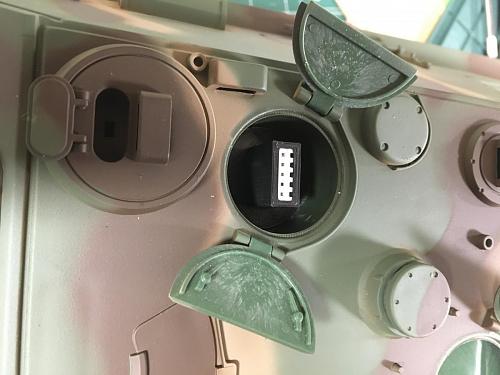

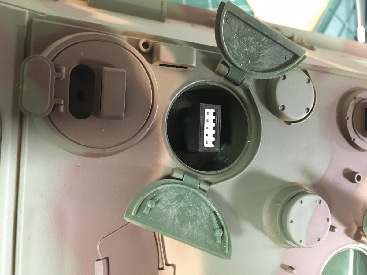

      I installed a new IR receiver port designed to fit the LegoDEI receiver.

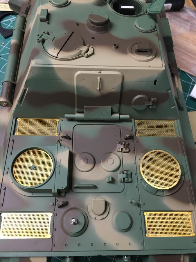

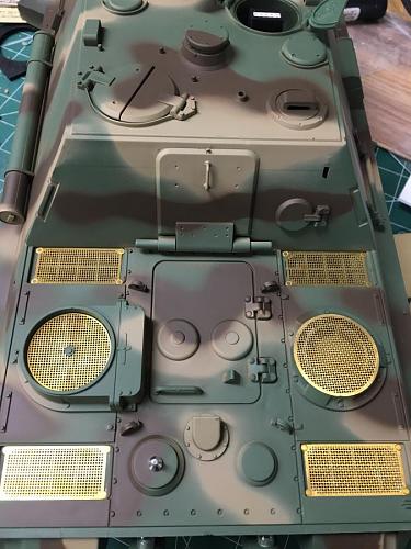

      Then added some etched screens to the engine deck.

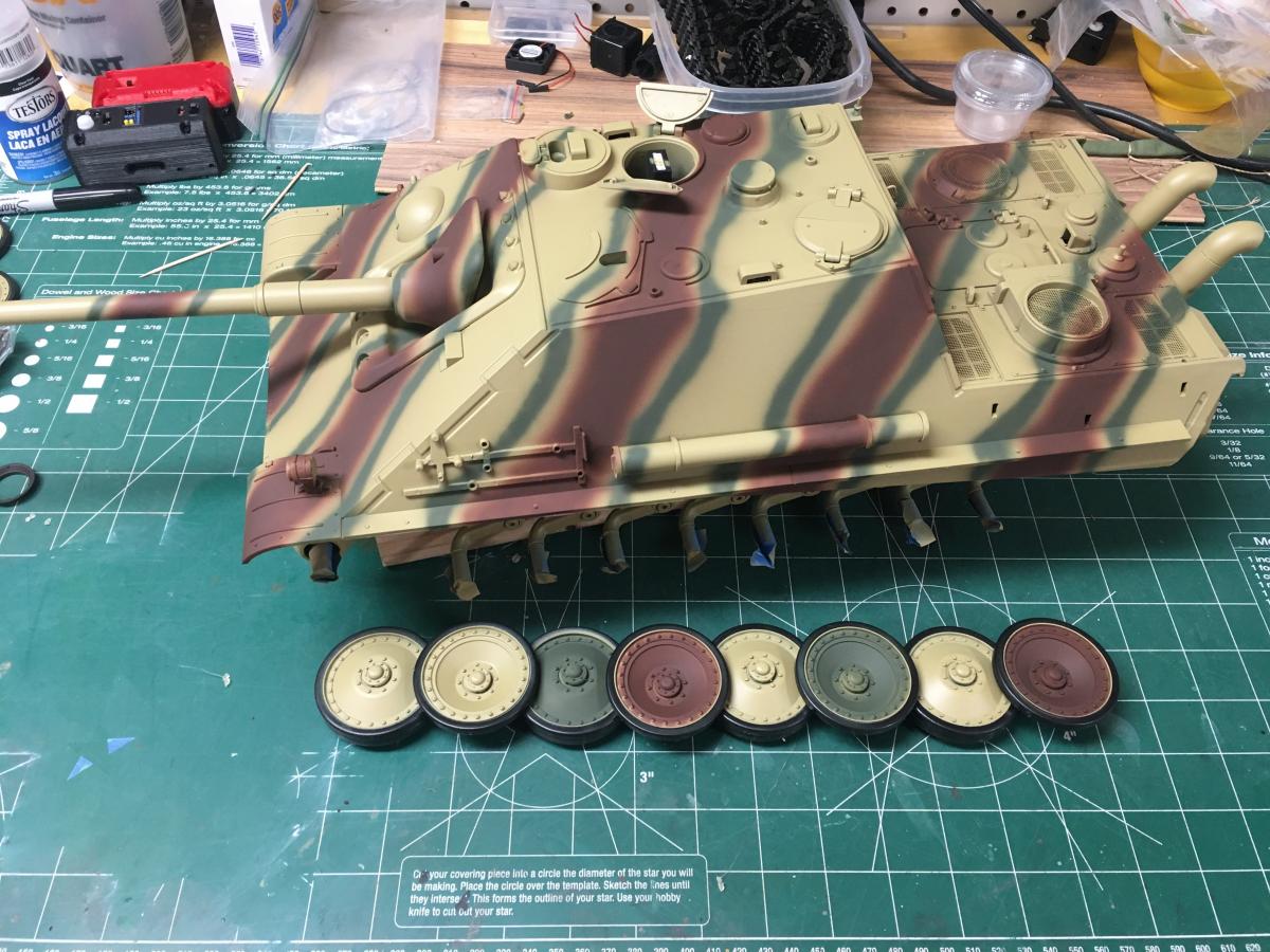

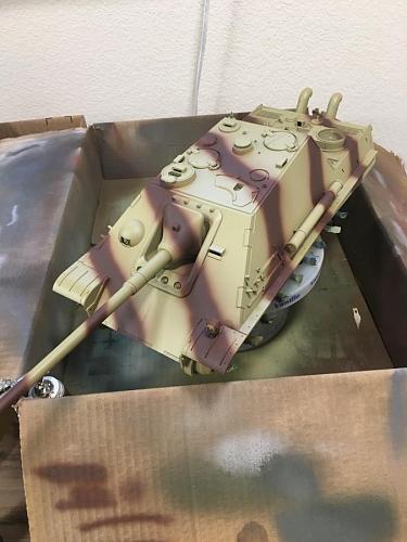

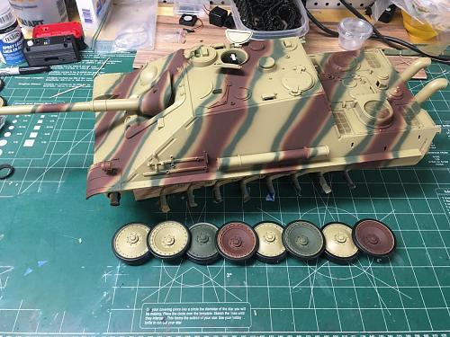

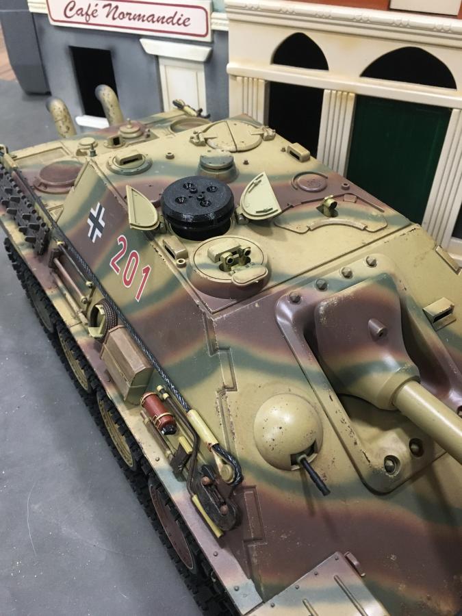

        Getting some paint on it. I tried a combination of ideas I found online.....not sure I like it, but with filters and weathering, I think it will be interesting.
ID:	263470Click image for larger version

          BcuriousR I like your scheme, and your brass PE intake covers, too. Mine were thin steel but the brass looks finer and more realistic.

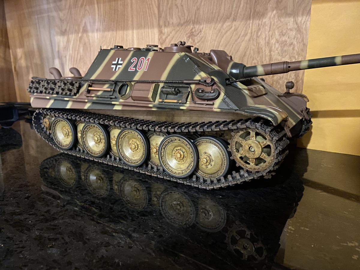

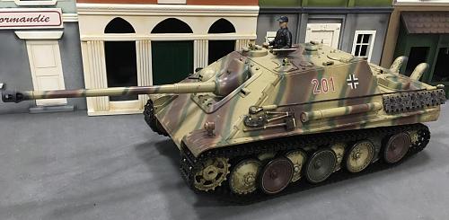

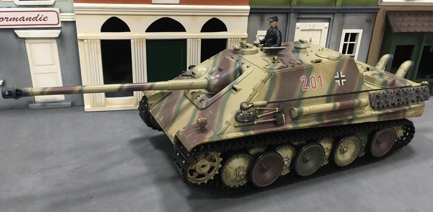

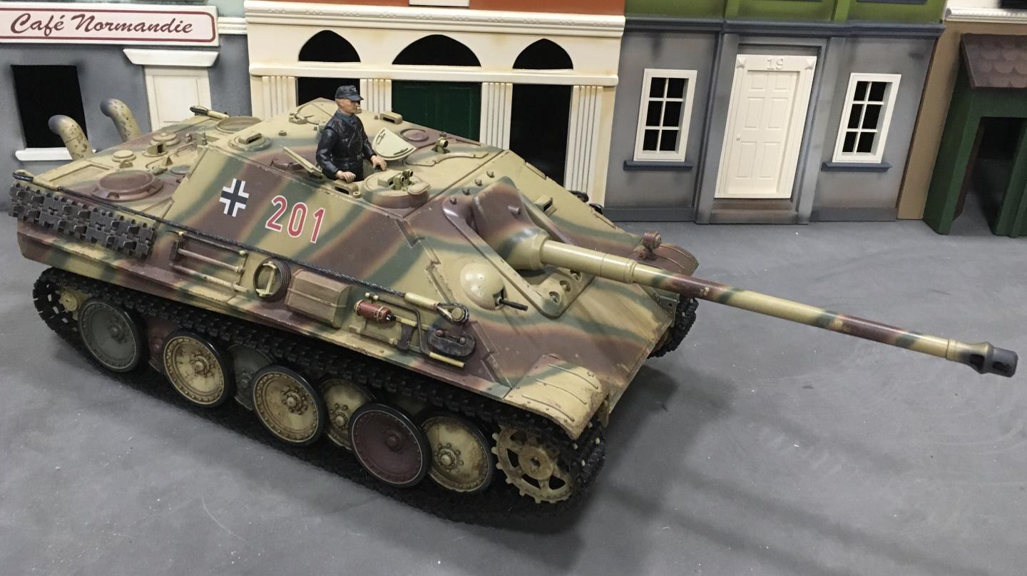

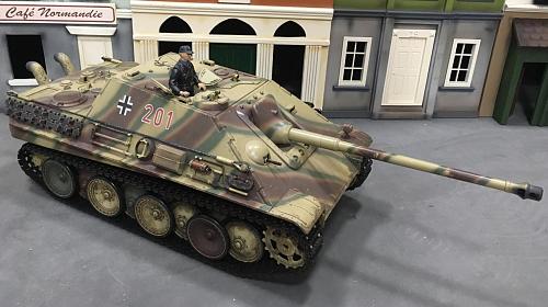

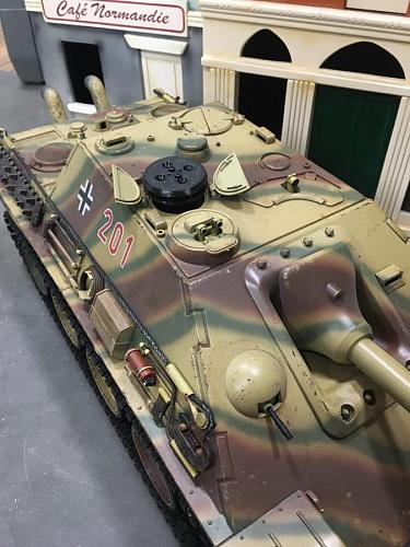

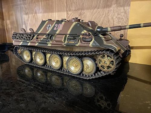

            Mostly finished. Lighting makes it look shinier than it is. With each build, I'm learning new techniques in weathering. It's much less stressful trying things on a Heng Long vs a Tamiya or Taigen. This is the first time I've painted a figure, so I thought the standard HL fig would be a good test ground. I quickly learned that the molding leaves a lot to be desired. But, by hollowing him out, I can cover the receiver base for the LegoDEI receiver, and give the model a bit more of a dynamic look. For a budget build, I'm very happy with the results. I did drill some new holes to try to increase the tension on the front road wheels. It has a bad case of the sags. I'm sure upgrading to steel gears will only increase the problem; thus, a future modification will need to address the weak springs.
ID:	264230Click image for larger version
ID:	264231Click image for larger version

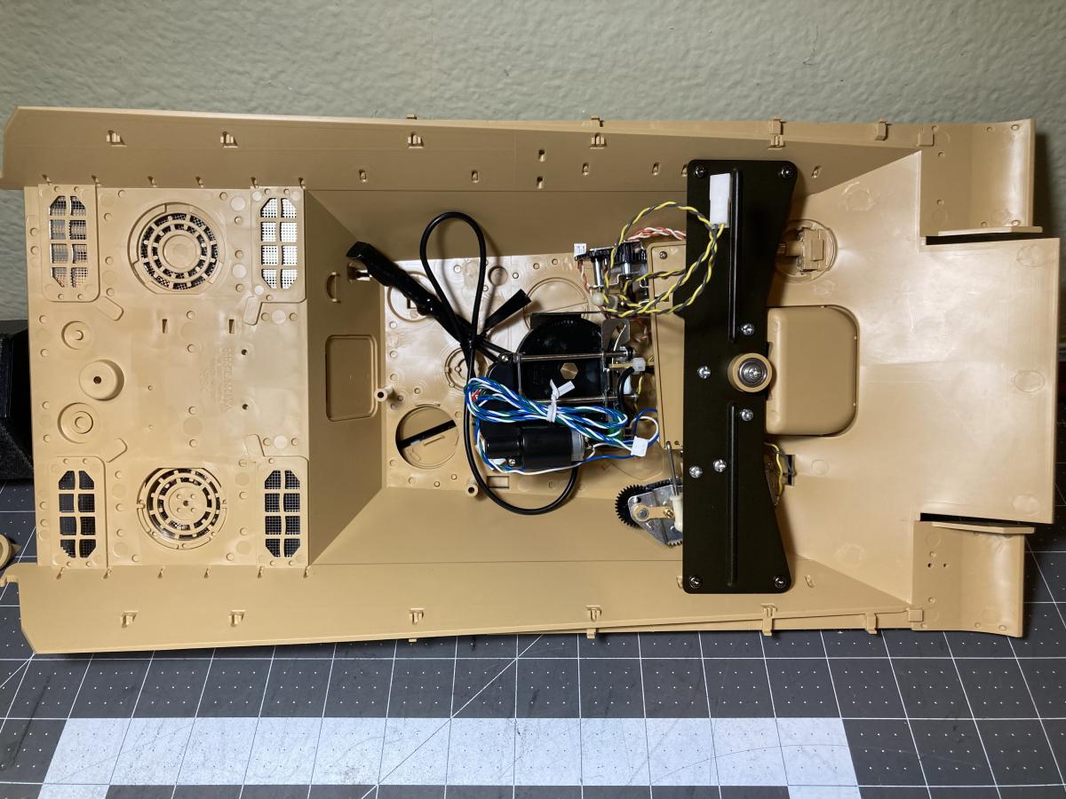

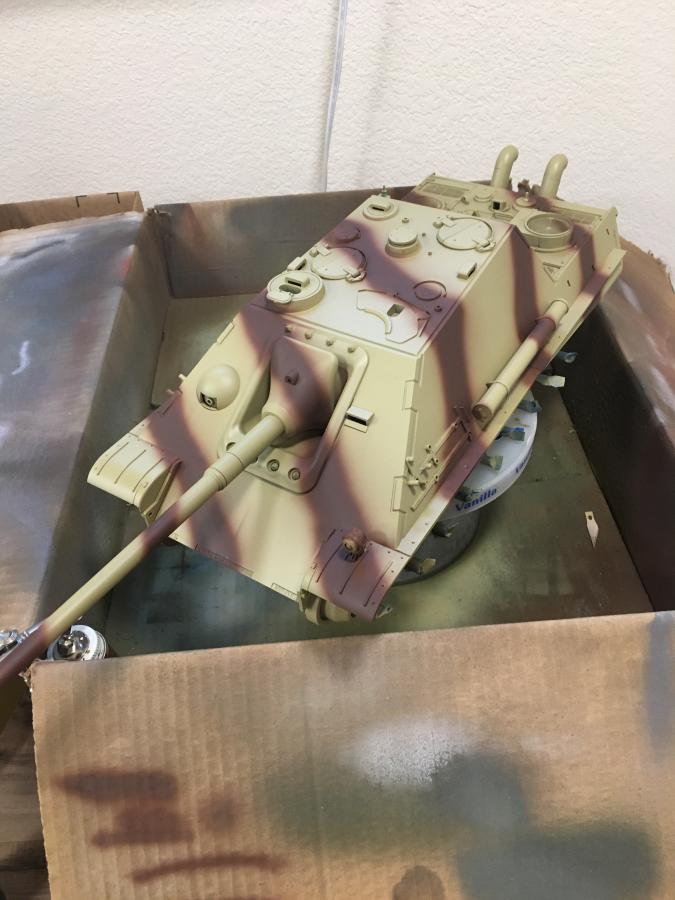

                      I started working on the chassis. There were many metal parts. My wife told me that I created too much noise. So I decided to do the upper hull and would work on the chassis over the weekend.

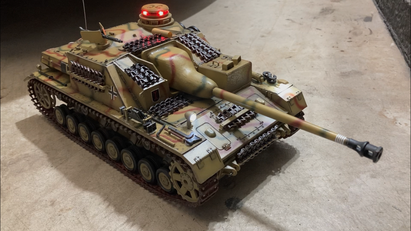

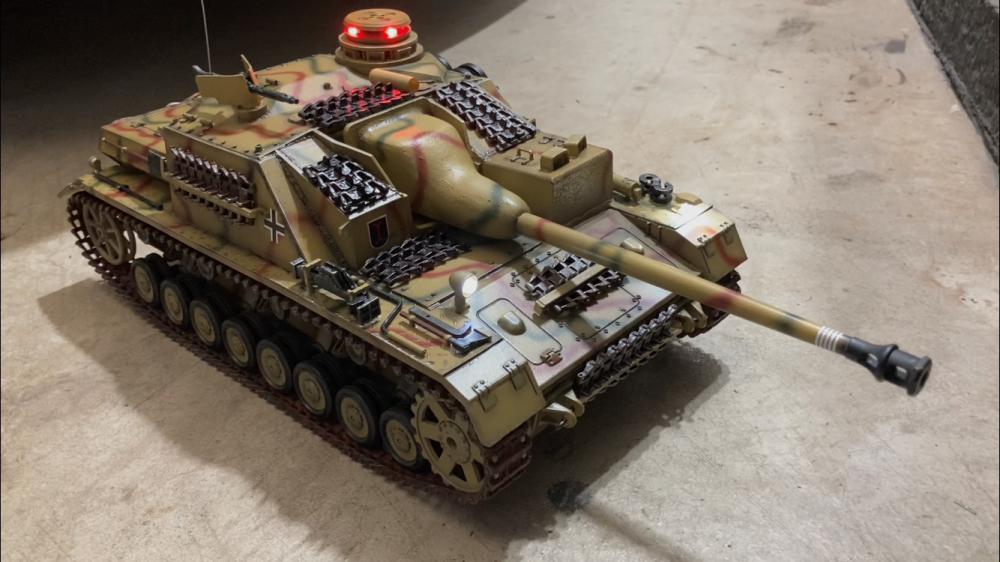

                          Funny.....I won't get it done till next week. This is only my 3rd times building a Tamiya tank. I am still learning. And like many of us, I have many projects to do. I jump around a lot. I have just turned this Stug IV into IR with the notek light installed. I am playing around with it tonite. I will bring the Tamiya Bovington Tiger I #131 this Saturday to battle.

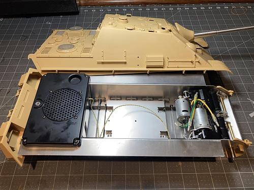

                              Love the Jagdpanthers! Looks similar to one I’m currently working on. I did end up finding stronger springs which helped with the droopiness; this is a heavy tank with steel gears and metal tracks/idlers.

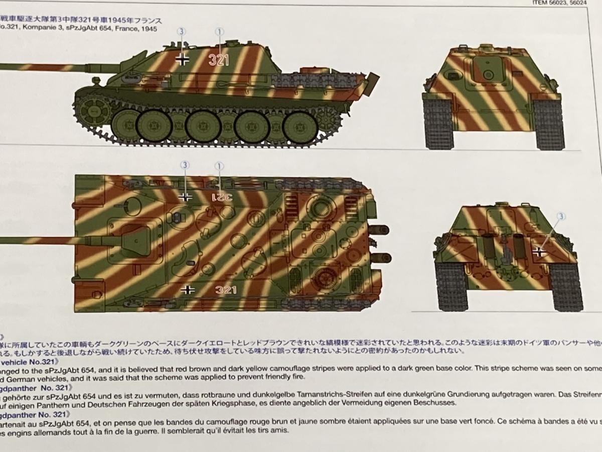

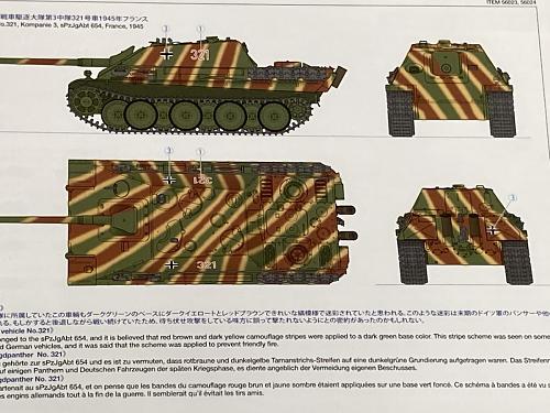

                                  I don't think the Tamiya Jagdpanther has that problem. I will follow this paint scheme from the sheet included in the Tamiya box...

                                      Many thanks on the link that you provided. I saw the one that I planned to paint...

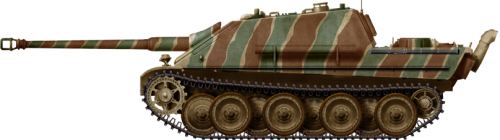

                                      • #20
                                        That is what I based mine on :)
