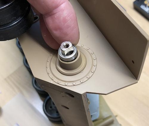

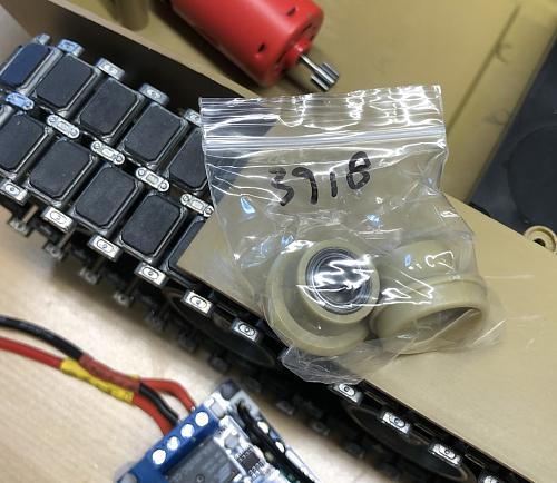

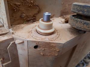

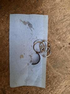

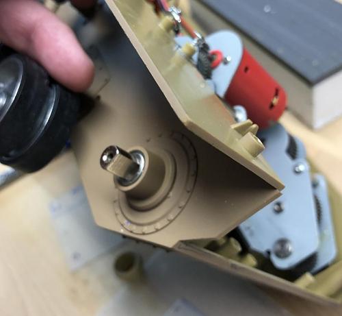

    I bought the Heng Long Drive Shaft bearing assembly for my 6.0s Abrams and after taking the drive sprocket off I found it already has the bearing "flange" molded in.
    Click image for larger version  Name:	Abrams_Drivebearings.jpg Views:	0 Size:	186.3 KB ID:	265738

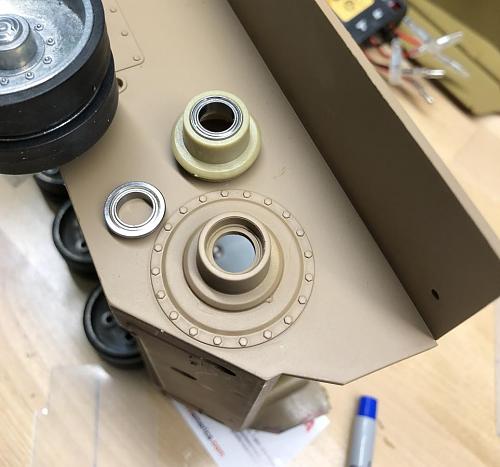

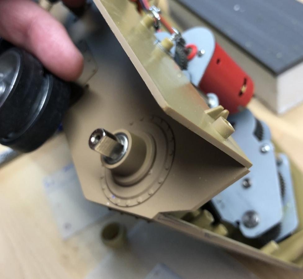

    I test fitted one of the MF128ZZ flange bearings that I used on my HL Sherman and it fit perfectly so I'm assuming a a non flange bearing of the same size would do?

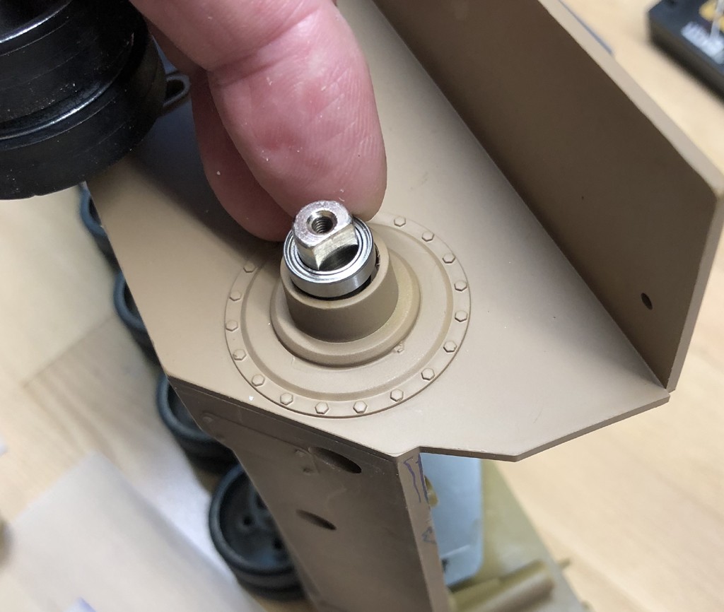

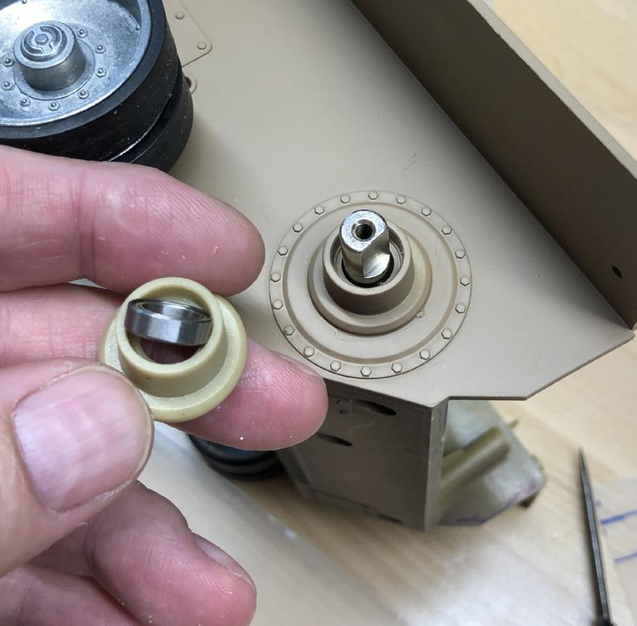

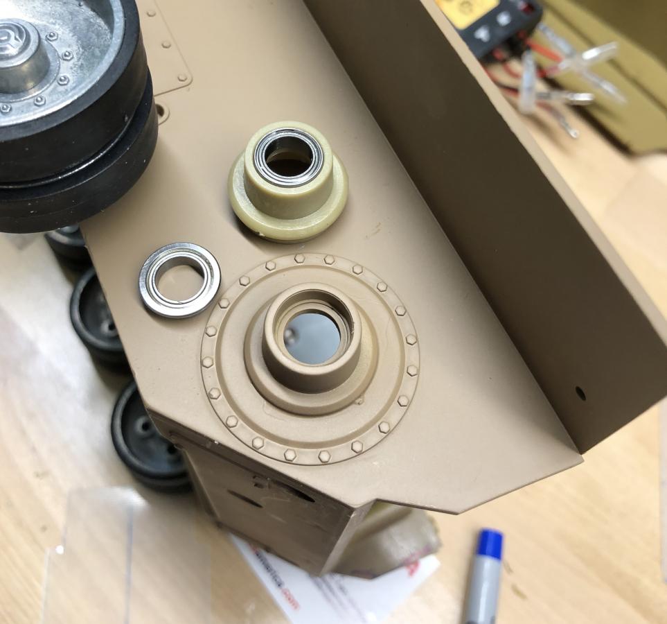

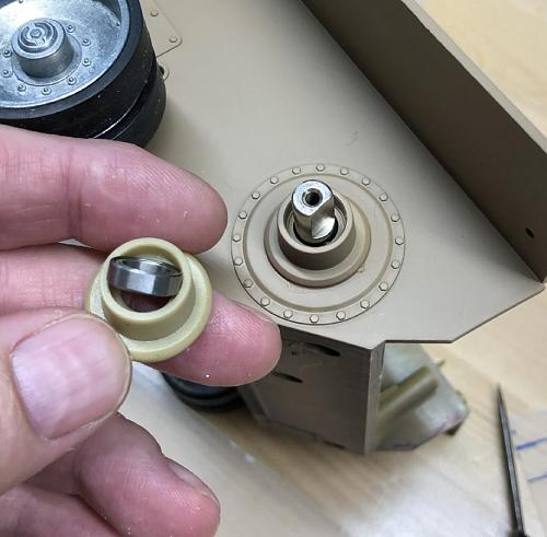

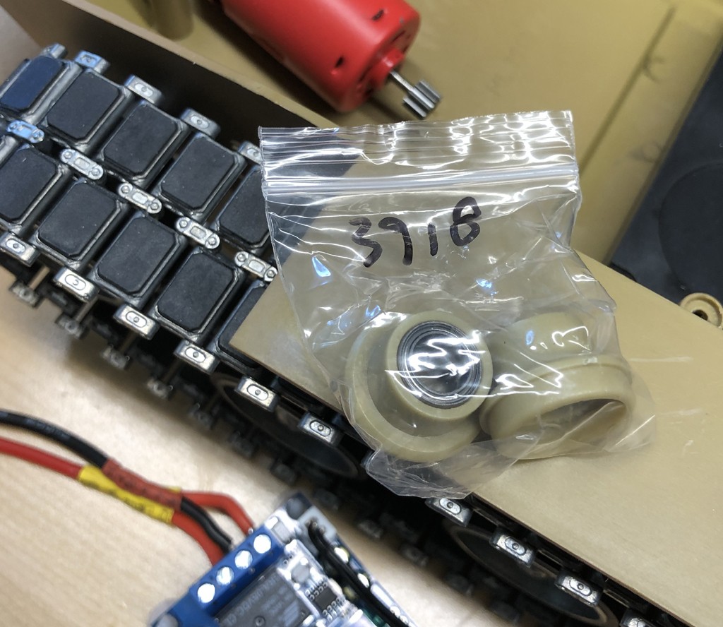

    All it needs is the bearings so I popped the bearing out of the new "flange" and it fit nicely into the molded in flange.
    Click image for larger version  Name:	Abrams_Drivebearings_03.jpg Views:	0 Size:	72.3 KB ID:	265740
    Click image for larger version  Name:	Abrams_Drivebearings_04.jpg Views:	0 Size:	119.0 KB ID:	265741
    Click image for larger version  Name:	Abrams_Drivebearings_05.jpg Views:	0 Size:	58.2 KB ID:	265742
    Unless I'm missing something a couple of bucks for just bearings is way cheaper than the $10 I spent on the assemblies. I'm guessing these may be required for older versions?
    I would think Stainless (SMR) for corrosion resistance would be preferred and you could just order the bearings if you have a 6.0s version lower hull?
    8X12X3.5 Stainless Steel Bearing SMR128ZZ

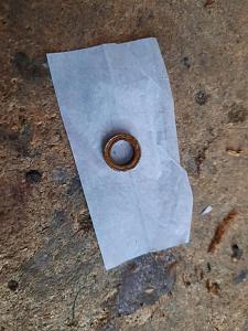

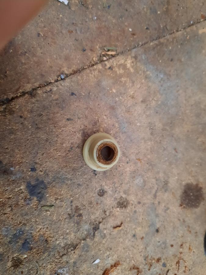

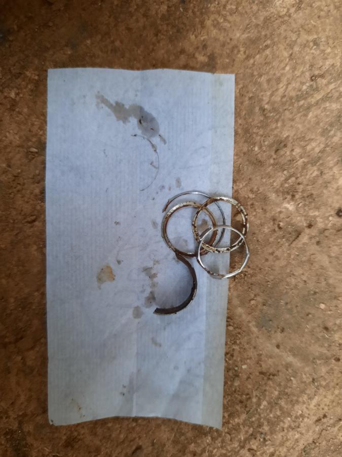

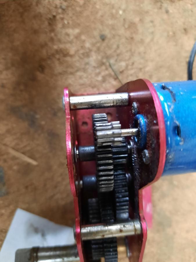

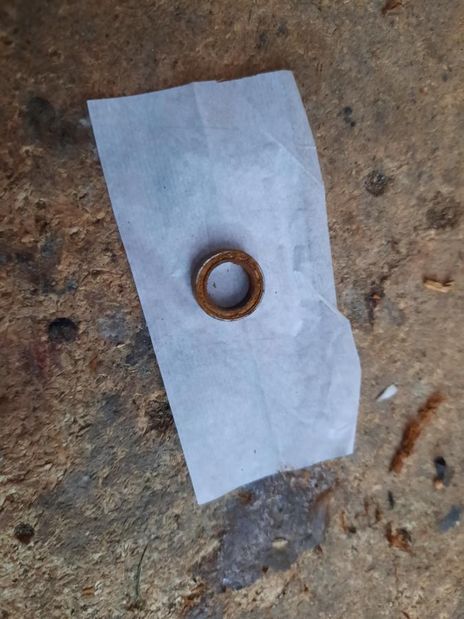

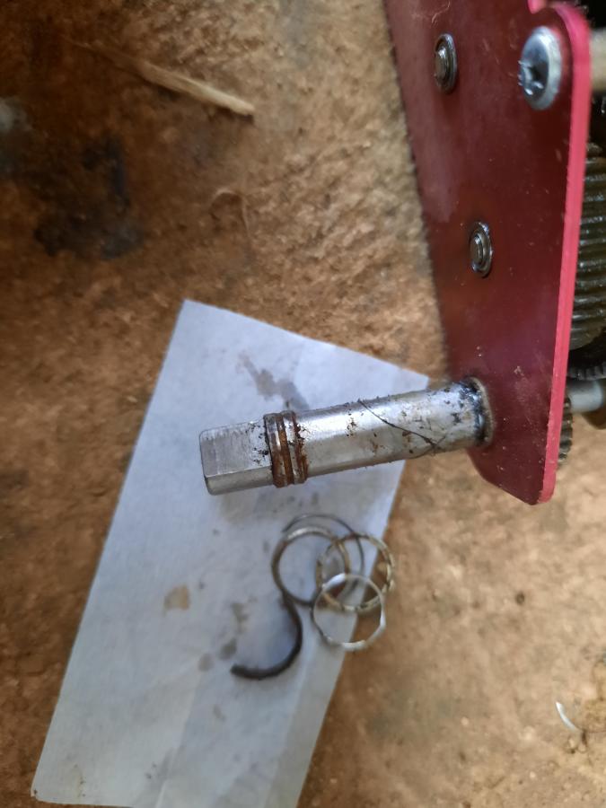

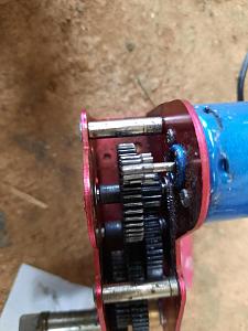

            I hope these bearings are better than the ones I got with the DAS kit I used cause the damn things have collapsed on me after only about two months. Corroded to bits, rusted on to the drive axle and caused the gearbox to jam, but naturally the motor kept running and stripped the pinion gear and bent the shaft of the motor. Click image for larger version

            • #7

              Can’t say I ever had a axel bearing explode like that on a tank and I have a few dozen in service, some for years.
              • #8
                Trust me mate not too happy about it right now. Still trying to get the remaining bits of bearing off the drive shaft. Gonna pull the bearing on the other shaft as well and see what state that one is in.

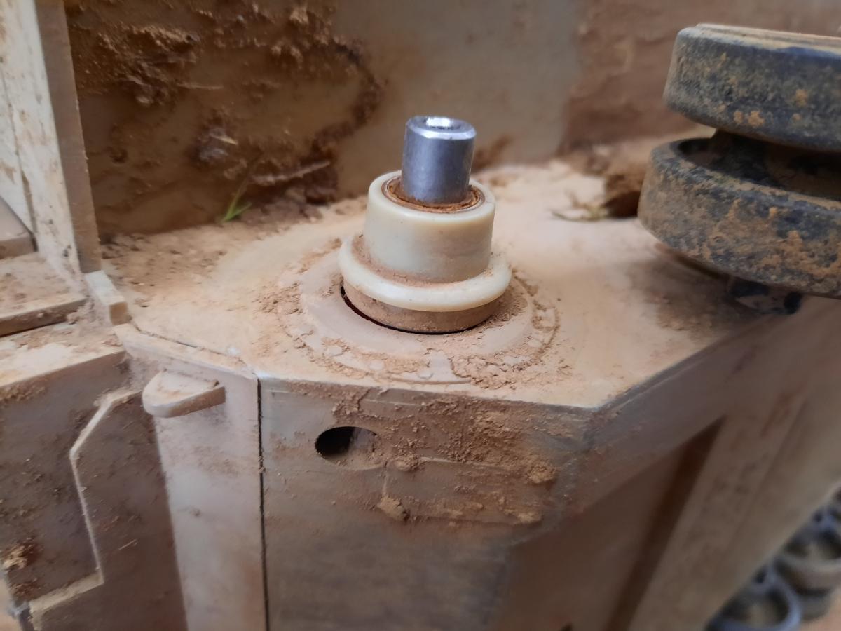

                  Well pulled the other DAS out and that one was frozen on the axle as well. As you can see it's corroded to hell and back again. And that's after being lubed before being installed and oil on the shaft. Click image for larger version

                  • #10

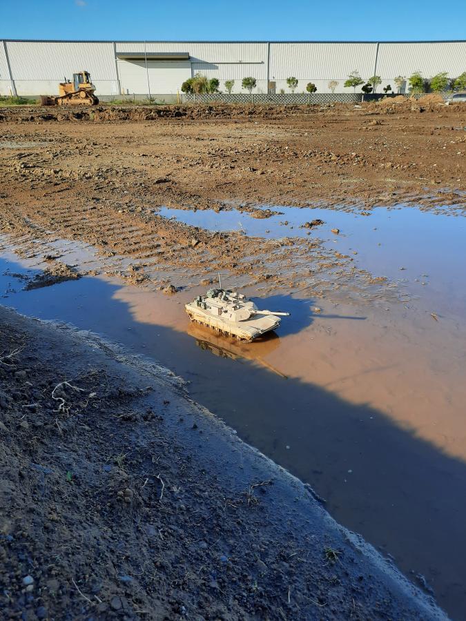

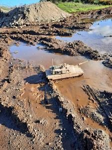

                    Did you drive your tank on the beach or in salt water?

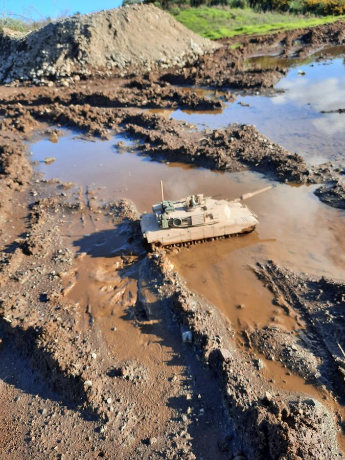

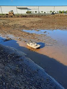

                    • #11
                      No to both questions mate, only run her through fresh water after which she was washed out and lubed up again. Mainly cause there was usually mud involved. Click image for larger version

                      • #12
                        As deep as the Abrams drive sprocket is I can see how any moisture could be trapped inside the wheel against the bearing. I'm making a mental note that if I run my Abrams through water to remove the drive sprocket to make sure the bearing and shaft are dried quickly and lubed.
                        Since these tanks are not designed from the factory to be run through water I would advise people to maybe pack the outside of the bearing with a heavy grease before installing the drive wheel if they plan on "mudding".
                        • #13
                          Yep thats my plan from now on
                          • #14
                            Another option is replacing the bearings with stainless steel versions.
                            • #15
                              Yeah that's what I'm gonna do as well as the grease. Did a bit of research and found I could buy one bearing in NZ for the price of 4 off ali express.
