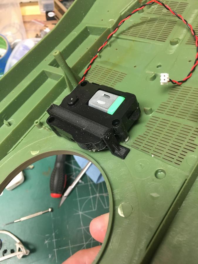

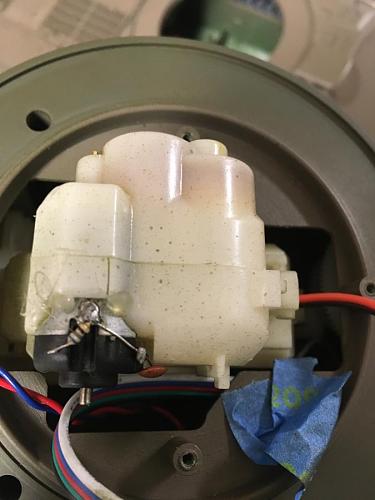

    I have been working on a Pershing that had many, many broken posts from the factory, (Its never been driven; cheaper and easier to fix than to send it back). All 3 rotation motor posts were broken. Some I was able to sleeve with styrene. I thought about drilling small holes through the upper hull to screw tiny screws into new posts and puttying over them. I settled on sleeving what I could, Epoxying the rest, then I created a "strap" mount. I glued two vertical posts on each side of the rotation motor and a cross brace that screws in to the ends, (so. I could still remove it). It seems to work fine.

      Hey thanks for that, I.might give that brace idea a go.

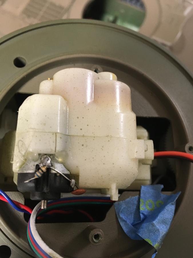

        On closer examination of the traverse gearbox I found it had multiple cracks of which 2 were in the support holes. I believe that the flexing of the gearbox caused the problem.

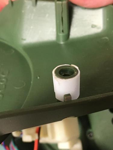

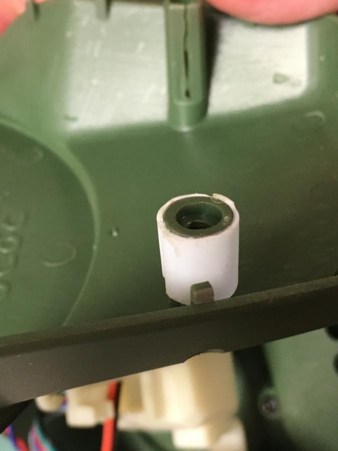

                I have had my share of poorly assembled HL tanks. The biggest problems have been over tightening screws until they split or break. The M26 I'm working on is the worst I've ever seen, (brand new never run): Broken rotation motor mounts; turret upper and lower posts, and 3 of the suspension arms/roadwheel posts split, airsoft housing at the motor is cracked so the gears won't engage and the motor falls out (I gutted it for IR anyway). I like to tinker, so it's not big deal to me, but had I paid more, or was new to the hobby I'd be pretty grumpy about it. I've had pretty good luck with newer HL, so this one is a fluke. I'd aggressively look for a refund or return if it was a Taigen, Mato, or Tamiya.
