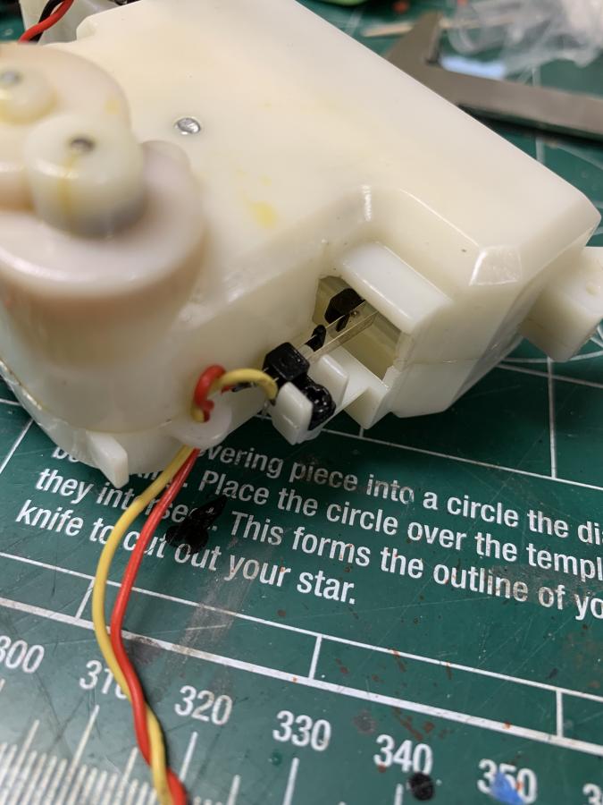

      CN6 is your recoil switch on the back of the airsoft unit. When the firing mechanism pulls all the way back, the plunger will "trigger" the switch creating the gun sound and track recoil. Plug the recoil switch into CN6, with the tank running try closing the switch manually with your finger/pencil/ stick/etc. It should make all the right sounds and the tracks will recoil. If the unit spins but does not fire, it could be that the airsoft unit has stripped or the motor has pulled out of the unit and the gears are not meshing. Could the spare wires be for the IR receiver and emitter, (found on the the 6.0/6.1 but not on the the 5.3 or earlier)? 2 wires for the emitter, 3 for the receiver.

        Thanks for your reply !! After many attempts to resolve this, I finally determined that the firing mechanism is not moving the plunger and is most likely stripped, and that is why the motor is spinning but the gun is not firing. I ordered a replacement unit. I wish I had known earlier how this unit is supposed to work, but could find no good info online. As for the extra wires, I found out from another source that the slip ring unit for the 6.o version is different, and is wired differently, so I ordered a replacement slip ring. Things should get resolved when the parts arrive. This may be a common modification, and I wish better info was available before I got into this. It would have made things a lot easier !! Perhaps a good tutorial on doing the upgrade to 6.0/6.1 could be posted on this site as a "sticky" to help others that want to upgrade their tanks. The parts sellers don't seem to offer complete upgrade kits at the moment, so its all guess work about exactly what parts to order.
