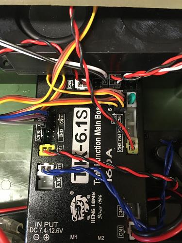

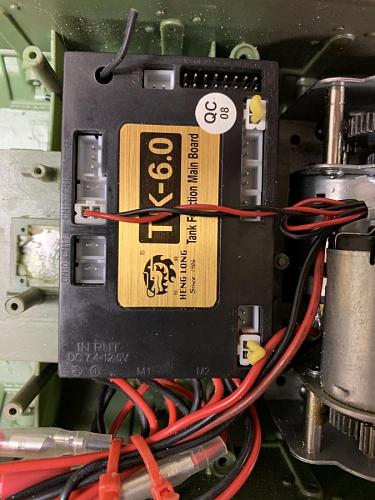

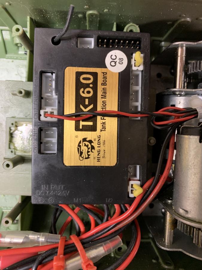

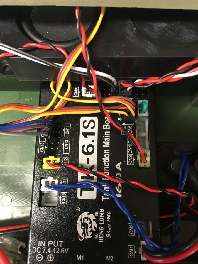

      All of my tanks are converted to IR. Our club, FRAG RC Tank Club, has specific rules about how to place the emitter in the barrel. So, all airsoft units are gutted. Some people even cut the motor housing from the bottom to create more room in the hull. You do not need to keep the recoil switch. You need to short the existing wires for the recoil or build a small jumper, (see the photos below: one is in my M36 build (green jumper), the other is in a Pershing (yellow jumper): I also shorted the new on/off switch because I was too lazy to rewire the inline switch on the battery).

        BcuriousR, thanks for responding! To clarify my cloudy mind, on the 6.0 board (I'm using a 6.0S, I think the relevant circuits are the same):
        1: You disconnected the recoil motor (CN10 BB Launch System) circuit.
        2: You jumped the CN6 Trigger circuit.
        3: You placed the IR Emitter in the barrel.
        Anything else?
        So, when you take a shot:
        4. Is there no delay since the the recoil motor doesn't run?
        5. Is there still a gun shot noise? Is it immediate, since the trigger circuit is jumped?
        6. Is there still a tank recoil?
        Thanks in advance!
        • #5
          BcuriousR; Never mind! In the true tradition of "what's this big red button do", with a wince and a cringe, I jumped the circuit. Works like a charm! To others reading this thread, the answers to 1, 2, 3, 4, 5 & 6 are all yes.
