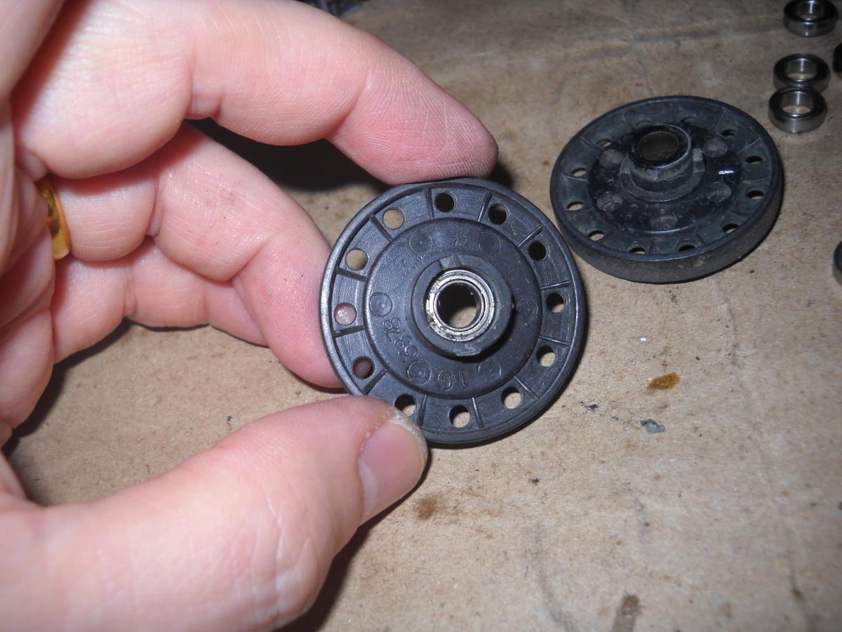

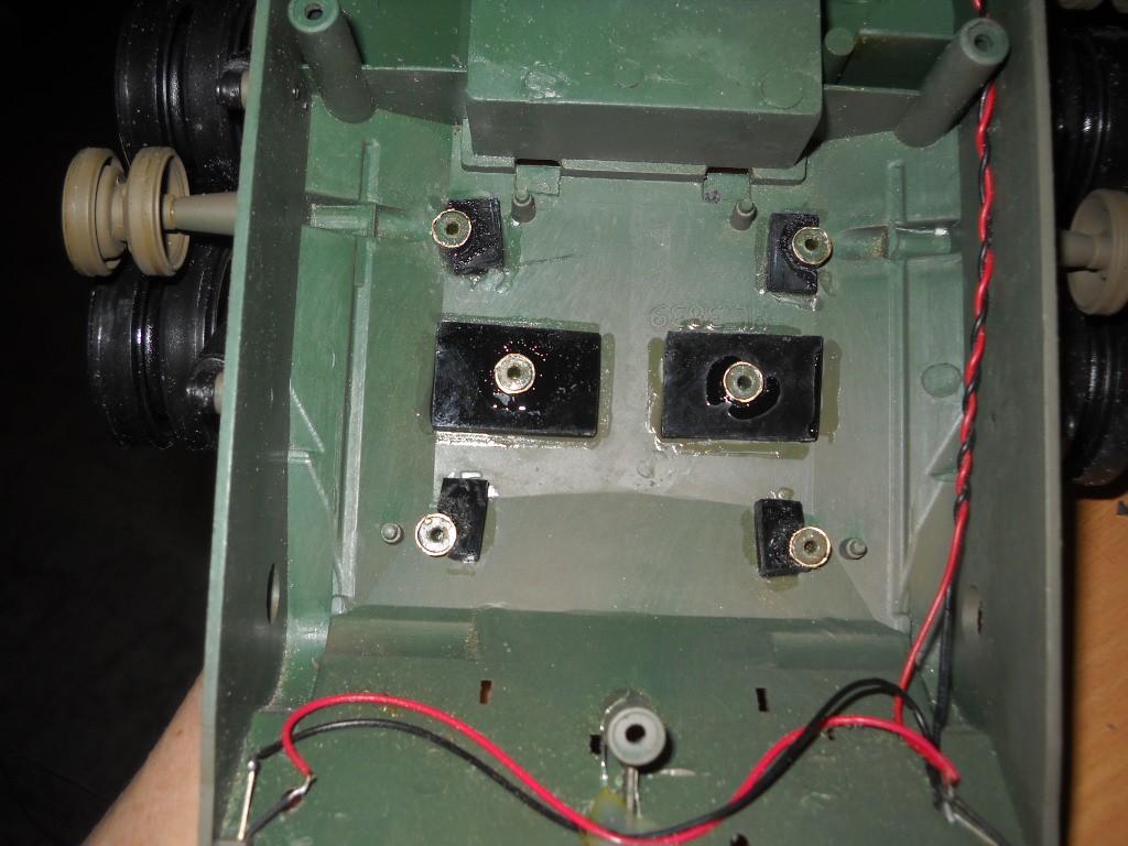

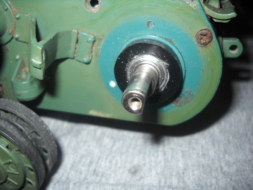

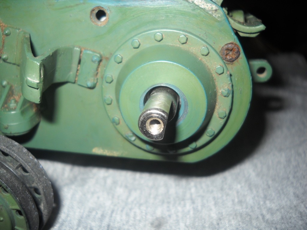

        Basic trick for heng long that run with metal track. Reinforce gear base ,tie bar for idlers wheel and made bearing shaft support.
