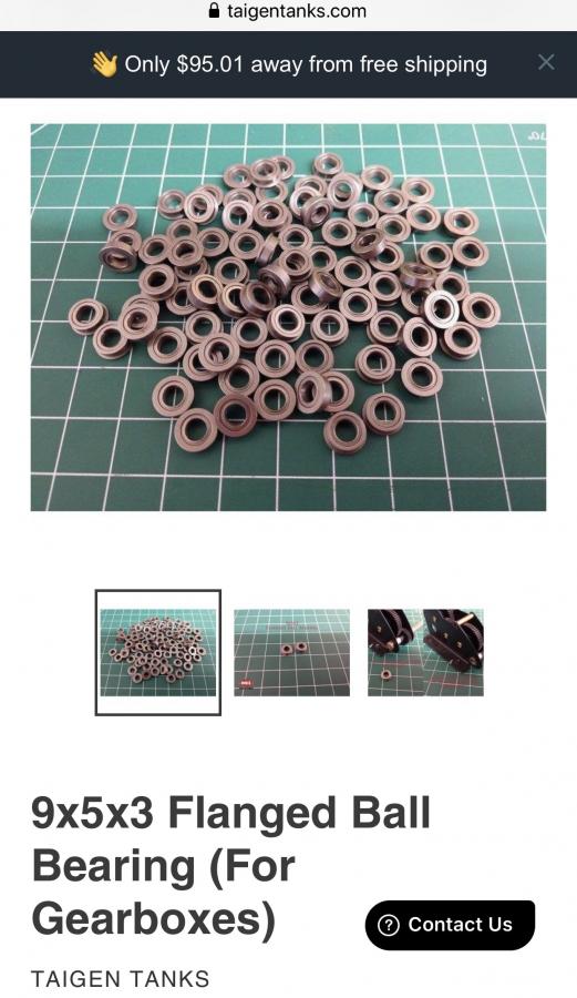

          Currently in stock at Taigen tanks:
          Click image for larger version  Name:	7A0A8C20-8D94-4F95-8EAE-349C97E4EBCB.jpeg Views:	0 Size:	70.4 KB ID:	283319
          • #6

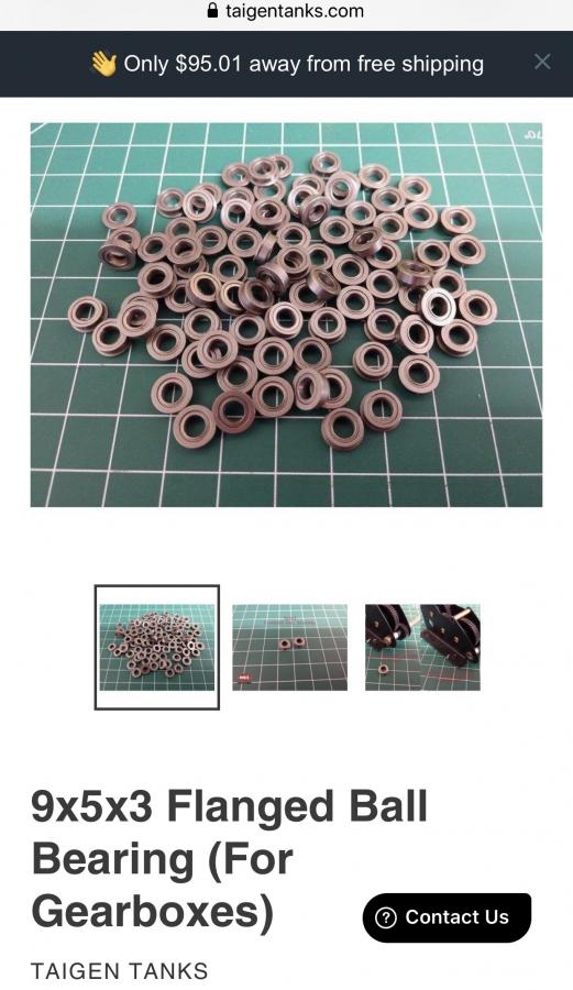

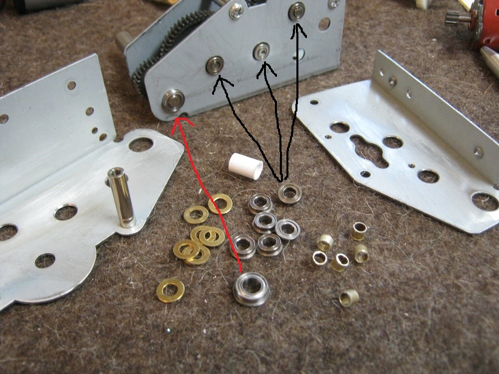

            Those are the large 5mm X 9mm X 3mm (ID X OD X WD) for the drive shaft (red arrow).
            The issue I had was finding the small 3.5mm ID bearings for the gear shafts (black arrows). Click image for larger version  Name:	image_63553.jpg Views:	0 Size:	225.1 KB ID:	283338I ended up getting 4mm X 7mm X 2.5mm bearings,https://www.amazon.com/gp/product/B0...?ie=UTF8&psc=1 and shimming the 3.5mm gear shafts with 4mm brass tube bushings https://www.amazon.com/gp/product/B0...?ie=UTF8&psc=1
            I used the 4mm X 8mm X 0.5mm washers https://www.amazon.com/gp/product/B0...?ie=UTF8&psc=1 to compensate for the thinner flanges on the bearings, and to space the gears so they don't rub laterally which is the source of most of the noise they make.

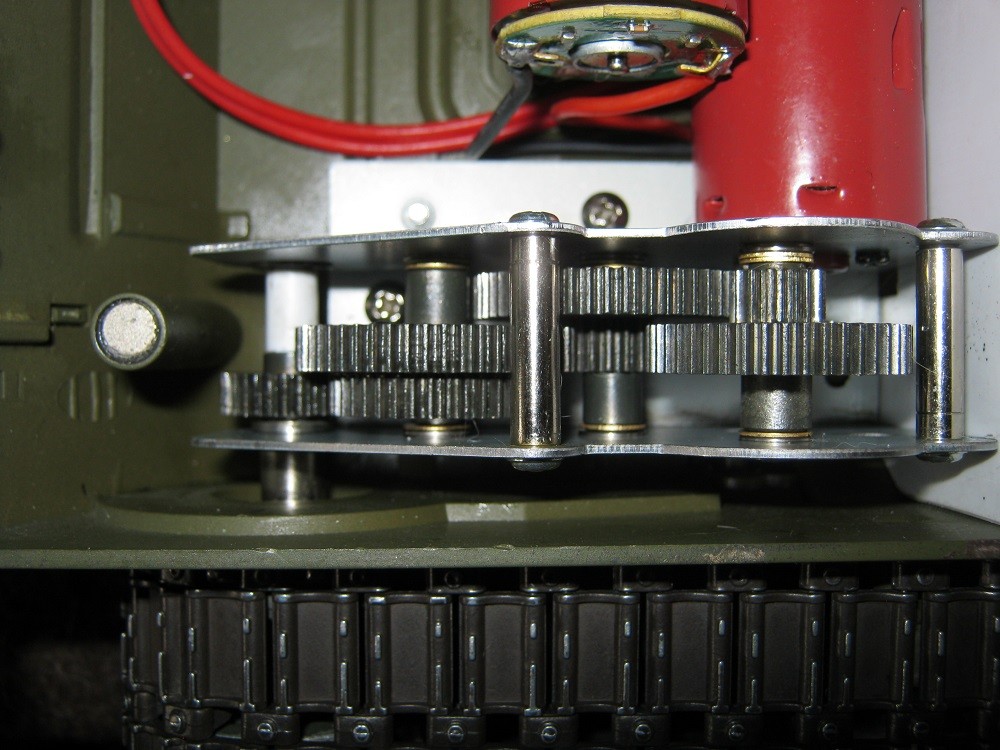

            Washer shims on gear shafts, and plastic spacer needed on right driveshaft.

                It's not too difficult, the brass tubing bushings are a pretty tight fit in the flange bearings, buffing the brass tubing with 400 grit before cutting, and a dab of oil will help when pressing them in.

                    I found with careful shimming with the washers, most of the gearbox noise can be reduced. It seems most of the noise comes from the sides of the gears rubbing each other, rather than from them meshing.
