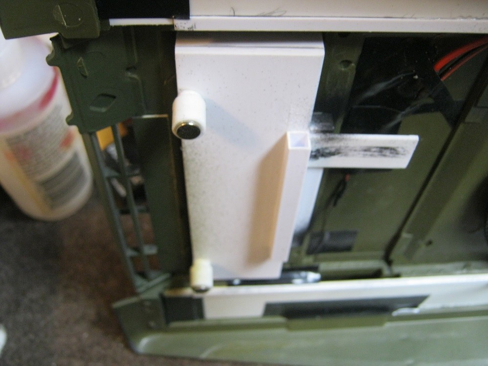

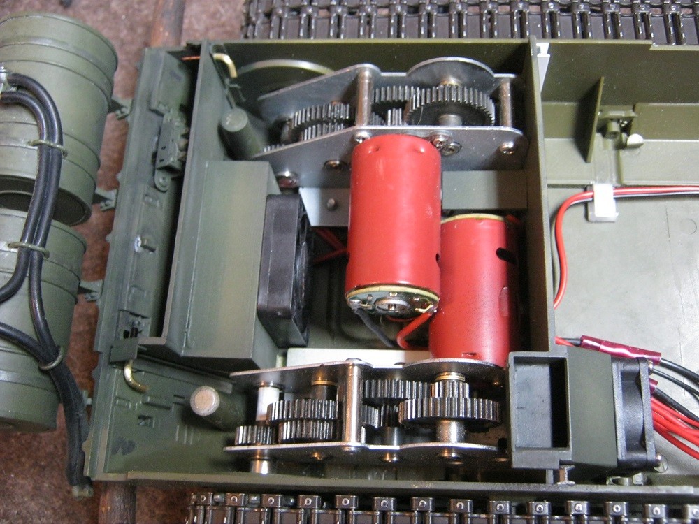

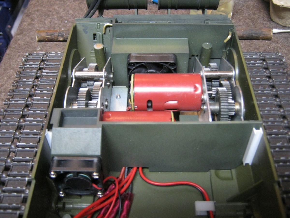

      You did a great job. Now get out and get those motors hot and see how well your upgrades works.
      A resounding success.
      Running fast as possible doing loops, figure 8s, and dog bones on carpet nonstop for the full charge of a 3500 mah battery the motors only got modestly warm. The battery still got hot, but noticeably less without that hot electronics smell, and the MFU didn't even seem warm. While hard to gauge accurately, it actually seems run time is longer with the 2 fans running full time.
      I added a couple of deflectors to further concentrate the airflow around the motors. The new setup has virtually eliminated contaminates being drawn in off the tracks.
      Click image for larger version  Name:	IMG_3399.JPG Views:	0 Size:	214.3 KB ID:	284187Click image for larger version  Name:	IMG_3401.JPG Views:	0 Size:	131.6 KB ID:	284188Click image for larger version  Name:	IMG_3400.JPG Views:	0 Size:	138.0 KB ID:	284189
      • windmill
        • Sep 2020
        • 82
        #23
        Took it outside today, 48 deg, and ran it on our road gravel driveway on high setting, at full throttle nonstop for the complete charge. At the end of the charge the MFU was still cold, the motors were barely warm, and the battery about the temperature of bathwater. No dirt, or debris got in the hull.
