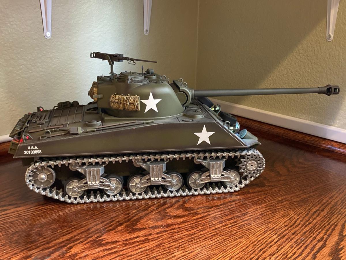

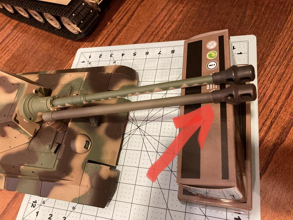

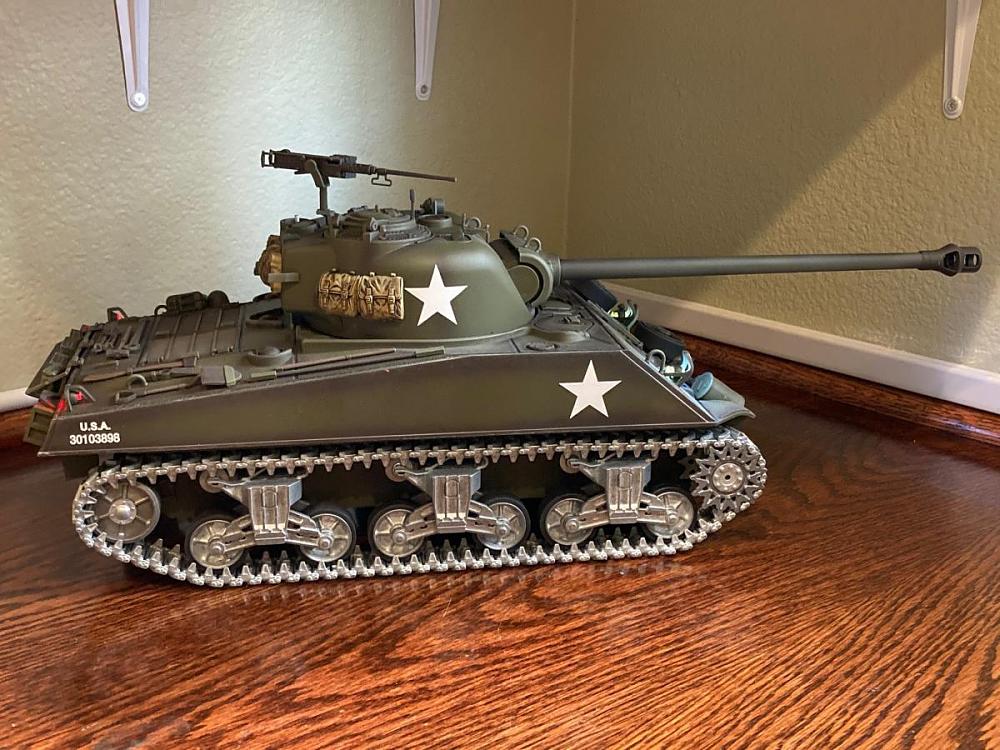

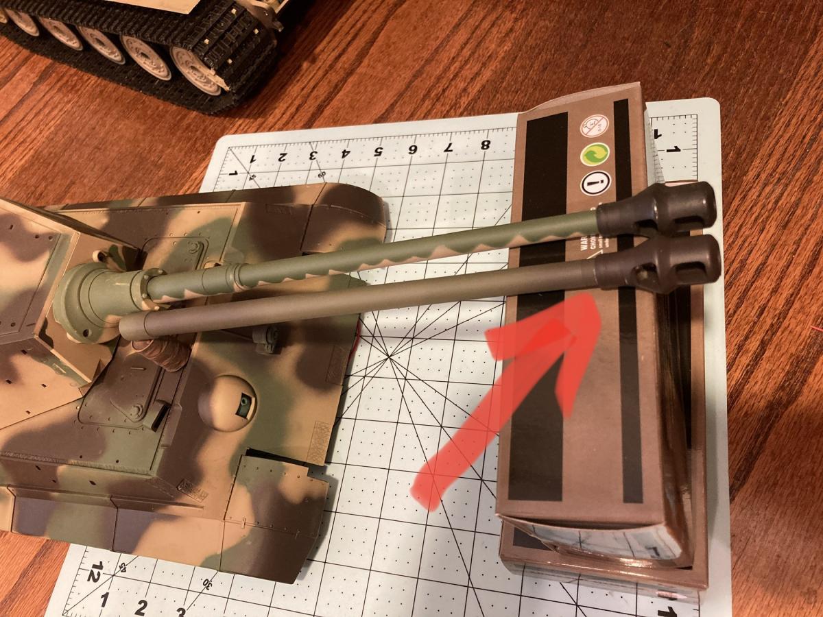

        I ordered a M4 Sherman Fury barrel from Toucan. It arrived. It doesn't look right. It looks as long and as big as the barrel of the King Tiger 88mm gun. I sent this same picture to Toucan and they responded that it was the right item. Does anyone have this barrel? Am I wrong or right? Thank you!
        • #5
          That's one I bought. You can always chop it.

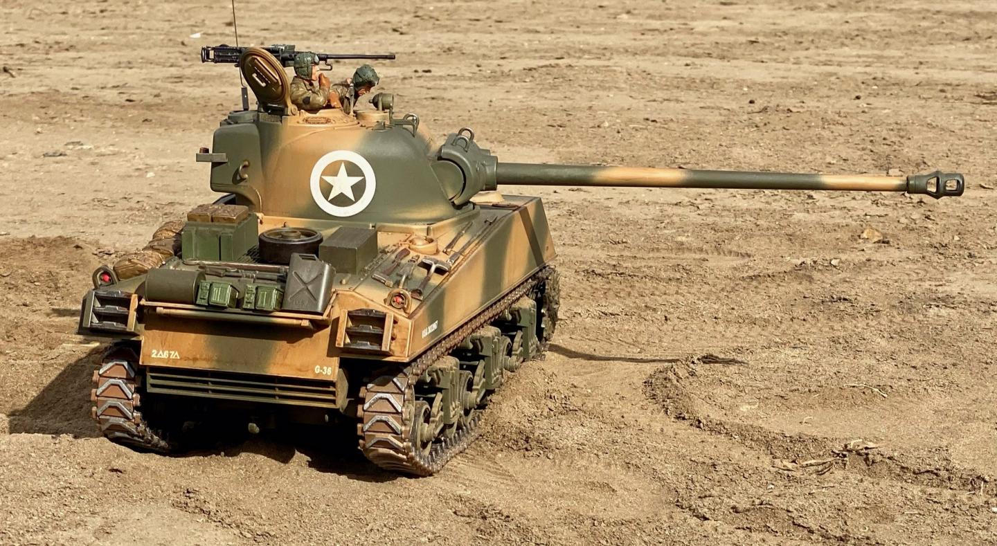

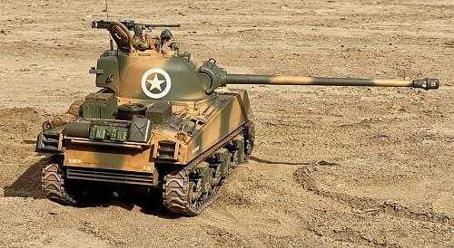

            • #7
              I did it. I replaced the short barrel for the Fury barrel. It is so cool when fires with the recoil system kicks in.
