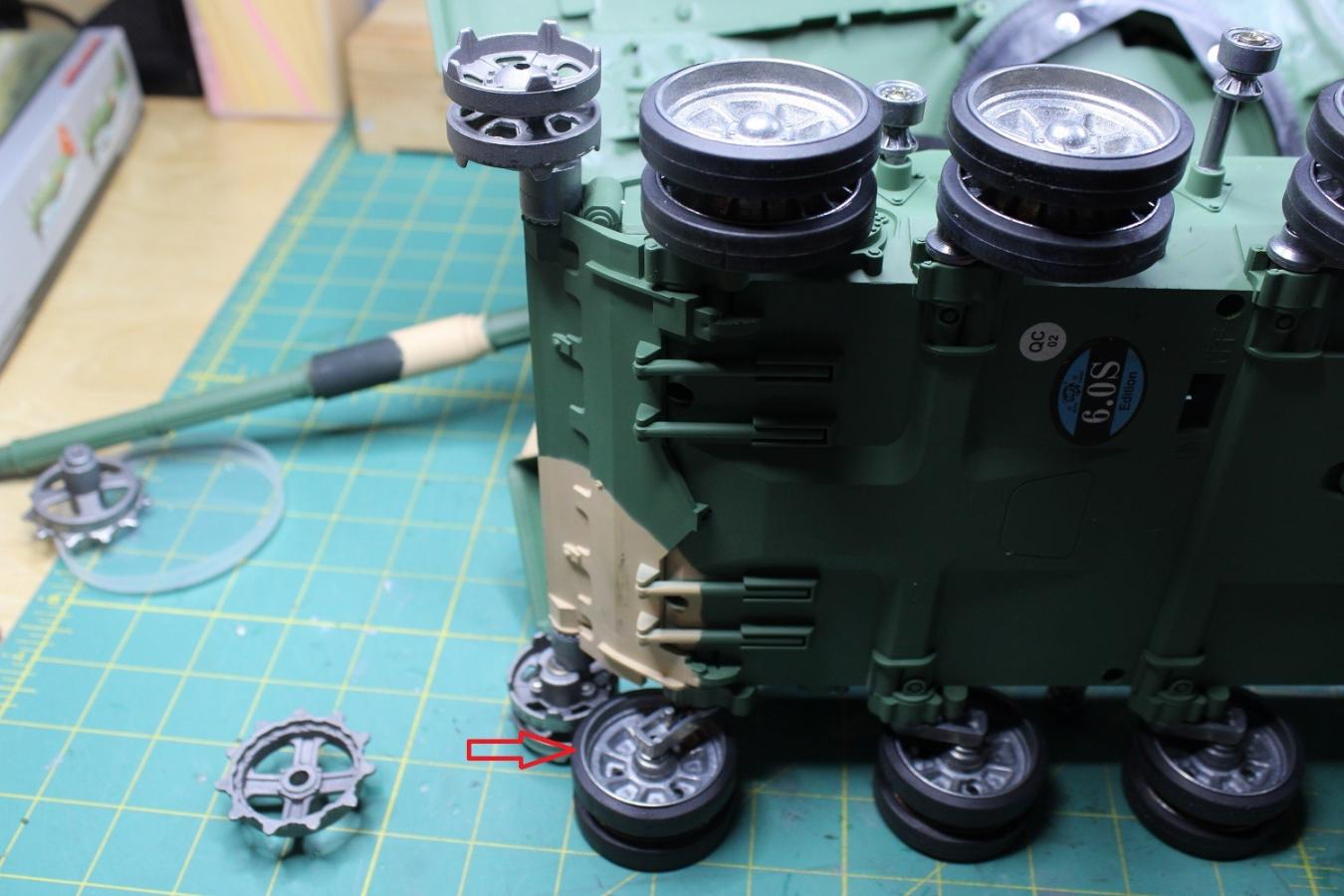

          Hi all,
          Just got home and got the wires reversed as advised. Still no go so I switched the wire motors meaning M1 now goes into M2 and vise versa. And black still goes to red and red goes to black and it works! Thank you all for helping me on this . But I learned a lesson. This is not Tamiya tank with Tamiya electronics. It does not have Futaba or Spektrum electronics. These are nothing more than expensive toy grade hardware and software ( yes I was brought to my attention from a comment on RC Tank Warfare) so I should not expected too much as I did. As long as I have this realistic expectation now I should be happy of what these HL tanks have to offer. I think the reason why the tank could not do a spin is due to the suspension was arm out of place and prevented the idler wheel from turning as seen on photo. Dai
          • dai phan
            • Sep 2020
            • 726
            #25
            Yes the older steel “black gears” do run smoother. Has to do with the way the gear “teeth” are cut. I prefer them over the new steel “silver gears”.
            So forward is reverse and reverse is now forward? If so, I would simply swap the motor power lines around from red/red, blk/blk to red/blk on each motor. This is a common practice and most often done with the red 390 motors. I have never had it hurt anything.
            If reversing the wires does not work then there is another issues.
            I found out not only reverse the wires but may also need to switch the motors to MFU connections too. Dai
