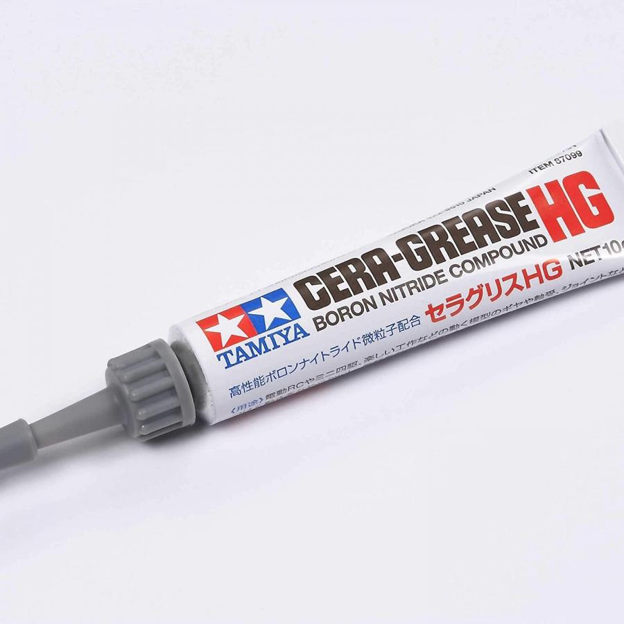

      Thank you Rubicon99 ! Can you please recommend a quality brand name for the greese ? Thank YOU !!! Dai
      • dai phan
        • Sep 2020
        • 726

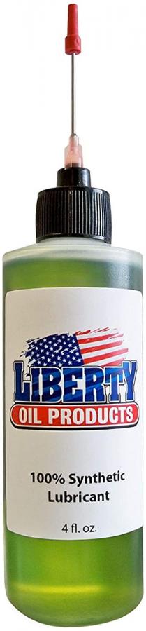

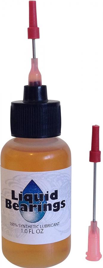

        Just ordered these ... Dai

          I have been using simple Mobile 1 red automotive synthetic bearings grease for decades as my main lube but I also use 20-50 motor oil for some applications. Keep in mind these are simply loose fitting gearboxes so nothing fancy is required.
          Just make sure the gears and bushing are kept wet with some kind of lubricant.

              I put the grease onto the gears and how about the oil ? Dai

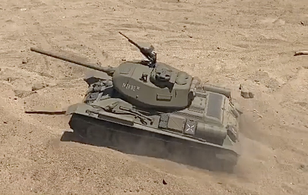

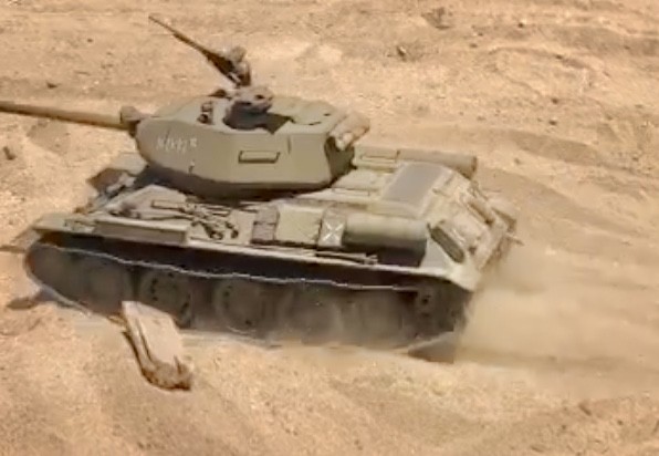

                  I use the oil on the gearbox bushing, bearings (most are not sealed) and gear shafts. One drop on each. How often depends on the frequency of running in moderate to extremely dusty terrain.
                  Example below I would consider moderately dusty and I would service the gearboxes after a few hours of continuous use in it.
                  Click image for larger version  Name:	F5E089D2-779E-4220-BA93-B87407D0D41B.jpeg Views:	0 Size:	179.9 KB ID:	292885
