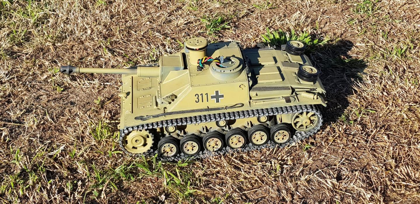

                  • OKC_Jim
                    • 53
                    My Heng Long Stug IIIG with Clark TK40S board. Really glad I went with the Clark. Love all the options it has over the standard Heng Long. LegoDEI IR receiver with a PVC pipe mount. The mount is attached with a magnet. Receiver and mount can be removed or reattached in just a few seconds.
