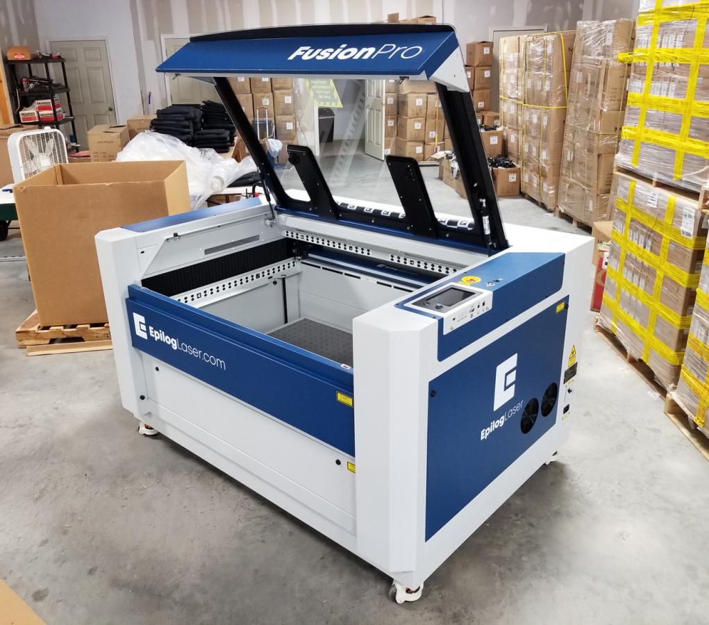

                                    I'm in the process of dealing with Cupola glass myself. I have some acrylic at work, as well as a decent Laser etcher/cutter:
                                    If I take real good measurements with a caliper, I should be able to cut out each individual pieces to pop right in, but my question is, How would I tint it? or should I I say, stain it ?
                                    I've even contemplated going to a tint shop and seeing if I could score some scrap blue window tint? (Abrams)

                                        I've read people use adhesive metallic vinyl wrap or even those dollar store whistles with the colorful foil fringes to glue to the window pieces. If you manage to cut these pieces, I'd love to purchase a set if you can make extras.
