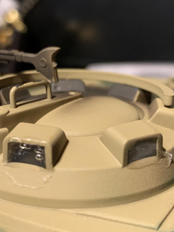

                I used the blunt end of one of the paint brushes.. Circled the hole, then with a blob on the end of the brush, dragged the liquid across the hole, If it did not cover, added more to the brush end and did it again until it covered. it left a milky covering. Let it dry only to discover they don't make Ziess quality lenses.,

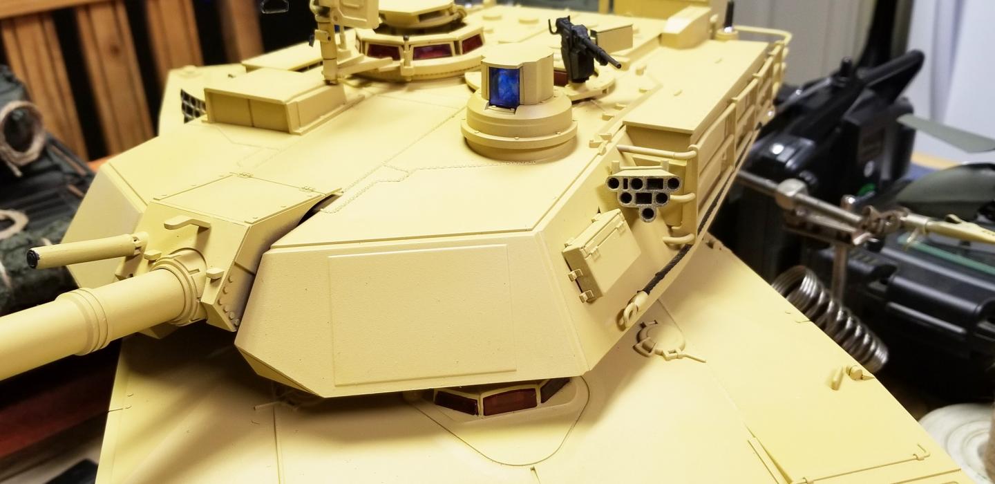

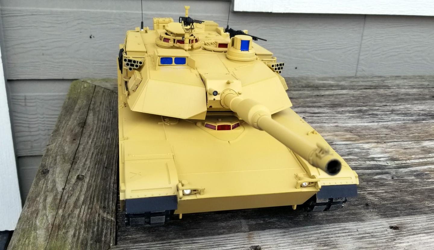

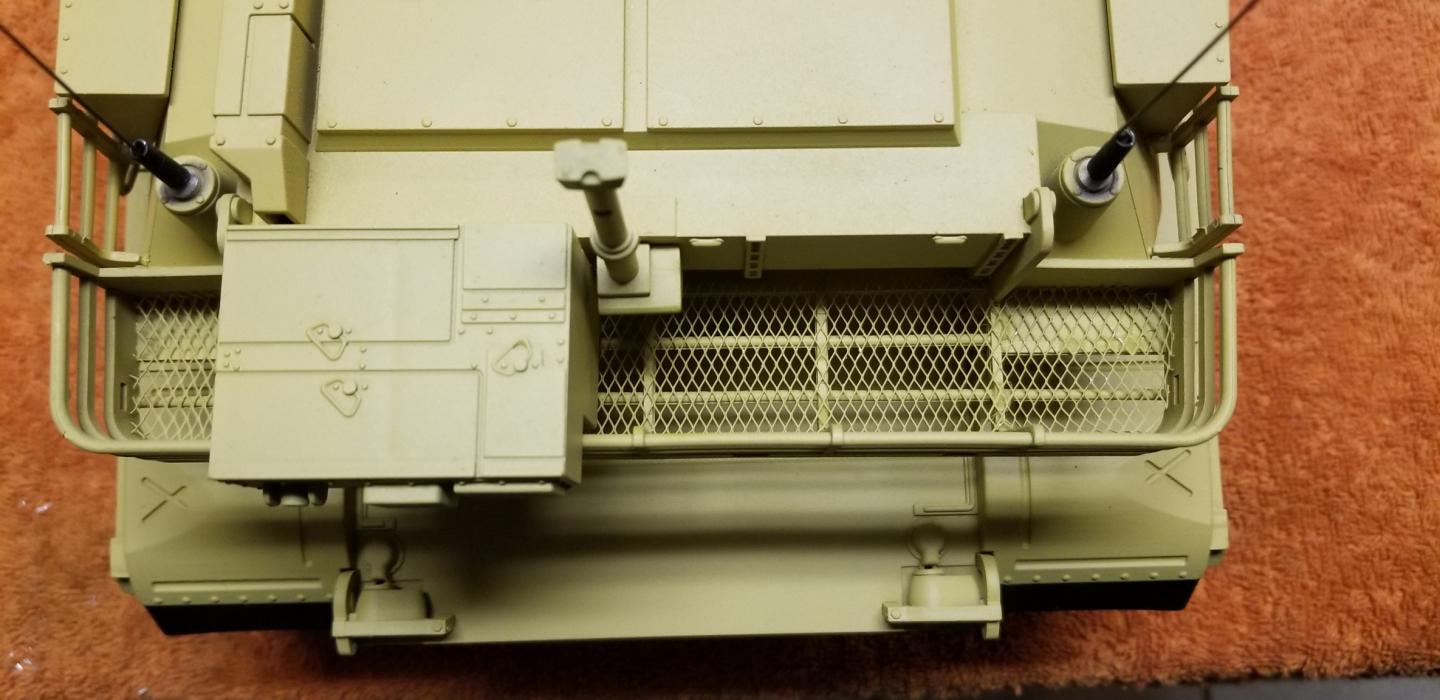

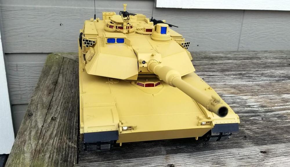

                    All the glass is in.....I ended up using the thick acrylic because my laser simply melted & deformed the thin plastic I had. The acrylic also threw me a curveball I didn't anticipate. The periscopes are "boxed in" from behind and because my "glass" was thick I had to shape the backside to fit. My laser of course is not 3 axis, so I had to sand, fit, sand, fit, sand, fit....etc. The back & sides of the glass on the commanders, loaders & drivers pariscope's were painted using testor's "stop sign red". Because only the backs & sides were painted, it still has a nice 3D glass look. The CITV glass has the blue mylar film glued to the back of it that canklebreaker suggested ....thanx ! That was a miserable experience and a real PITA. Glad that's over. I figured out a way to put glass in the range finder..so thats next on the list.

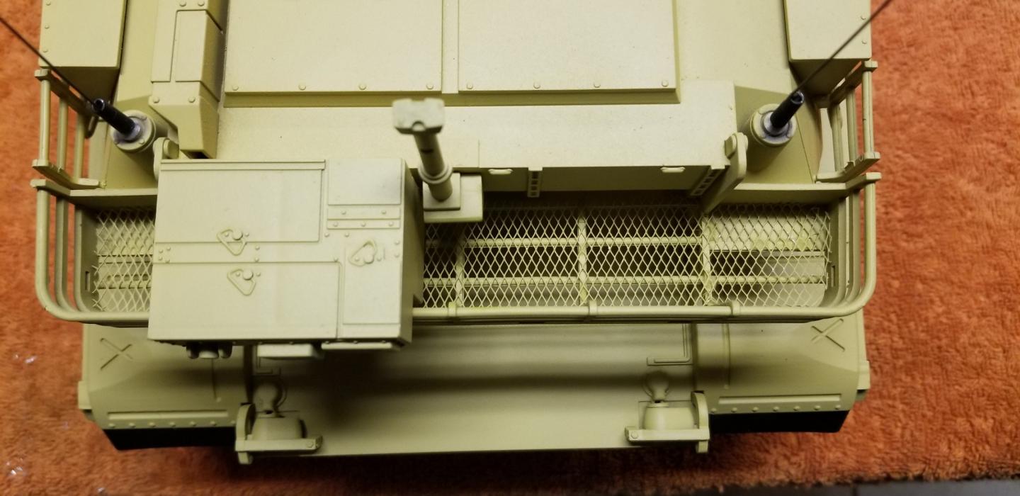

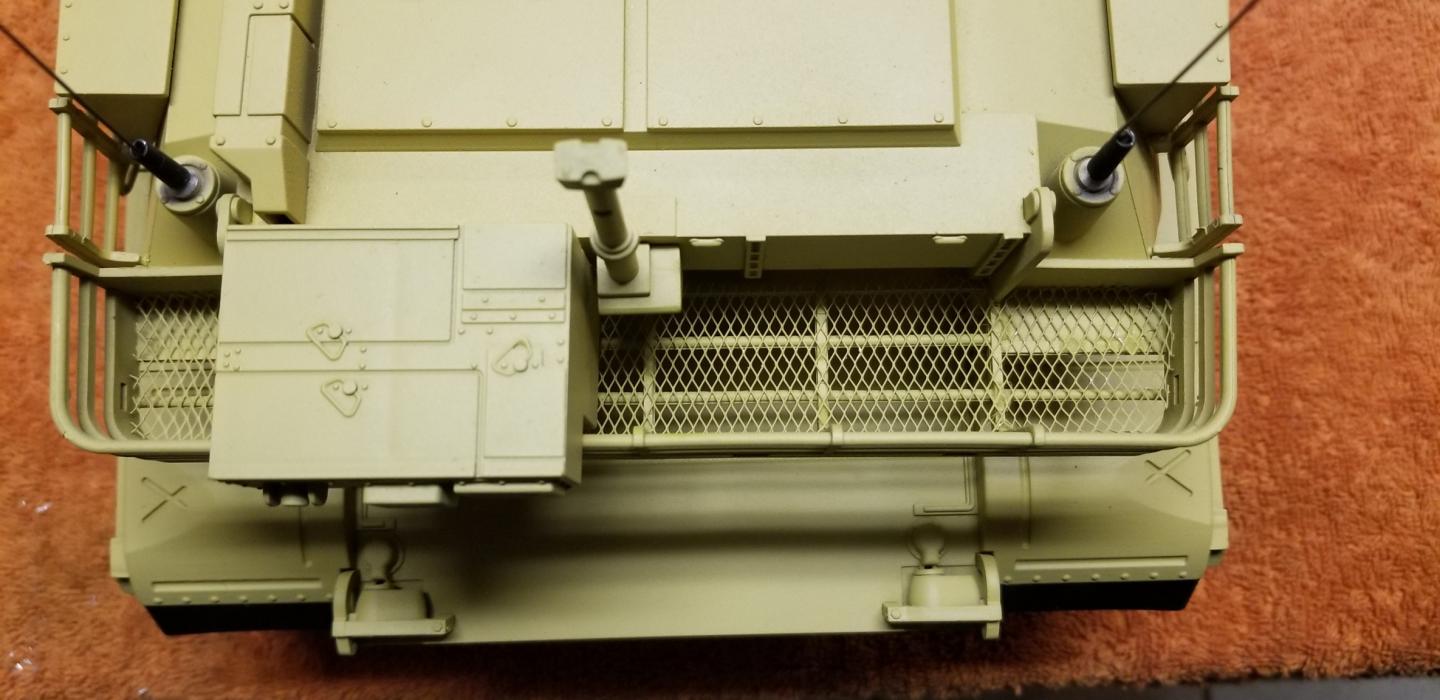

                    Got the "steel grate" laid down in the bustle as well....
