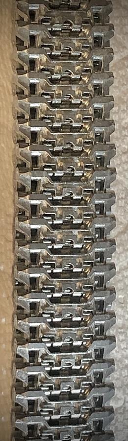

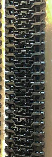

        This is the CS track. I have a set and sprockets for it. It's great looking well made track. BUT it does not run well on my HL Merkava. The sprockets have a wobble that is not drive shaft related. This causes them to not mess well with the tracks and makes the entire use of the CS tracks a step backwards in running performance. I would not recommend them at this time.
        Before blackening.

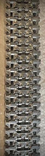

        After blackening.

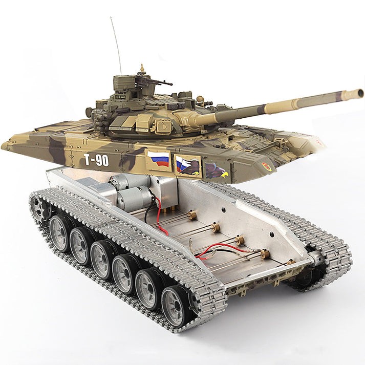

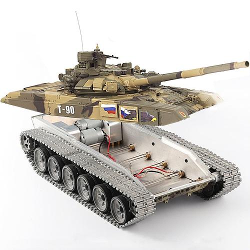

                        Heng Long market 1:16 scale all metal chassis RC tank such as the T-90 here:

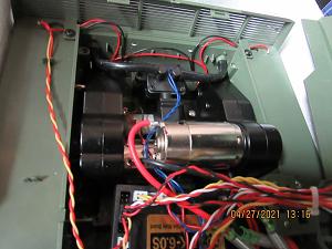

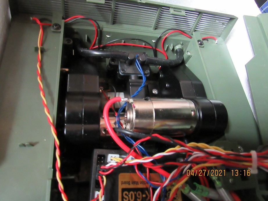

                        The 540/550 series motor may be the right size for the all metal chassis. For typical plastic chassis HL, I agree that a 390 pair is more than sufficient.

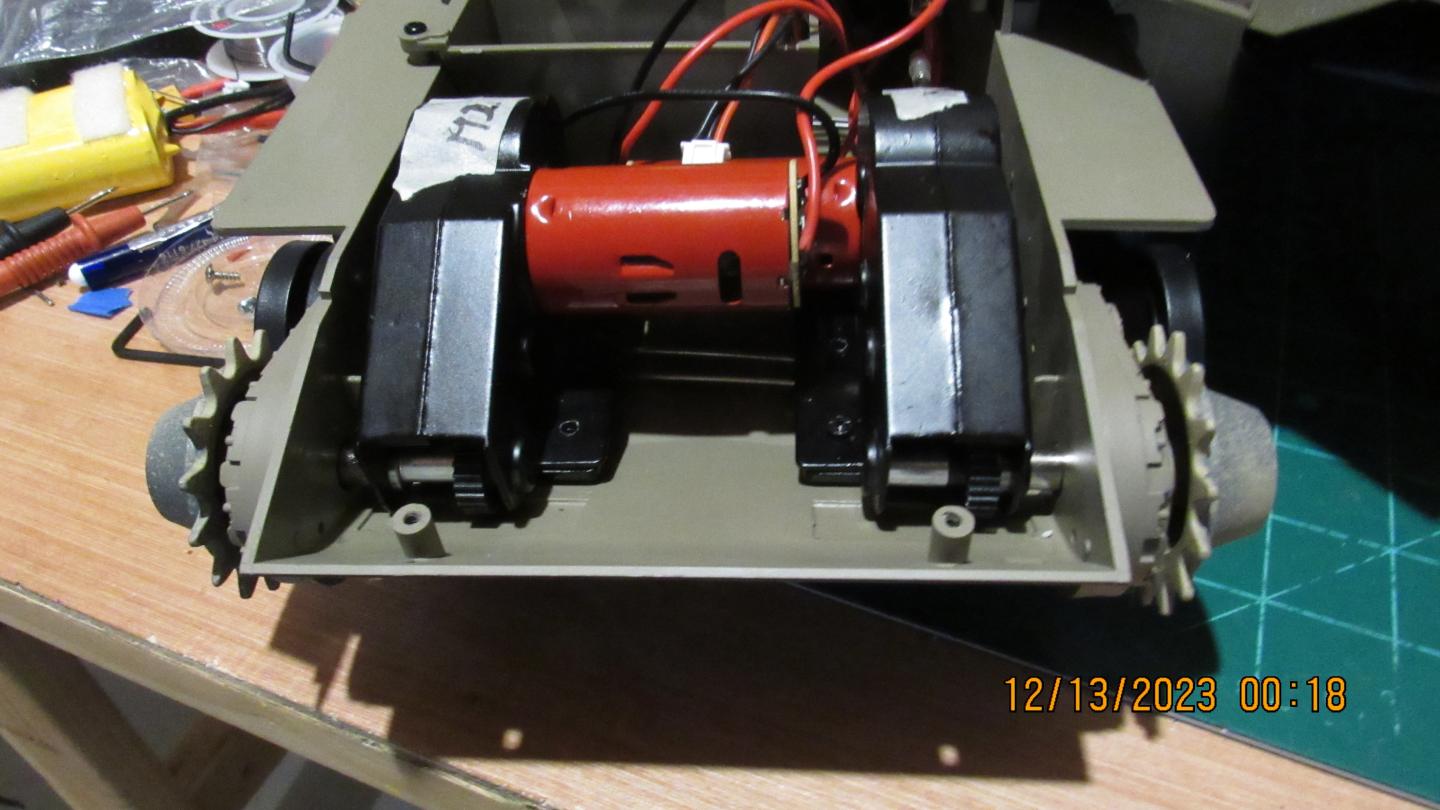

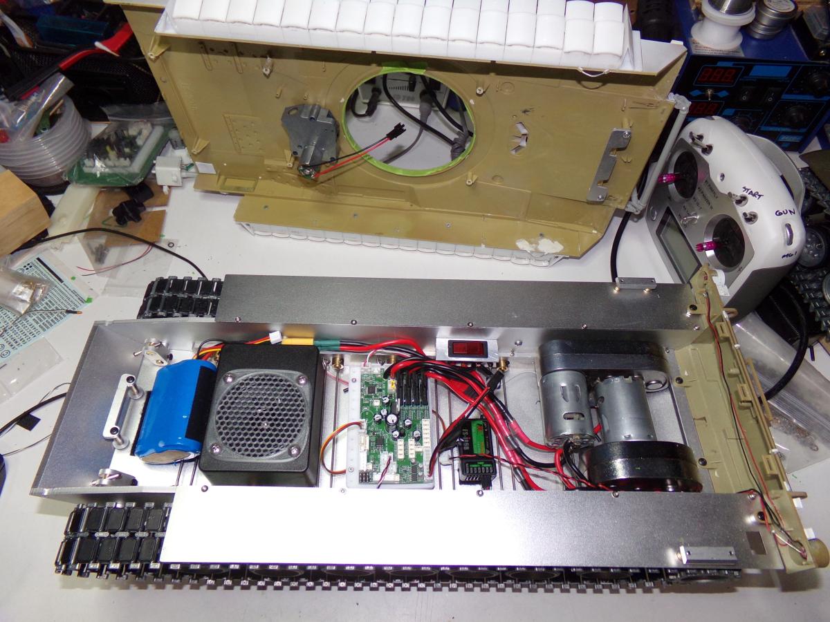

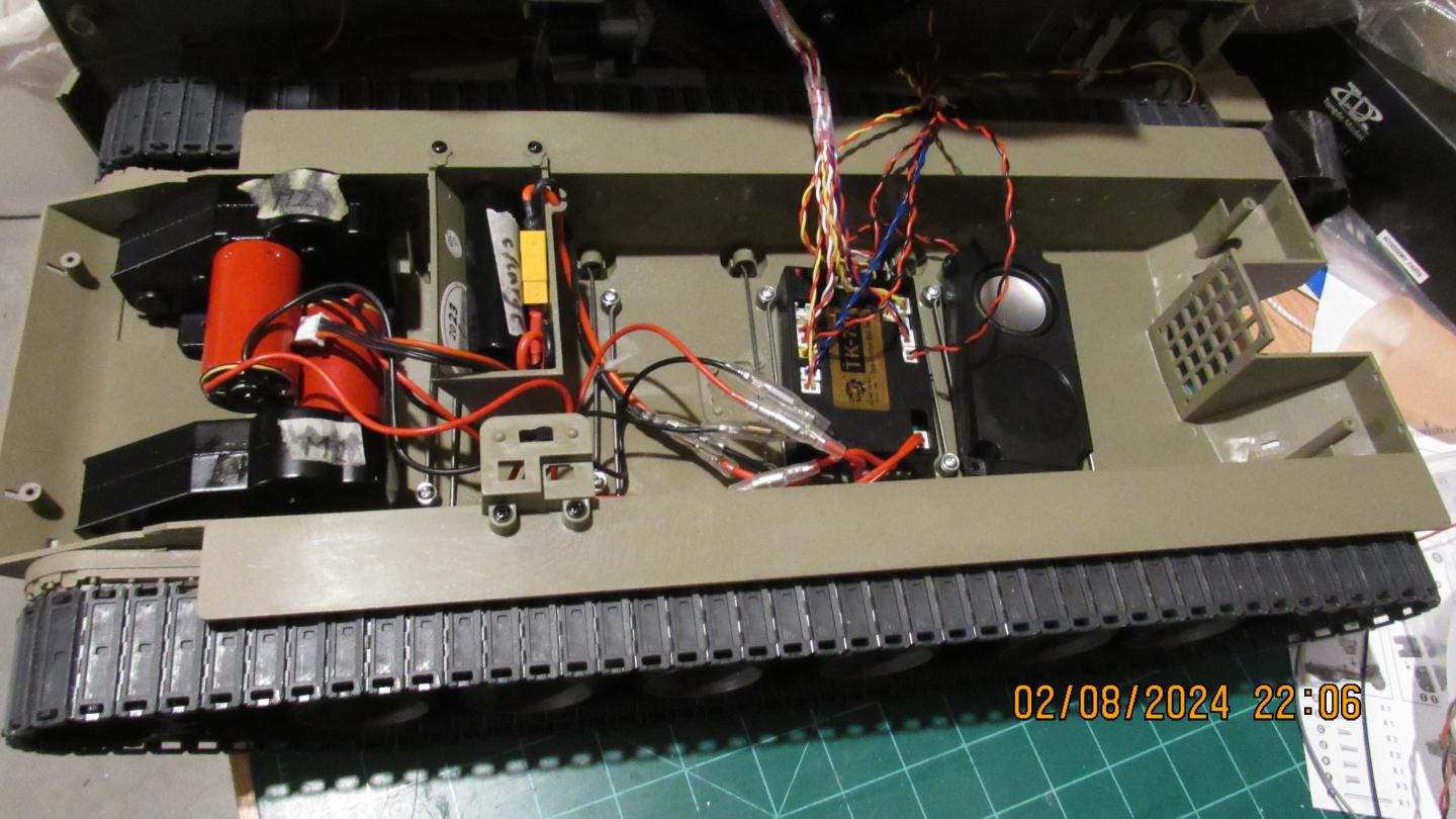

                          My HL Abrams is using dual 540 motors and runs quite well on those. They are the same gearboxes that DKLM RC sells in their Leo 2A6 all metal chassis except I replaced the longer 550s with 540s as the 550s were too tight a fit for my liking. They are soldered to a Clark TK80 board. The switch has been beefed up to a 20A switch as power is going through it.

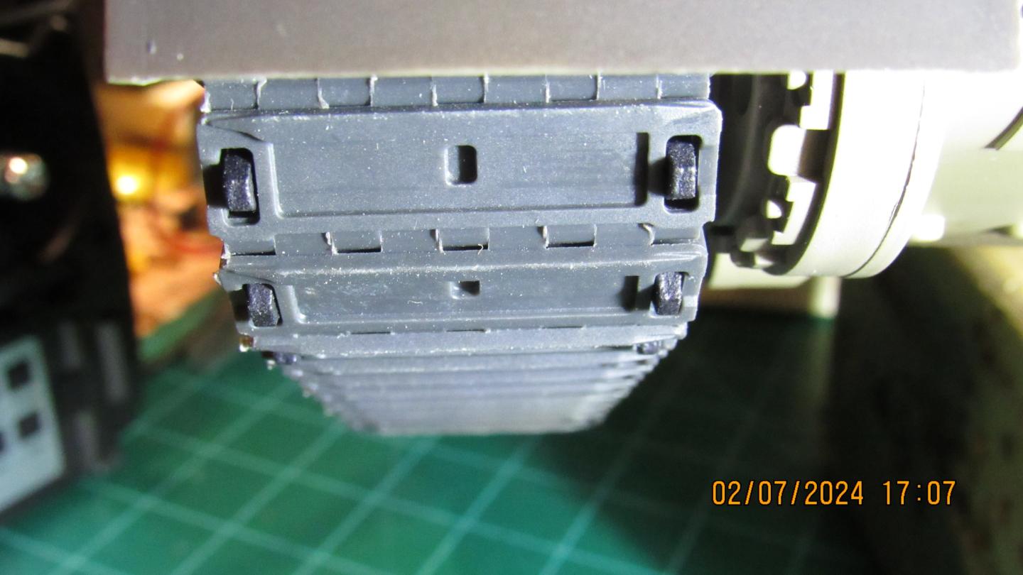

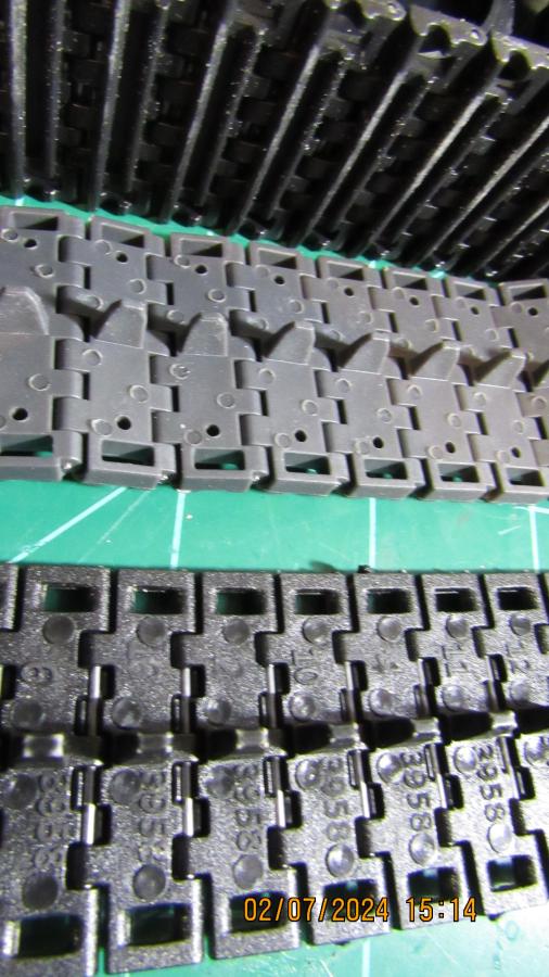

                                    Now that I completed the adaptation of the Hooben nylon track/sprocket to the Heng Long Merkava, I fully appreciate your comment on the Hooben Merkava. The Hooben parts did a tremendous job in enhancing the HL Merkava.
                                    On the issue of Hooben's customer service, I received the track in 2 weeks and the sprocket in 7 weeks. In your word, "very typical Chinese business attitude". During that time, I have had no problem communicating with Hooben by regular email.
