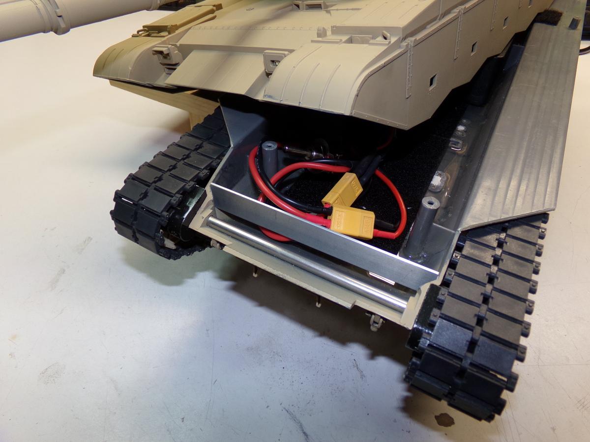

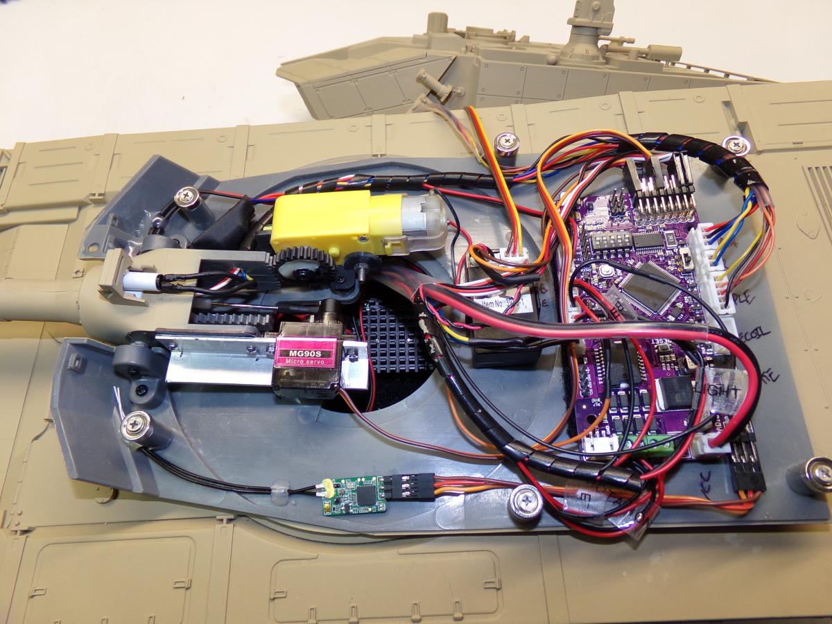

          Just a heads up. The Hooben ZTZ has a reputation of being really fragile like their Merkava.
          Yeah, my Hooben ZTZ burned up it's recoil servo the first time I use the tank. That's why I had to mount that aluminum arm on it to relocate the servo so it would work right. The suspension arms move around a lot as in wobble laterally. I've never taken it on the battlefield as I don't think it will hold up very well. Maybe one of these days I will. I need to try different electronics in it as the TCB doesn't seem to be working with the gearboxes. I get weird driving characteristics, but that's not Hooben's fault. I even put a different TCB in it with the same results.

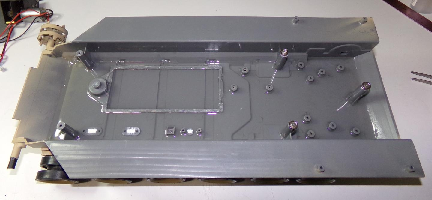

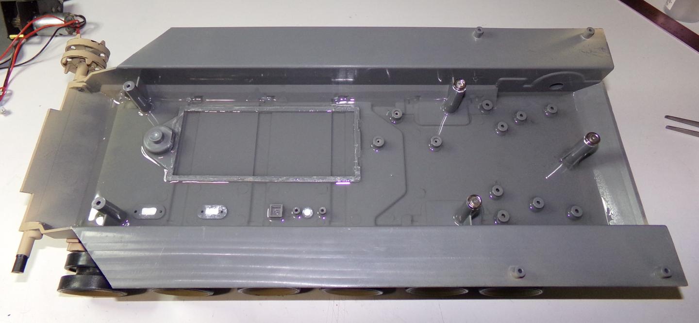

          The idlers mounts were just plastic shafts sticking out of the chassis with plastic on plastic contact for the idler. I also replaced the idler mounts with a T72/T90 type Henntec and added bearing to the idlers.

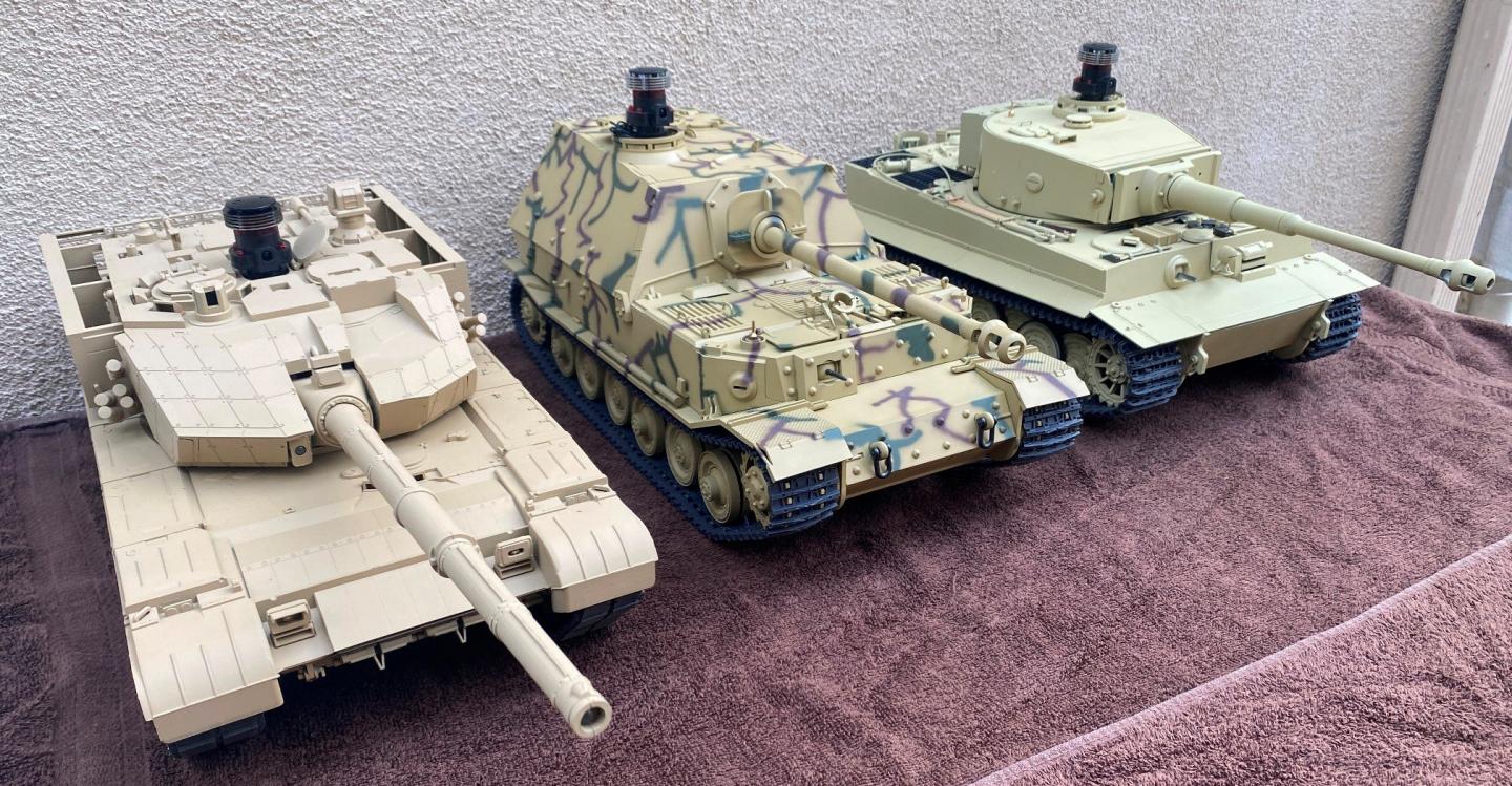

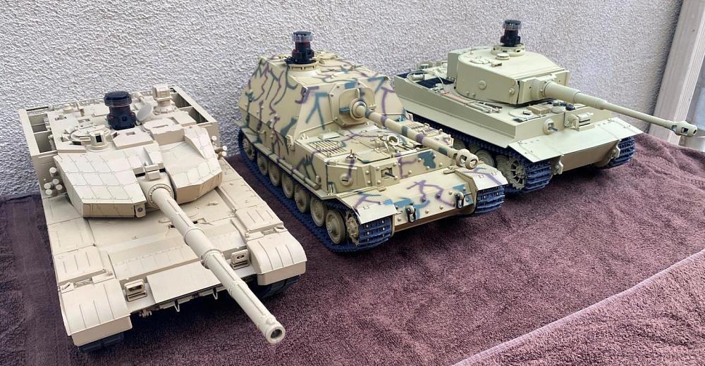

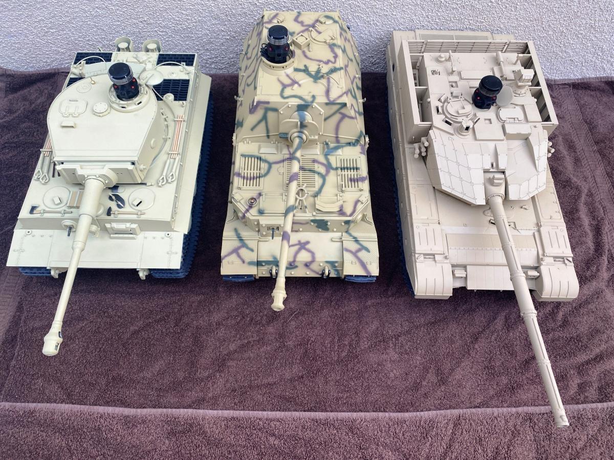

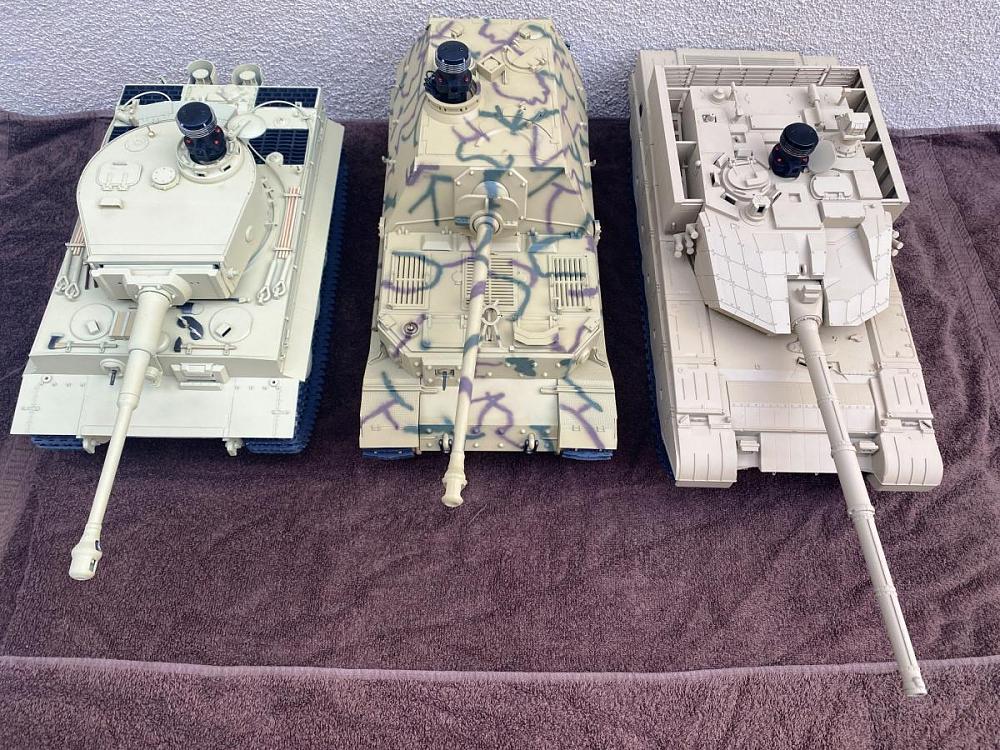

            All three of my tanks are made with strong plastic. They have almost 90% of the accessories on tank already. I did not have to install anything except I will have to do the weathering and the decals.
            Click image for larger version  Name:	IMG_1497A.jpg Views:	0 Size:	256.9 KB ID:	406224 Click image for larger version  Name:	IMG_1496A.jpg Views:	0 Size:	253.0 KB ID:	406225

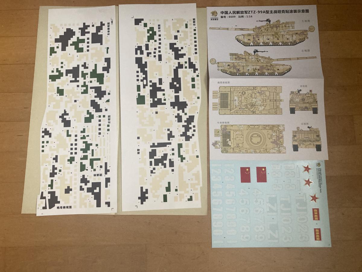

              The decal set for the ZTZ99 .....

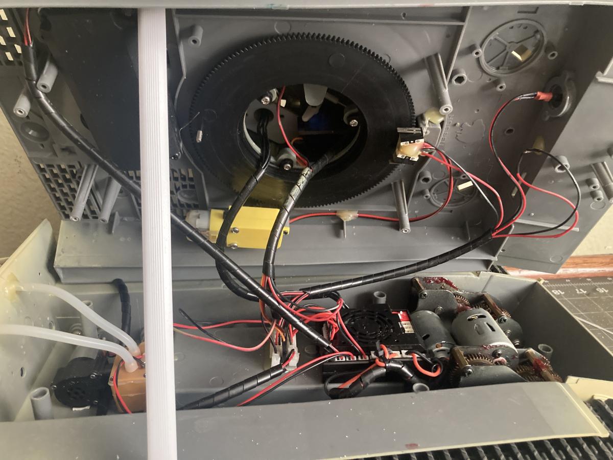

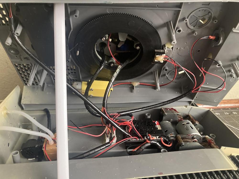

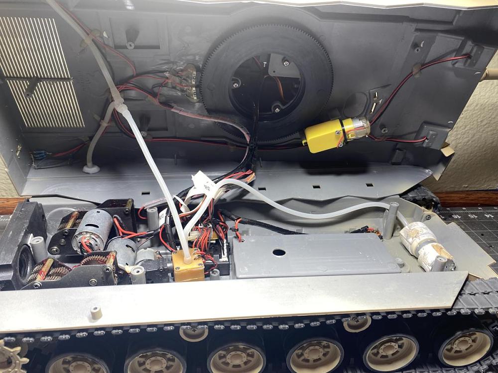

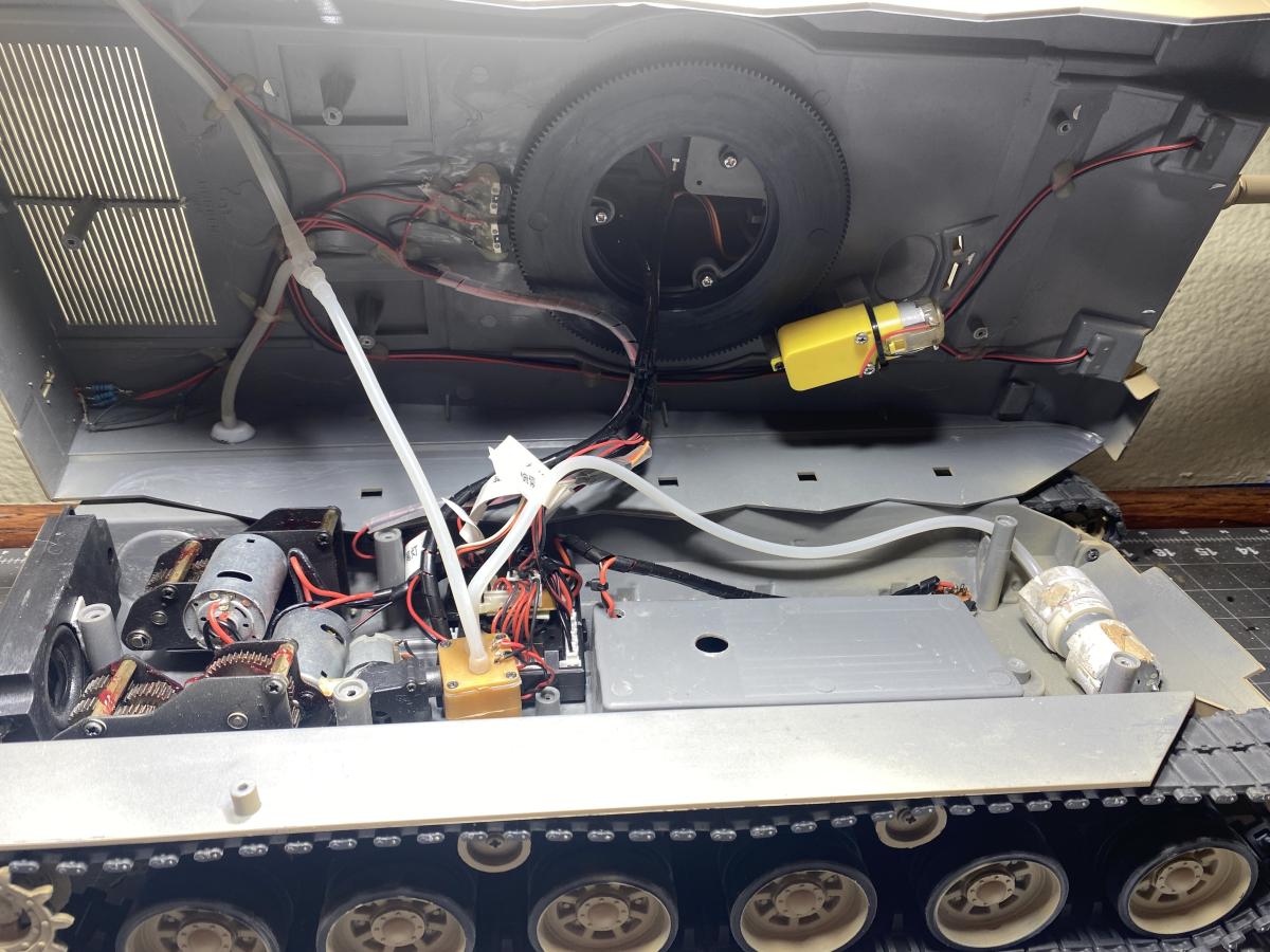

                  I am interested in the motors. Are there differences between the models?
                  They are all the same....
                  The ZTZ99...
                  The Cromwell....
                  The Tiger I...

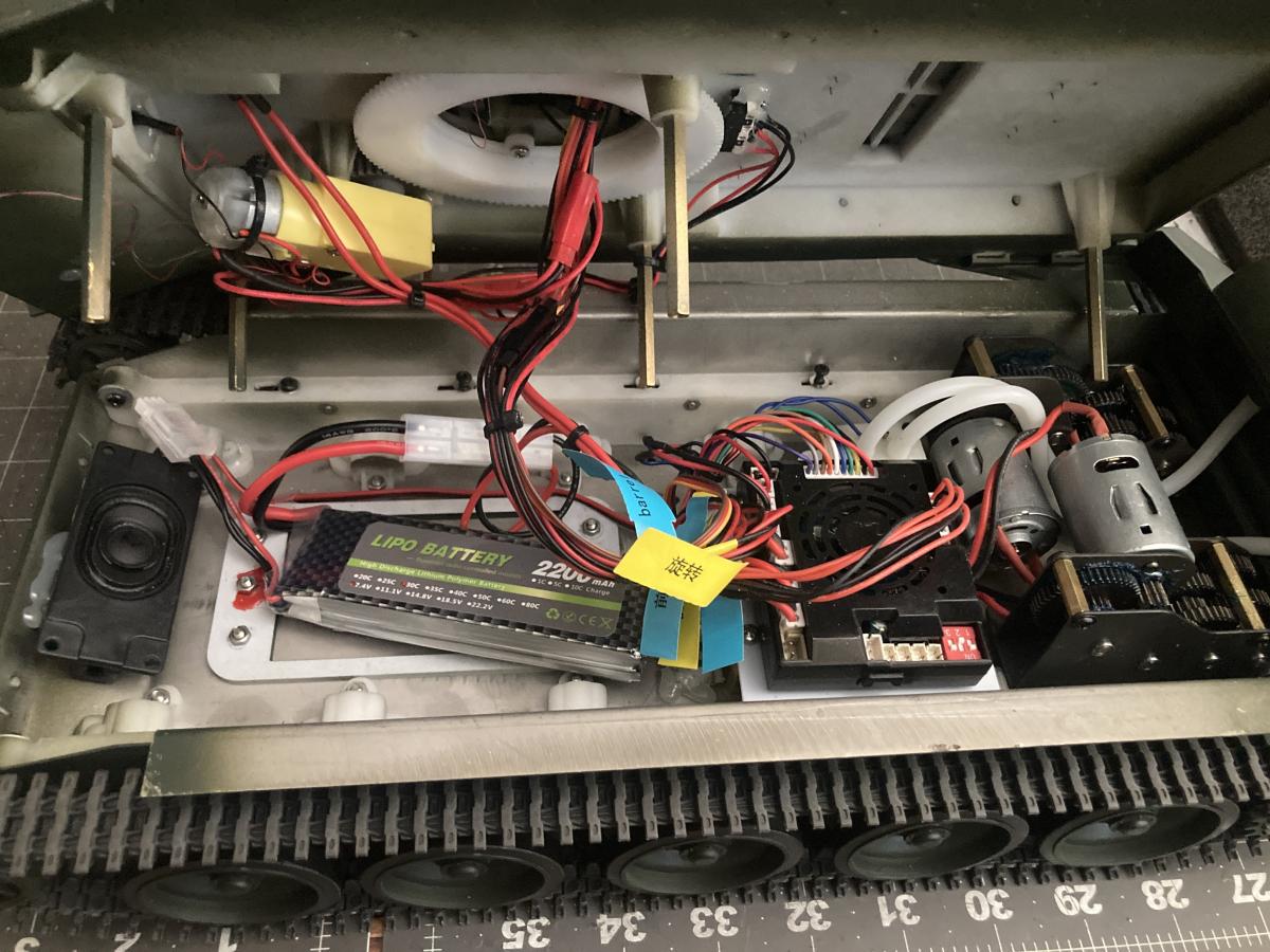

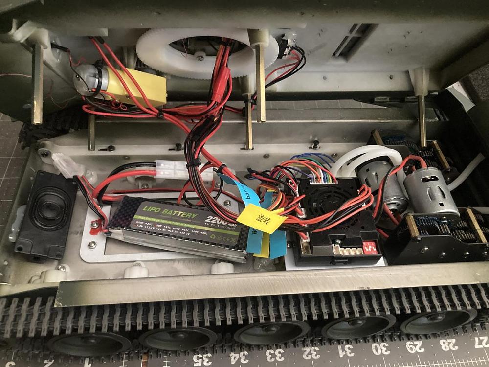

                    Do they all have the same plastic on plastic idler wheels like tank_me ZTZ99?

                          Do you mean the gearbox when you referred to "transmission"? I went to the Hooben website and found only the HL CNC gearbox for their 1:16 scale tanks. Did they package a different gearbox in the Leo 1A5 and Merkava 4M?
                          In DavidN pictures of the Hooben interior, the gearbox seemed to be an open frame gearbox with sleeve bearings. Not an acceptable pairing for the Hooben price point. Can you show some picture of the transmission failed bearings?

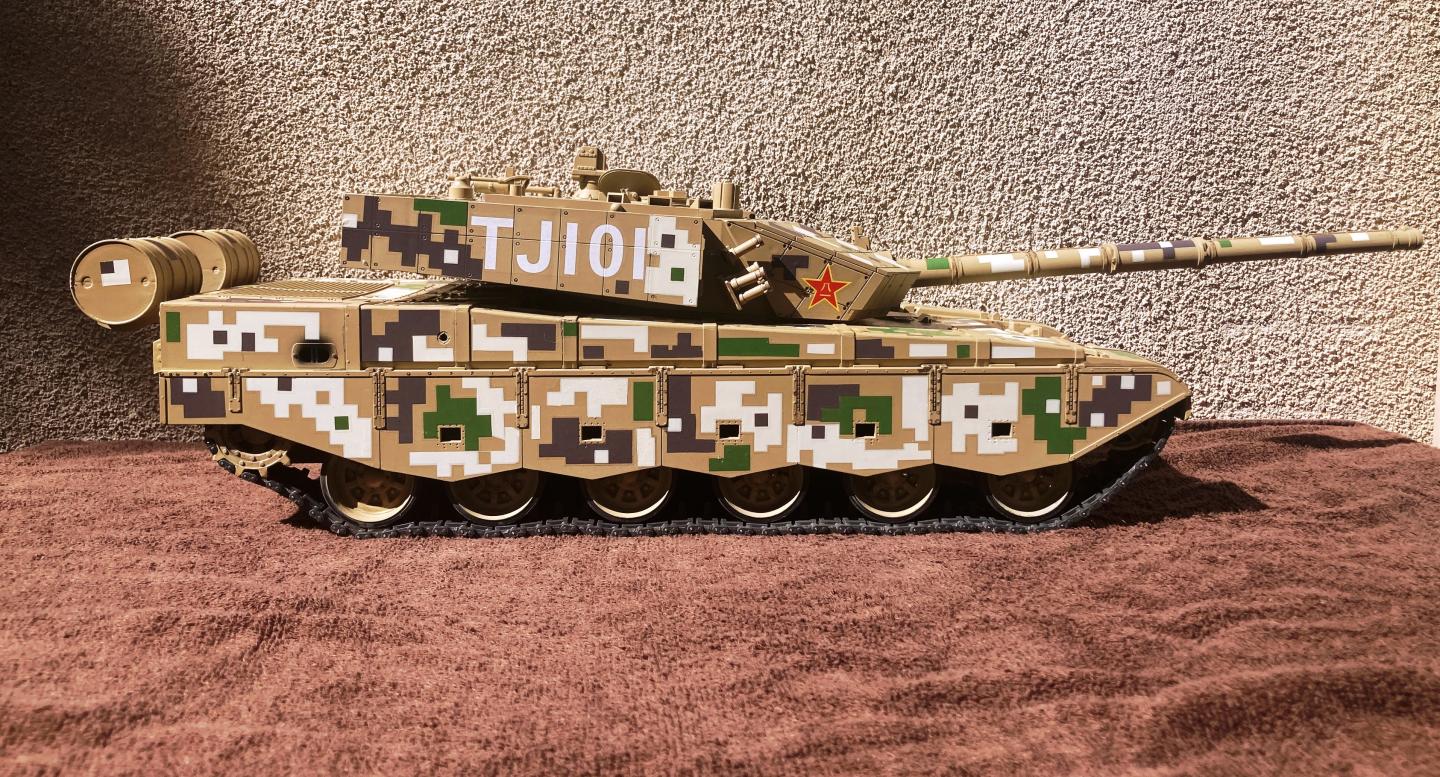

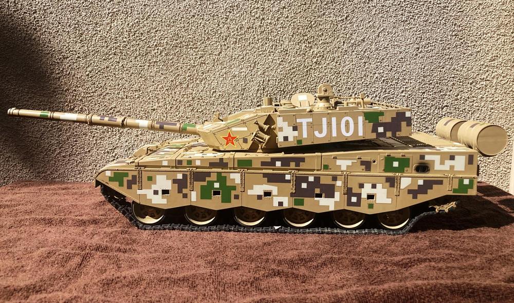

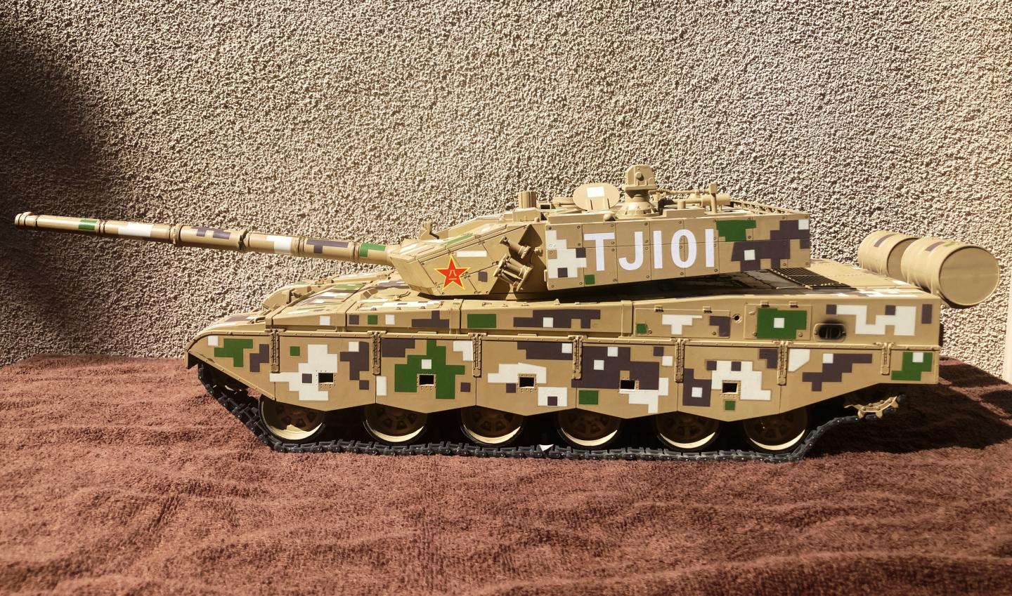

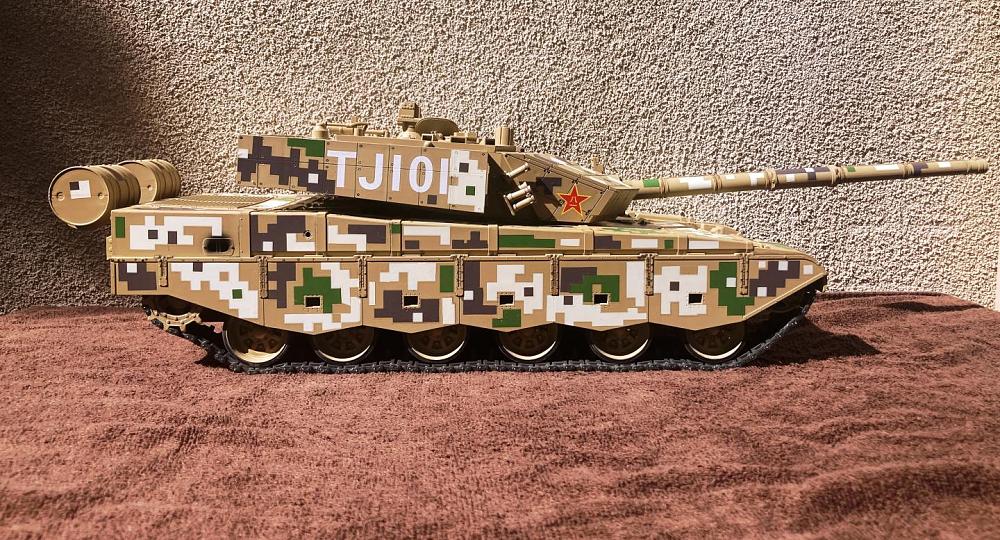

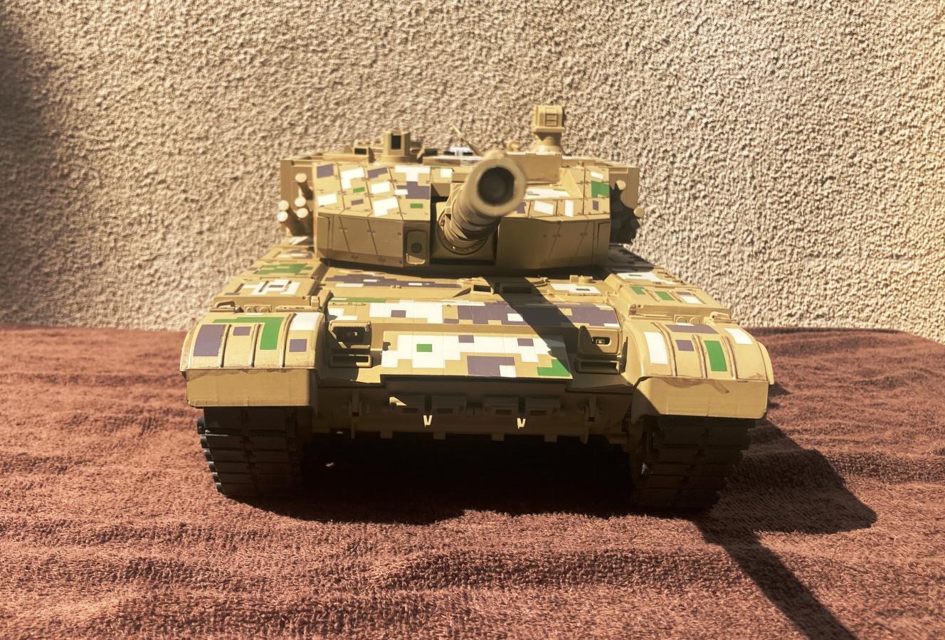

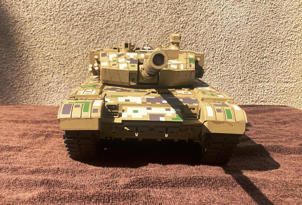

                                          My Hooben ZTZ-99 is done.
ID:	406852 Click image for larger version
ID:	406853 Click image for larger version
