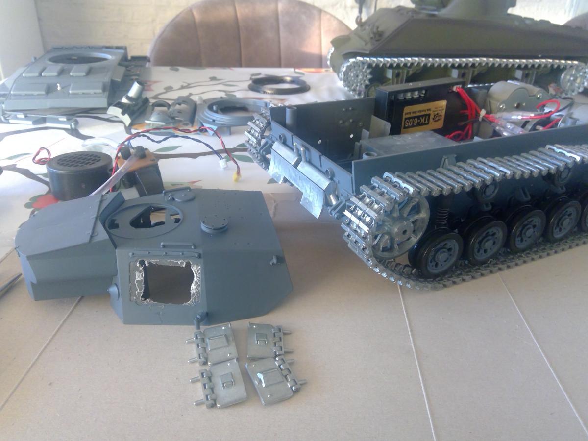

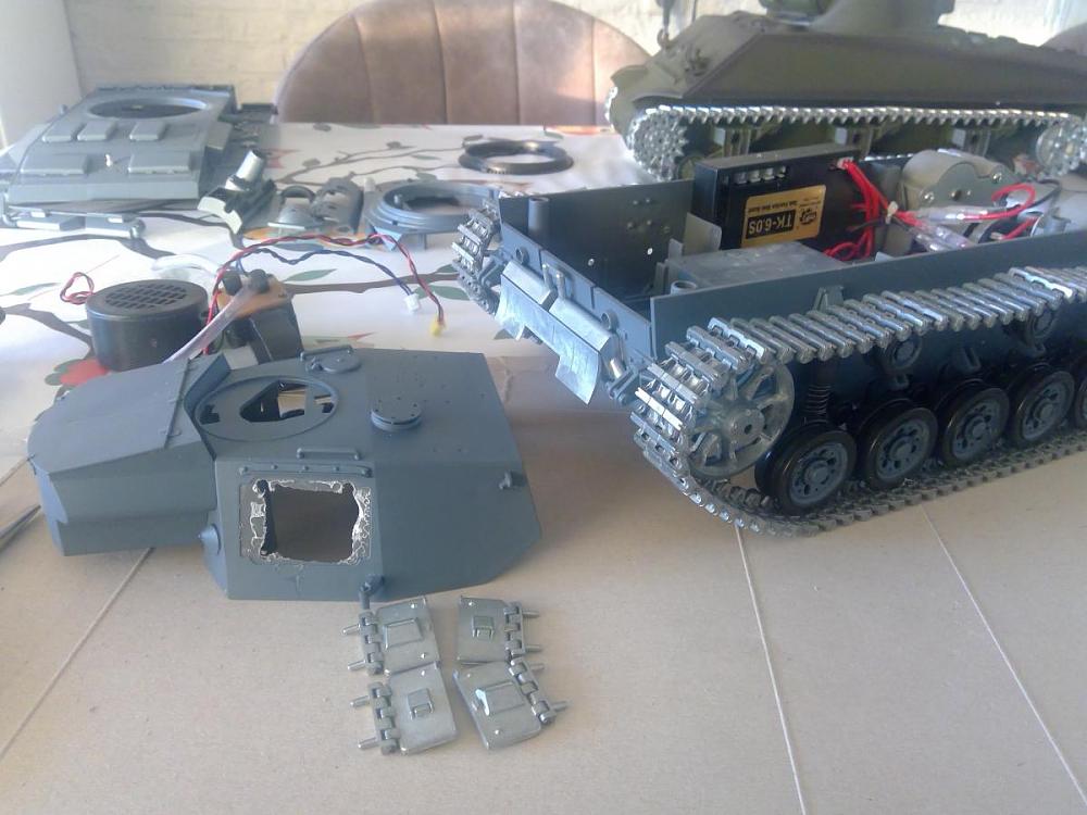

    And so it begins. Heng Long panzer III.
    I replaced the previous metal tracks with Taigen tracks. The reason was because the metal tracks were missing a link so I couldn't get sufficient lack in the tracks. But these Taigens are a lot more detailed. So bonus there.
    I also replaced the exhaust assembly and rear guard for a metal version. The plastic rear guard was broken, and seems a fragile piece anyway.
    Finally I removed the plastic side hatches in the turret. Man, Heng Long used a LOT of glue on these. Still need to clean up the edges and print some "buckets" to go behind the holes. Metal hatches will be installed.
    The ausf. N aluminium gun barrel 37L/24 I ordered looks like it wasn't meant for barrel recoil. Unfortunately I have no metal turning machine, so I'll have to order a new one. I'm still undecided on going the cheap route for barrel recoil (modify the BB-unit) or the more expensive route (Get a 6.1 MFU and servo recoil unit).
    Also still undecided on the Schürzen that I want to do. Buy a kit or make them myself.

    I was surprised when I got my new Panzer III and the turret doors were glued shut.
    Both of my Panzer IV's and my old 27mhz Panzer III have doors that open and close.
    Steve
    • #3
      Yeah, I saw from pictures that they were probably glued, but never expected this amount of glue. To be honest, they were generous with glue on this tank throughout.

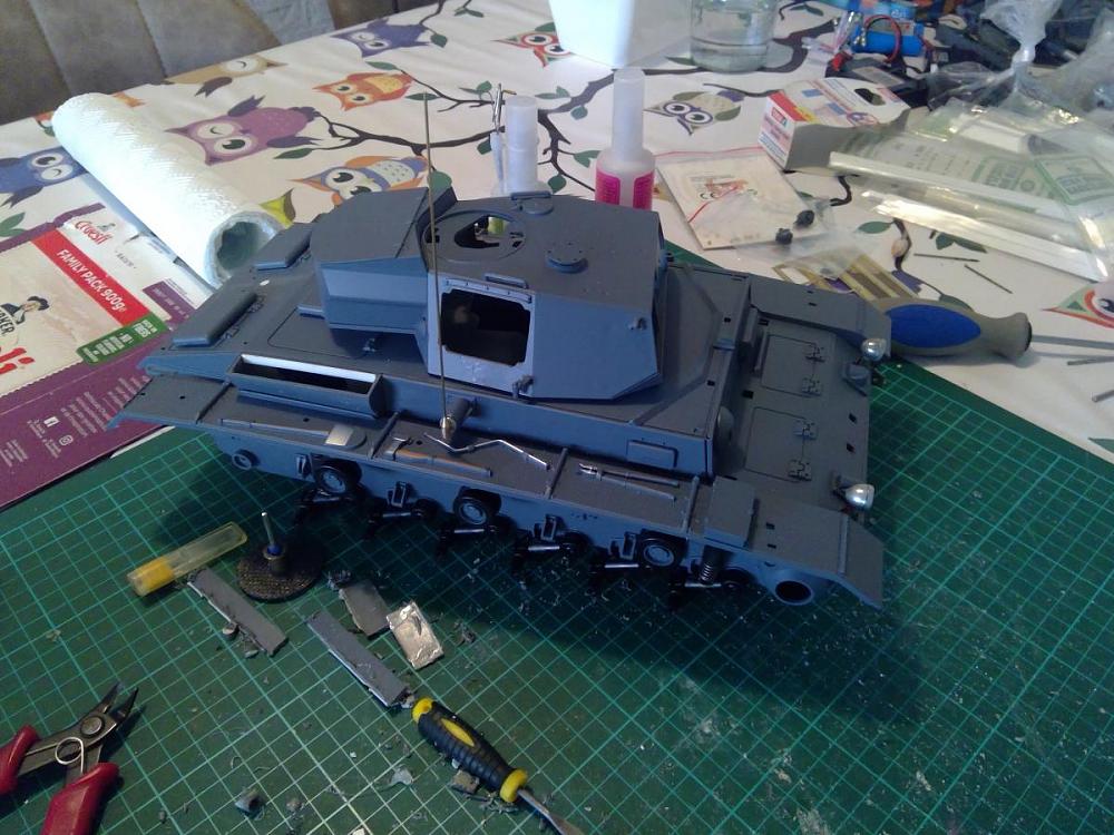

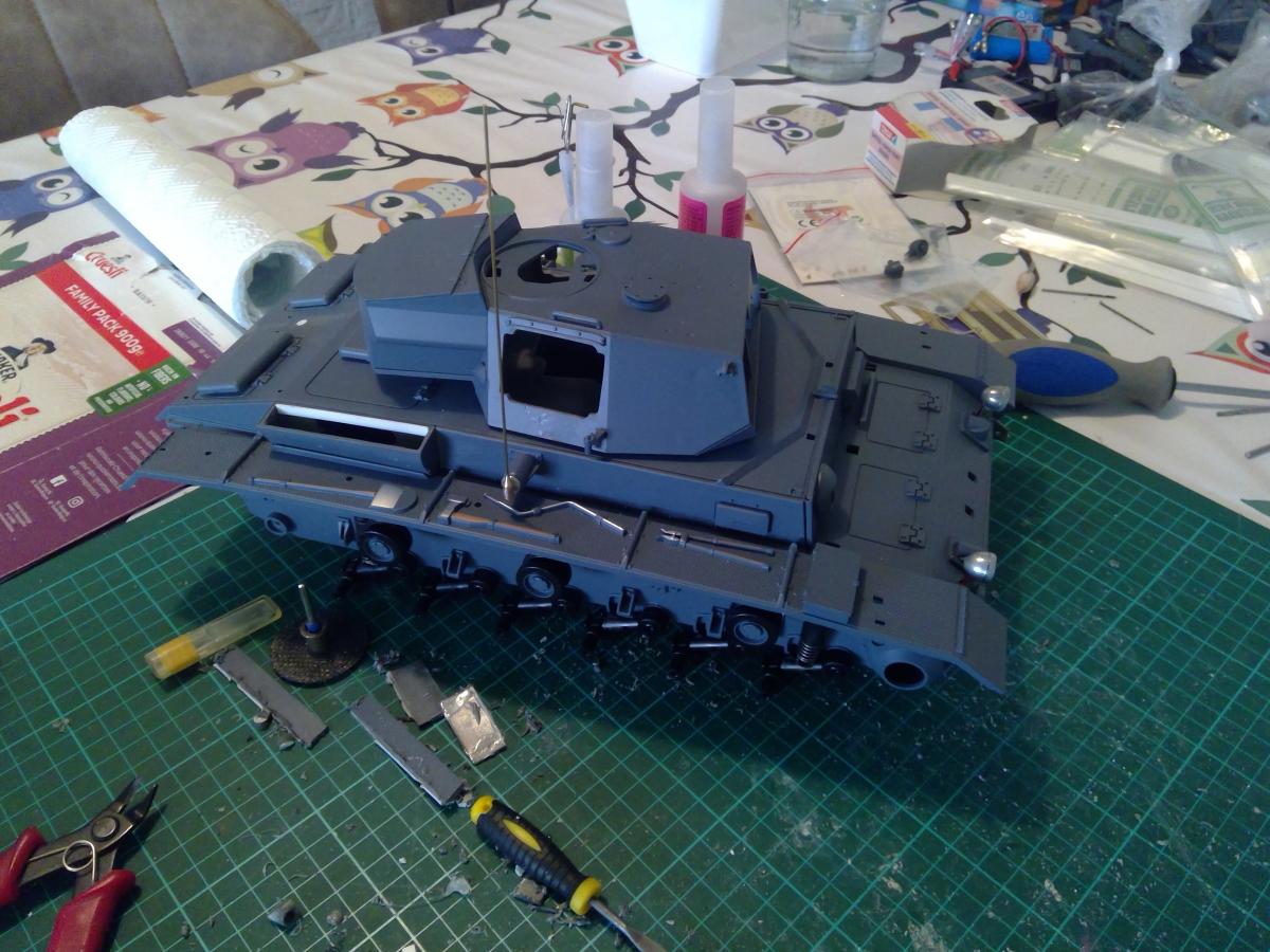

        I got most parts for the Panzer III in, so it was time to continue working on it.
        Still waiting on the 6.1 MFU and barrel smoker though. Chinese New Year has kept Toucan from sending it to me yet.
        Also waiting on a response from a German website that sells early style notek convoy lights. Sent them a question last weekend and again two days ago through Facebook. Still no reply. I think I'll give up and make something in 3D and try to mount a small SMD led in it.
        The shop is called Heike's Modellbaugasse. Anyone familiar with them?
        Anyway, bit of progress from yesterday afternoon and today:
        - Cleaned up the turret hatches in preparation of 3D printed inserts to mount the metal doors to.
        - I got that weird Panzer III antenna from one of the tank webshops. The antenna base doesn't look anything like it's supposed to, so I'm going to modify.
        - Opened up the side air intakes. Will be covered by a set of PE screens.
        - Dry fitted metal headlights.
        - Not pictured: Removed the plastic idler adjuster and dryfitted metal Taigen ones. Only to discover that the metal set is for the older Panzer III, as the swing arms don't fit. So I'll remain using the plastic swing arms
        - Not pictured: Cleaned metal wheels with vinegar and coated them in etching primer. Already feels like a smart choice.
        Click image for larger version  Name:	WIN_20210220_17_22_59_Pro.jpg Views:	0 Size:	151.2 KB ID:	300194

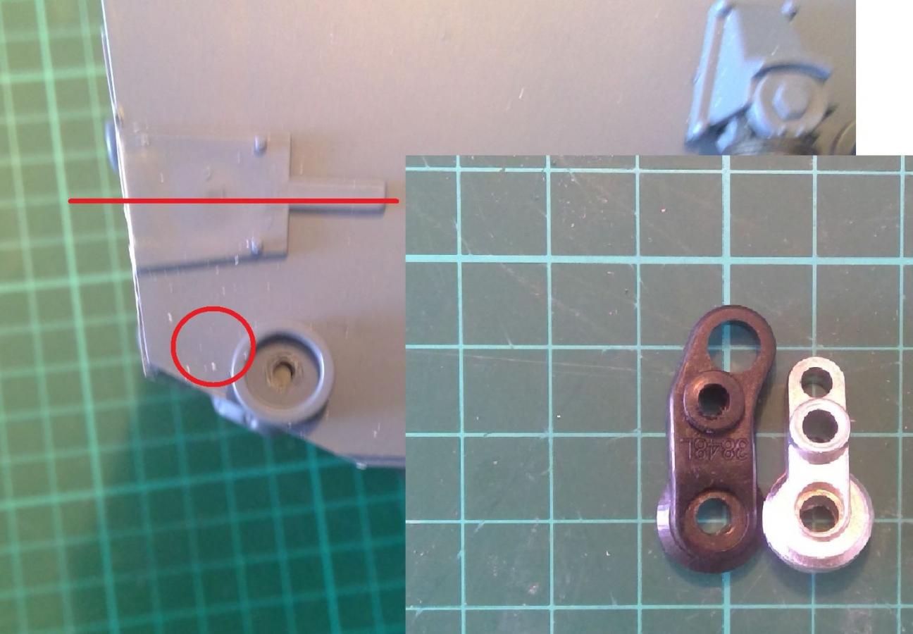

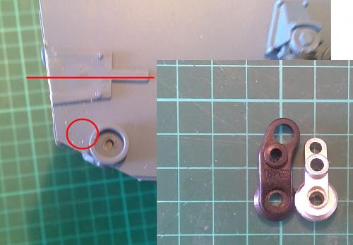

          Can you tell me more about the swing arms? Are you putting in a Mato track adjuster?
          • #6
            Not sure about the barrel that you ordered; but when I converted my PIII to recoil, I used the Taigen/Torro unit. It bolted right in and need very minor modification to get full elevation.
            • #7
              EDIT: I was confused on what I bought: They were indeed Mato track adjusters. I edited the post below. So maybe Taigens will actually fit.
              I used Mato metal track adjusters. But the Mati metal swing arm is too short for use on the 6.0 version Heng Long. It appears the older Heng Long Panzer III had it's idler wheels more to the rear and up. Also it screws into the Panzer side differently, so it's not readily adaptable. So I'll just be using the original plastic arm in conjunction with the Mato set. It appears sturdy enough.
              Like this (see picture below):
              Black arm is the original HL
              Metal arm is Mato
              Red circle is the approximate location of the old HL idler position
              Red line is the approximate location of the adjuster screw
              Click image for larger version  Name:	tensioner.JPG Views:	0 Size:	86.7 KB ID:	300340

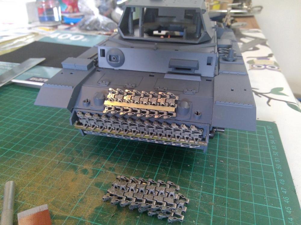

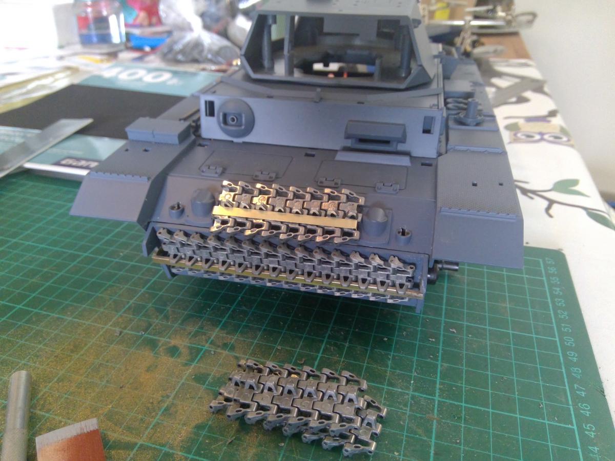

                  Todays work: Made some brass racks for spare tracks.
                  The bottom one is soldered. An experiment for me. I got myself a hobby gas torch, as I want to make a brass stowage rack for on top of the engine deck. The track rack seemed like a good way to practice.
                  Still undecided if I want to add more spare tracks to either the turret top or on the spaced armor plate between the gunner and driver.

                    Your Idler arm is different from mine. Any Idea how to bolt the idler wheel to the new arm?
                    • #11
                      It's the same arm. But I see you have the older style Panzer III so that's good, should fit.
                      You'll need to do some surgery to fit the whole contraption. I found this tutorial that should help:
                      MT030 1/16 Panzer III Tank Track Tensioner (matotoys.com)
