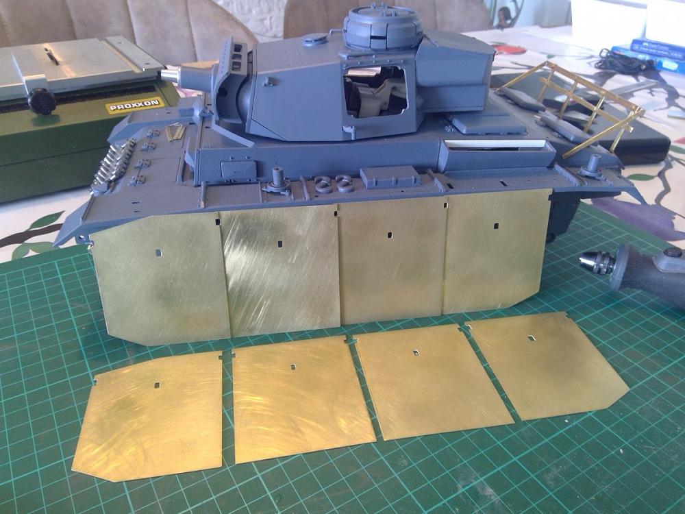

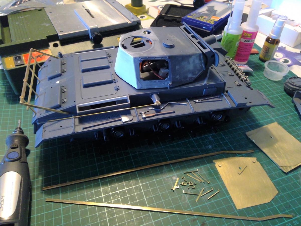

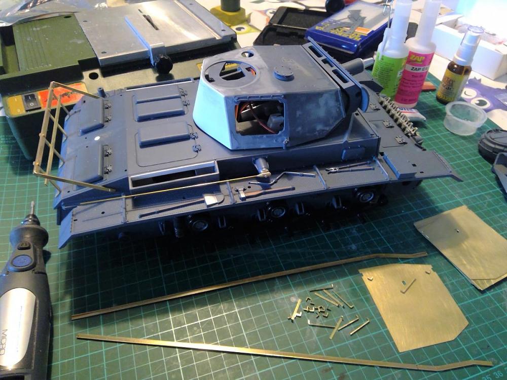

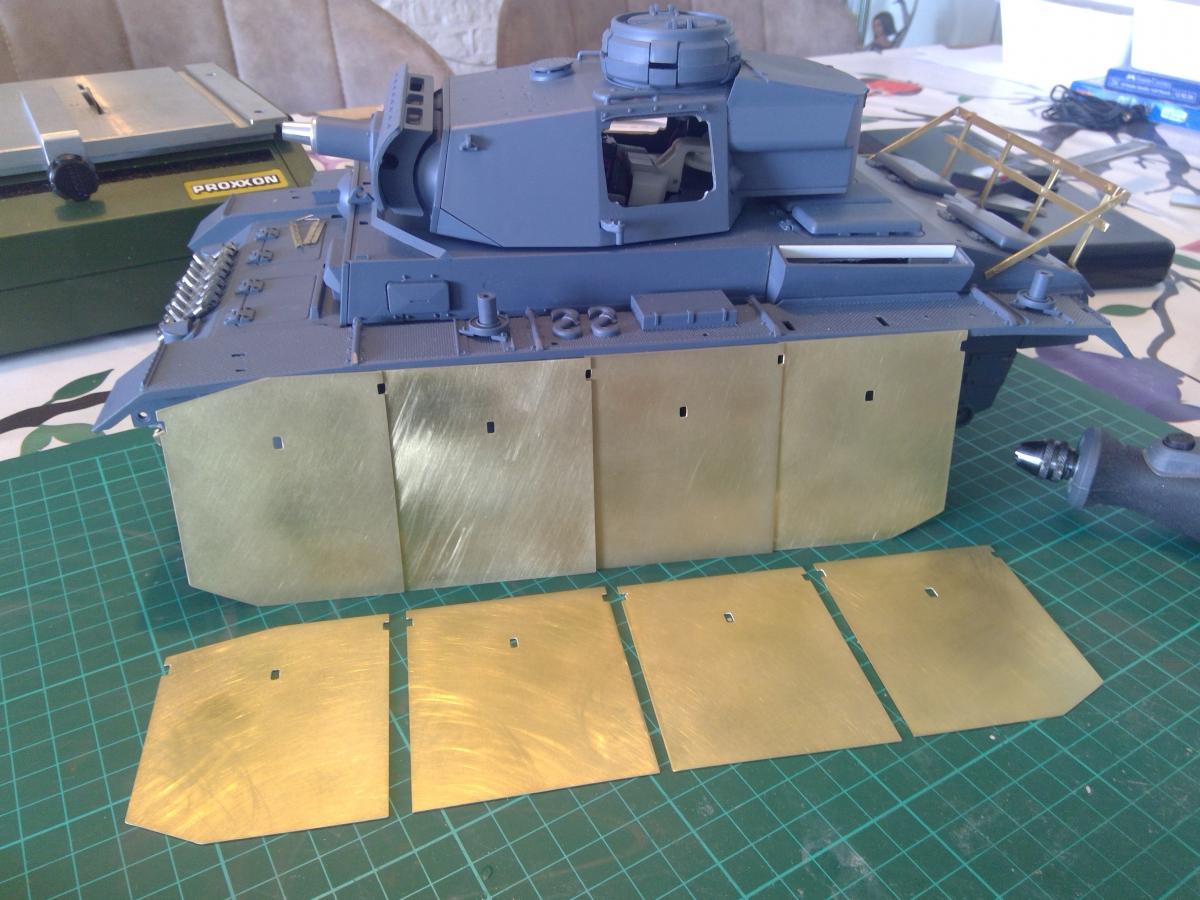

Bought one of those Proxxon miniature tablesaws because I found it too time-consuming to saw and cut brass by hand. I knew I would need the saw to make the Schürzen. So I started making those, using the styrene Schürzen I bought as a template.
I used 0.5 mm brass for the side-schürzen. In my head they were thicker than the schürzen on the turret, but it turned out I switched it around. Should have used 0.3mm for the sides, and 0.5mm for the turret. I guess they will all be 0.5mm now. Oh well. :)
OMG, everyone will know! You'll be disqualified at Scalemasters when they discover the 0.2mm discrepancy! 😱Originally posted by UltraVargen View Post
Seriously though, if you're going to drive it around outside, a little extra strength won't come amiss.
Do you have a plan for removing them if you need to service wheels or tracks? I ask because I may put some on my StuG IV if I get one.The more screws it takes to reassemble a tank, the more likely it is you left something out!
- Likes 1
The styrene set I'm basing this off of has them suspended on some hooks (three point per panel). So they should be removable: Schürzen Panzer III (tank-modellbau.de)
On that site the lower point hooks aren't installed, but you get the idea.
- Likes 1

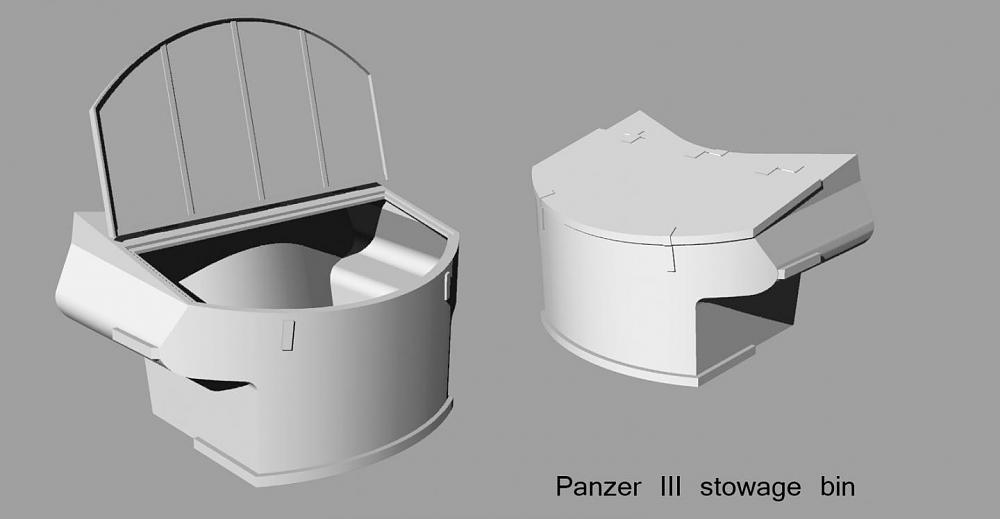

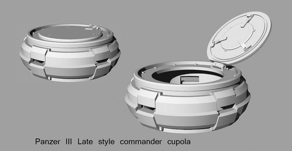

I also found a surprise in a book called Panzertracts, that has schematics of the Panzer III variants: The late-style single hatch commander cupola that I was planning apparently is quite a bit bigger (thicker armor) and with different proportions than the early style two hatch version. So I started re-drawing the Late style single-hatch cupola in 3D to be more accurately proportioned. This of course meant that the Heng Long Panzer III with it's oversized stowage bin and inaccurate details won't be able to fit the new cupola. So I removed the stowage bin and some raised details on top of the turret (signal port and cupola brim). I closed the rear of the turret with re-enforced styrene sheet bent to shape. I will have to draw up a new correctly sized stowage bin for printing. Of course, removing the stowage bin also meant I couldn't use the barrel elevation motor anymore that Heng Long has situated in the bin. So I added a servomotor for the barrel elevation, which works fine and fits just nicely in the relatively small Panzer III turret. Servo's for the win.
Tomorrow will probably be spent drawing up stuff in the computer for 3D printing.

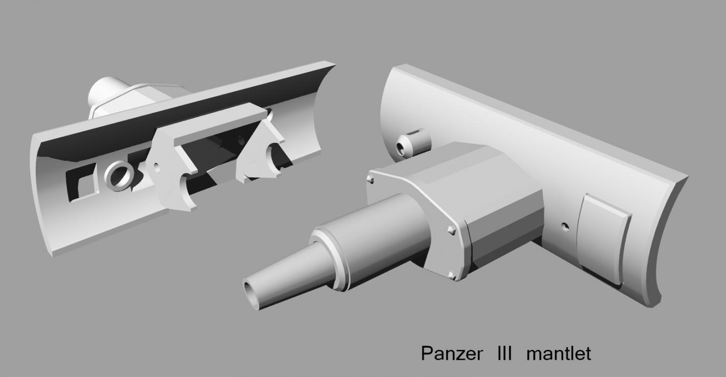

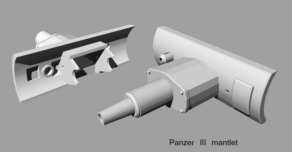

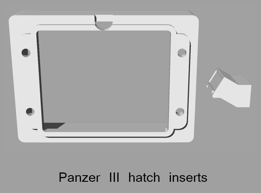

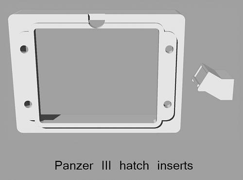

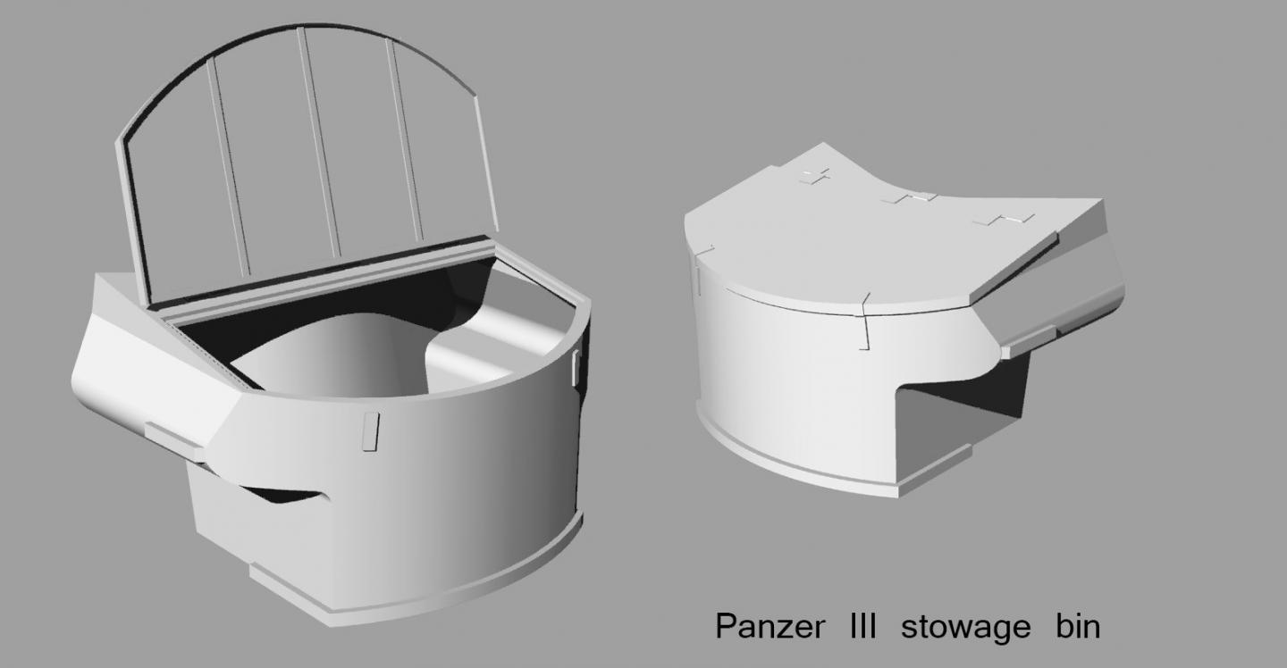

Done drawing the "big" parts, and I started printing. Still have to draw up a bunch of small detail items like lifting hooks, towingcable guides, a Notek convoy light, etc.
- The mantlet is modeled as to fit on the aluminum recoil unit without having the cut too much material from the recoil unit. The barrel insert is the aluminum aftermarket one.
- The stowage bin will have brass hinges and clasps. If it works out to make those tiny parts. If it doesn't I'll probably just glue it the lid shut.
- The turret side hatch inserts are meant to take the metal aftermarket doors. I'll put a small magnet at the top, and srill a tiny piece of metal into the doors so hopefully they'll remain shut when closed.
