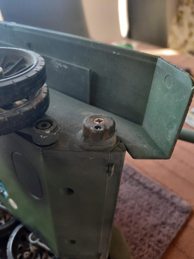

    Well I finally broke something on my t34, and of course it was a part that I couldn't repair. Just doing some hard running and bam, the track flies off and the idler goes rolling off into the distance. Broken metal tensioner, does this happen very often, is it a design flaw?I should mention this is the upgrade 6.0 version with metal running gear Click image for larger version

    Aww crap, time to get a replacement part
    • #3
      My most recent (11/20 purchase) T34 broke both sides off before it was even finished being built. The first two T34 that were purchased when the new 6.0 versions was released in 2019 have been bulletproof.
      I think HL got a bad batch T34 idlers. Fortunately I had ordered a spare set when they became available and they seem as strong as the early ones.
      You should be able to “fix” it by using a longer wheel screw. I was able to on the ones that broke on me until I replaced them.
      I have since went ahead and replaced all the short HL idler wheel screws with longer ones to help reduce the likelihood of the idler axles snapping off in the future.

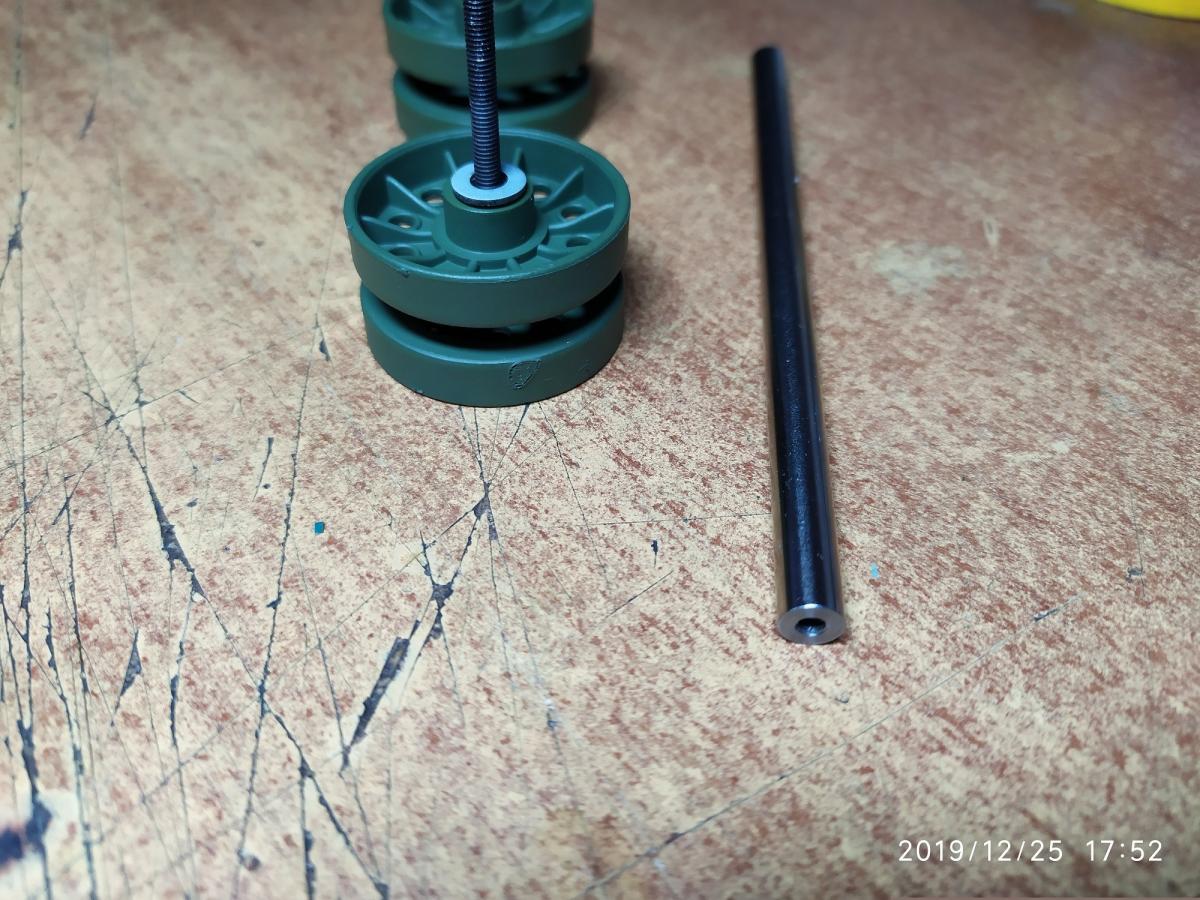

ID:	300346Click image for larger version
ID:	300345Click image for larger version

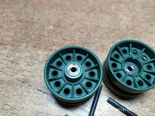

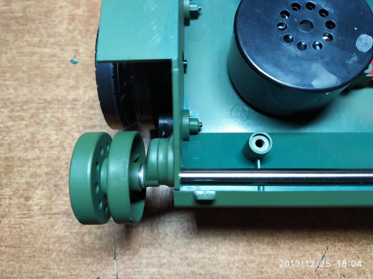

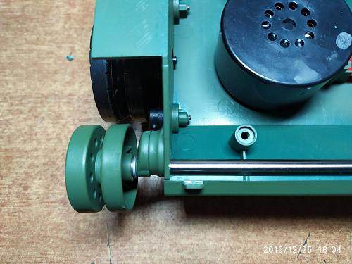

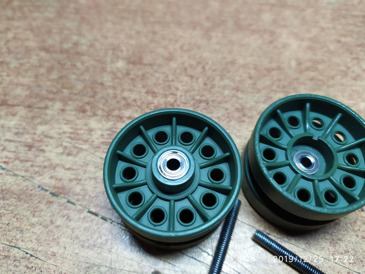

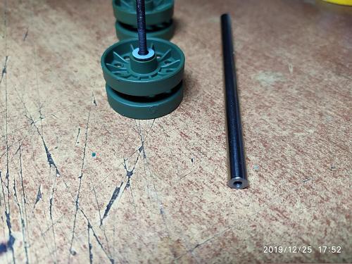

          • #6
            Repair option.
            • #7
              Very nice job
