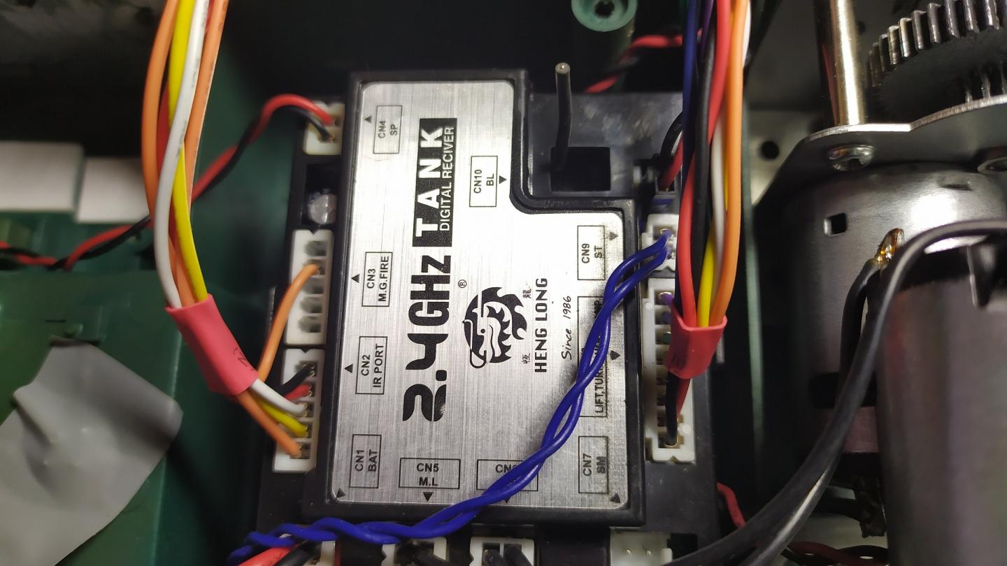

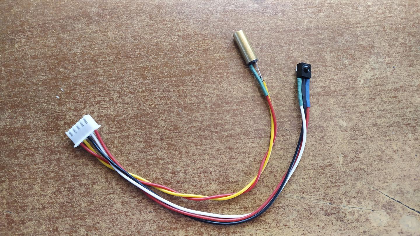

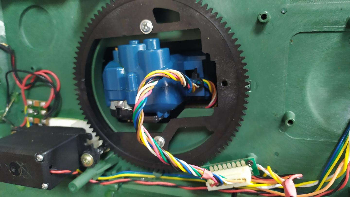

            All 5.3 controllers can be BB and IR combat. I have 7 tanks of which three are 5.3, two are 6.0 and two are PX-18. They all play with IR, and they can all play with BB.
            • #7
              This is how the IR battle is connected in the 5.3 controller.

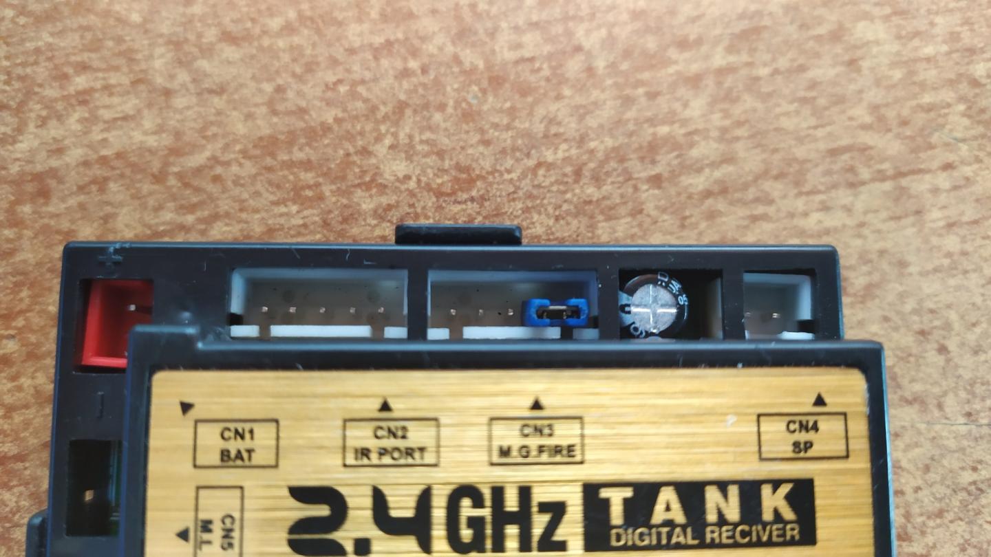

                If the 5.3 (5.2) controller only needs IR combat, set a jumper in the CH 3 connector.

                  As I said the 5.3 do not come set up for IR battling from the factory. As you showed they must be modified for IR battling. This is well known, but even so because the 5.3 is not Tamiya compatible even with the simple IR system installed it is considered by clubs unexceptionable for field use.
                  To make it acceptable a second board like a MAKO needed to be installed which changed the outgoing IR code to match the Tamiya codes and vis versa, thus registering a hit. These boards worked ok but still left a lot to be desired.
                  All this of course wasn’t your original statement/question but for others reading this it was necessary to explain because simply adding an IR bulb and basic IR receiver does not magically make the 5.3 system anything but HL compatible. The 5.3 can read the old HL 6.0-7.0 IR code that is mixed in with the new Tamiya code. All in under 1 second of time that the bulb is actively sending an IR beam.
                  The old 5.3 is better served being replaced with a 6.0-7.0 system because these are far more reliable, well rounded and can interface with not only Tamiya systems but also aftermarket upgrade MFUs by CLARK and IBU.
