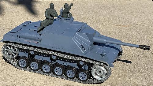

    I just took it out of the box and did the 2 minute test, as recommended by Alpha & company. I got a metal tracked version.
    1. The internal gears are zinc; metal but not steel. How well they last will be something to monitor.
    2. There are two speeds; slow/realistic, and zoom.
    3. Airsoft firing is different.I had to read the manual (sacre bleu!) Hold down the right top button and push the left stick forward.
    4. There is no IR receiver or emitter.
    5. There are two sounds. That's fine, a Stug III with a turbine sound might be off-putting!
    6. The battery is a 2-cell Lithium Ion, just as junky as the 6.0 ones.

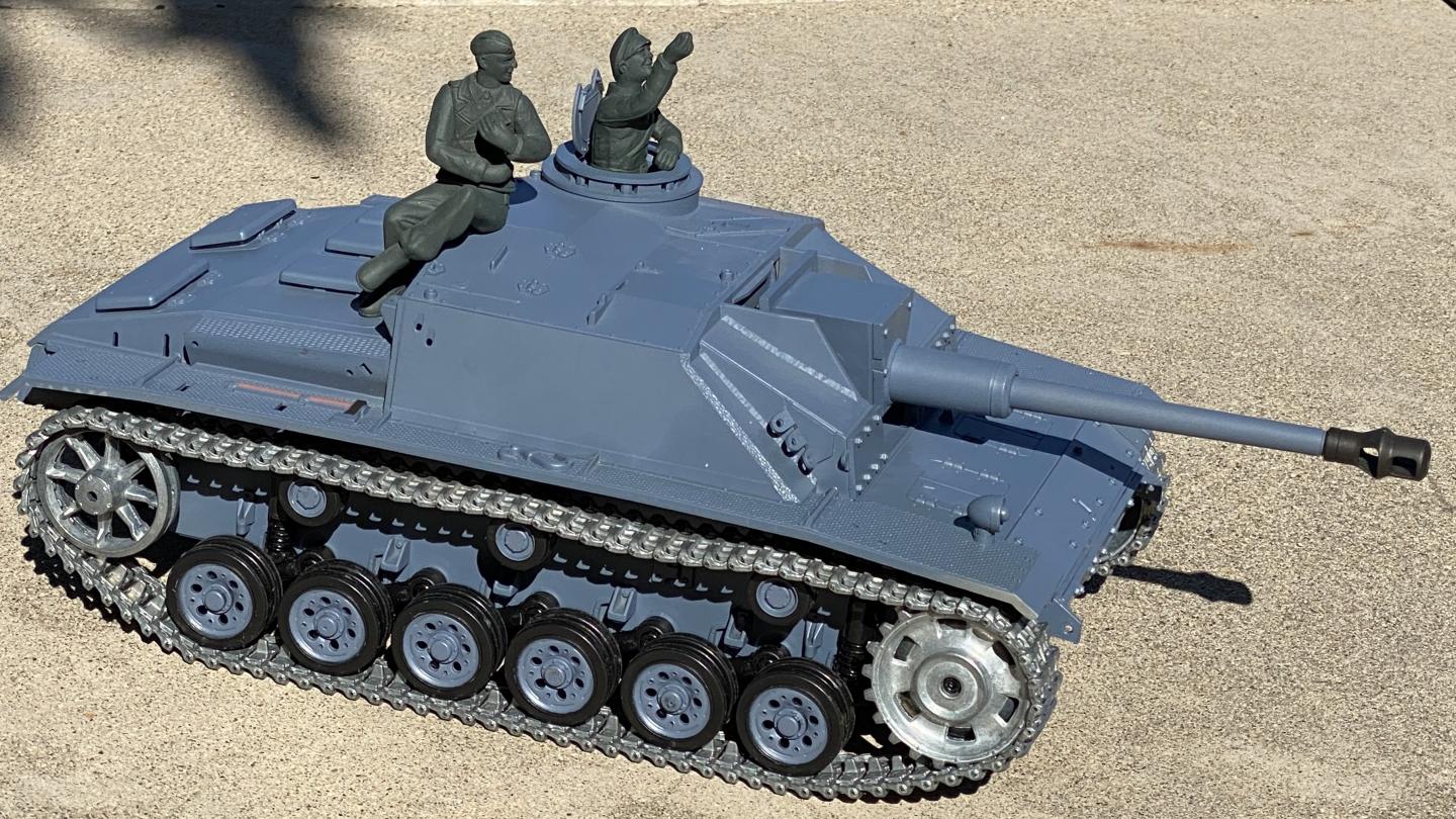

    That's it for now. In case anyone wants to read the box, I've attached a picture. Also, it comes with two pretty nice crew figures.

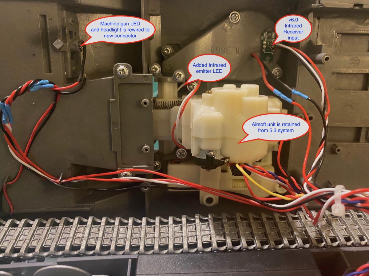

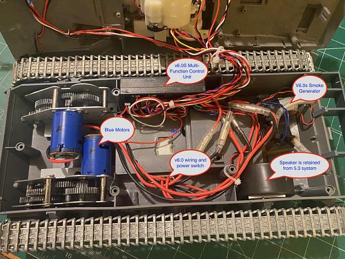

        I am very happy with the 5.3 to 6.0 upgrade I did on my Stug III. Huge difference in performance. Plus I added the new IR capability and Blue motors too. I was disappointed that what looks like a full size battery compartment only holds the small size battery

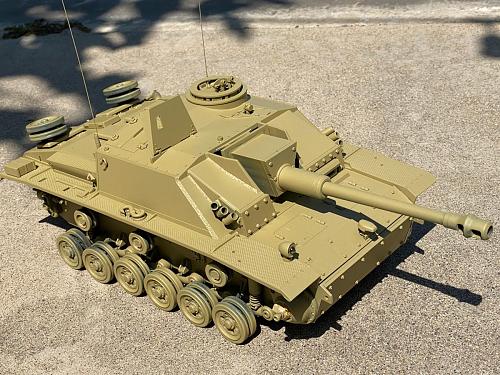

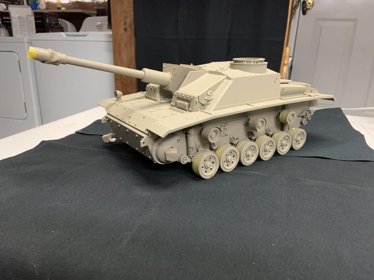

          Anyway, here is step one; repaint the frame.

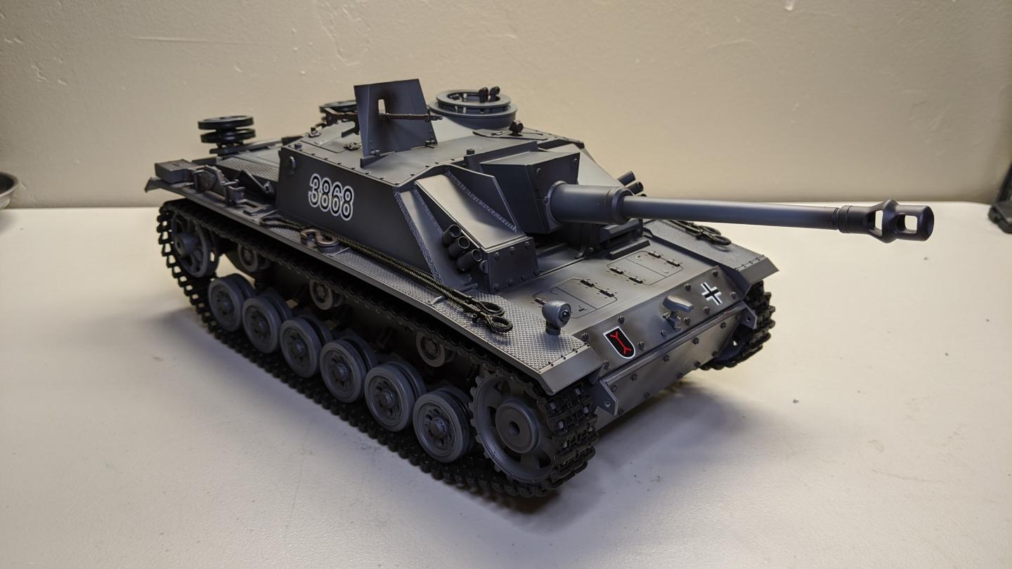

                I popped for a Stug a month ago just because I think is one of the coolest tanks ever. And like you I went thru exactly the same scenario as you. I won't worry about updating to 6.0 or win any IR battles, but she does shoot a hell of a BB. Shot my 40yr son at fifty feet in the back and he said "ouch". Mission Accomplished!!
                Grandpa

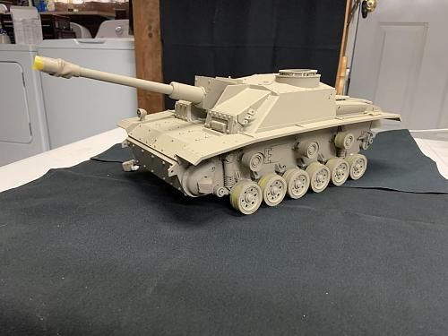

                  Grandpa, very nice. Do I detect some airbrush shadowing and gunsmoke residue? Well done.

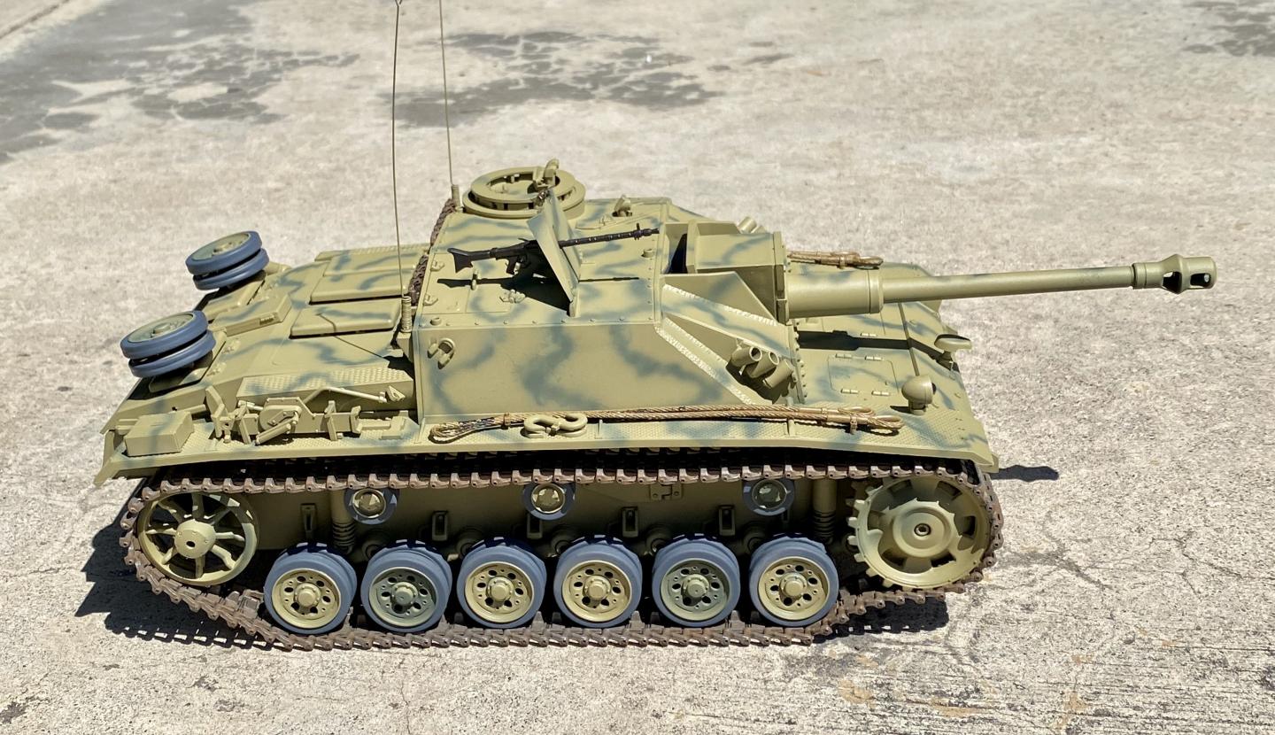

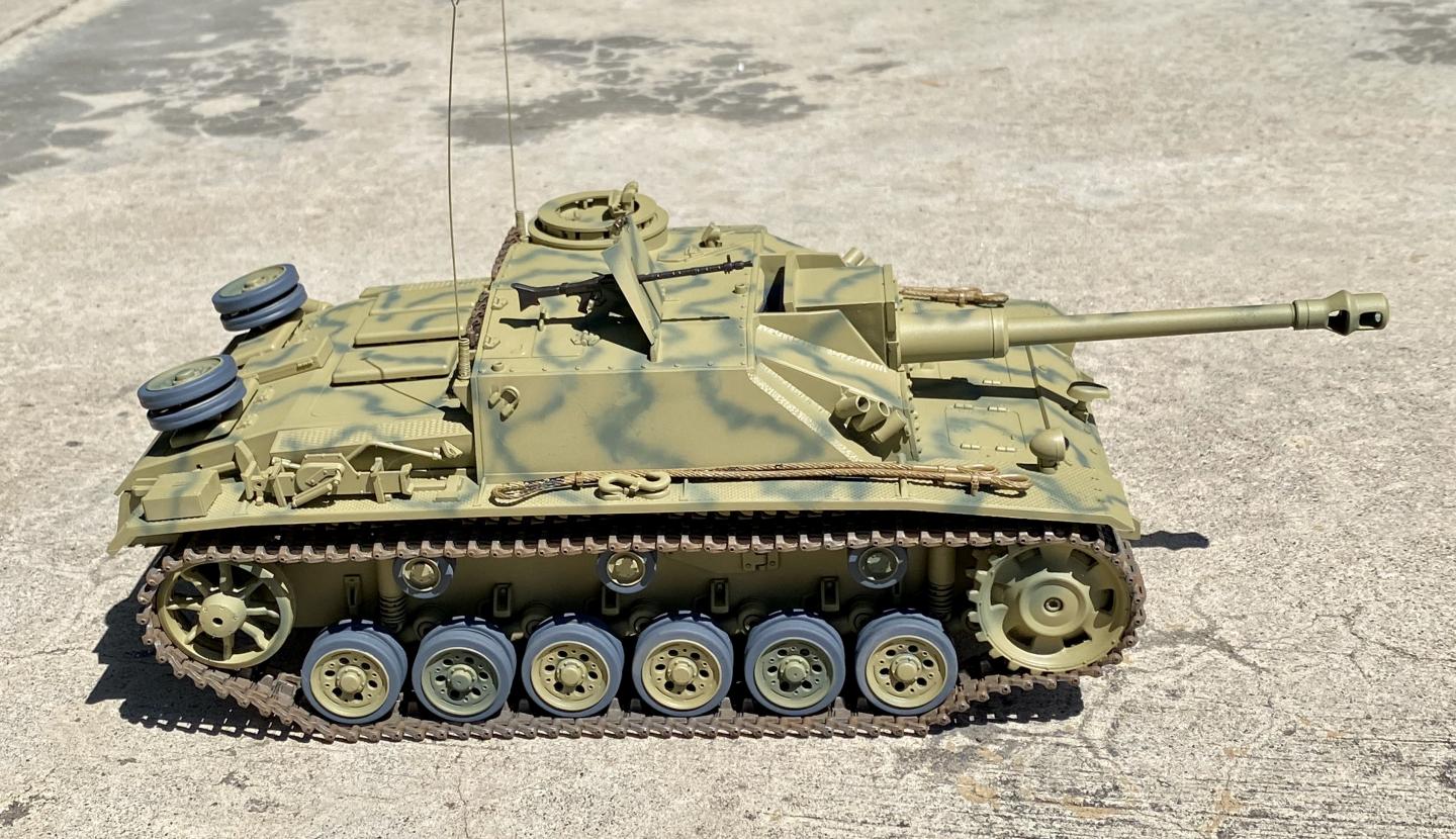

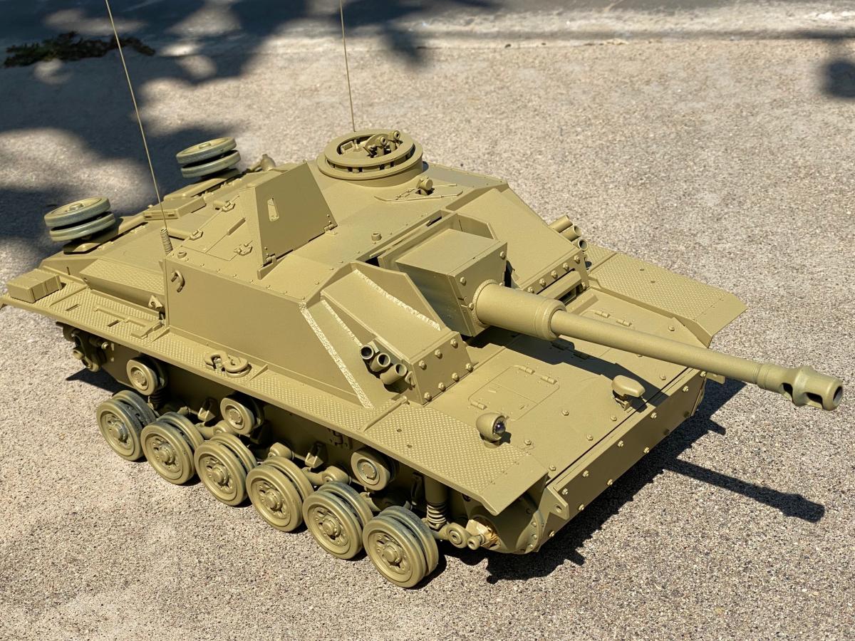

                  Ok, step two, the scariest for me; airbrushing camouflage. Interesting how colors change depending on lighting. In this case it was partly cloudy. Once it’s done, it’ll be time to repaint the tires.

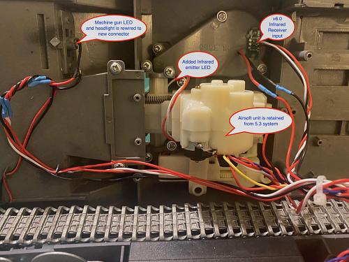

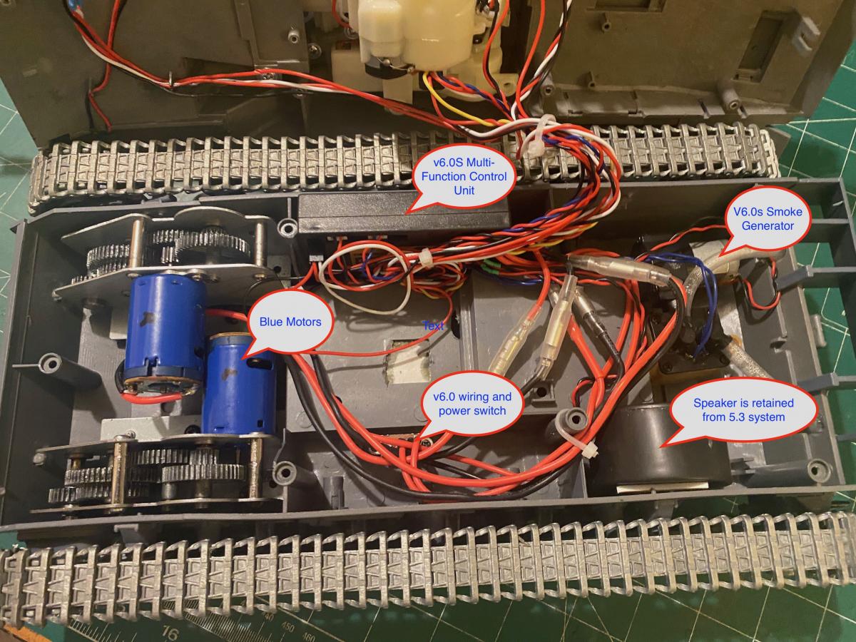

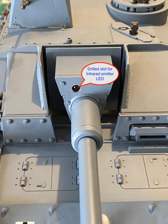

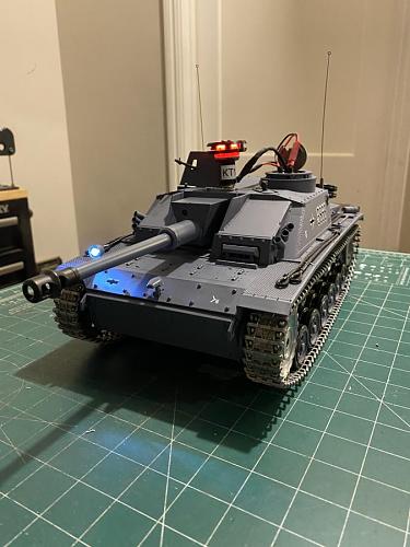

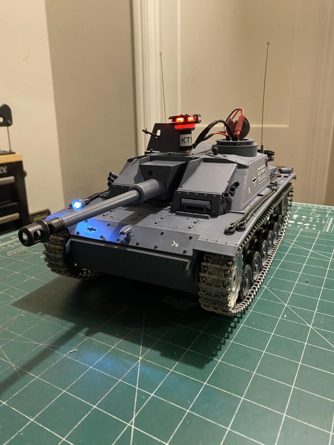

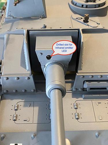

                    If you are interested in what it looks like inside the Stug III after my v6.0 upgrade here are some images with notes on the changes.
                    Click image for larger version  Name:	IMG_0891.jpeg Views:	0 Size:	197.1 KB ID:	267006
                    Click image for larger version  Name:	IMG_0892.jpeg Views:	0 Size:	143.5 KB ID:	267007
                    Click image for larger version  Name:	IMG_0858.jpeg Views:	0 Size:	73.2 KB ID:	267005
                    And the final results. First drive.😃

                      Wow Karl! Fantastic. I’ve saved the pictures for reference. So, you bought a 6.0 main board, an IR receiver, an IR emitter, a smoke unit, blue motors and of course a transmitter. Did I get that right? It’s nice to see everything fits. Bravo!

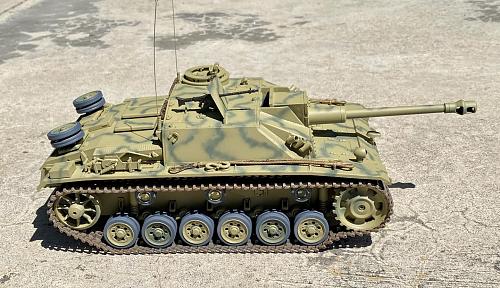

                        Weird. When I upload from my ipad the photos show. When I look from my PC, nothing. I'll reload here.

                        Next steps; decals and weathering.

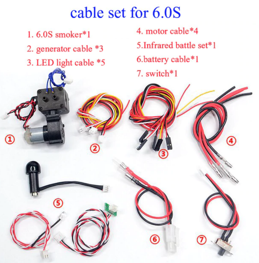

                                Bob,
                                Here is what comes with the 6.0S upgrade kit. You also need the 6.0S board. I got it without the 6.0 transmitter because I already had one. FYI you can bind all your tanks to one 6.0 transmitter. It is hilarious if you have all the tanks on. They will all start up and drive in unison. LOL!
                                Click image for larger version  Name:	Screen Shot 2020-08-07 at 8.51.08 PM.png Views:	0 Size:	712.7 KB ID:	267274

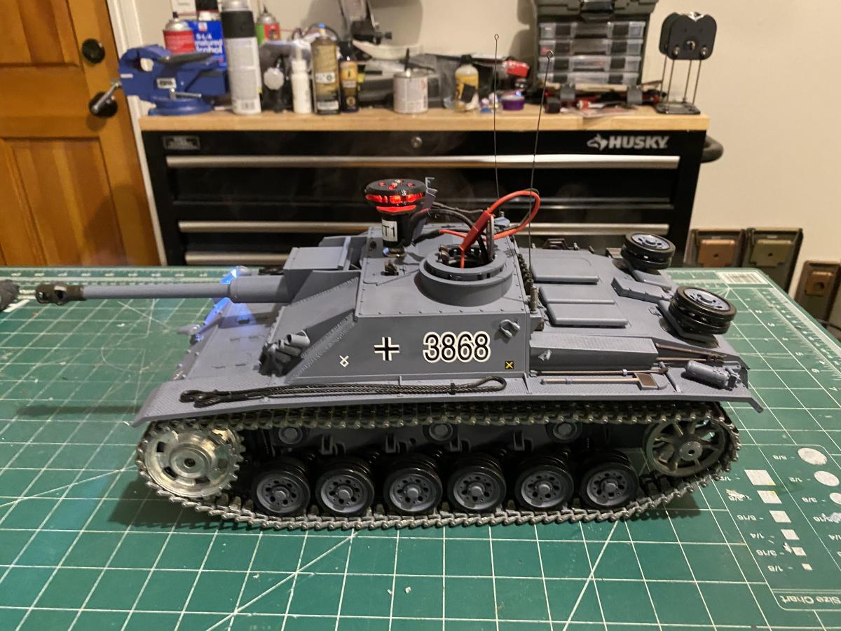

                                  Pretty much done, time to run it in the dirt! By the way, I echo another thread, GLUE THE SMALL PARTS! I’ve already lost a couple after driving a little frisky.

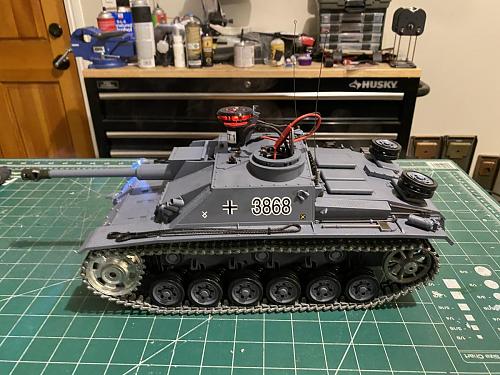

                                    I am working on my Stug currently. I have the base paint done, but waiting for an upgraded airbrush to deliver. My current airbrush is just not up to the detail required.
                                    Bob (not from SoCal!)
