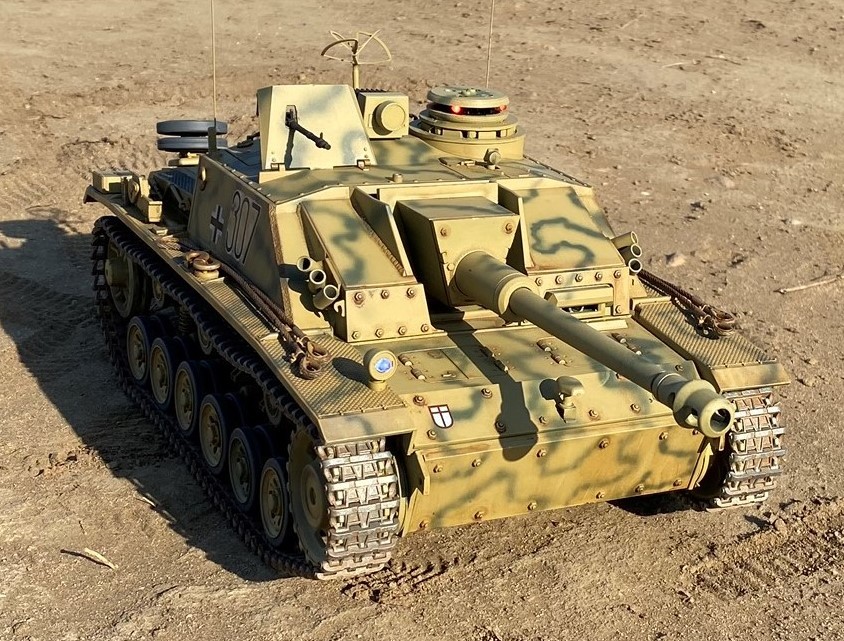

    I got distracted. Let me put one of my pictures in so some of our members could focus back to the main topic :-)
