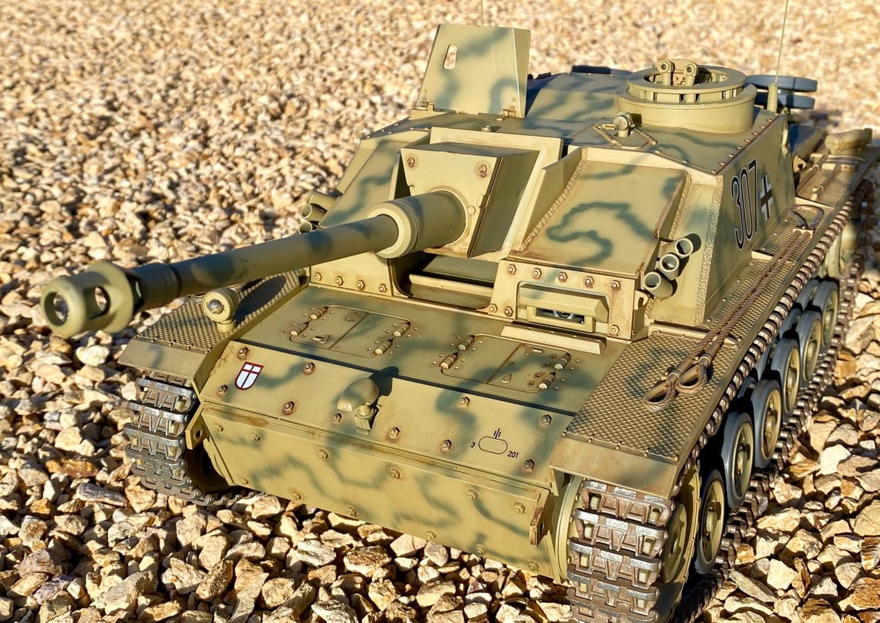

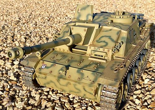

                I’ve found Tamiya paints work well. How about these pics?

                  Very cool, Bob!

                    Yeah I use Tamiya paint as well, I especially like the way dirt and grime accumulate on the paint, no need for weathering. Big time saver

                      Wow SoCal Bob! Looks amazing! I think NorCal Bob (borntoolate) is going for the same look! 😃
                      I love the rust weathering. How did you do that? I was never very good at weathering. But willing to give it another try.

                        Hey Karl, thanks. My process is actually very easy. It won’t win any Scalemasters contest, but it’s great for these tanks. I use AK’s Streaking Grime and their Enamel Thinner, as a wash. Thin it and it runs along creases, corners and panel lines. Thicker around bolts. Real thin wash can run down surfaces. I used some after I took these pics to dim down the white numbering. If you use too much pigment, just brush it away with thinner.
                        Just make sure you seal your paint first, with clear flat, so the thinner doesn’t affect the paint. It’s the most fun step for me.
                        As far as the tracks, I just spray them with Testors Flat Earth or Dark Tan, then drive the tank on some hard surface to wear off the high surfaces. You could also use the streaking grime to deepen the creases.
                        I buy the AK paints at Hobbylinc.
                        Bob

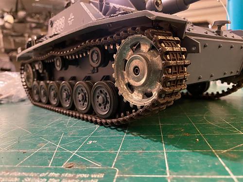

                              I picked up a can of Rust-Oleum Camouflage "Earth Brown" and painted the tracks on my StuG III. I like how they came out. Should weather nicely over time in the dirt.

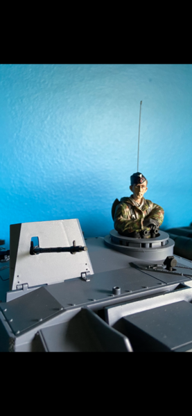

                                    Another STUG III owner here.....I've converted mine to a Clark TK40 with a Flash unit. Have not added IR yet. I've done detailing / painting but have not done any weathering on it yet.
