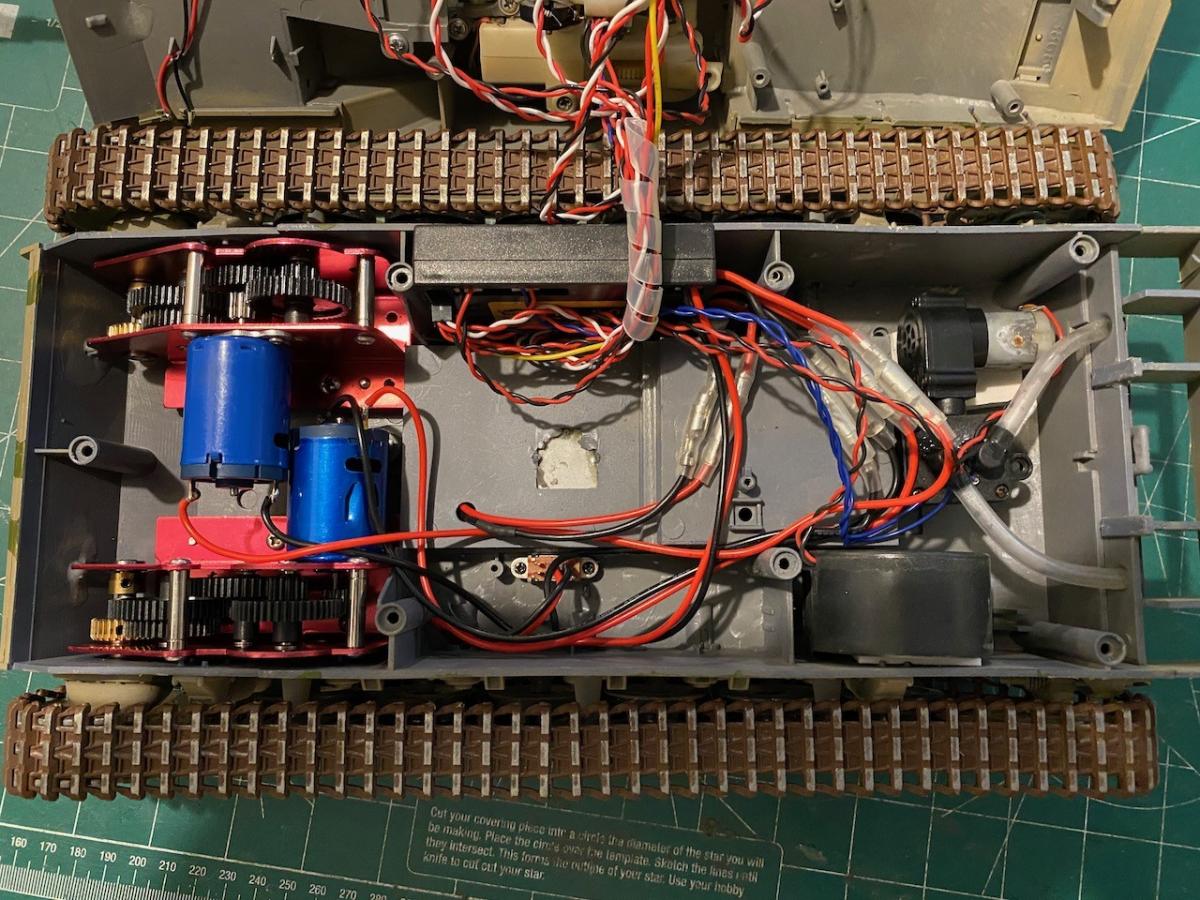

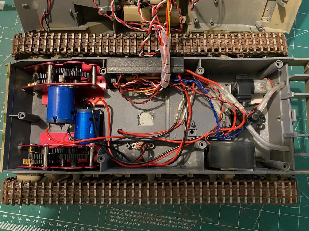

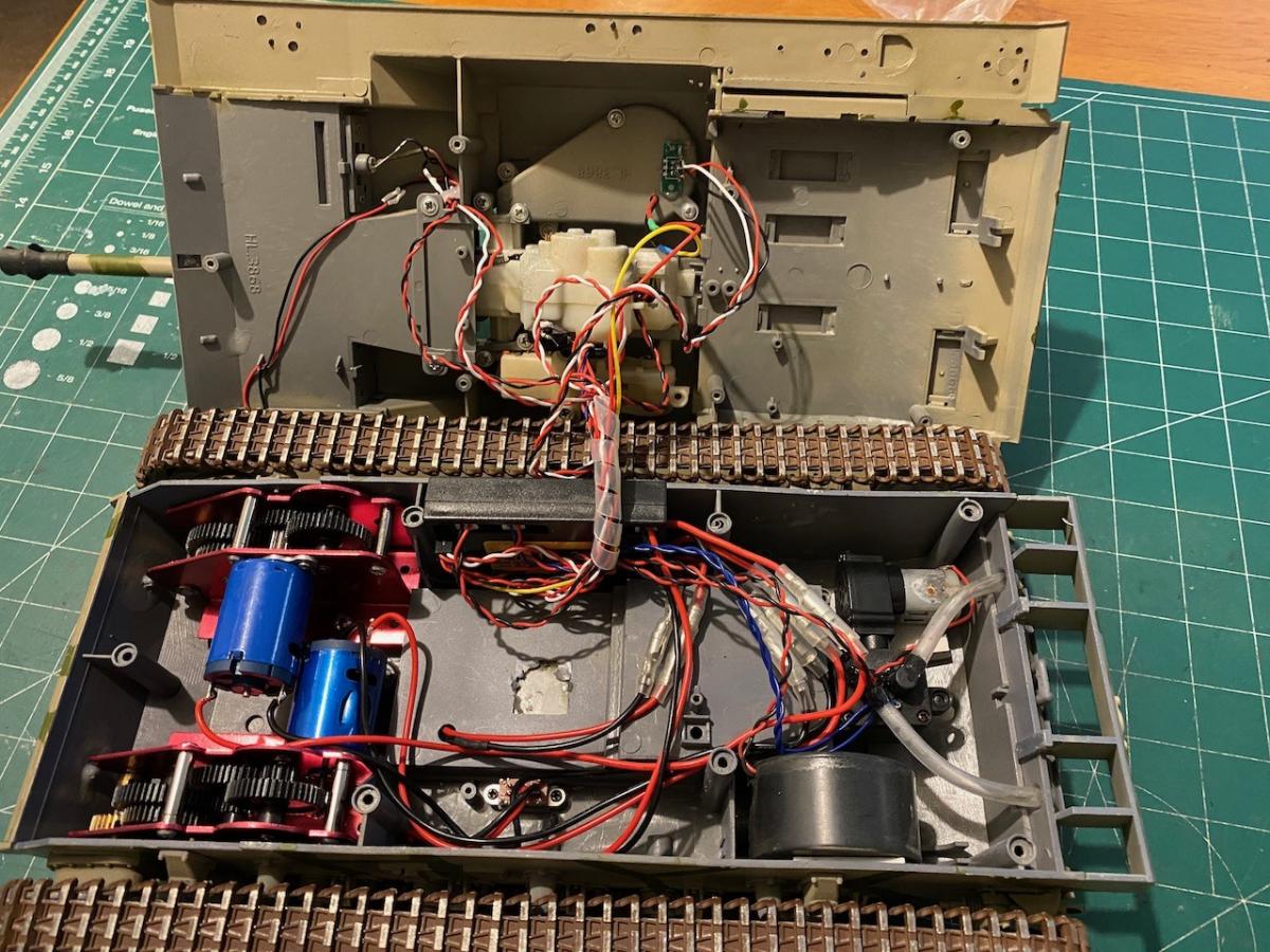

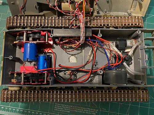

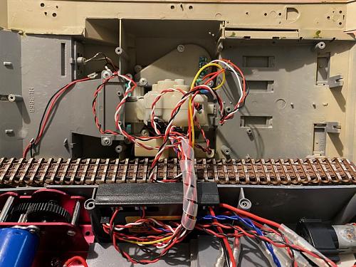

        Originally posted by karltrek
        If you are interested in what it looks like inside the Stug III after my v6.0 upgrade here are some images with notes on the changes.
        Click image for larger version Name:	IMG_0891.jpeg Views:	0 Size:	197.1 KB ID:	267006
        Click image for larger version Name:	IMG_0892.jpeg Views:	0 Size:	143.5 KB ID:	267007
        Click image for larger version Name:	IMG_0858.jpeg Views:	0 Size:	73.2 KB ID:	267005
        And the final results. First drive.😃
        https://youtu.be/MwdoWEs69kY
        Hey Karl, I have some questions. How did you mount the IR bulb? I see you drilled a hole. Did you disassemble all the way down to the mantle so you could get the hole aligned? Did you remove the airsoft unit to access the area? Have you tried it, how accurate do you feel it is? How did you brace the bulb behind the mantle?
        I talked to Toucan, they can sell me the required parts without the transmitter for $55, so now I have to figure out the process. Thanks for any help you can share.
        • karltrek
          karltrek
          • 159
          • Santa Cruz, CA
          #44
          Hi Bob,
          Yes. I disassembled it down to just that part so that I could easily drill the hole. I am very happy with the IR performance. Works perfectly.
          One thing I am not happy with is the tracks come off to easily. Almost any turn will de-track it. I have to slow down to a crawl to make a turn. I believe it has to do with the idler wheel. It’s too floppy and can’t be tightened any better. It is the metal Heng Long version that has no bushing. I ordered a Mato metal idler that comes with a bearing. I am hoping that will have better performance.

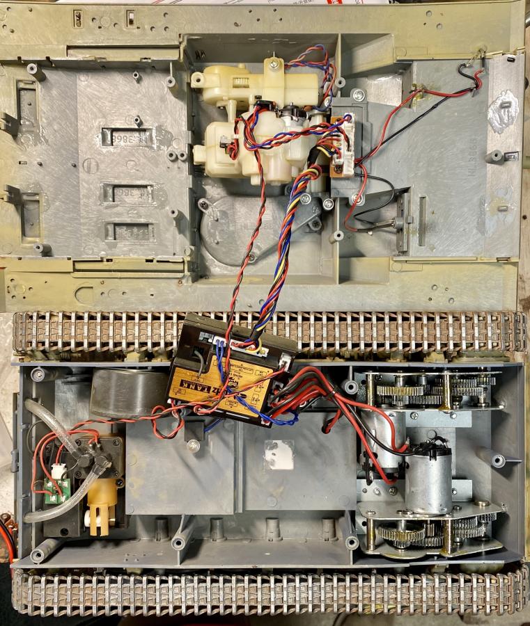

                  #48

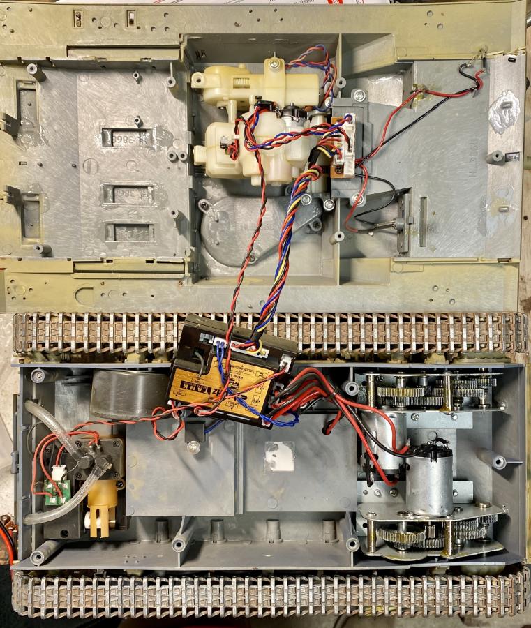

                  I got my 5.3 to 6.0 upgrade kit yesterday; $55 from Toucan Hobby. I'm really looking forward to the upgrade, and the primary reason is for better steering and throttle. The absence of a turret makes it important to fine tune the aim, almost impossible with the 5.3 electronics. It also allows IR functionality, absent in 5.3. (An aside: some earlier HL products could be bought with EITHER IR or Airsoft, but not both.)
                  First step is to open up the patient. Second is to photograph the guts, in case stuff needs to be put back! I've posted large size versions, in case anyone wants a closer view.
                  Click image for larger version  Name:	StuG 5.3 wiring.jpg Views:	0 Size:	154.4 KB ID:	274915

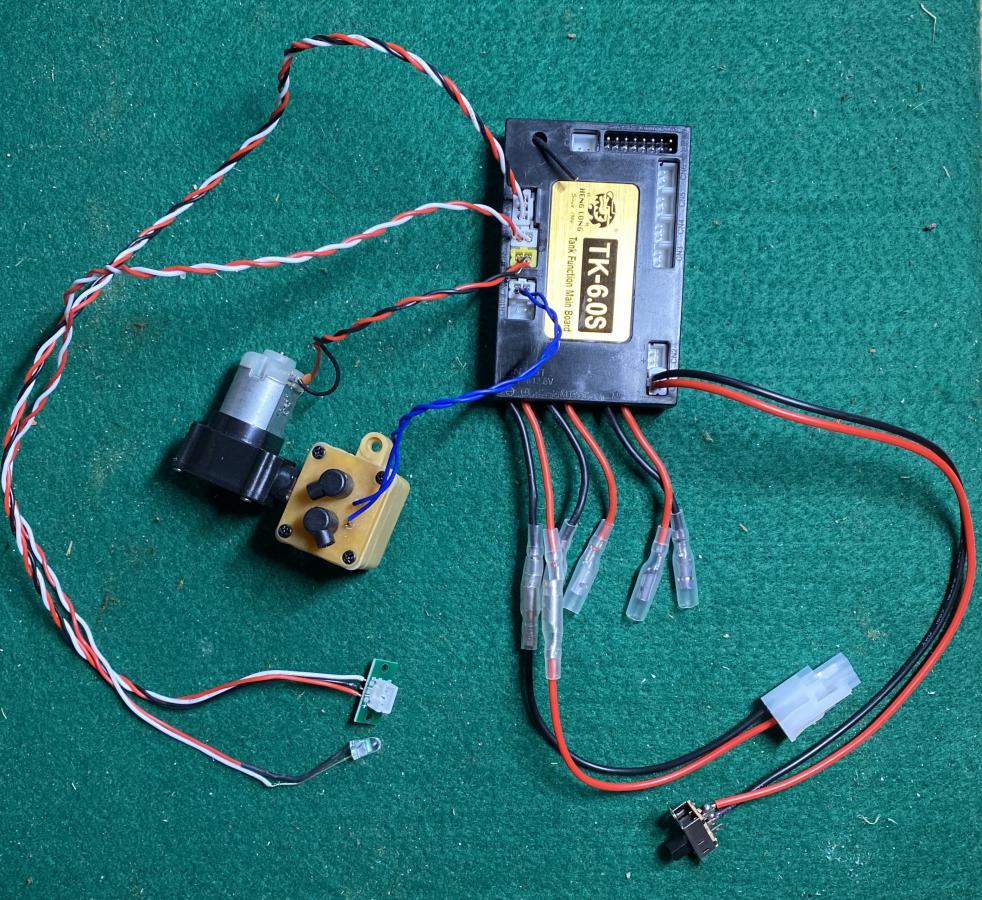

                    #49

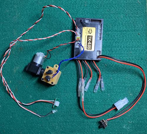

                    This is a photo of the 6.0 components, hooked up as much as possible for educational purposes. I used the wiring diagram included in the 6.0 manual that comes with their respective tanks. So all I have to do is pull the 5.3 wires and plug in the 6.0? No, not really, but it won't be too hard to connect the appropriate modules. I will be relying heavily on Karltrek's photos in this thread.
Name:	StuG 6.0 electronics.jpg

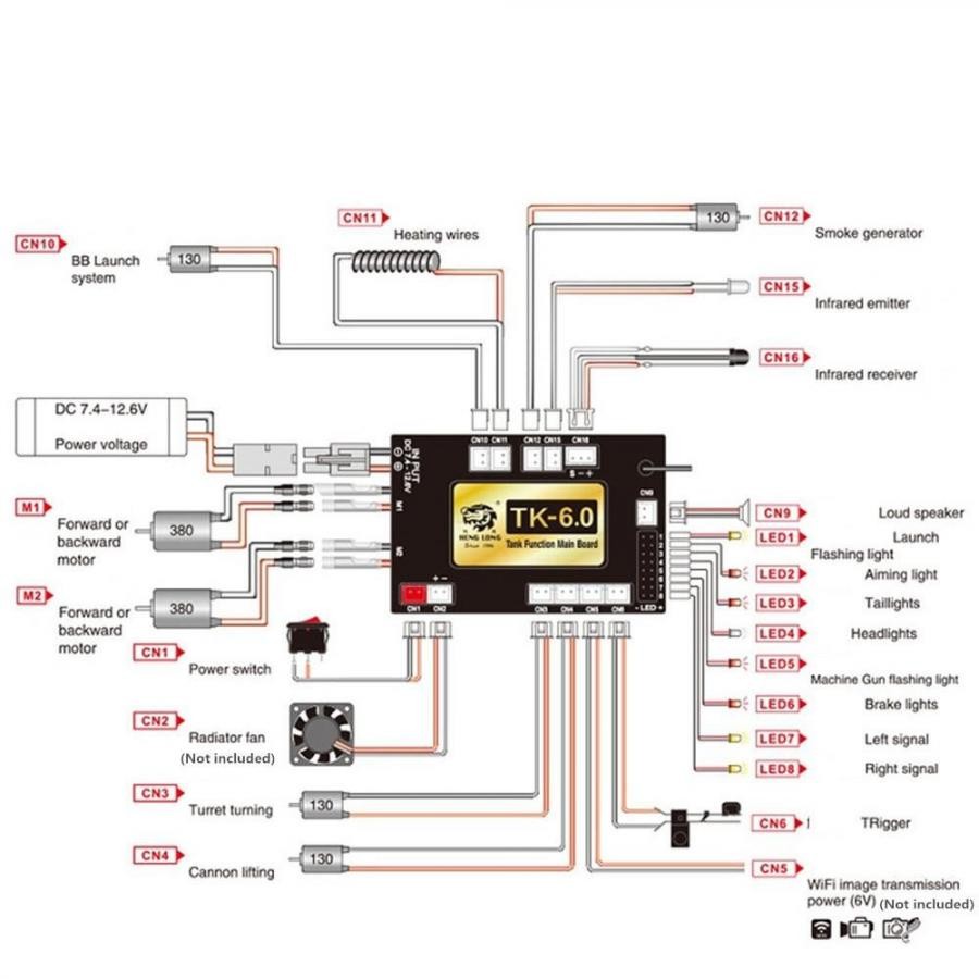

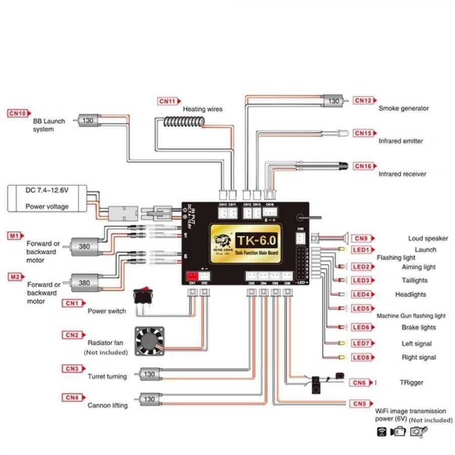

                      By the way, this is a 6.0 connection schematic I grabbed from another thread. A good reference if you can't find your manual. Click image for larger version
Name:	60 diagram.jpg

                        So, good news and bad news. Bad; I got well into the conversion, hooked up the airsoft I thought, activated it and fffffft! burned out a board. Toucan sells them for $33, so I'm in hiatus. Up to that, it was going good.
                        The following are the steps up to.., you know. This is by no means a how to, just my real time observations. Please consider them "helpful hints".
                        Stug III 5.3 to 6.0S upgrade process:
                        You will need an upgrade kit. Also a 6.0 transmitter, unless you already have one. You can bind more than one tank to a transmitter. Just don't have two bound tanks turned on at a time! More on this later. Screwdrivers of course, a soldering iron or gun and solder and miscellaneous tools.
                        Open the hull.
                        Photograph the 5.3 wiring details, just in case!
                        Using the wiring schematic in the 6.0 manual if you have one, learn where the 6.0 modules plug into the 6.0 board (aka MFCB).
                        I opted to remove the Tamiya socket & solder XT-30 replacement connectors onto power leads.
                        Remove 5.3 on/off switch, install 6.0 on/off switch. Look underneath so on and off are correctly configured.
                        Enlarge lower hull hole a little bit for power leads.
                        Install the 6.0 power leads.
                        Unscrew small black cover & remove 5.3 momentary button from lower hull; not needed in 6.0.
                        Remove 5.3 smoke generator by unscrewing three screws on the outside bottom of the hull.
                        Install the 6.0 smoke generator. Check karltrek's picture of his installation for orientation. It can be held in place by one of the removed screws in the center of the three holes. The red & black leads to the smoke generator motor and blue leads to the heater may need to be lengthened.
                        Connecting the Motors:
                        Depending on your soldering equipment and comfort level, this can be done either in place or with the motors and gearboxes removed.
                        Unsolder the 5.3 motor leads from the motors. Remember that the M1 circuit is for the left motor and the M2 is for the right.
                        Note that the kit's motor leads have a plug and socket midway for ease of adjustment and replacement. You may want to shorten the leads to achieve a cleaner install. Solder the 6.0 motor leads to the motors.
                        At some point you will need to confirm the treads go forward and back correctly. This has to be done when the tank is bound to a transmitter. Fortunately, if a motor is reversed, you can unplug and reverse the leads.
                        I bound the tank to a transmitter at this point. In this way I could confirm each step as I re-routed the wiring. Simple process; turn on the transmitter. Hold down the ignition button and while doing so turn on the tank. Voila!
                        It turns out the left motor leads were reversed. I'd connected red to red all along the circuit. However, one motor ran backward. Simple fix, plug red to black and it ran correctly.
                        Next was connecting the headlight circuit and the machine gun light circuit. The 5.3 wiring buss on the underside of the upper hull will be eliminated. Rewire the parts, with leads included in the kit, and plug them plug directly into the MFCB.
                        Next was the "cannon lifting" (read: elevation motor) circuit. Same process; wire leads, plug them into the board. I turned them on to test, all worked fine.
                        Now here's where things went wrong, advice will be appreciated.
                        I rewired and plugged in the "Trigger" circuit and did​​ the same for the "BB Launch System" (airsoft gun motor).
                        Time to test. The motor worked but when the time for the trigger to activate, fffssst!
                        Hmmm. wiggle wiggle poke poke turn off and on, restart. Nope, dead. So close!

                          #52
                          SoCalBob,
                          Sorry to hear that your 6.0 control unit fried. Did you remove everything from the StuG except the Airsoft unit? I take out all the 5.3 electronics.
                          "I rewired and plugged in the "Trigger" circuit and did​​ the same for the "BB Launch System" (airsoft gun motor).
                          Time to test. The motor worked but when the time for the trigger to activate, fffssst! "
                          You should not have needed to rewire the trigger from the BB Firing unit. It's the same as the ones used in the 6.0 tanks except one side has a rail glued on for the lifting unit. It uses the same plugs. But make use to unplug it from that small secondary circuit board and plug it in directly to the main 6.0 board. I remove that secondary board all together.

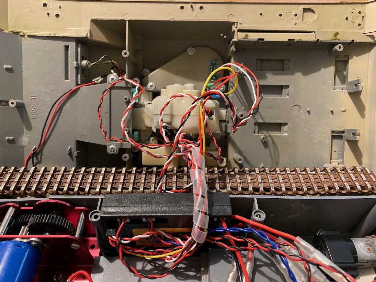

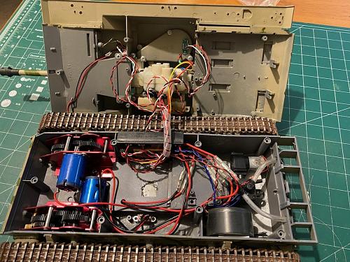

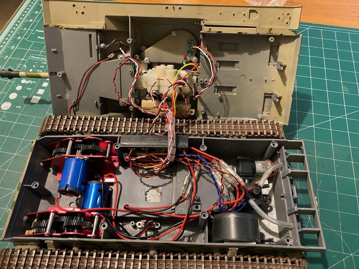

                            #53

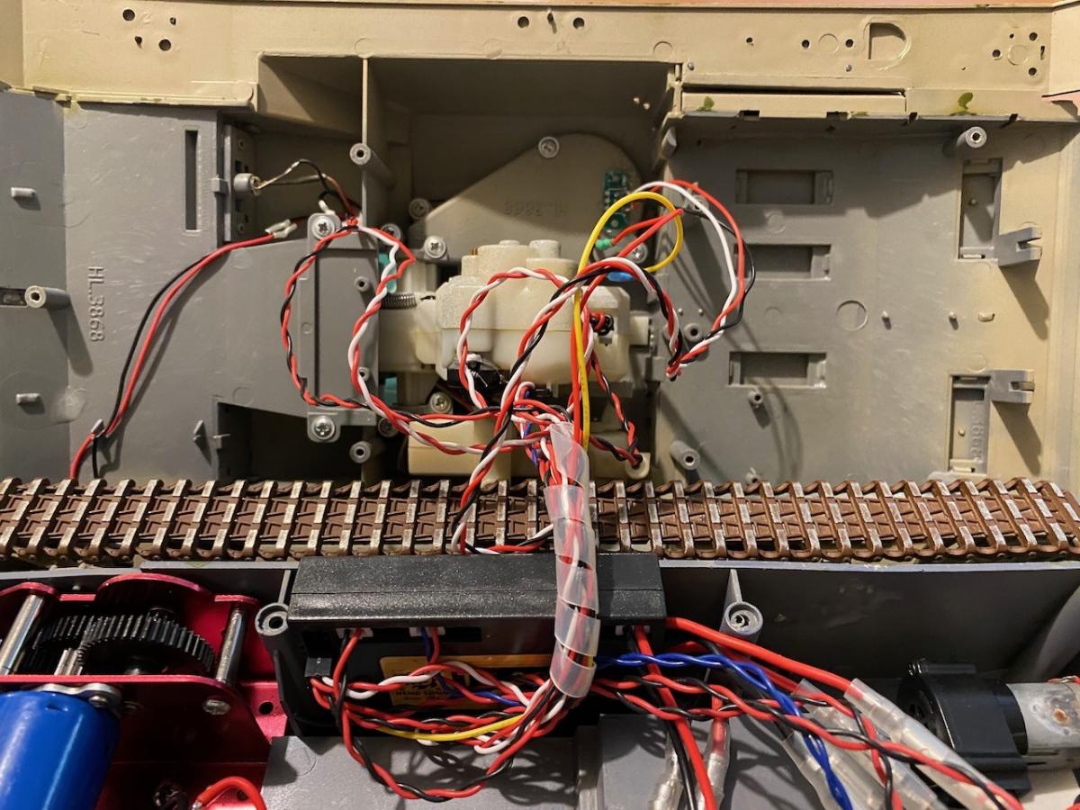

                            I finished another 5.3 to 6.0 upgrade on a StuG III. This time for NoCalBob (aka borntolate).
                            I cleaned us the wiring with some Spiral Cable Wrap.
