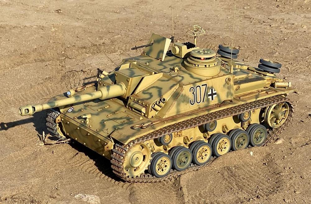

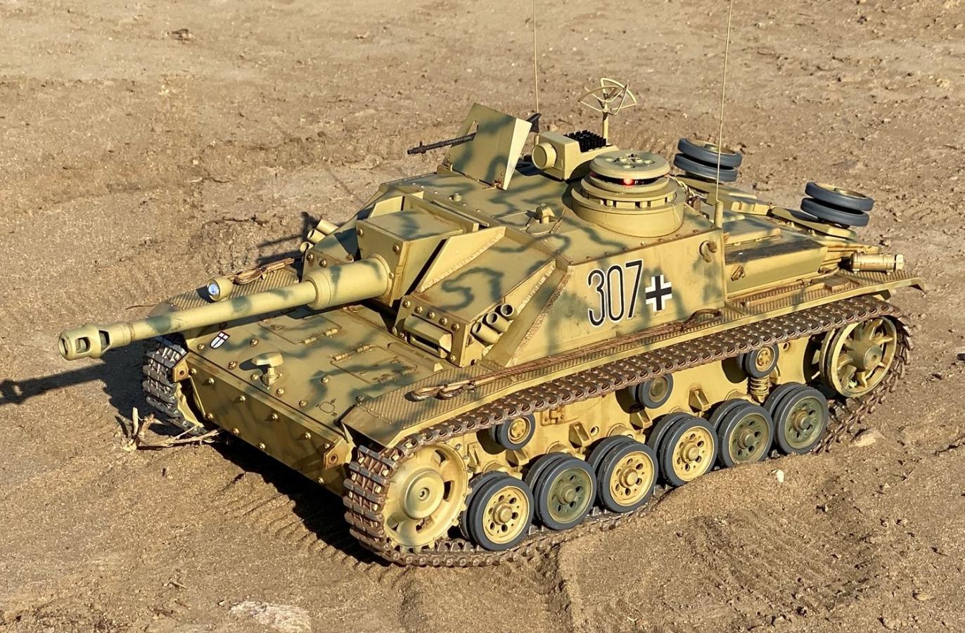

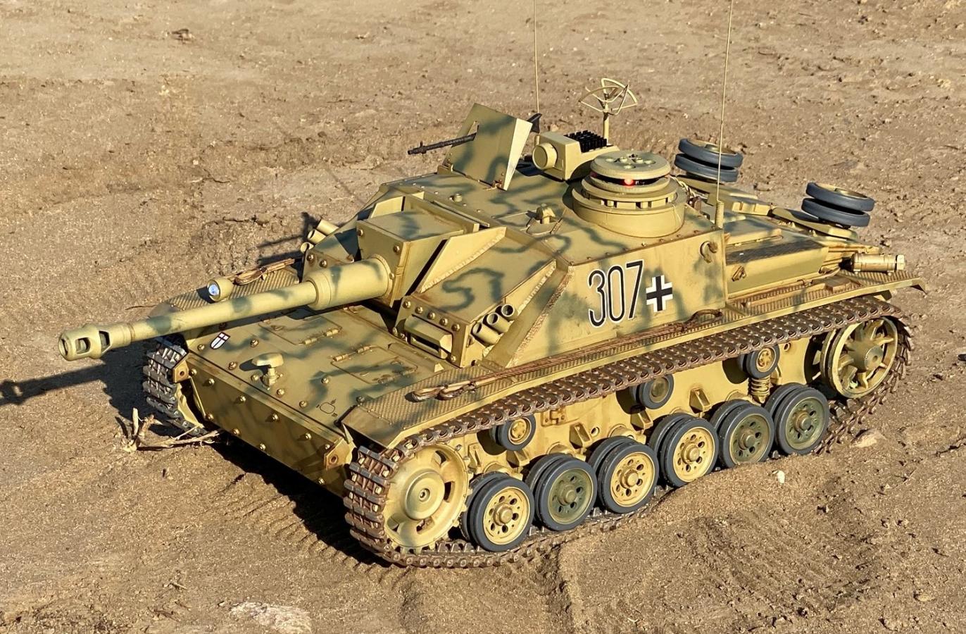

              "Baby Battler" Project Complete.
              SturmGeschutz III upgraded to 6.0S, Airsoft gun deactivated, IR emitter in barrel, IR receiver in cupola, FPV camera/transmitter held in place with magnets. For club battles, I'll remove the camera and mg shield...maybe!

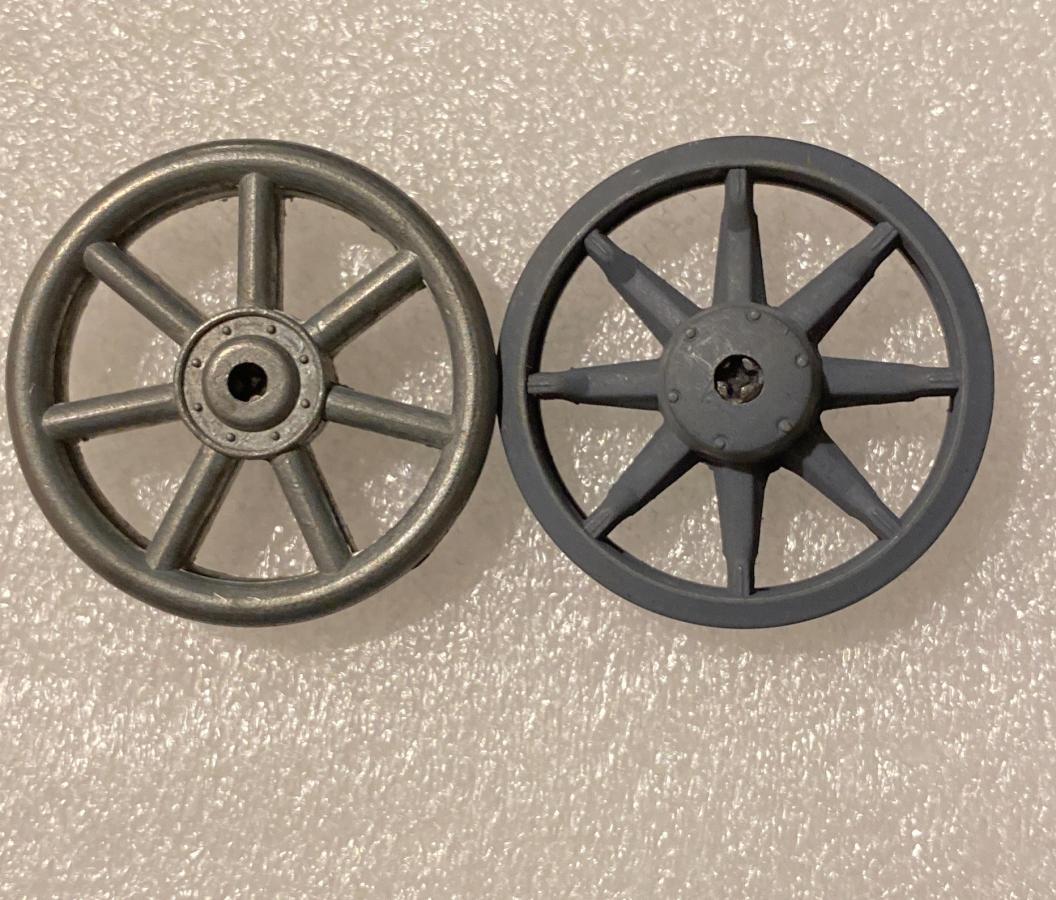

                            One thing I am not happy with is the tracks come off to easily. Almost any turn will de-track it. I have to slow down to a crawl to make a turn. I believe it has to do with the idler wheel. It’s too floppy and can’t be tightened any better. It is the metal Heng Long version that has no bushing. I ordered a Mato metal idler that comes with a bearing. I am hoping that will have better performance.
                            I have the same problem with my Panzer III which is the same chassis. I have the upgraded Idler wheel with bearing. It doesn't solve the issue. What solves it is keeping the stock plastic Idle wheel. I noticed the tension gets thrown out of whack using the metal idler. Gets really tight and without a track tension adjustment. You are at the mercy of removing or adding links which make it too tight or too loose. Nothing in between. It is like the metal idle wheel is slightly larger diameter.

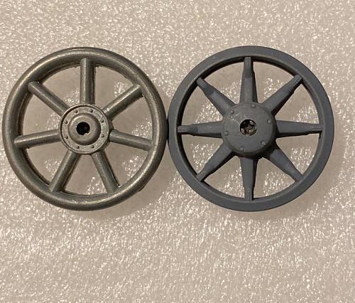

                                  What I did to make removing a link work is to replace the Idler with one from the Panzer IV. It's slightly smaller in diameter. So it is now the perfect tightness. And looks very similar. The Panzer IV Idler is on the left in the picture.

                                        See I knew something was wrong. Thanks Karl. So do you bother with the adjustable Mato track tensioner as a upgrade or will the PanzerIV wheel solve it? I am just using the plastic wheel for now and don't see any issue so far. I have metal tracks
                                        All you need is the Panzer IV Idler wheel. Get the Mato version because it has a bearing.
