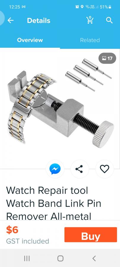

    Just bought this from Wish, cause I have a watch strap to shorten. But I see other possibilities for it Click image for larger version

    If it works which it should it is “great out of the box” thinking to solve an issue we all have. 👍👍
    • #3
      I'll let you know when it gets here. I was thinking you might not even have to take the tracks off,,which would make our lives a lot easier

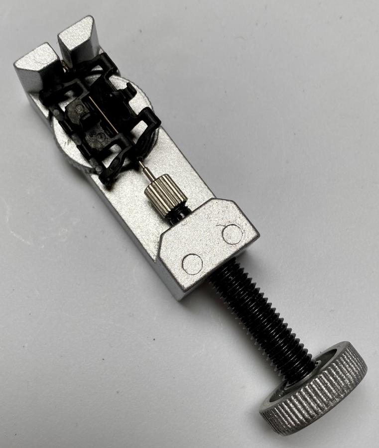

        Sappo, what a great find! I’ve already ordered one. Even if the pin diameters are too thick for our track pins, which I doubt, a little filing can fix that. All it has to do is punch out the track pin enough to grasp with pliers. I’m thinking it could also be used to push the pins back in flush using one of the thicker pins. 💡💡💡💡💡 Six bucks on eBay.

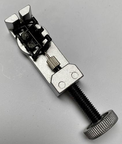

          May need to resort to this, should even go over winter tracks Click image for larger version

          • #6
            Yeah I was looking at one like yours but then found the one I bought, nothing to say that the pin can't be trimmed up, I only need another 4 mm to use it on my widest set of tracks, m1a2, 38 mm

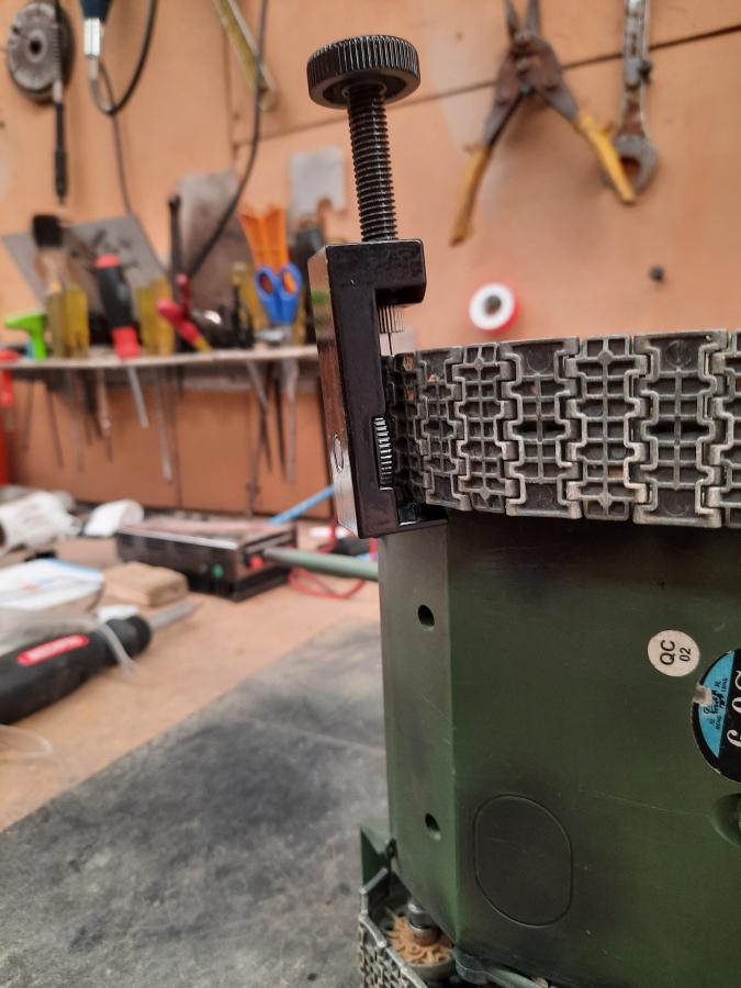

                Got mine, looks like it will work great, with one limitation. Maximum width track it can accommodate as is will be 1 1/2". IShermans, Panzer 3 & 4's no problem. Push the pin through an 1/8' and grab it with pliers. My King Tiger, however, sports 2" wide tracks. I guess they don't find too many 2" watch bands out there! I'm sure a workaround can be thought of. In fact, the 2 spare pins it came with could be used in a vise grip or pliers. Here's a shot of it pushing a pin out of two spare links. I also worked it on a track set already on a tank. Flip the tank over, grab some slack and push the pin out.

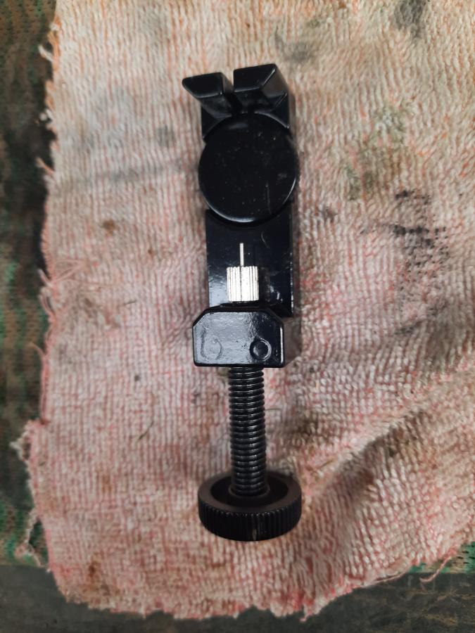

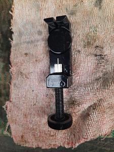

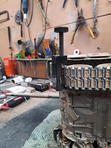

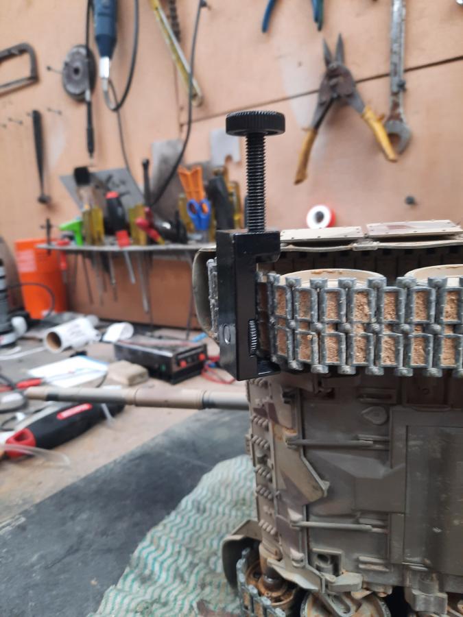

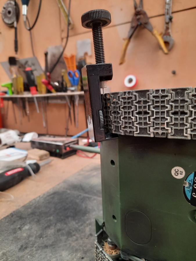

                      Well my "track breaking tool "arrived, did the job on the watch strap and then put it to it's true use. Fits the t34 and t90 without modification Click image for larger version
ID:	309917Click image for larger version

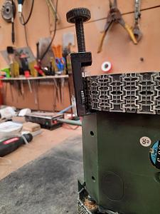

                        Just got to modify it for the kv1, chally 2 and the m1a2 Click image for larger version
ID:	309921thinking of removing the beveled part of the tool and trimming down the pin, will give me the necessary clearance for the wider tracks
